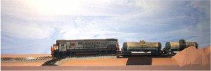

The hill on the right of this pic is done using blue styrofoam, and a hot wire cutter, then painted. Still have to do some more work on it, but you get the idea. I **KNOW** others have much better pics I'm sure they'll be happy to share, or point you to.....

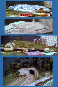

When I built my old layout, I meant for it to be totally flat. But after a short while I decided that I needed a scenery break. I used some spare pieces of blue foam to make a framework, which I then covered in plaster cloth. (Actually, it was 90% plaster cloth and 10% newspaper dipped in plaster. I thought I had enough plaster cloth left over from another project...well, you get the idea.) Then I painted the plaster and sprinkled on the ground foam. Later, I drilled and poked holes in it and put in some trees.
