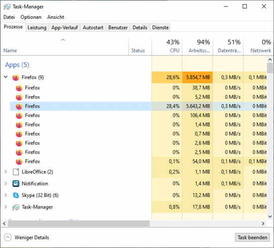

As a last resort I tried to limit the RAM usage with the task manager. FF has multiple processes which are displayed as a group. If you open that group you see the RAM used by the different processes:
You can see that FF is using almost 6GB of RAM. And this is happening with only one tab open with static content (no videos or fancy graphics). I opened the process tree and saw that one process in particular is using a HUGE amount of RAM. Unfortunately the PID of that process changes after a restart, so writing it down and searching for it would not lead to a useful result.

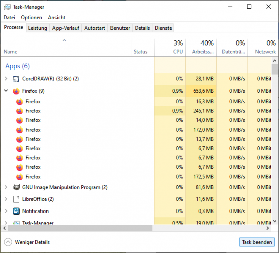

I then did something which I usually would never do: I selected that process and clicked on "end task". And guess what happened:
The amount of RAM dropped to 1/10th of its original size! Sometimes it even dropped down to 1/20th of it. I expected the program to act strangely and even shut down but that was not the case. I was able to use it as usual and did not notice any strange or unusual behaviour.
