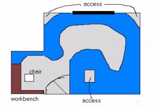

Hi Guppy
You're going to have quite an empire in that space!
Just wondering, could the entrance door to the room be re-located to, say near or even in, the closet? That would allow for three and a half virtually un-interrupted walls. Knock out the closet walls and build your workbench in there and still have room for raised storage/staging tracks - your workbench height would be 30" or so with the tracks being 48" (or whatever) high. The layout could then be built in a backwards G shape.
Just throwing out some ideas...
Pete
