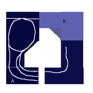

Ok i received my zephyr this morning and i hooked it up to my layout. Now my layout is an oval witha few turnouts ( it is the first phase of the trackplan. There aren't any return loops as far as i can tell.
Pretty basic really
