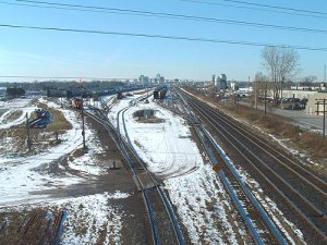

For your edification, here is a picture of the CN Yard in London from the east end looking west. The double-track main is on the far right side, with the arrival departure tracks towards the middle, and the actual storage/classification tracks towards the left.
You can see CN4129, a GP9 Chop Nose in a neutral position after having moved some cars around on the left hand side, mid-way up the ladder tracks.
I'll be posting more of these pics in the Canadian Trains section...

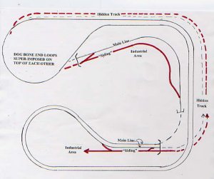

Yep, I'll reiterate SS's comments. You get an impression of double track with a folded dogbone but you also double your mainline run! My U-shaped folded dogbone layout in a 20 X 12.5 foot space has a mainline run that takes a reasonably paced freight literally five full minutes to complete a circuit.
I decided to avoid crossovers that created reverse loops. There are crossovers though because I added a long "siding" that follows part of the main line around the layout. This lets me run local switching independent of the main, or if I want, trains can cross onto and "foul" the main to switch industies on the other side of the track...
The main is long enough that I can run two short trains at the same time and create the illusion of freights approaching eachother on the double main from opposite direstions.
Here's a crude sketch of my trackplan...not to scale. The siding is represented in red.
Ralph
