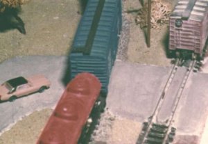

On my long gone N scale layout I made my roads out of plaster of Paris (POP) which was toned down with powdered black pigment. It is easy to pour the POP up to the outside of the rails. For the part between the rails I glued two short pieces of rail profile between the track rails (much like guard rails on a bridge, also bending the rail ends a bit inwards). Then I filed the space with a blob of POP and levelled it out.
This is N scale, and I admit that it isn't a masterpiece (so stop clapping your hands like mad! :D:D:D). From this angle it looks quite coarse, but from the normal viewing perspective it looked better.
On my new H0 layout I'll use the same technique, but this time I'll try to make the gap narrower and tone down the slit with a black wash.
Just wanted to offer another technique for doing a road crossing.
