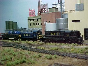

For industrial track, definitely lay it directly on the foam.
Here's what somer of my industrial track looks like...Not a real good pic, but you get the idea.

The "diorama" you mention (pictured in my post above) is actually a working N scale switching layout...I do use Peco code 55 track.
I glued it directly on the foam, & ballasted it with mostly dirt, & some Woodland Scenics cinders. I was trying to get the look of poorly maintained industrial track.
I did build the layout like a diorama...it has a backdrop on three sides, valance, & facia boards, & lighting. I was trying to acheive a look like you might see in a museum-type display.
The hole in the left rear is for trains to enter, & leave the scene, & will soon be hidden by the urban scenery.

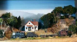

Here's a little N scale diorama I built a couple of years ago...it's tiny...about 5" deep, 18" wide, & 9" tall. It's an open box with a backdrop painted on the back.
Dioramas are great learning tools, since they can be built for very little money, very little time, & can encompass several asspects of model railroading.
This, for me, was a study in scenery, decaling, weathering, & backdrop painting...
