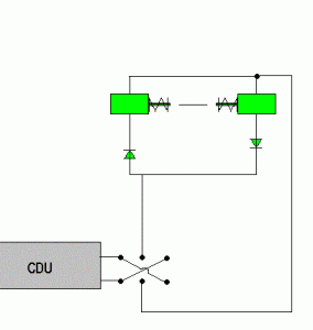

Hi all,
This is my first post to the forum so I decided to offer something i recently discoverered, this may have been said before but I can't see it.
On my first layout with powered points i used a common negative wire and two positives. I had no CDU so the trains slowed down every time the switch was changed and I needed three wires.
By two diodes I discovered that you could use only two wires and have the direction controlled by the polarity...
--Chris (Sempak)

For switching my points, I use the AC outlet on my controller, so it doesn't affect the trains at all, but I know what you mean about the threee wires. I run a "common" wire to all my points (turnouts) too, and then another two wire to each (one for each coil on the point motor.
Have you "cooked" any point motors with you diode method?

I think a bridge rectifier is a way getting AC or uncertain polarity DC into a set + and -.
No, I haven't cooked any point motors because I still use a Capacitor Discharge Unit to supply the current. I got it from DSE for about $12.

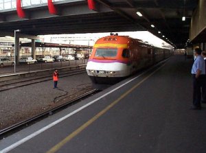

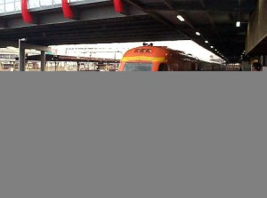

Wonder why only half the pix went the first time? Here is the full pix (I hope) of the XTP pulling into the Spenser Street Station in Melbourne after it's overnight run from Sydney. We departed on it a few minutes later for the 11 hour daylight run back to Sydney.
Bob

Hi Chris and welcome to the gauge from the UK.
The reason your loco's slow down is because power is used for the point change over, and is taken away from the loco whilst running.
Always better to use a 24 volt transformer through a CDU and a seperate transformer to operate the loco's.
Shamus
I do have a separate transformer and CDU for the points. That was a very old post and the diagram shows how I have it all set up.
