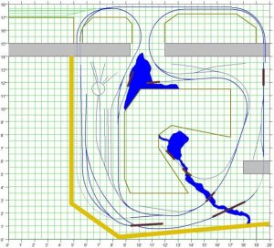

But good news... I have acquired a new area to build a layout. The room will be approximately 14'x15', with a 3'x20' staging/reverse loop area. I have yet to even stud out the walls, so I have a long way to go before running trains.:D
I have been designing a 2 deck layout, HO scale, that will represent a logging and coaling region in Pennsylvania somewhere (open for suggestions). The era is going to be in the 1920-30's I want a narrow gauge feel to the layout but use standard HO track code 83. Mainly for ease of construction. Not sure if I want to get into hand laying track yet for the narrow gauge, or even buy a whole new fleet of engines and rolling stock to operate on this layout. So I'm sticking with HO.

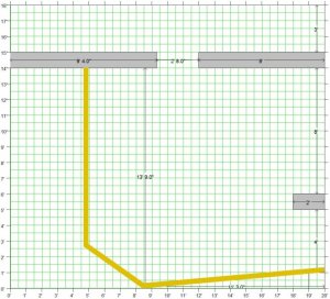

Here is a CAD drawn of the blank room. The 1' thick GREY walls are cynderblock and the yellow walls will be wood stud walls.

Below is the first level. The main yard/town area is on the left side of the layout. I will operate this as a point to point RR, but I have put reversing loops on both upper and lower deck. Although I won't be able to run trains from one end to the other because of a switchback section half way around the plan.

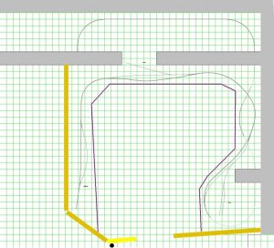

Here is the upper level. It starts in the upper right corner at 20" above the lower deck and wraps around clockwise up to 24" on the upper left corner. This deck will be the higher logging and mining camps up the mountains.

If anyone has any suggestion on the track plan, PLEASE speak up. I am very flexible to make any improvements to better the operation. And again if you want the CAD file I can send it to you.

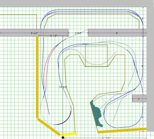

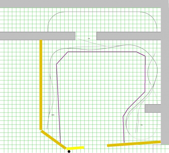

New Walk-in Design
Here is the new walk-in design I have come up with. This should make it a lot easier on my back.:thumb:

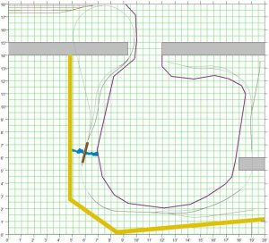

First level

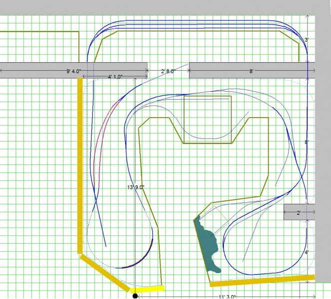

Second Level
I have most of the grade at 2.5%or less , But I was wondering if increasing it to 3 or 4% on the switchback would be a problem? The extra height I gain would be helpful in between the to decks. The radii is 22" or greater. On the first level (middle left side near the dimension 13'9") I was trying to squeeze a small yard in or engine service area. Any thoughts would be appreciated.
Ron,
the grade you can get away with will depend heavily on your motive power. I have a lot of old brass geared power, much of it modified with extra lead weight. small rod locomotives will be severely limited with grades over 3%.
the tightness of curves adds a lot of drag, so curves and grade must be considered together. You may want to mock up a section of track, with your curvature and test it at several different grades to test your locomotives, and see what you can live with.
The larger deck separation is nice. My redesign is attempting to use a helix, but they eat a whole lot of space.
Bill Nelson
