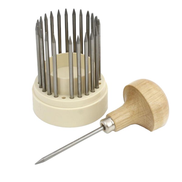

I do not know how big are your holes, but I use this set for punching small holes (0,25mm - 1,35mm)
Reactions: cecilmeyer
