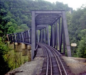

Steve, most if not all steel girder and truss bridges are constructed by using a series of short, straight bridges with their connecting points always on a pier. (See pic below)
Viaducts built in a real curve are practically always constructed from concrete or masonry. The reason is that the heavy stone/concrete better absorbs the lateral forces of a train going through that curve, than the more 'flimsy' construction of a steel construction. A metal girder bridge could start swaying sideways because it is more elastic than stone and then it might collapse.
Ron
