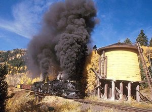

Hi Ted, Here's a picture of a D&RGW tank out in the middle of nowhere!!:D If you look closely you'll see that the train is pulling a long grade and will have to take on more water.

Thanks so much for the photo. Saved it for reference during my work on the siding. It'll be after the first of the year before i can start on this project. STILL trying to get the holiday layout completed, but may have more questions, and will post pics of what it ends up looking like.

Vic,
Looks like part of the Cumbres & Toltec Scenic RR...was supposed to ride that last summer (as I have said before :( ) but they closed it for fear of fires. I like the sympathy...;)
