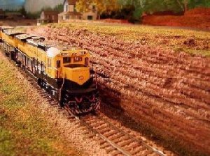

Hi Donn, I had posted a thread about this a while back, couldn't locate it just now when I tried. Here is a photo I found in my file tho. Not the greatest shot but shows the rockwork ok. Mine isn't ceiling tile, its homasote but the idea is the same. After glueing together the layers I went at them with a utility knife. This took some time and was more fun when done to fast music. Then I used needlenose pliers and tweezers to remove balls of material. Some touching up and it was ready to paint. It's not bad looking and I'm sure it could be done better.

I located my original thread, it is under General Talk, called "Modelling rock", currently on page 39. The one thing I do differently than the fine write up Marty attached is I don't use any plaster or similar material, I paint the homasote itself.

I really don't see where the thickness of the tile would be an issue in terms of scale. You need to carve strata into them anyway. Relying on broken edges won't look so good. Once you are done working it you shouldn't be able to detect individual layers of tile anymore.
