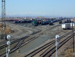

I'm planning a yard for my HO layout and want a truly functional yard.
I could fit a lot more yard in my space using curve radii like these.
Would it be possible? Would operations be reliable?

Rusted,
Take a look at Ray Mativier's layout in the N/Z forum.
http://www.the-gauge.com/forums/showthread.php?s=&threadid=2569
His yard looks like what is pictured here. He appears to have done what you want to do only his is in N vs. HO.:) :)
Curve radii
I've noticed that curves appear much sharper when viewed from the outside and broader when viewed from the inside. There's a yard (GO transit Bathurst Street) where the switches at one end look like Lionel S-curves when looked at dead on.
One of my friends worked for Algoma Central for a while and says he got strange looks for protesting some of the S-curves they were planning to put in one yard; says his boss recognised him as a model railroader.

Rusted,
The only concern I would have with curved entrances/exits from yards/staging area like the pic, is the placement of auto uncouplers.
The Kadee auto/magnetic upcoupler relies on the coupler being centred over the track. Longer carraiges with body mounted Kaddees, when parked on a curve, do not have the coupler centred over the track, and will not "auto uncouple". Also the coupler (magnetic strip) does not lend itself to being placed on a curve. (It physically wont fit between the rails).
That's just a thought if you wanna "automate" your yards. You could, of course, place thee coupler 2 - 3 " along the straight part of the yard, but you loose the length of "curve" as yard capacity for a lengthy train.
