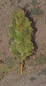

You can make some really passable trees with nothing more that twigs (or weeds) and ground up foam. I have scores of trees (like the attached image) on the back of the layout that were all made in a couple of hours. All I did was take some dried up weeds, cut them to size, drizzled a little watered down white glue on them and dipped them in a plastic baggy full of ground up foam (I mixed some different colors of foam together to keep it from being too uniform). You can also make some great looking bushes this way.

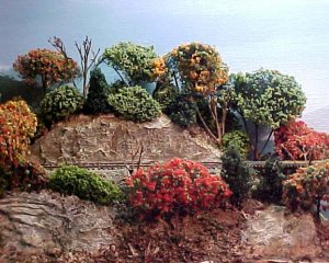

I make all my trees from weeds...
I posted a thread in the N/z forum here, called N Scale Trees...Cheap, Fast & Easy. (I think it's on the 2nd, or 3rd page of that forum)
While the thread deals with a particular plant that I get out of my wife's flower bed, any branchy-type twig would work as well.Here's some trees I made using this method.
