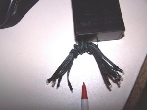

I finally got a picture. I put a small pen with them so you could gauge the size. They take 2 "C" cell batteries. I know there's a difference between parallel and series, but - don't ask. I've got another that uses 2 AA, with about 10 of those tiny Christmas tree bulbs. Can these be used some way with a resistor, or something?

Sure you can, Lynn. Try to determine the voltage required for each bulb, either by figuring
it from the wiring or by measuring with a voltmeter. Since it's low voltage DC you can
stick a sharp pin into the wire on each side of one of the bulbs and measure the voltage
across the bulb with it lit. That's a starting point.
If you want to light the whole string at once you just need a 3V supply or regulator. Can
you use your meter to measure the amp draw of a bulb?

OK, Lynn, you seem to have a 3 volt battery supply. Try to determine the voltage required for each bulb. If the bulbs are all wired in parallel then they are 3v bulbs. If there is some other arrangement, then measure using a voltmeter. Since it's low voltage DC you can stick a sharp pin into the wire on each side of one of the bulbs and measure the voltage
across the bulb when it is lit.
Do you have a VOM? Does it have a current range you can use to measure the amp draw
of a single bulb?
I don't have a VOM, but I have a battery checker that handles AA up to 9V to show if they are good or not. To do some "Southern Engineering", could I use those pins and see what voltage goes across? I was hoping it would work to hook them up to a power pack with a 'forty-leven' resistor.:D . I guess it just isn't that simple.

If you can get your hands on a meter, you can do what LoadMusic talks about, I have. Set the output of a cheap toy train power pack to 3 volts (or a bit less) You could go so far as to remove the knob and glue the controller in that position (I have) You won't have to worry about batteries anymore.
Gary, I was wondering about that. I hooked them up to a power pack and cracked it to about a 20. The bulbs lit good, bright but not 100%. I have a box of those cheapo packs, but It never crossed my mind to remove the knob and glue it in place. Thanks for the idea.
On the string of 15 Christmas tree light types, I did the same thing. Evidently they don't work the same as the GOW bulbs. They take 2 batteries too, but when I crank the throttle, some got real bright, and some so dim they were hardly on. I think I only paid a dime for them at a yard sale, so - - - - -.
