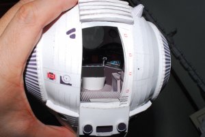

I have a couple of questions about the Hi-res UHU02 Pod. Hopefully one of you who have built it can give me a hand before I get started on the new Valley Forge:
1.) Parts 11/12 Silver Cylinder - according to the instructions, it looks like this is supposed to go somewhere under the control panel on what would be the pilots right side. Does anyone have a picture of this part installed?
2.) Seat - how does this mount? I don't see any type of post or cylinder, so does this just sit on the floor?
3.) Footwell - It doesn't look like there's any parts to cover the footwell area in front of the pilots seat. Does this area just remain open?
One other question - UHU02 has a number of parts on the the Valley Forge and some of his other models; how are those parts assembled? At first I thought maybe you just have to add your own tabs as you go, but some of the pictures on the website look almost as if the parts are edge glued somehow? I tried doing some google search on tabless paper models, but didn't find much. Any ideas?

First, welcome!
Unfortunately I haven't yet built the pod, although it is on my ever increasing build list... :rolleyes:
I can say that UHU02's models are definately in the advanced category; and require a variety of techniques, including edge gluing.
When I edge glue, and especially on small parts, I prefer to use cryanoacetate (superglue). It soaks into the paper and can be used to strenghten small parts... and has the benefit of instant bond. You have about 2-3 seconds to position, so you have to work fast. I tend to position the part first, "tack" a corner or edge and then reposition before final gluing.
UHU02 is really good about posting build pics on his blog; browse around and if you have questions, he's always happy to answer questions.
