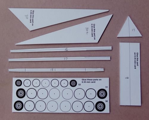

The instructions state there are some parts that need to be glued to 0.35 mm card. So, I laminated them to 1 layer of poster board, using Krylon Spray Adhesive. These parts are formers, stiffeners and landing gear tires.

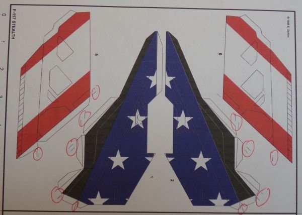

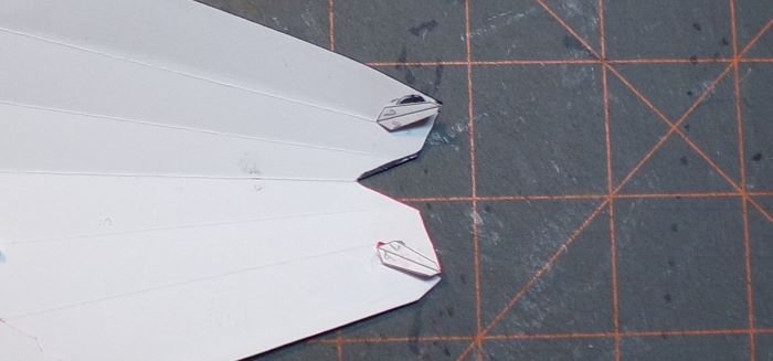

Assembling this model requires a good scoring tool. There are a lot of score lines because the model is mostly straight lines. Where to score is indicated by short black lines on the outer border of the parts. I circled score indicator lines in red in the accompanying photo.

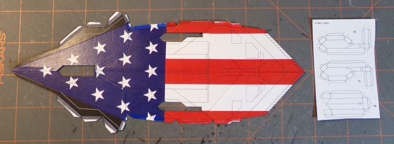

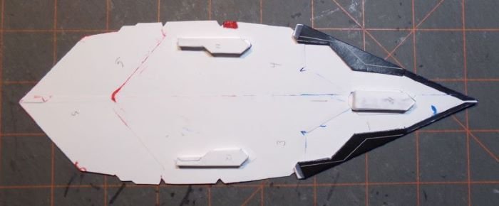

All 3 landing gear bays are constructed and glued to the unprinted side of the fuselage's bottom. The front edges of parts 1 and 2, which are black in color, are folded over and glued to the unprinted side of the bottom. The front portion of the fold over lays flat and the back portion is raised a little by 3 glue tabs.
Next step is to glue the bottom of each wing to the bottom of the fuselage.

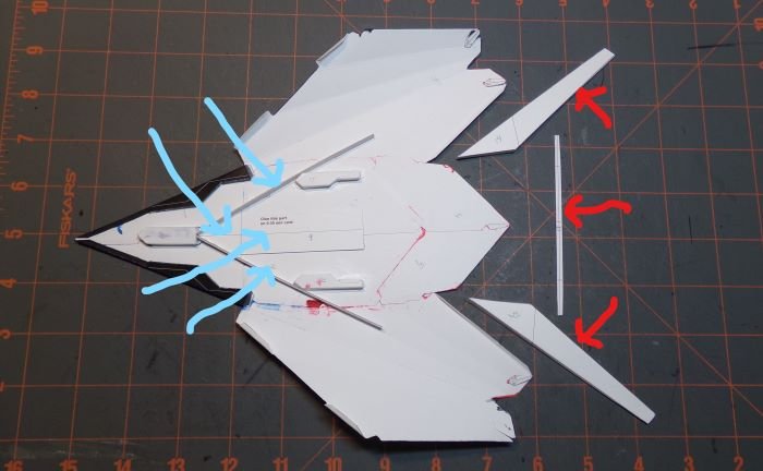

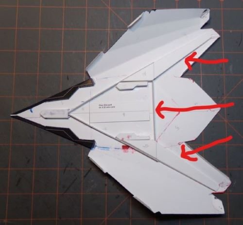

Once the underside of the wings were dry, it was time to add several strengthening parts (which I previously laminated to post board) to the unprinted side of the fuselage's bottom. The positions for parts 9, 13, 16 and 17 (indicated by the green arrows the photo) were apparent after studying the diagrams for a couple minutes. However, the diagrams weren't detailed enough to show exactly where parts 14, 15 and 18 (indicated by the red arrows the photo) should be placed. It was obvious the larger parts (14 and 15) were wing supports, but I was puzzled where to put part 18.

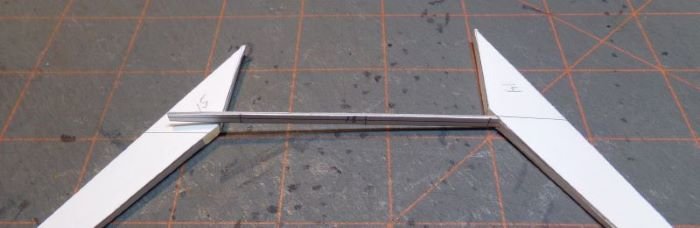

After some experimentation, I realized these 3 parts were designed to fit together into subassembly.
Identifying the positioning of the subassembly was fairly obvious.

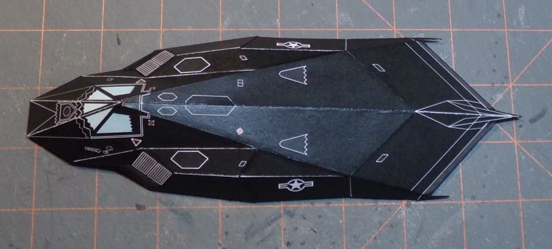

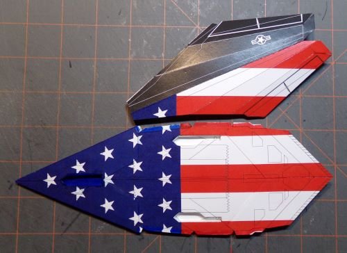

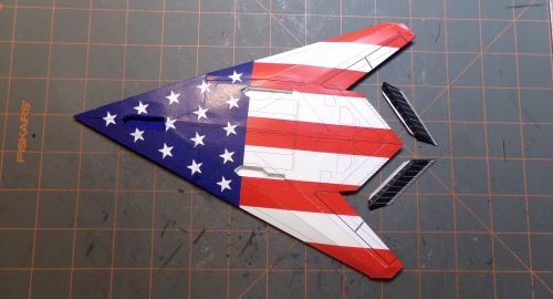

Here's what the printed side of the bottom of the fuselage looks like. Note the wings have a faceted shape with several flat surfaces, which is created by scoring the lines printed on the top and bottom of the wings. The engines vents (parts 19 and 20 - the 2 black parts to the right of the fuselage) will be attached to the unprinted side of the fuselage's bottom.

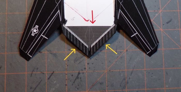

Here is the correct orientation for the engine vents (as indicated by the yellow arrows in the photo). The glue tabs on the back of each vent are at the rear of the fuselage.

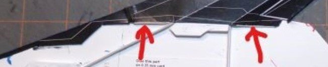

I covered the unprinted back portion of the fuselage with a piece of black cardstock to prevent white from showing through any gaps in the parts (indicated by the red arrow). Coloring that area with a marker would have been easier, but I didn't want to take the chance that the ink would bleed through to the colored side.

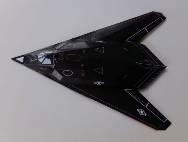

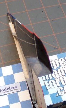

The next step is to mate the upper and lower halves of the fuselage together. There is a white line that runs from the front of the lower fuselage and across the inner edge of the wing. This is a guide line to show where the edge of the upper fuselage should be glued down.

Dry fitting the upper and lower halves of the fuselage is highly recommended before gluing them together. I started at the front. I positioned and glued the front edge of the upper about 17 cm from the tip of the lower. After the front was thoroughly dry, I glued down the first tab on the right. After that was dry, I did the first tab on the left. I worked my way down the sides, alternating to the left and right. There were 6 glue tabs on each side of the upper fuselage. The rear end didn't have glue tabs so I edge glued it together.
