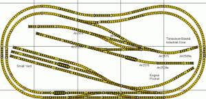

Give me a few hours and I can put something together in RTS for you.
As promised
As promised, a quickly thrown together layout, based on the '3x5 for the absolute beginner' website. I lengthened the 2x4 version of the track and added a double track:
theres a slight curve of the backstretch to make the trains' movement more interesting.
the 3 track yard can be expanded to 5 tracks with a few more turnouts
the industry area is actually a stretched timesaver, with plenty of room

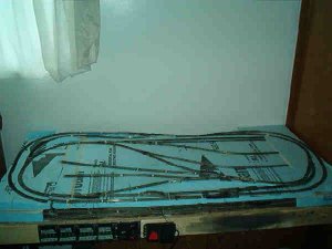

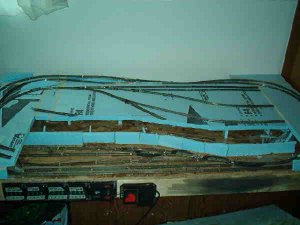

well guys here is a couple of photos of the layout
it is a dubble loop with a small yard on the front side under the layout and all joins in the back behind a back drop he can have all the switching he wanted and still run another train it is all going to be wired for dc due to he don't want dcc yet but it is made to add to a bigger layout at a later time

It looks like you have a reverse loop in the first picture right in the middle. Is he ready to deal with a reversing section? Of course the second pic looks like the reverse loop has been elimintaed, so my question may not be justified.
it is some what of a reverse loop in the middle it is their for he can enter that middle for any way but the power does not switch that is part of the middle loop i tested it and can run a train on it with no problems
in the 2nd pic that is the outer loop that runs under the rest of the layout and in to the yard and at each end their is track to join it to another layout the track can't be seen it is under in the back at the two coners
It looks like a neat layout. I hope he enjoys it. If it is in a coffee table, he will be able to access it to do switching and operations won't he? I'd hate to see such a nice operational layout reduced to just having a train go around in circles.
