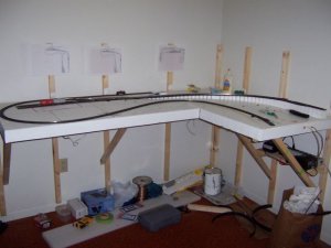

Rich,
can I ask you some details please?
It looks like you are supported about every 18" along the wall... is this correct?
You are using a foam base? How thick is it?
What is your max overhang out from the wall?
I would really like to see a picture from underneath... is that possible?
Thanks!
SeanM
