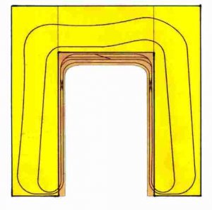

I thought about what your requirements are and I think I have a solution. This would work for HO or N gauge. (for some reason I think your an N gauger) (Isn't CSX N scale?)
What you would do is build a 1"x 4" shelf 3 inches below the level of the layout table top around the inside of the 'C'. Then you would have your track loop around to the inside edge and descend down a sloped roadbed to the shelf. Then the track runs around the inside of the 'C' and ascends on the other side.
You could make the board that goes across the back of the 'C' out of a 1"x 6" or a 1"x 8" and this would give you a staging yard.
You could make the layout table's edge look like a rocky cliff.
You could make storage tracks that come off the staging area and run under the layout table. This would be a good place to store the trains and rolling stock when the layout was not in use.
I hope this helps. :)
You could have 2 tracks running around the inside track. This would give you a lot of options. I have made this quick sketch to give you a better idea of what I mean. The tracks that descend to the secret staging yard would have to be a permanent installation, but you would not have to permanently install the rest of the track right away and you could still experiment with the rest of the layout once the return track was installed.:D :D

train clown nailed it
That was a great idea, which I'm seriously considering. Benchwork ain't my thing, but I might give it a try.

So , as I understand your post, you have a 8x2 foot table going across flanked on either side by 8x2 foot tables going up and down. By my thinking, that makes the layout 8x12 foot and not 8x10 foot.
Also, if you want me to figure out the table alterations I need to know how the tables are put together. Are they just 3/4 inch plywood, or do they have a frame around the edge? How deep is the frame etc.

I'm planning the same sort of layout with staging and storage "underground" and I have one recomendation, seperate the shelves by more than 3". Make the spacing wide enough to get your hand in and are able to manuver to correct any problem that occures on that level. Also be sure that you can see what's happening. I would recomend mounting lamps on the "ceiling". Grain of wheat size would be plenty and have them swithed so they are only on when you need them.
That's my 2 bits worth :)
