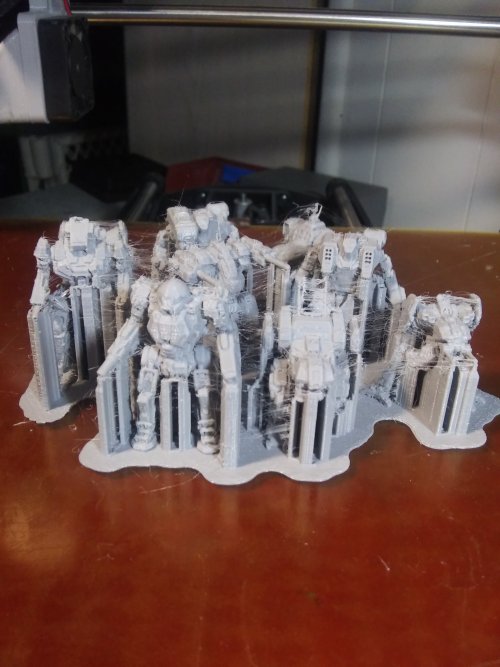

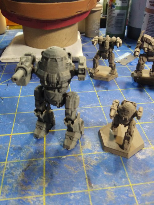

What I had trouble finding, were mechs though. See my other post in Resin about my 3rd party build using some awesome resin miniatures... I just struggle with letting my sons use those however, so I needed some more durable mechs. People have been 3D printing the Mech Warrior Online models (and a few modified 3d meshes from earlier Mechwarrior 4 and 3 single player games), so I gave it a shot not expecting much from my FDM printer (Lulzbot Taz 5).

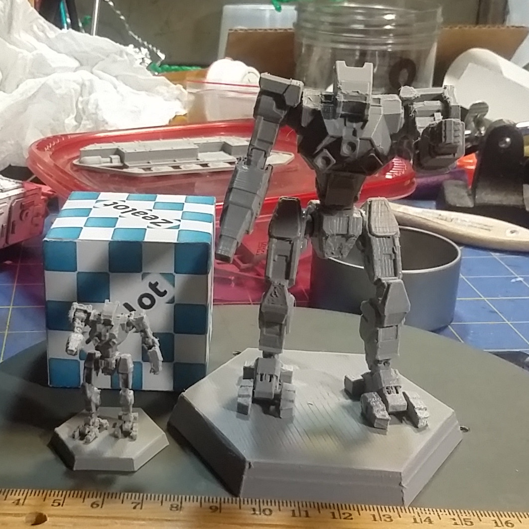

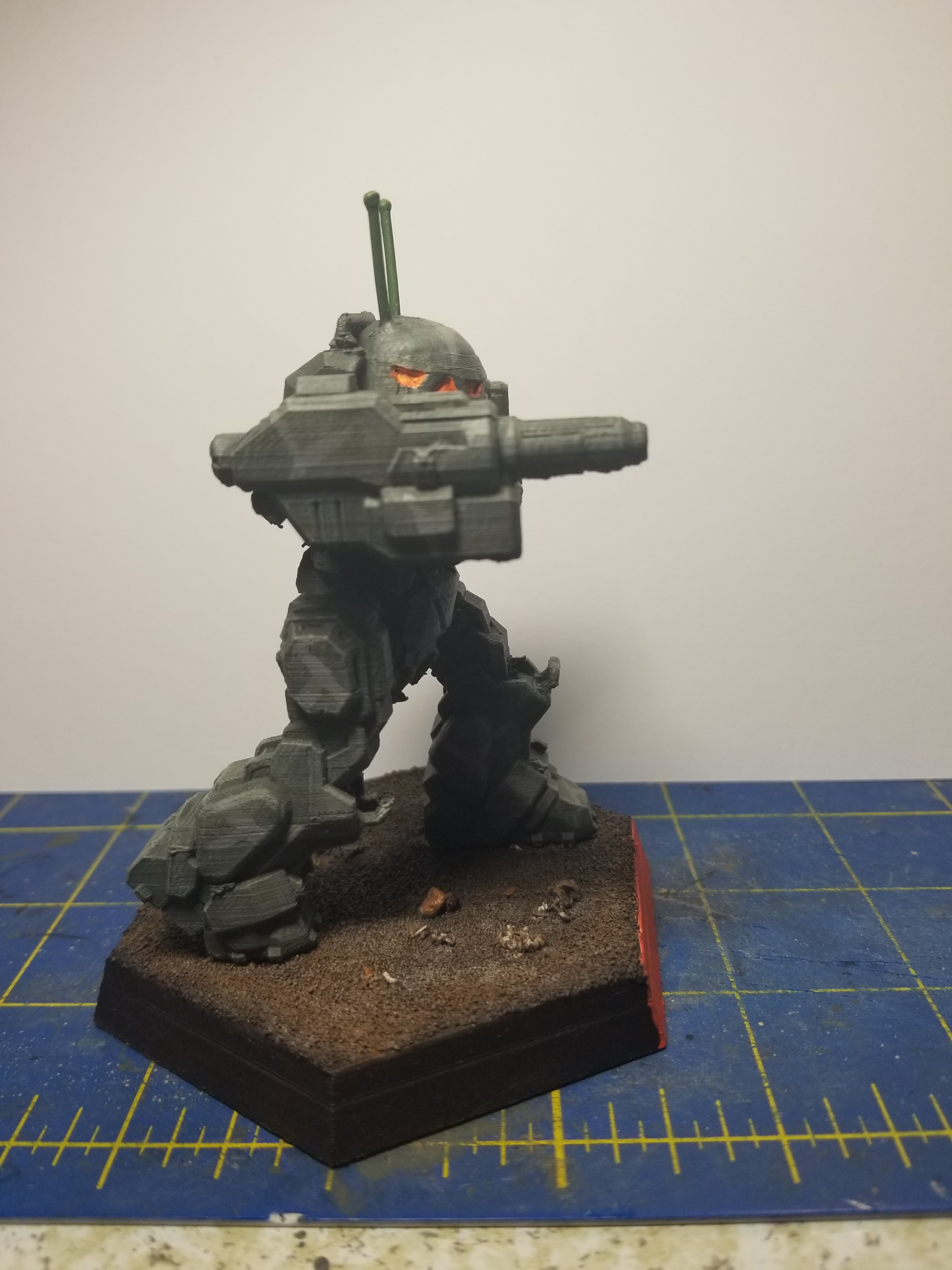

Here are a couple of Urbanmechs I printed. Left we have one that is viable for 15mm (1:100th) scale table top games, or decoration, and on the right, the 6mm (1/285th) scale used for Battletech on the map sheets or miniatures rules.

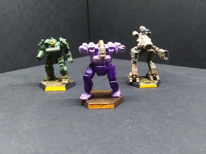

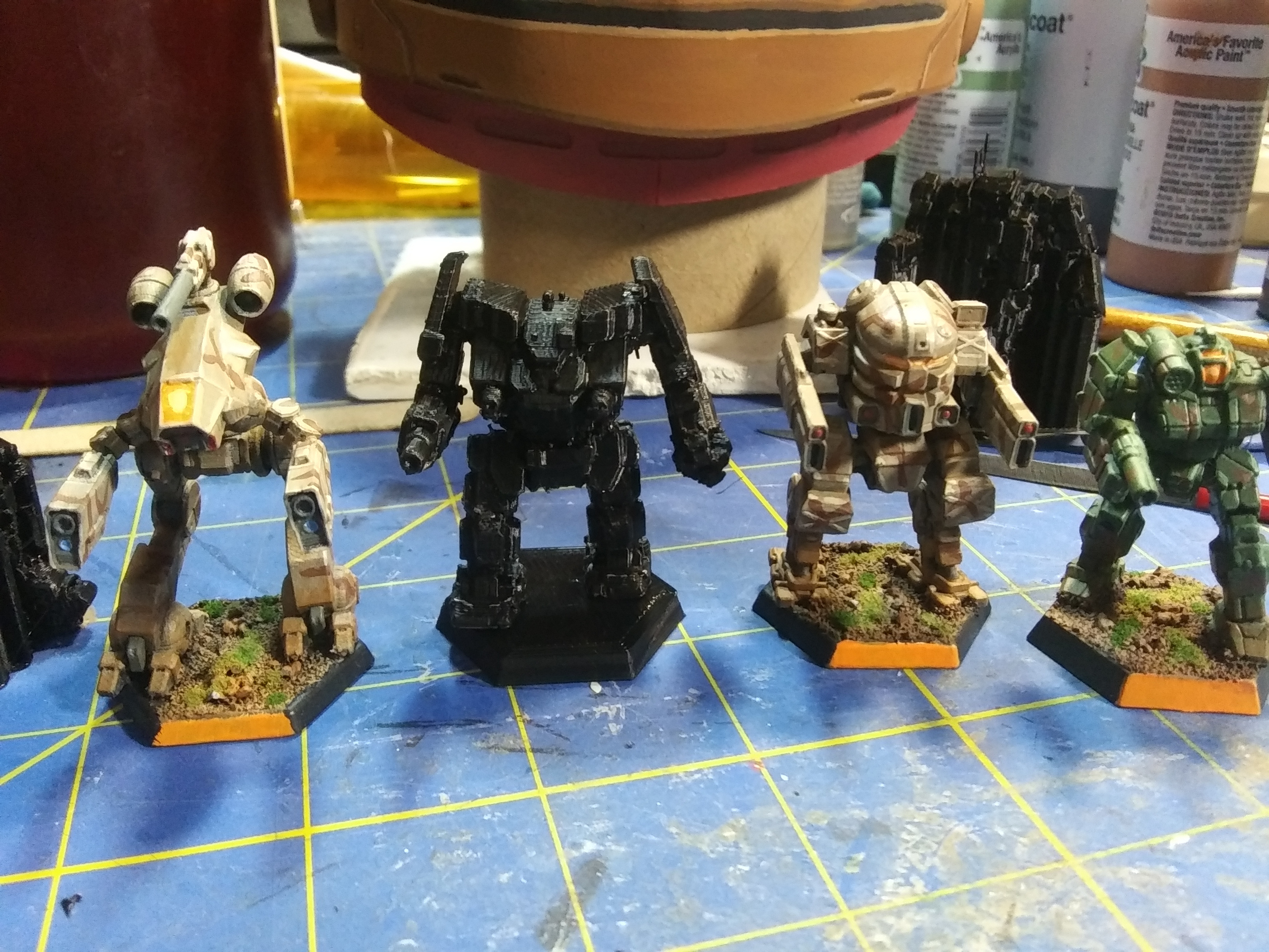

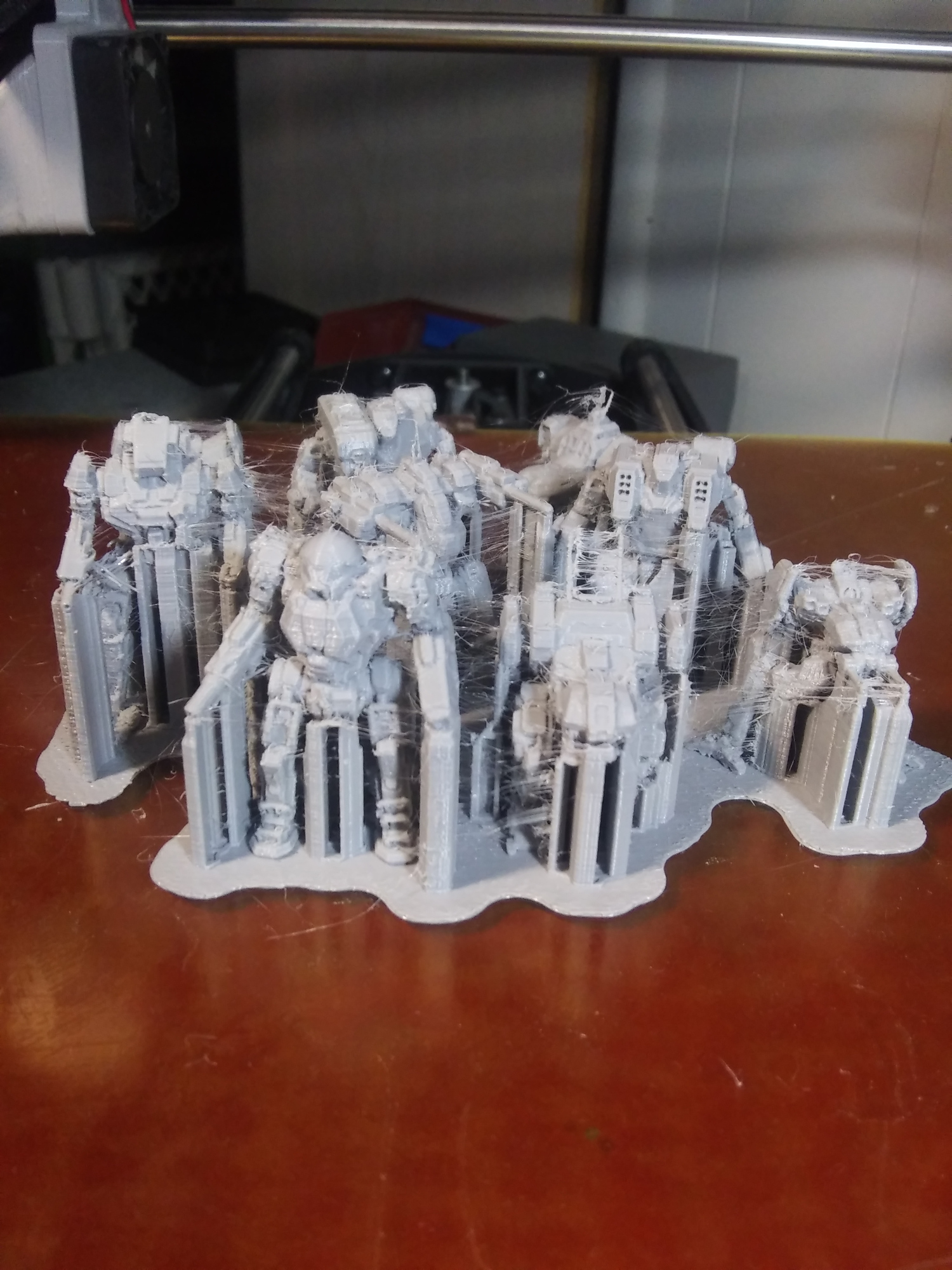

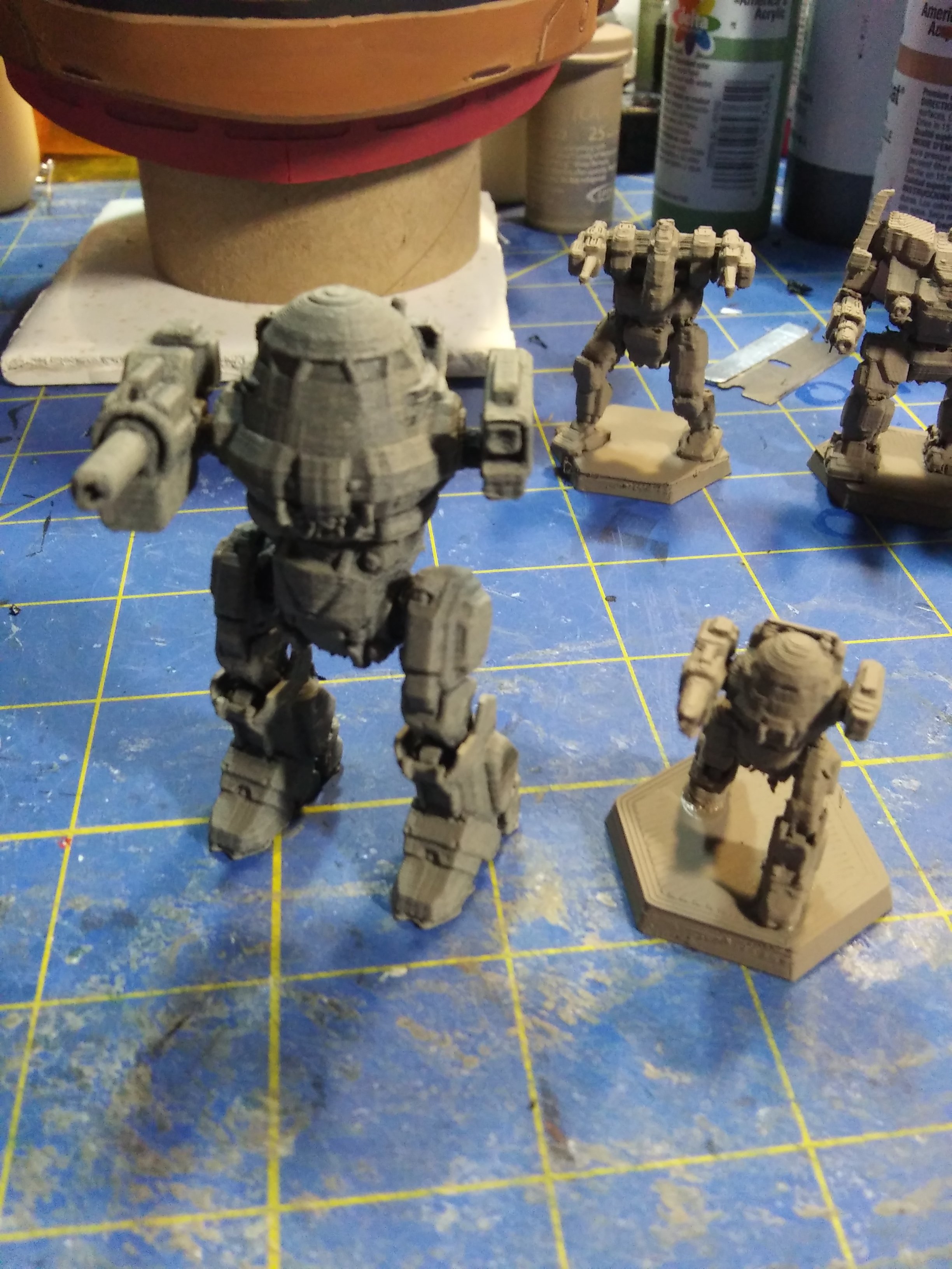

Just to the rear, you also see a primed Blackjack and Awesome in the 6mm scale. These all had a layer height of .14mm and a 20% infill. I found the need to use a raft as the feet on the 6mm scale are too small to effectively sit on my PEI print bed. They required support, and I used zig-zag at 30% at first but had to re-assemble the small ones a lot as that was too dense and pieces like feet and gun barrels fell off while I removed supports!

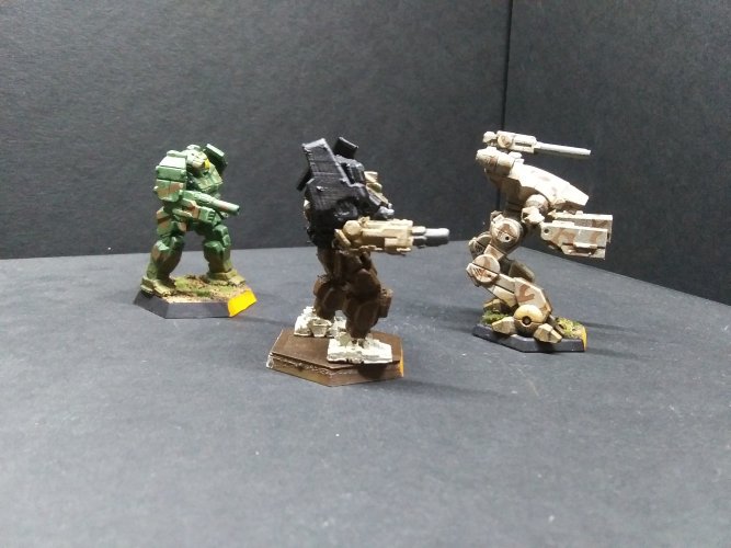

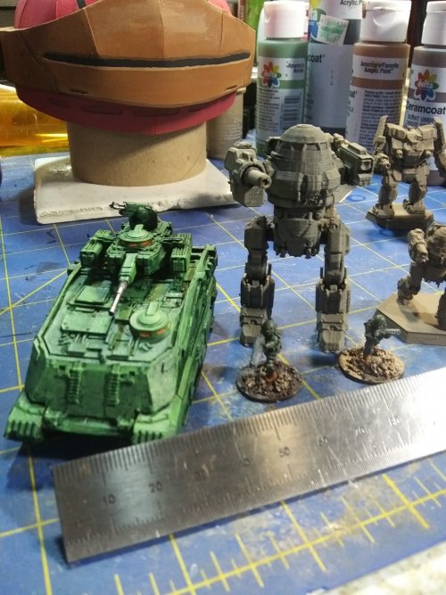

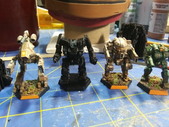

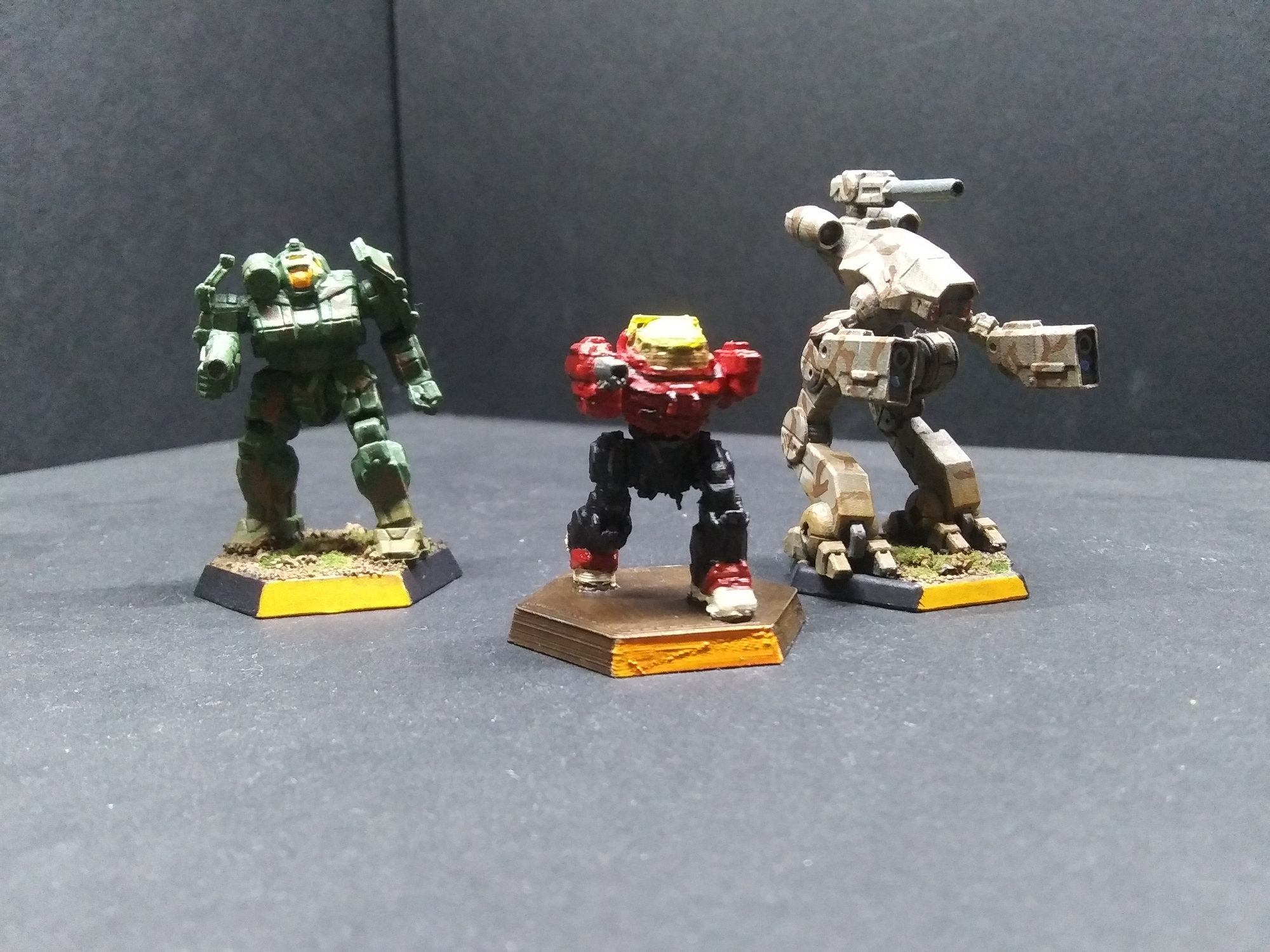

Here is the Awesome next to the resin Stratos Minis (Bullshark on the left, 3D print Awesome, Flashman, and CGL Griffen). I learned NOT to print in black for these in the future. The visual pain of trying to clean up black 3D printed plastic was enough... I will print the bases black however, as they have little detail I need to worry about, just some basic sanding.
Finally, I had to put this Urbie next to some of my 15mm army and see how it compares, and yes, it works perfectly. I'll try to dig up which model I printed on Thingiverse and post it later. I'm very pleased with the level of detail from the larger scale, as a final product. 6mm scale, well, the detail is good enough to serve as proxies until I get some better models (as in the plastic or pewter and resin kinds). In the mean time, I have some fun models to paint in odd ways, as well as some great beginner miniatures for my boys to paint.

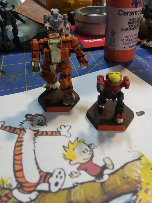

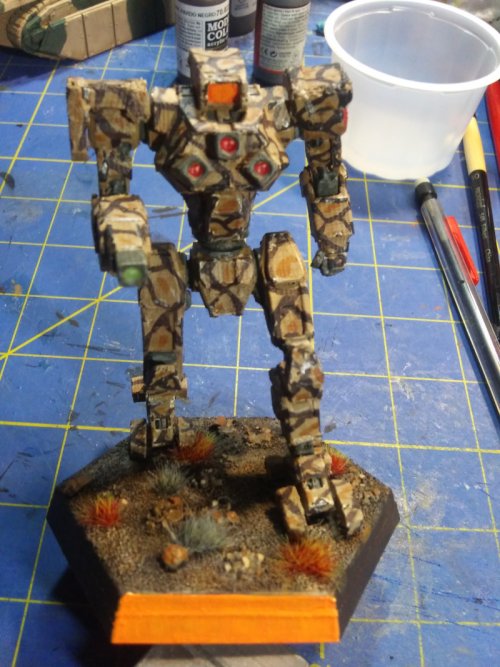

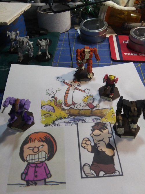

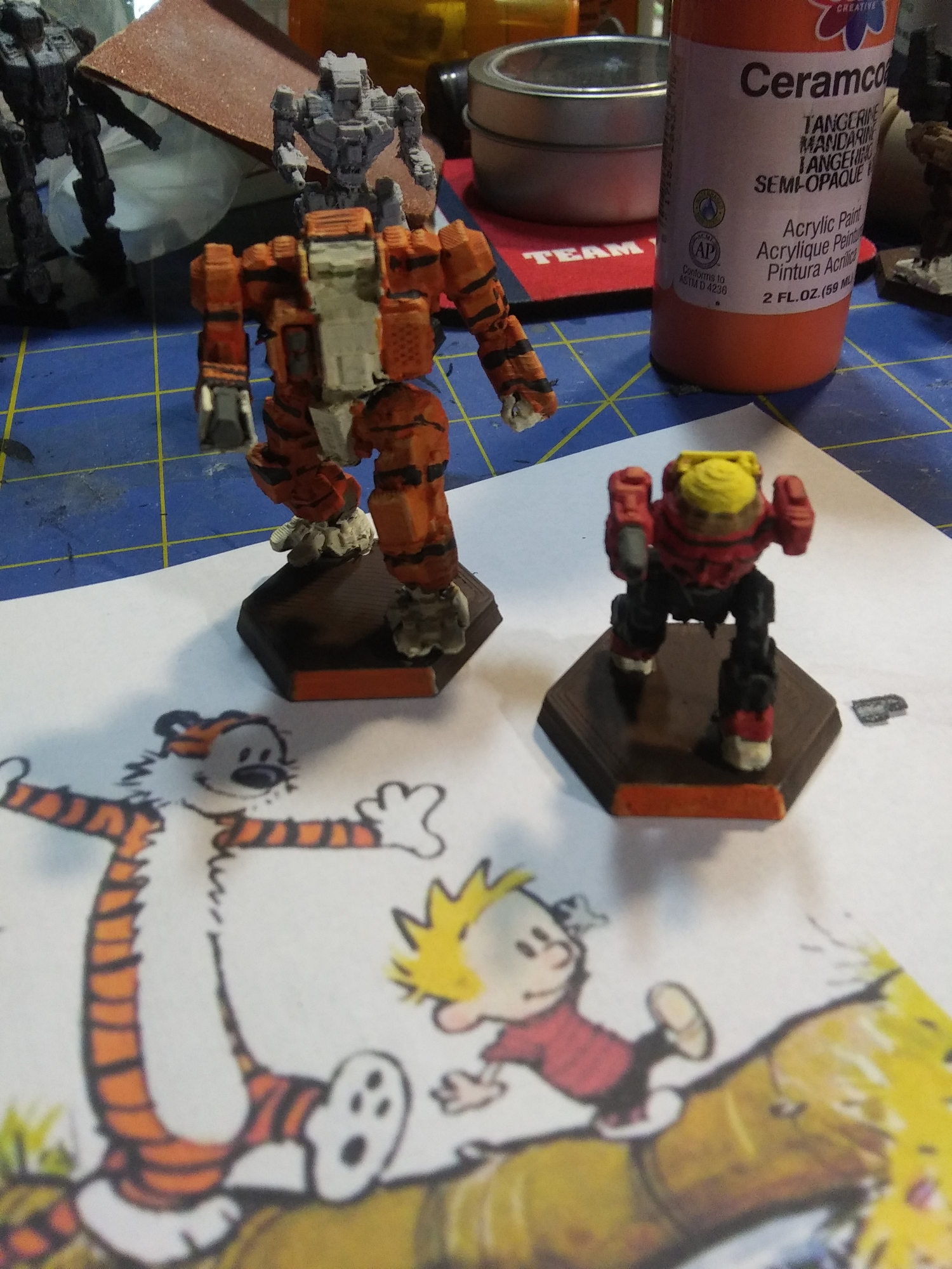

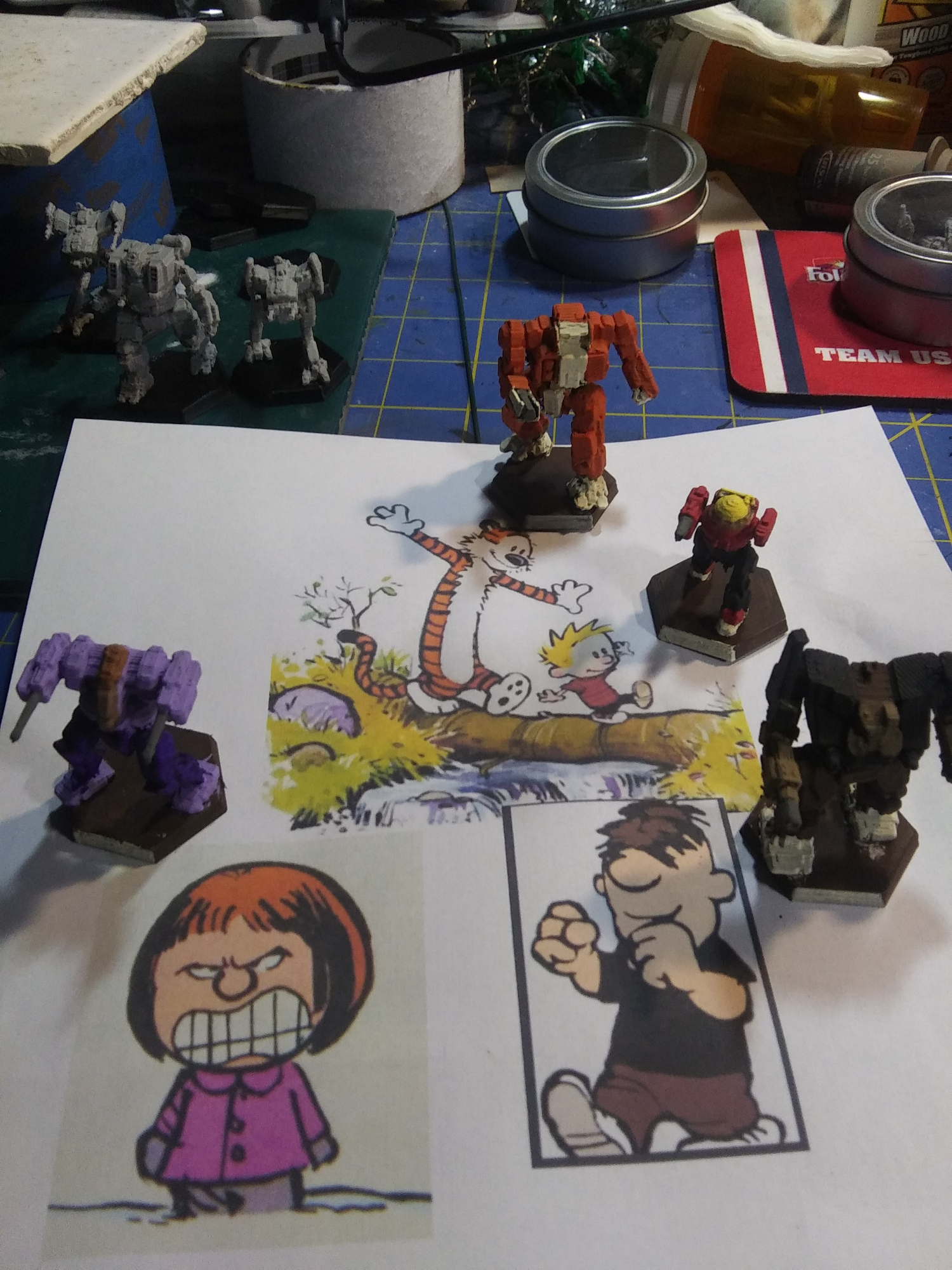

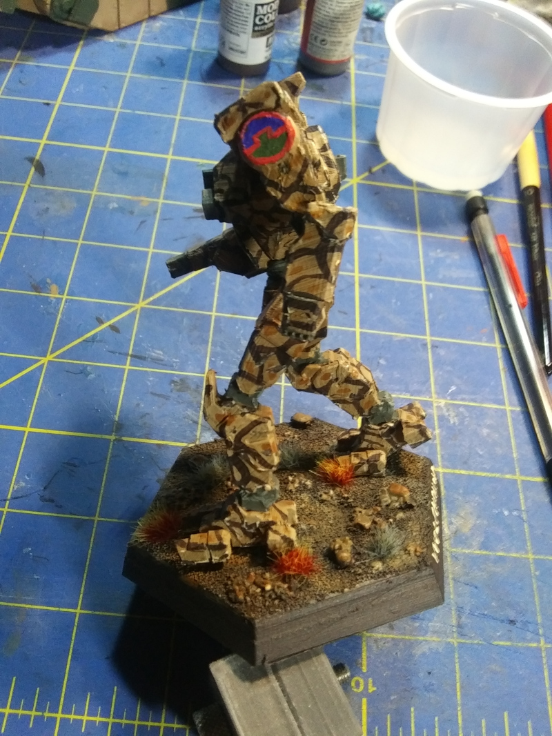

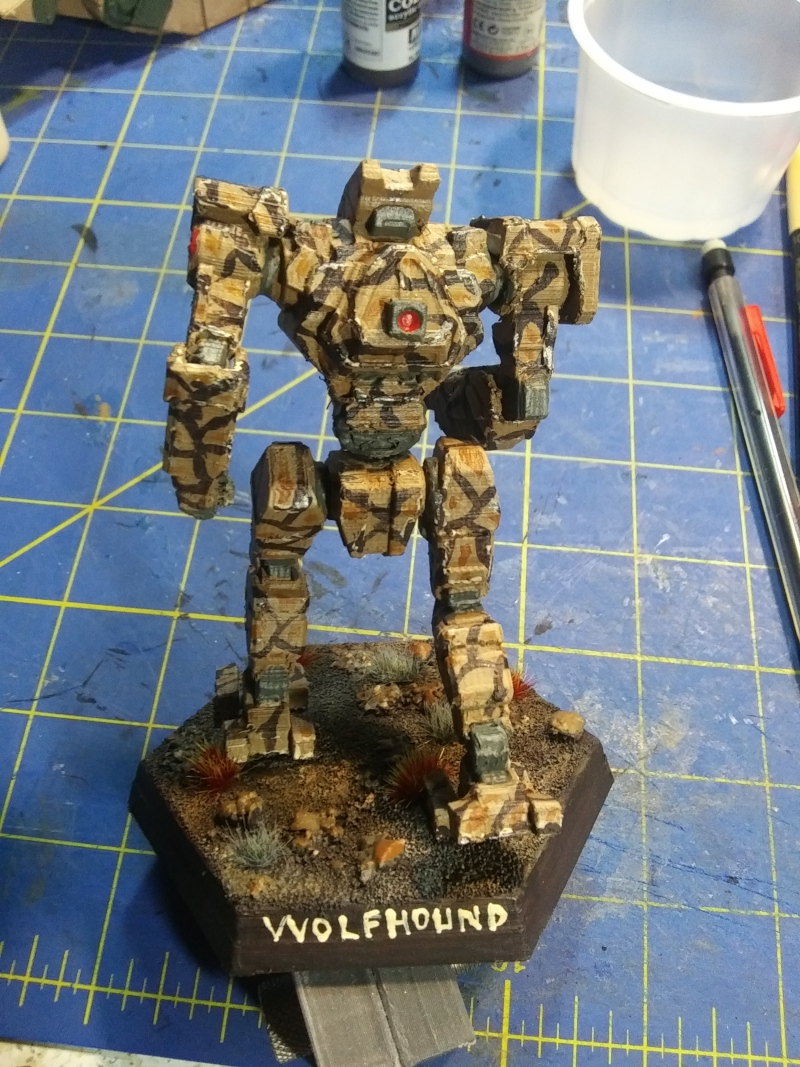

So, for my first paint ups of my 3D proxies... I decided to do something I'm unlikely to do with actual models.
Create a Sunday comic strip inspired lance... Watterson's World Defense Forces militia... Lead by Calvin and Hobbes.
Printing stats: 3D Print Life gray Pro PLA
Extruder Temp: 200 initial layer/195 print temp
Bed Temp: 80 initial layer/ 50 print temp
Layer Height: 0.1mm
Infill: 20%
Supports: From bed, lines, @15%

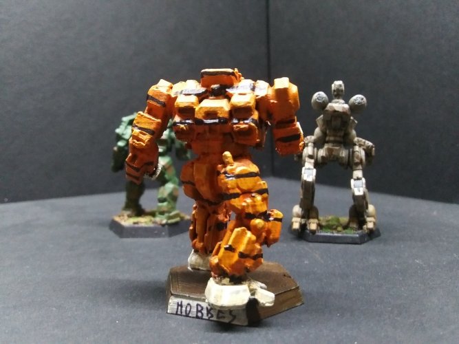

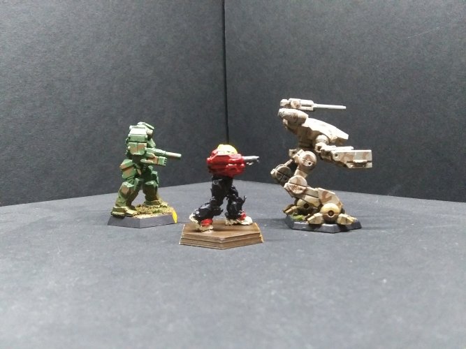

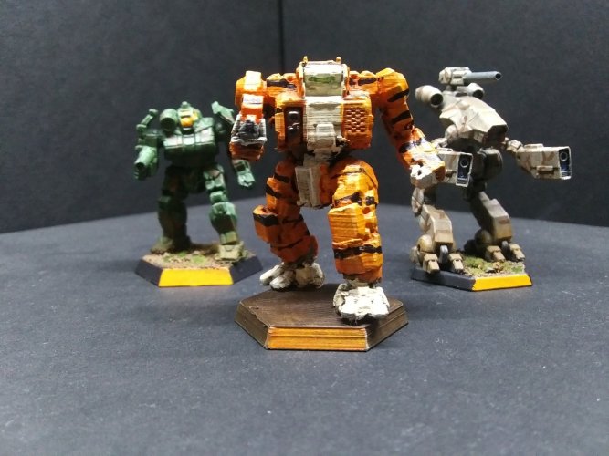

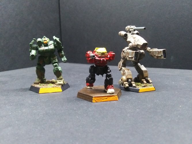

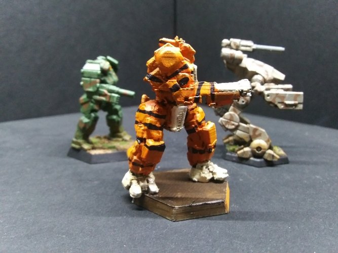

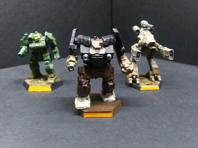

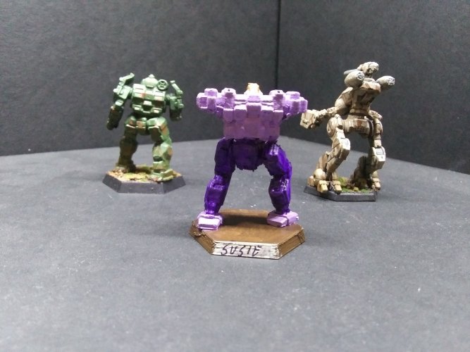

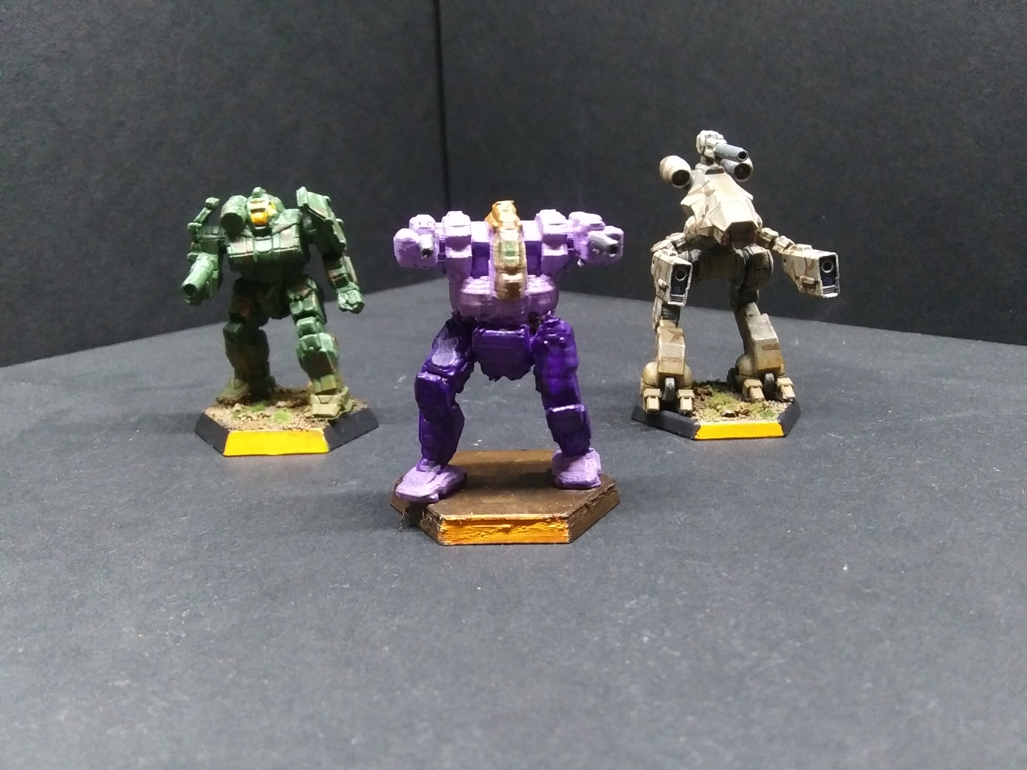

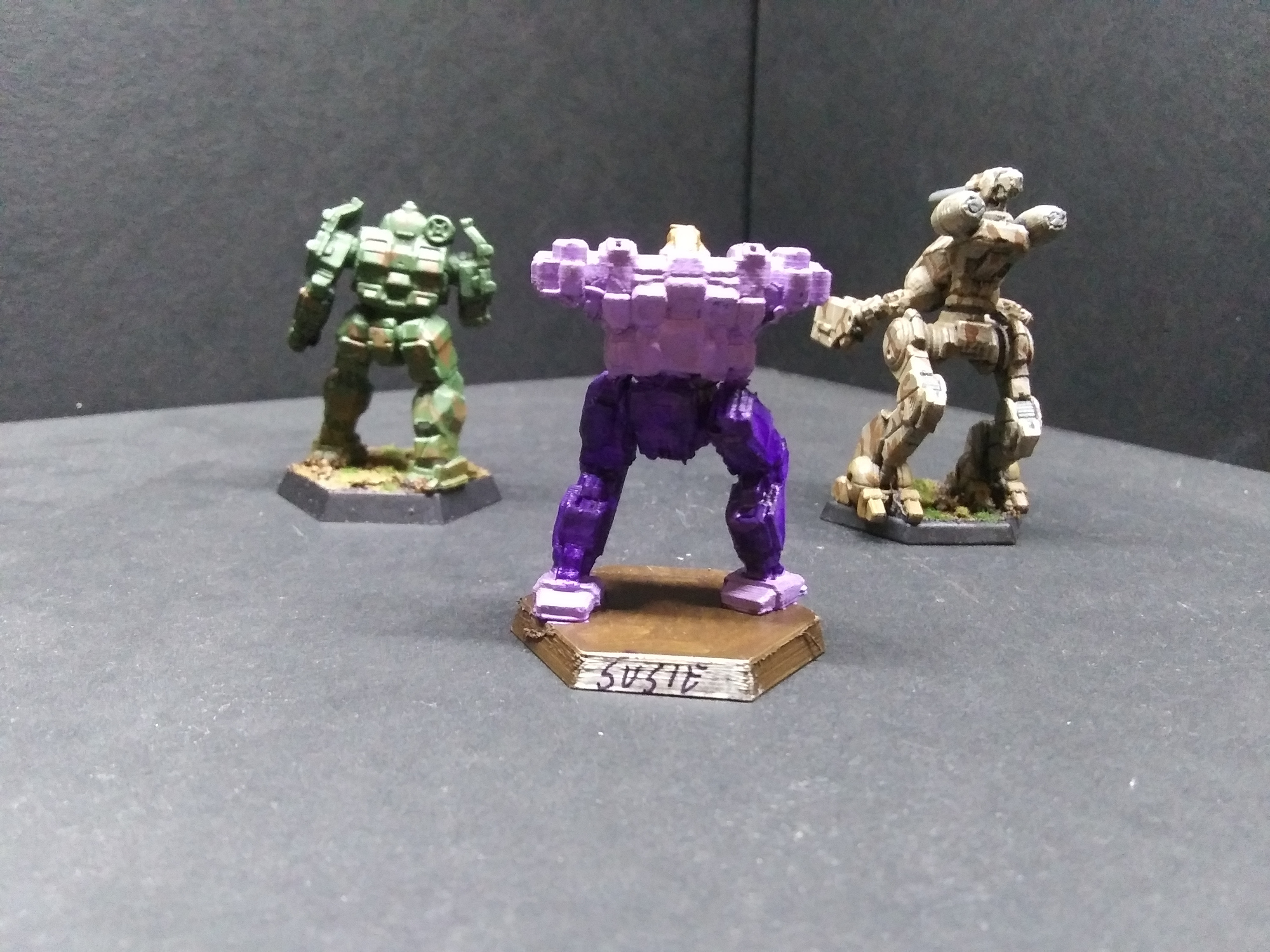

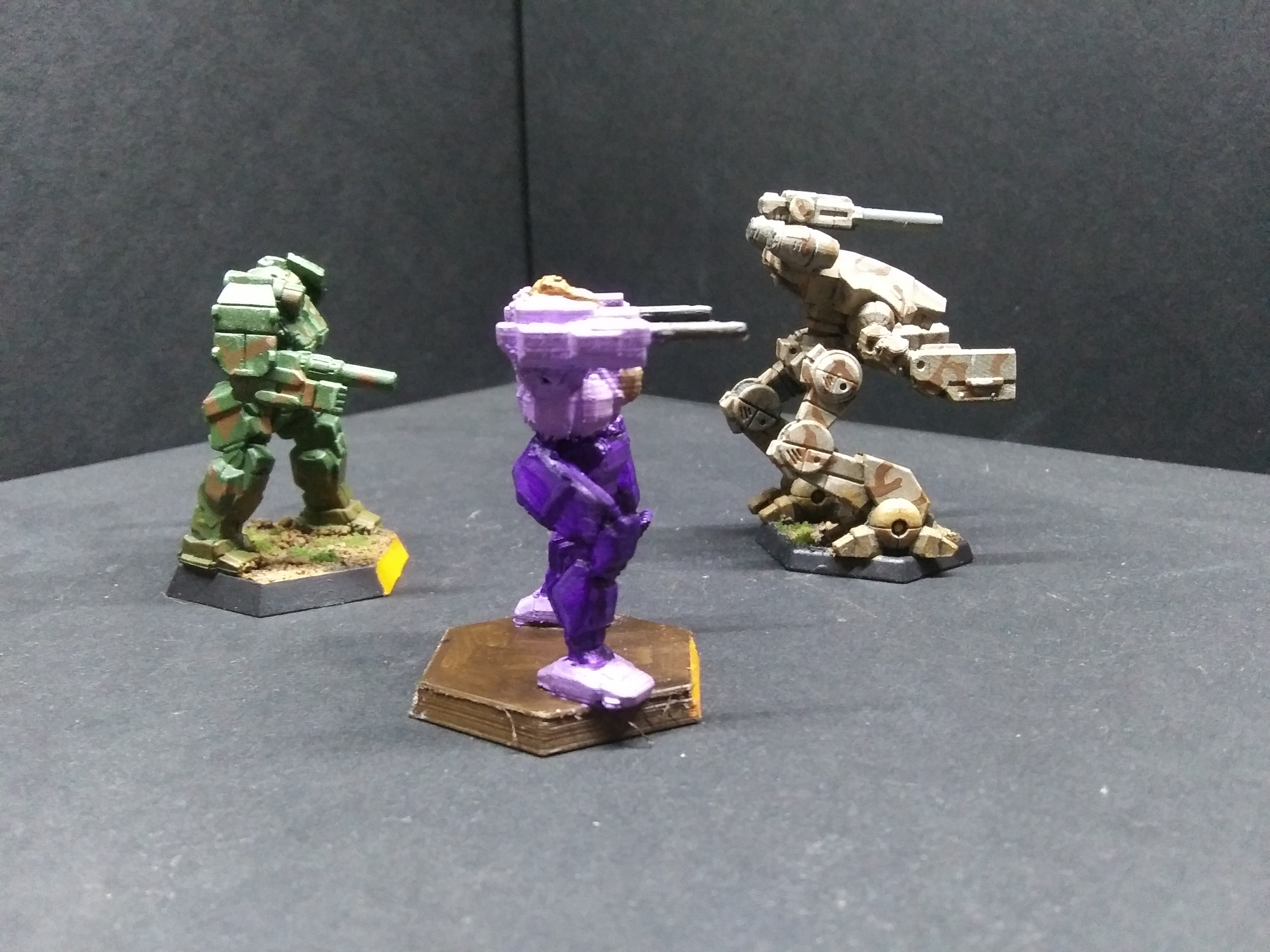

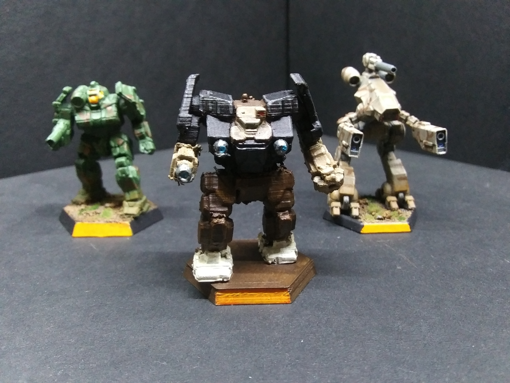

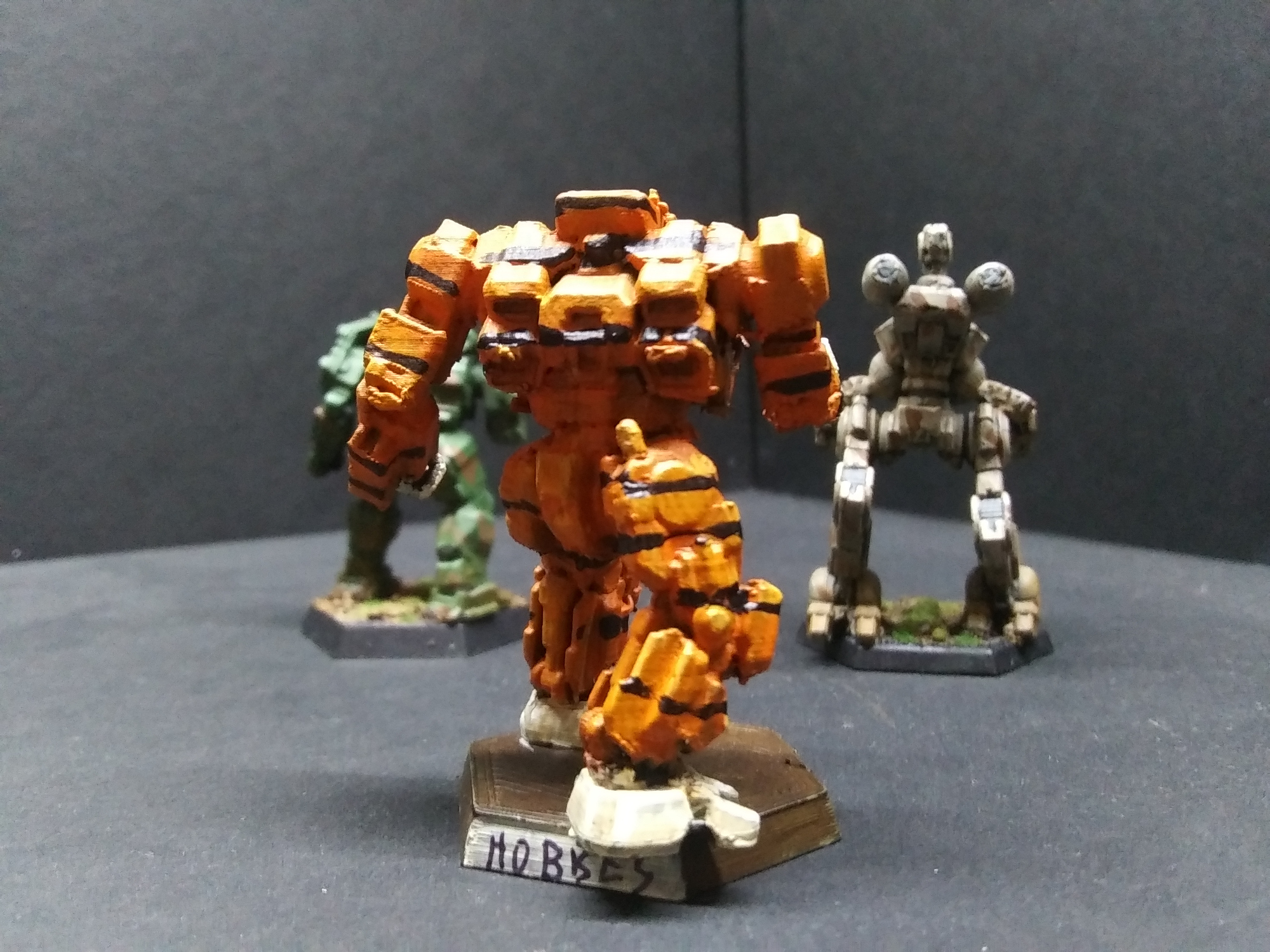

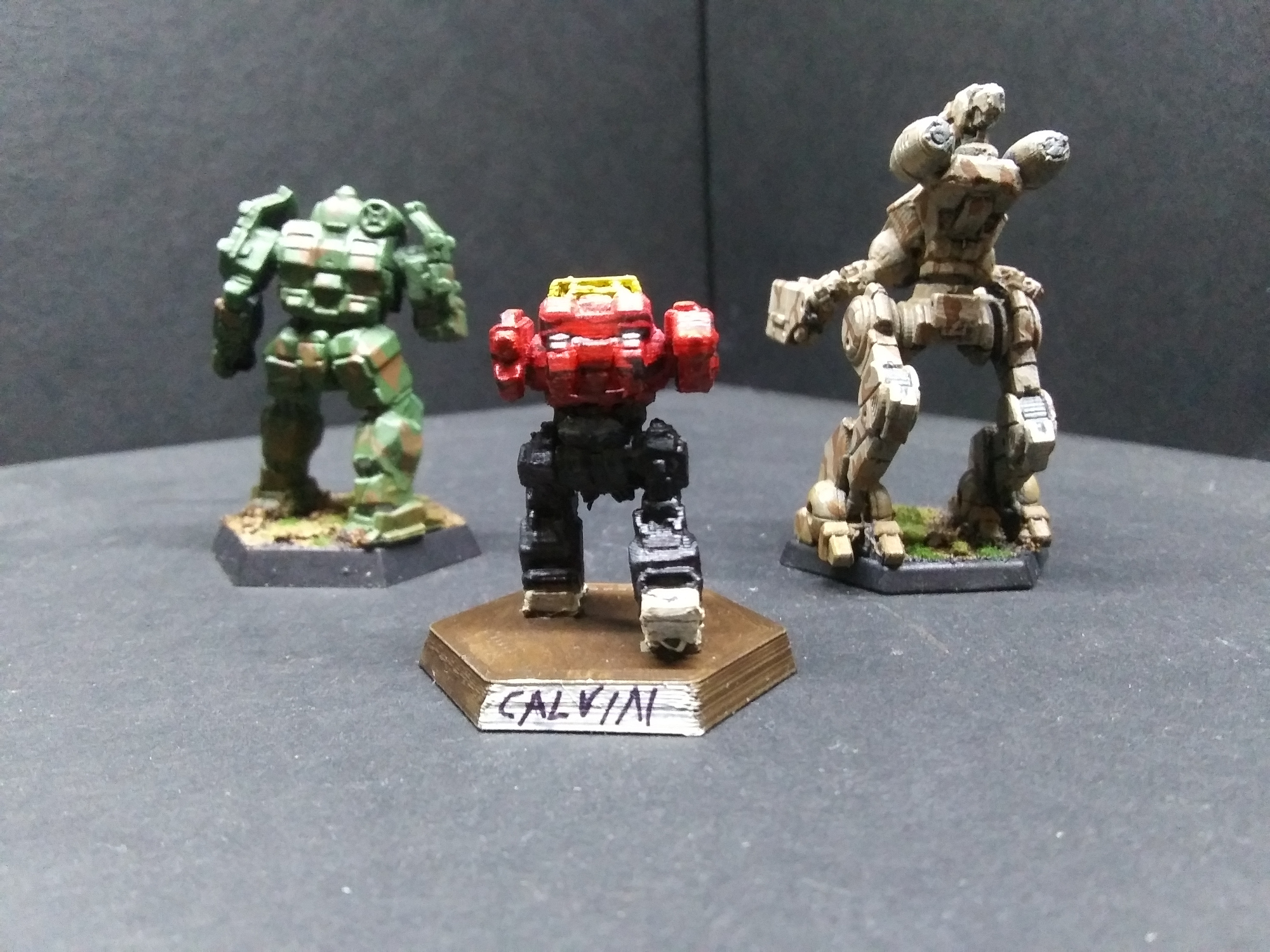

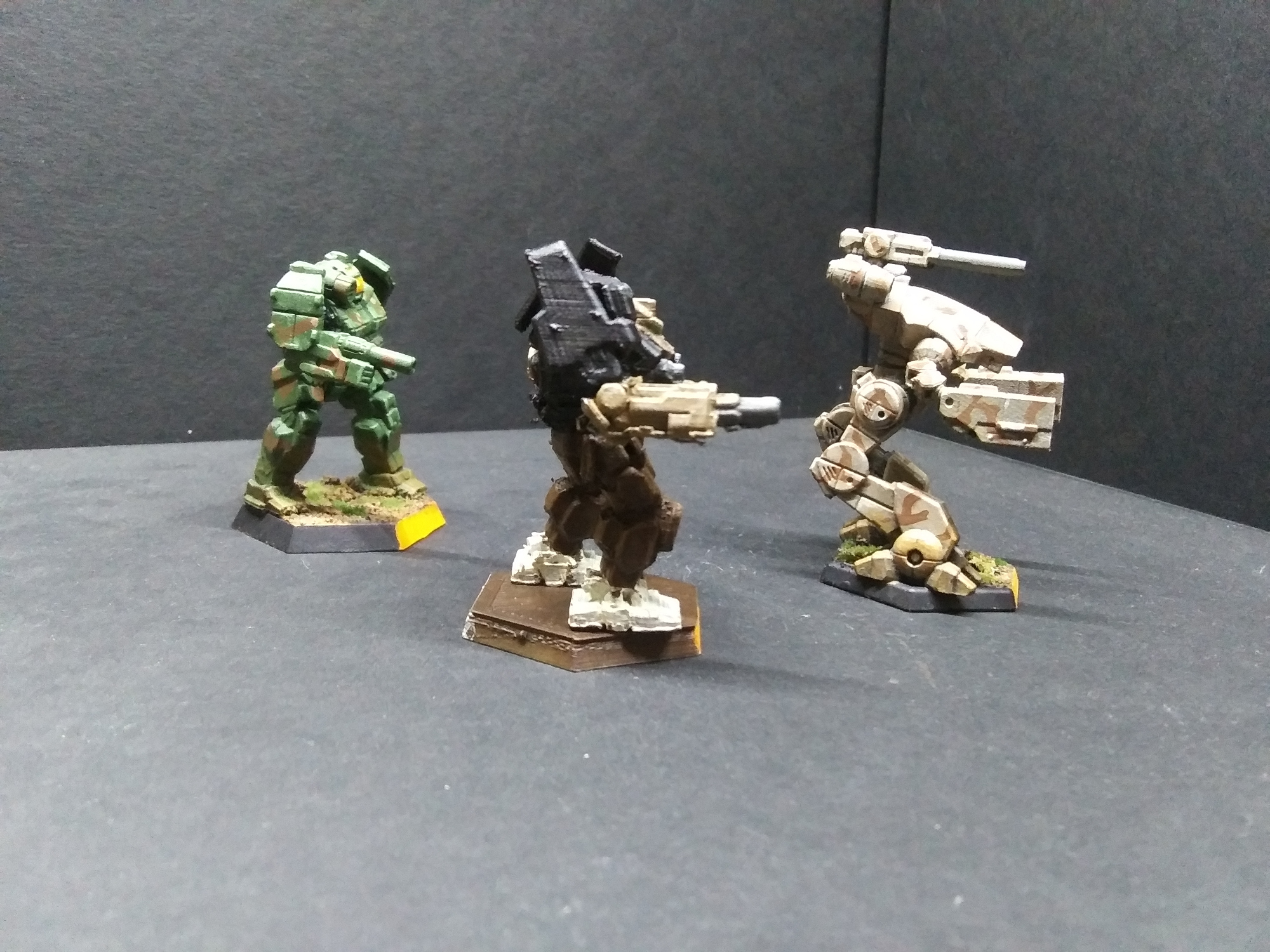

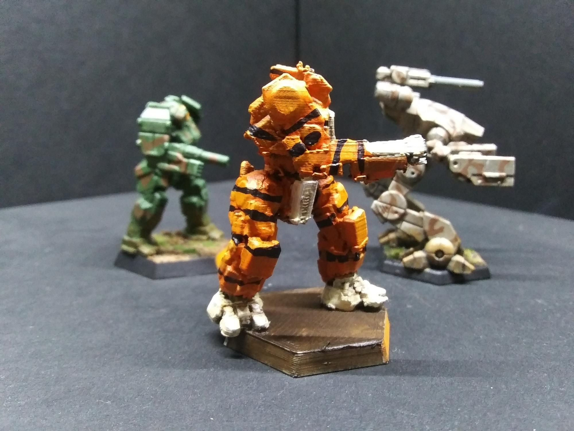

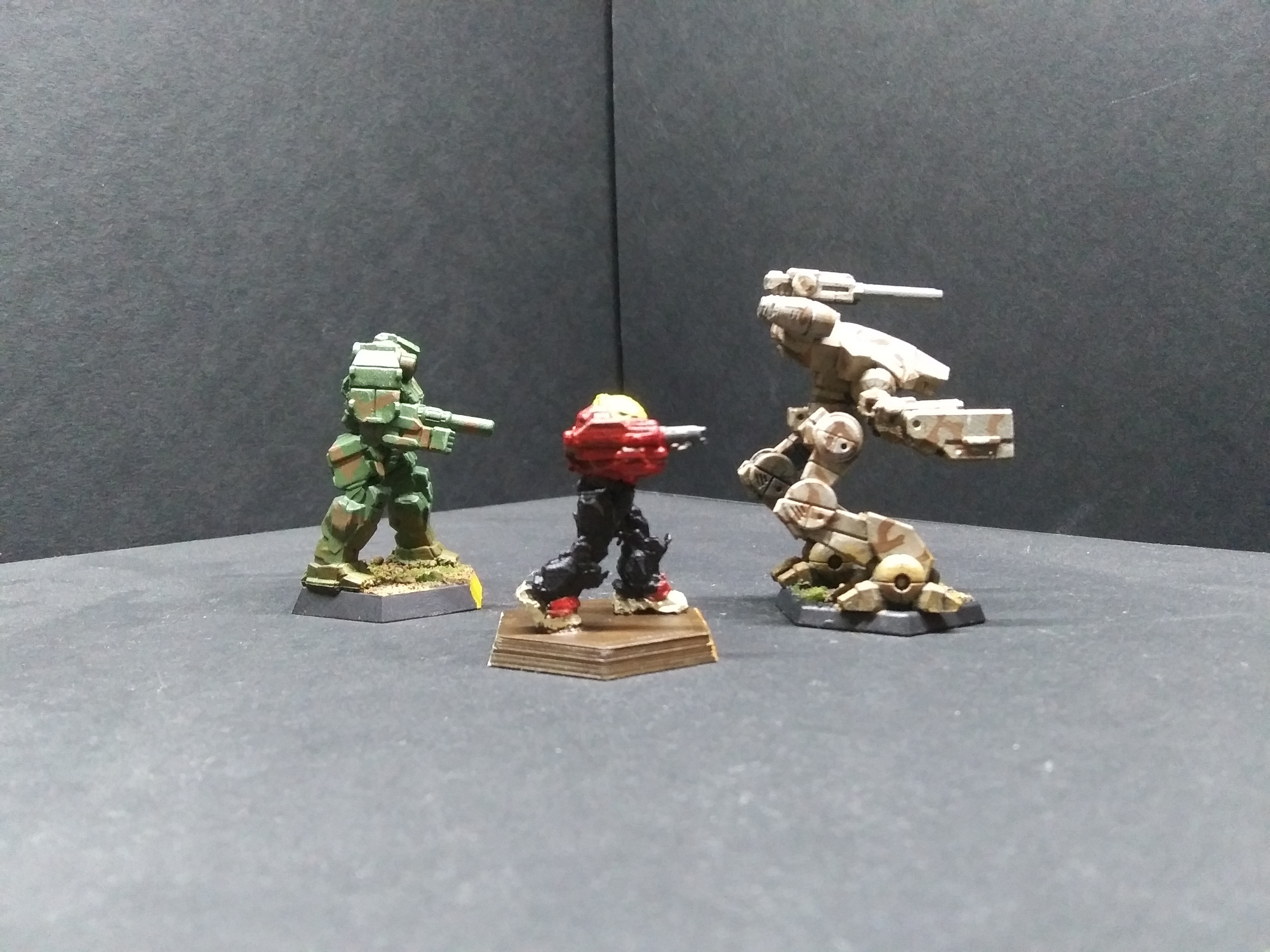

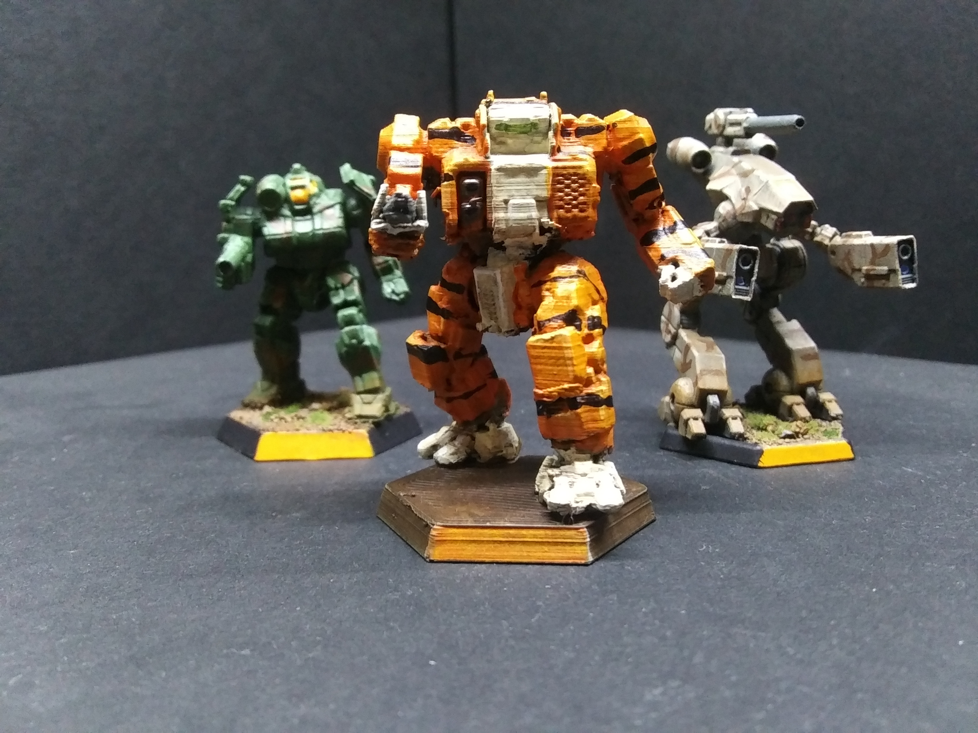

Here we go, a quick break down of each mech. 3D printed mech is between a CGL injected molded Griffin and a Stratos Minis resin "Bullshark" (counts as Maurader)

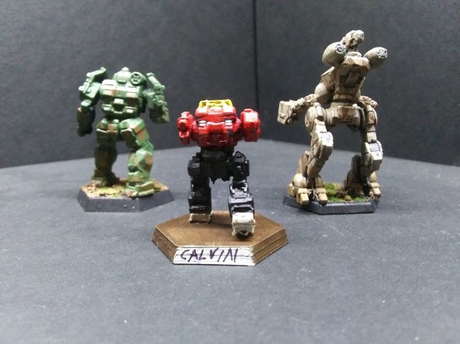

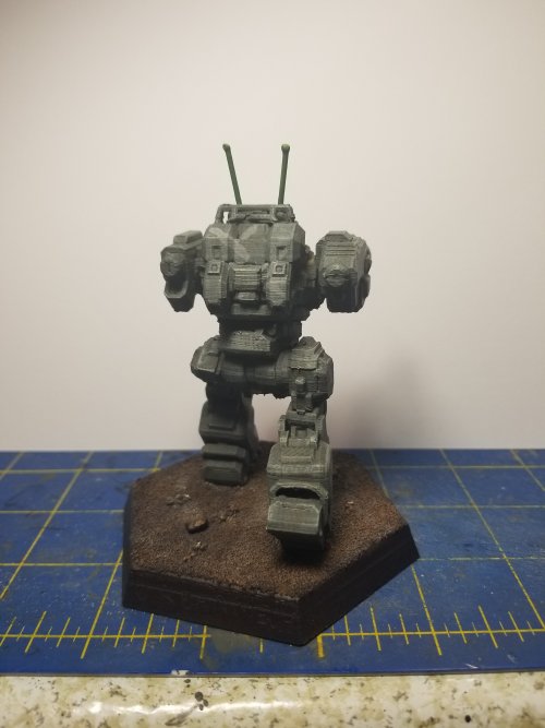

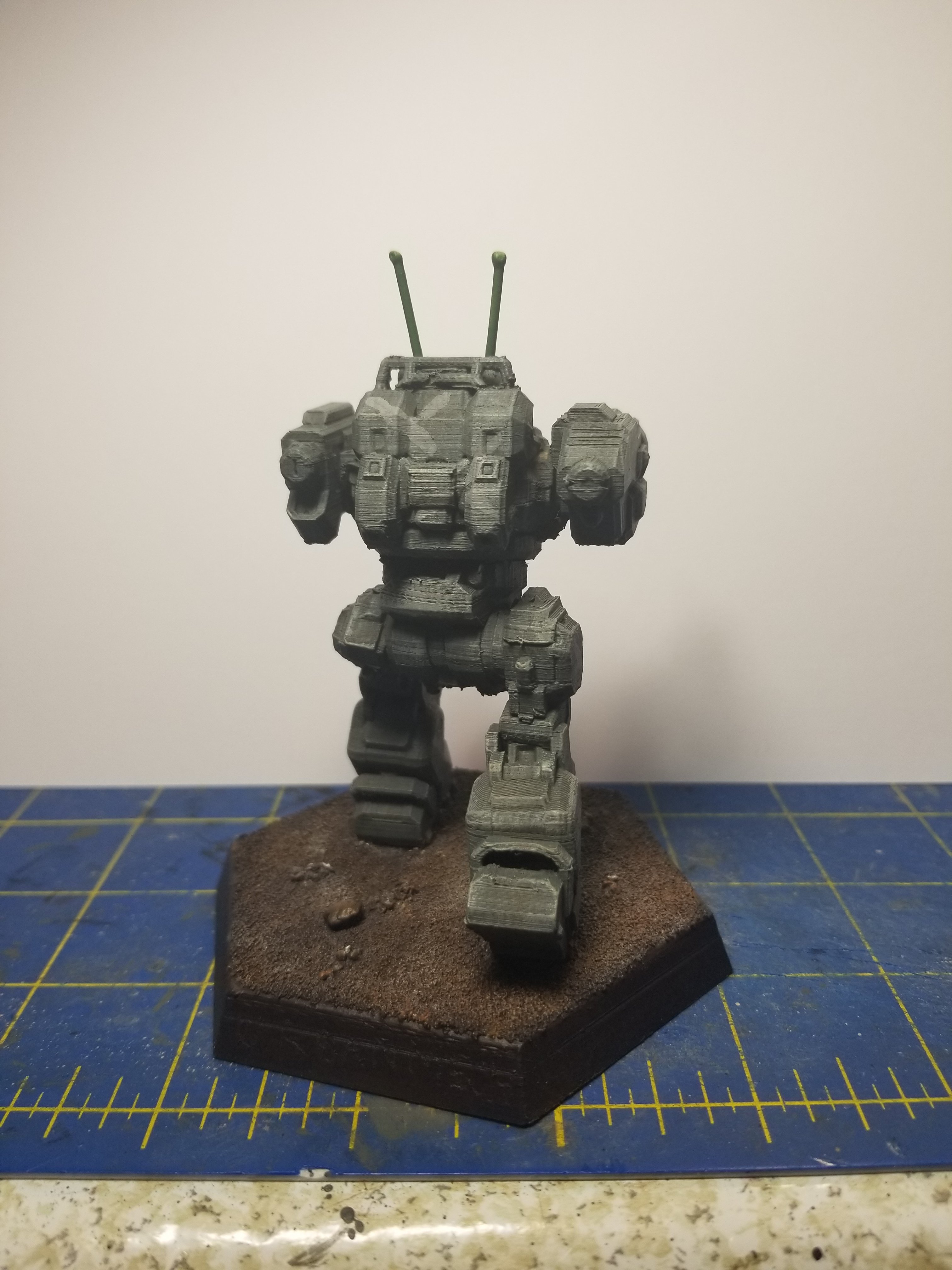

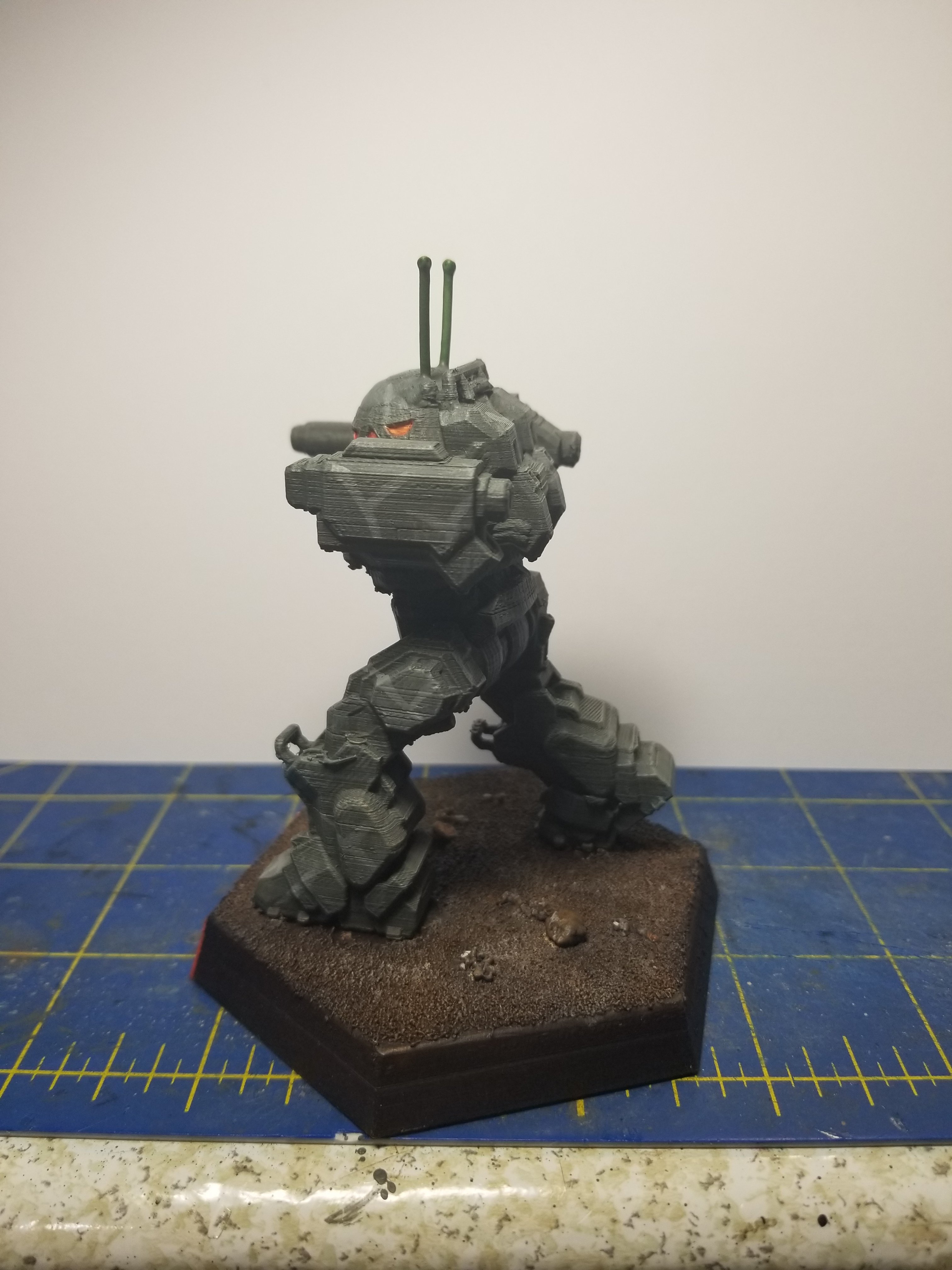

Calvin, Urbanmech:
Hobbes, Highlander:
Suzie, Blackjack:

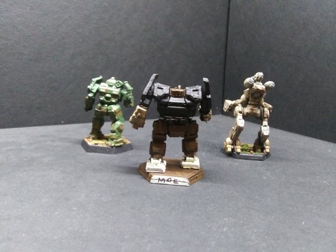

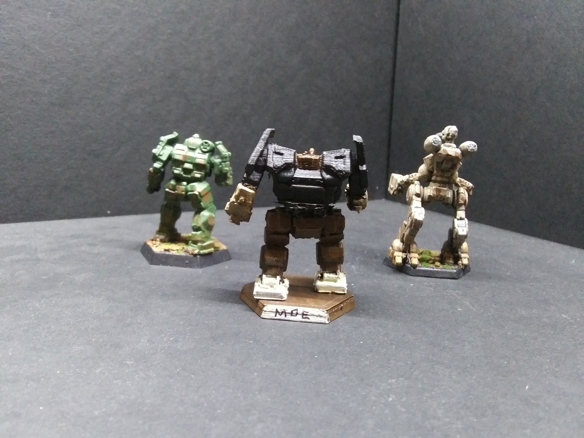

Moe, Awesome:

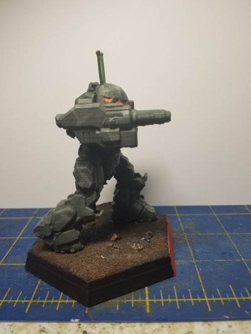

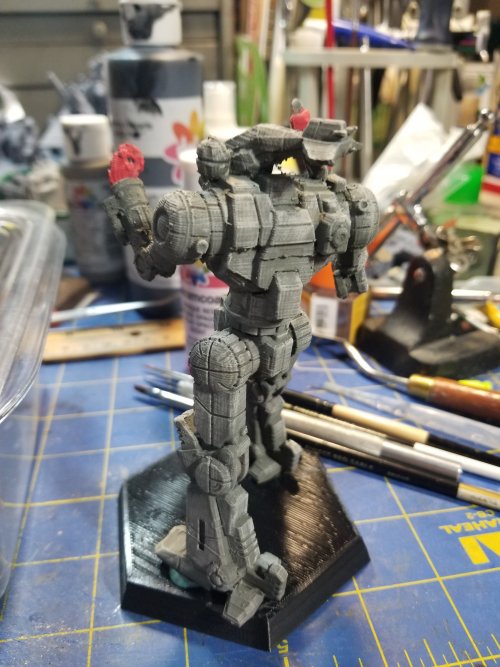

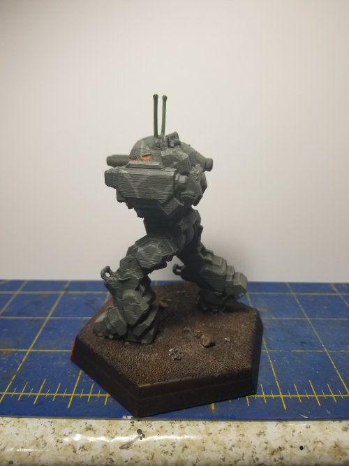

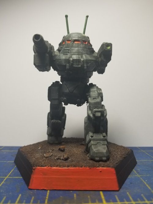

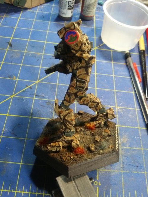

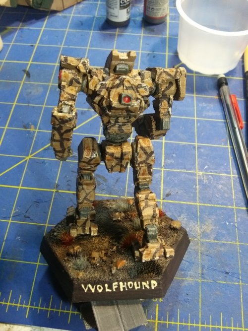

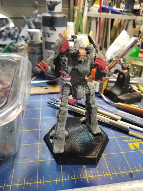

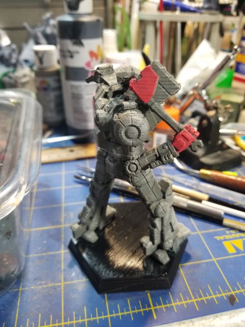

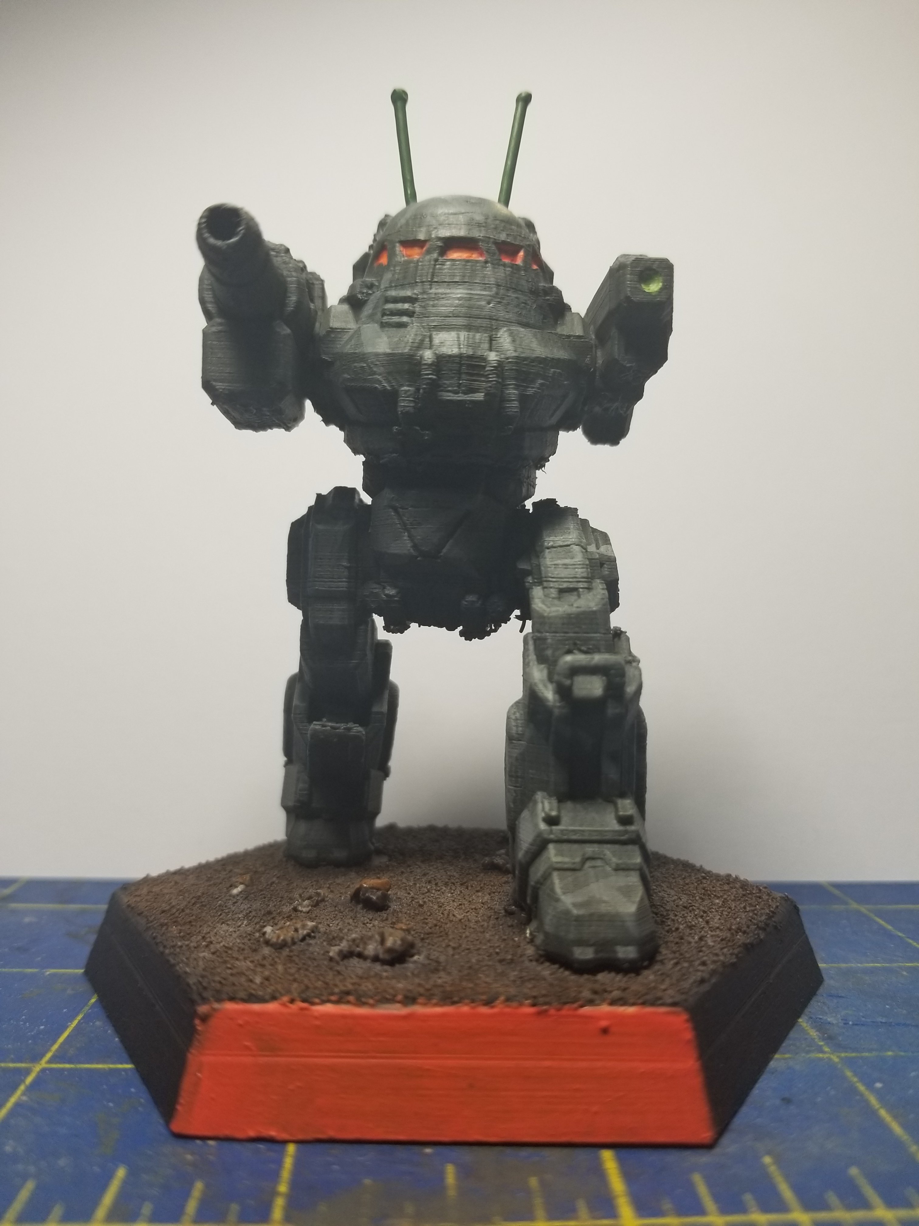

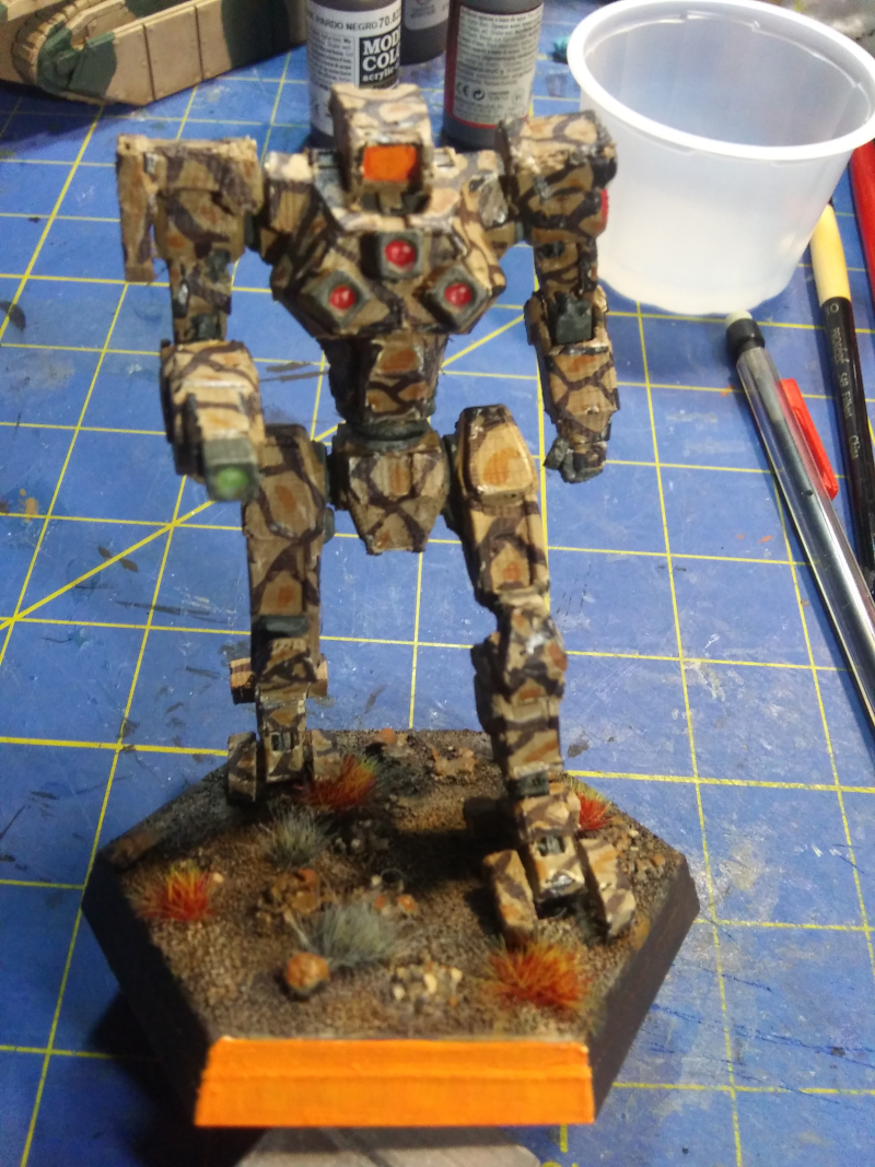

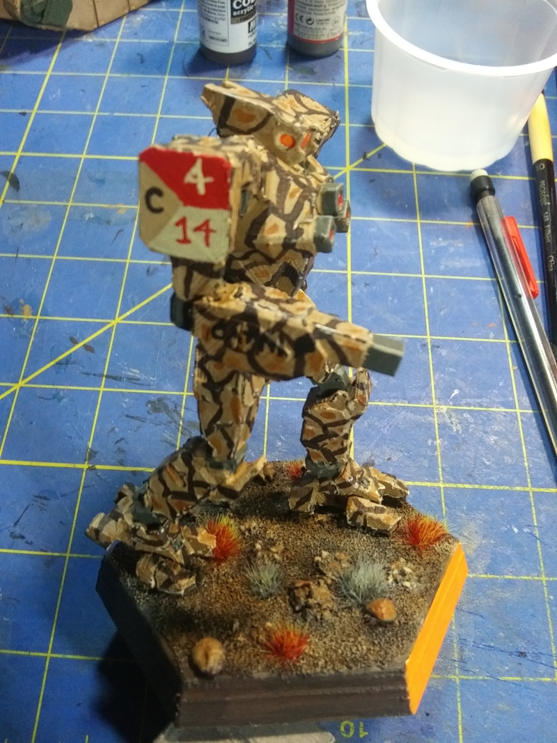

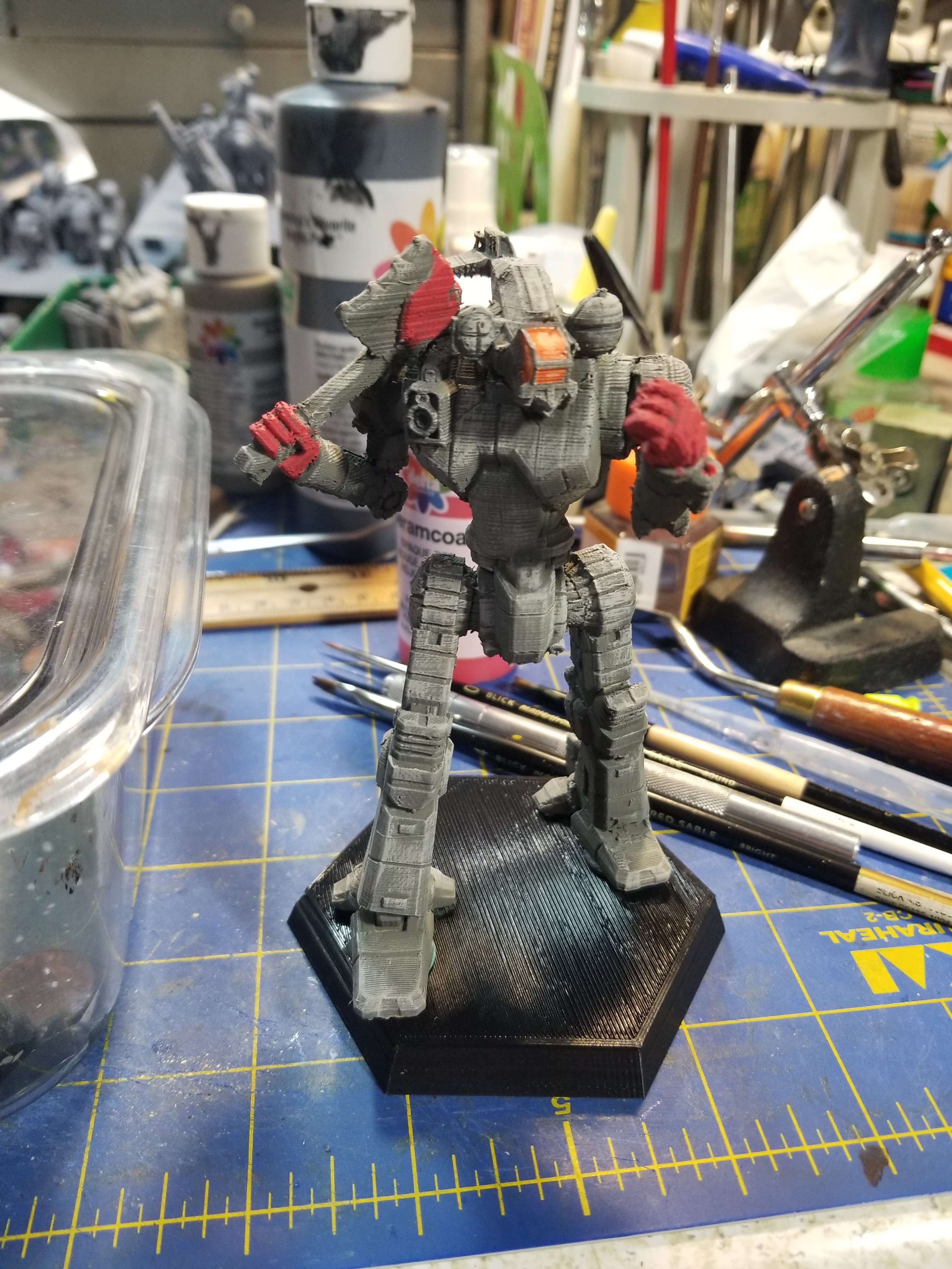

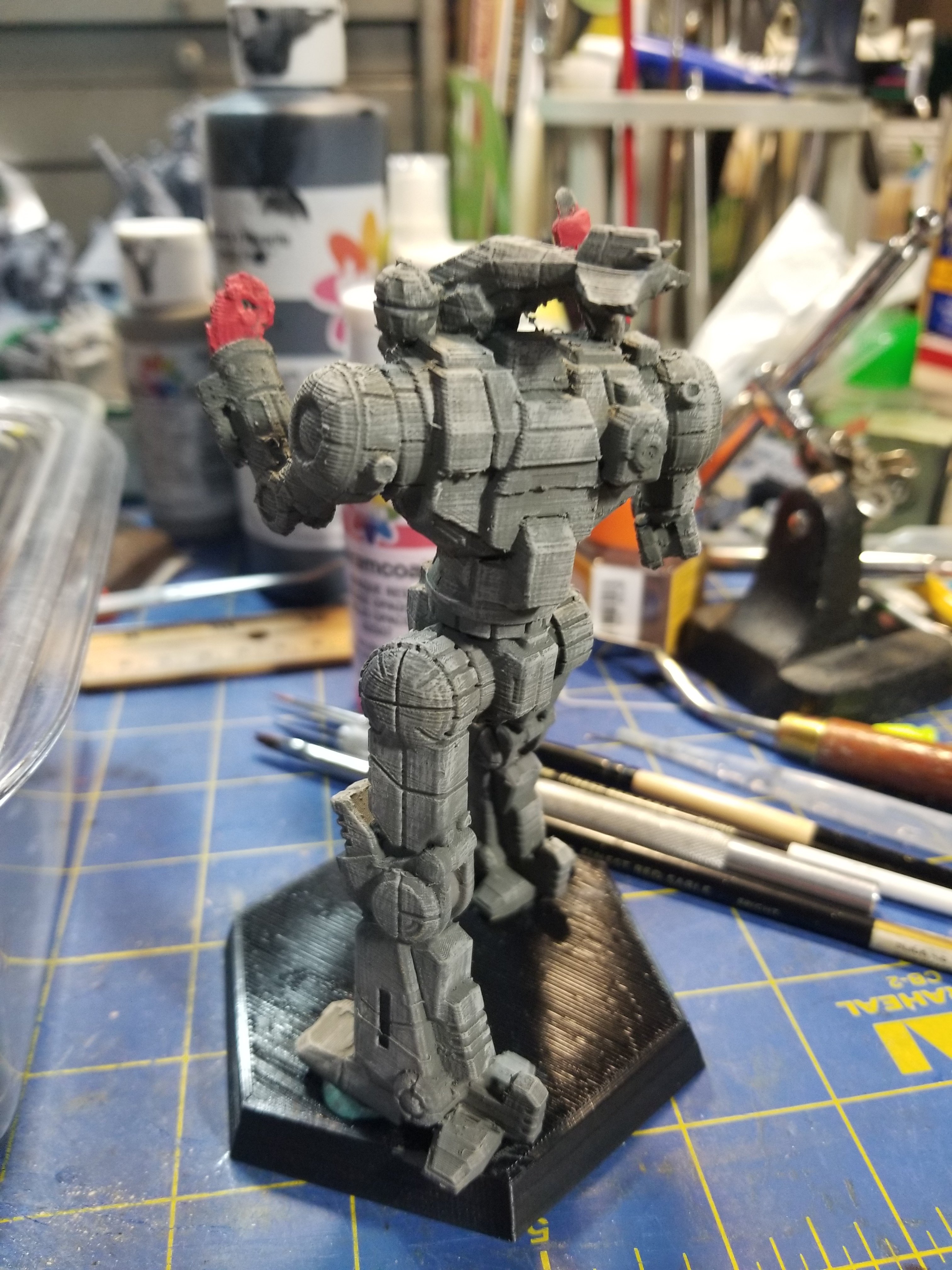

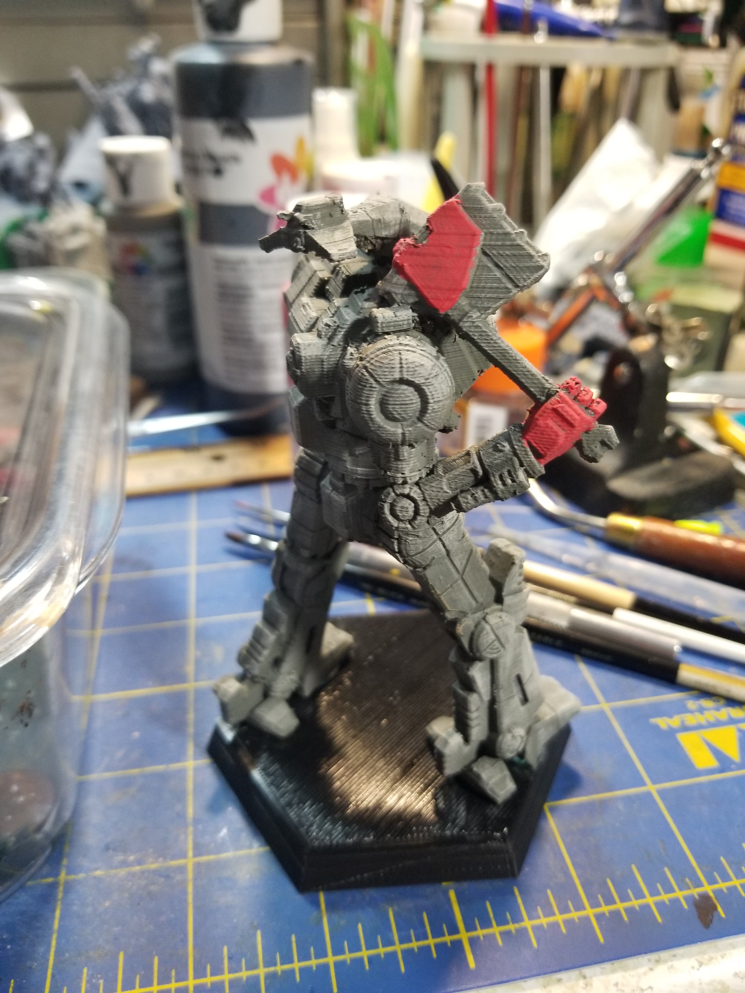

Quick update on my, as yet, unfinished 15mm 3D printed Mechs... Namely, the Hatchetman...errr.... Tinman! My aftermarket Stratos Minis STL scaled up from 6mm to 15mm scale has finally been painted! Well, mostly. I might refine this a bit. Or not. I'll sleep on it.
I might, or might not, add some more to the urban camo here. Red hands, because, yeah, Clans hate melee and this was an Inner Sphere mech made just for that purpose, in urban environments.

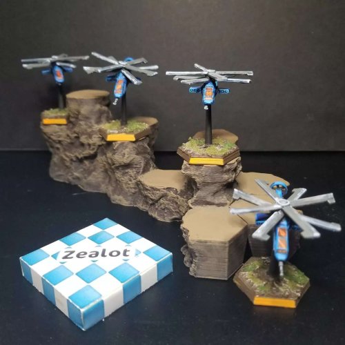

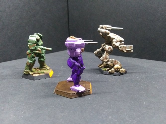

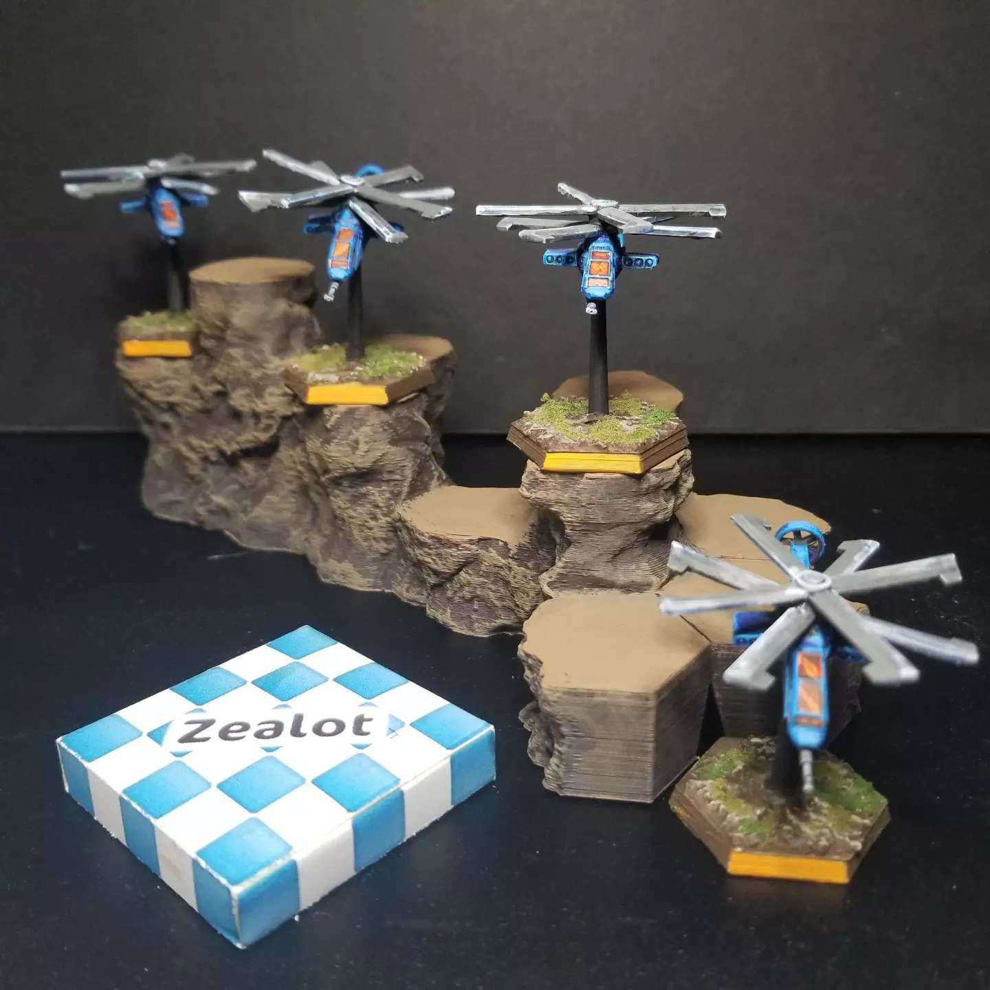

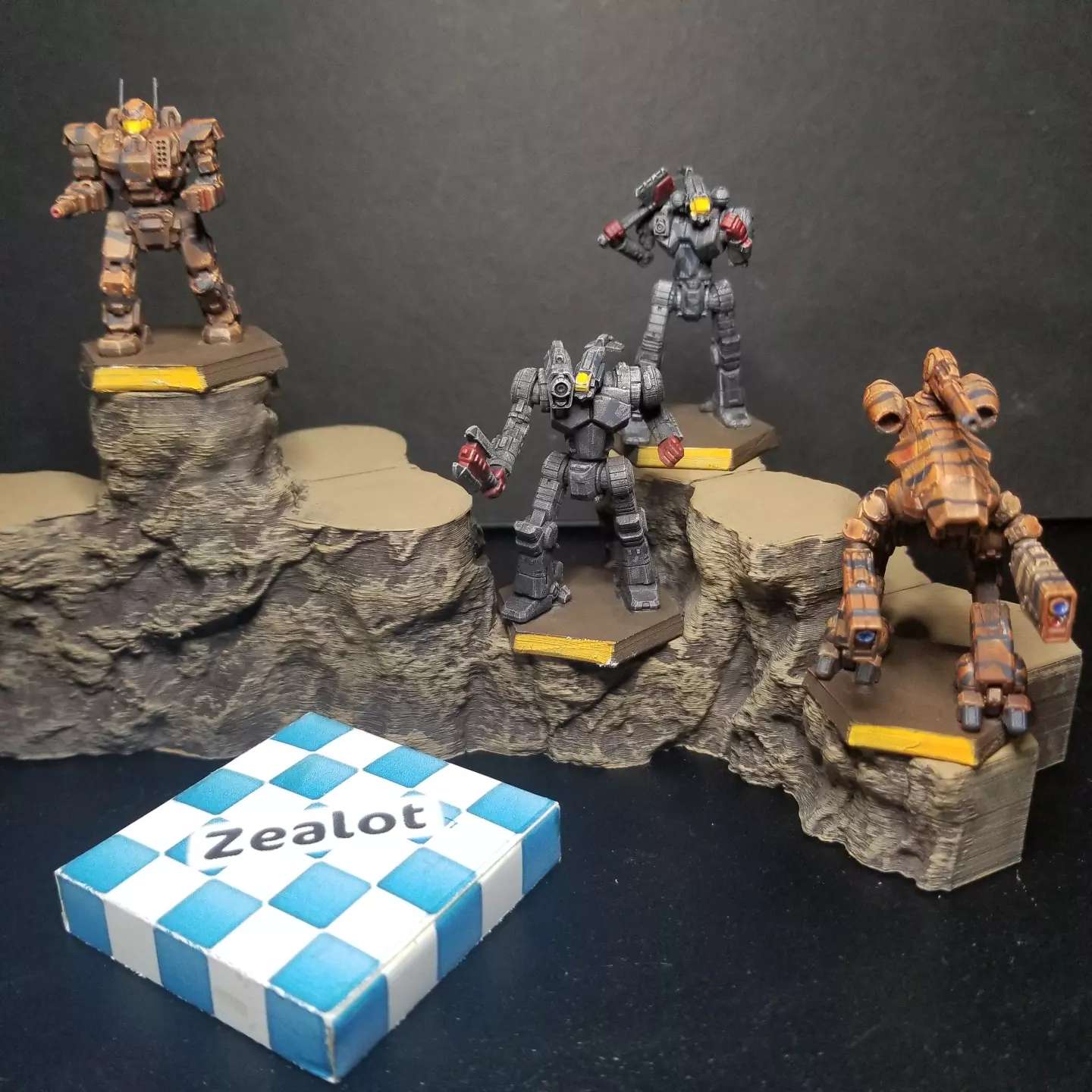

So, I've NOT fallen off the face of the Earth (yet), but I did get sucked into Battletech even more this year with my 3D printer(s). Resin one might be down, but I ended up creating quite the painting backlog that I've been working on since. Some of the last models the Elegoo printed were these mechs and helicopters:
My "Mudgobber" flight (hills are Hex Tech 3D printed on the FDM printer.

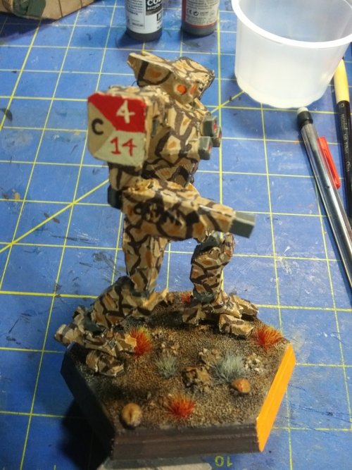

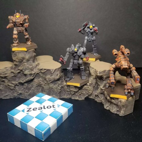

And my tiger lance with a couple urban fighters.

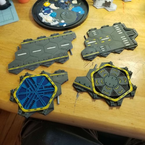

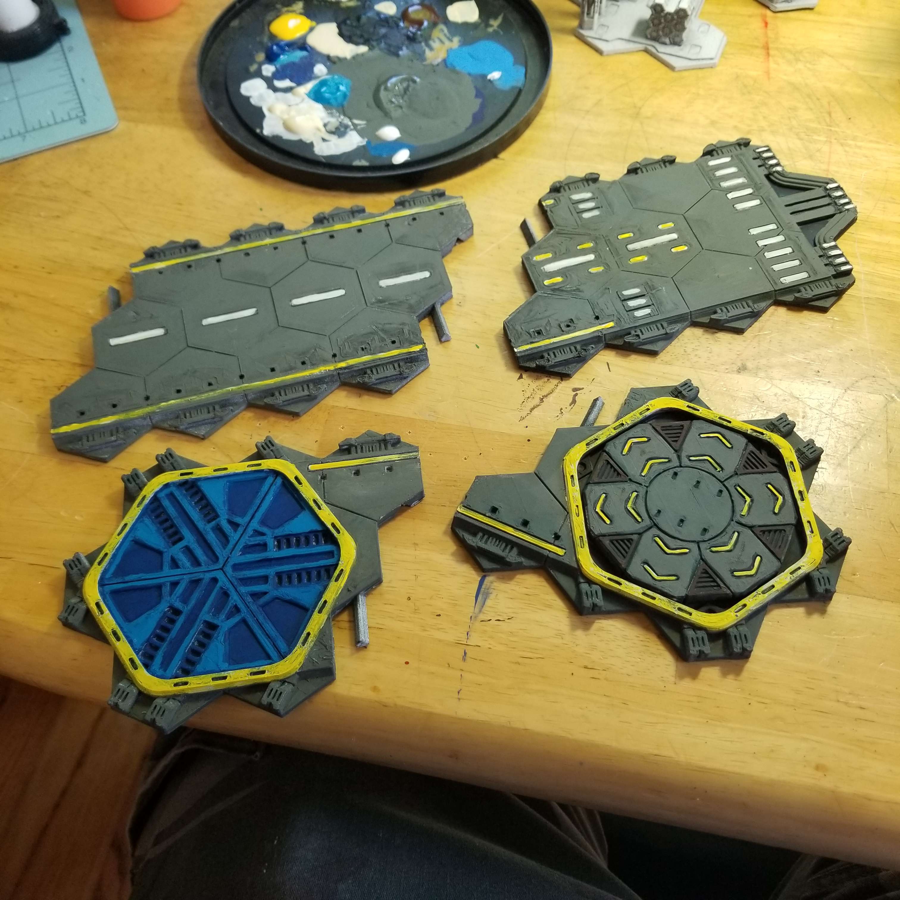

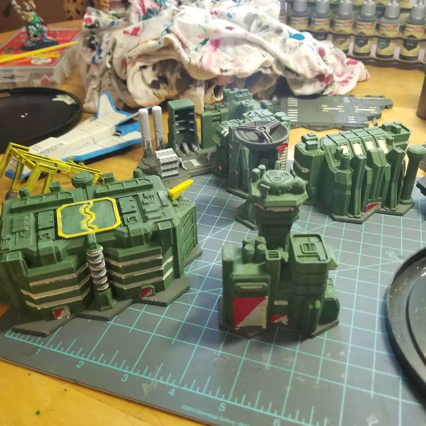

Also, the FDM has been nocking out loads of hex tech terrain which I've been painting like these fighter elevators and tarmac.

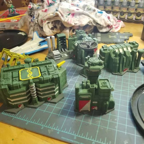

As well as some FOB buildings (yes, it must belong to a Cavalry unit... How can you tell?).

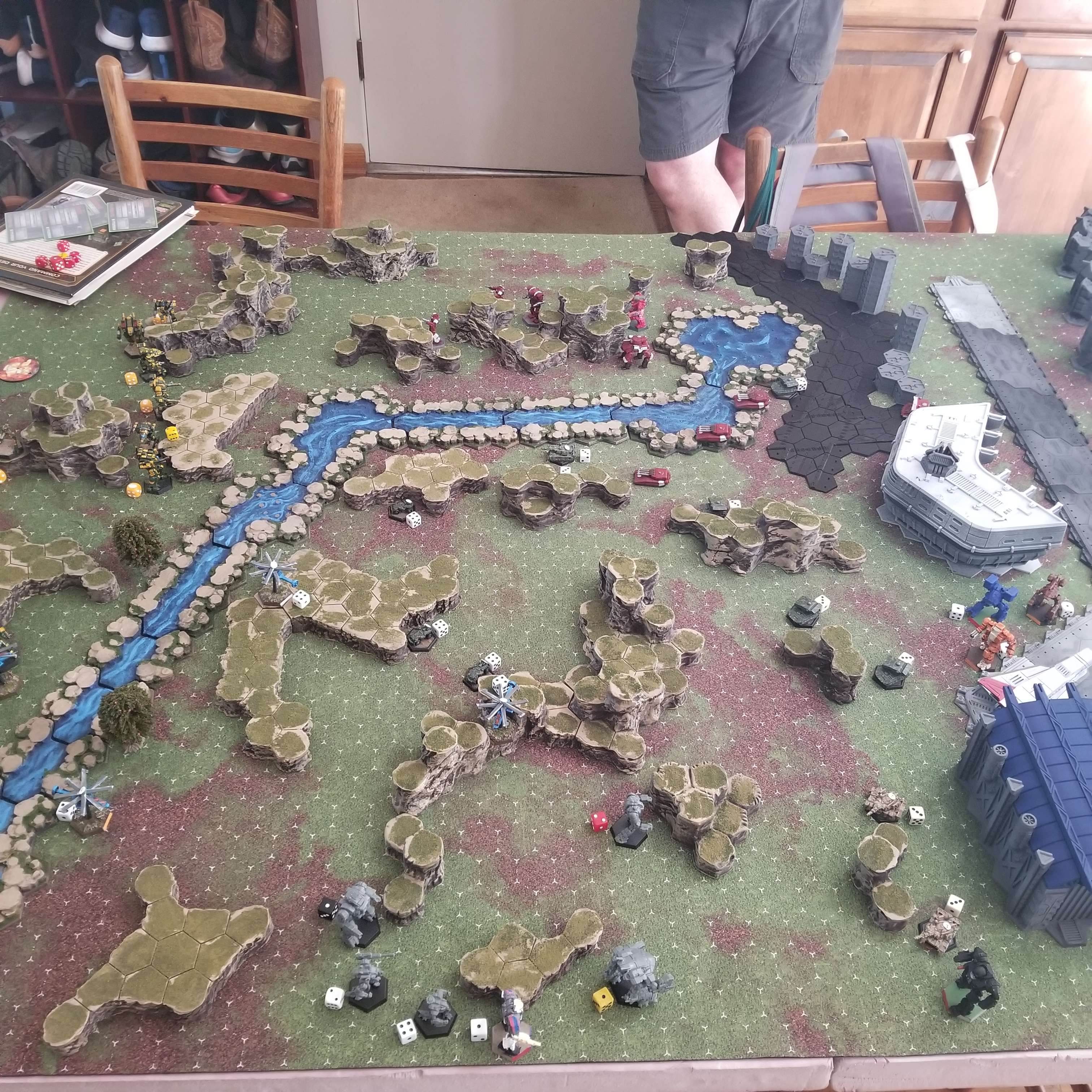

Finally, this is what all the effort looks like in action on our dining room table. I have this wonderful mousepad material hex map, and the hex tech looks beautiful on it along with all the 3D printed and official models.

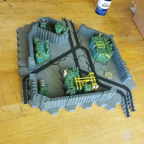

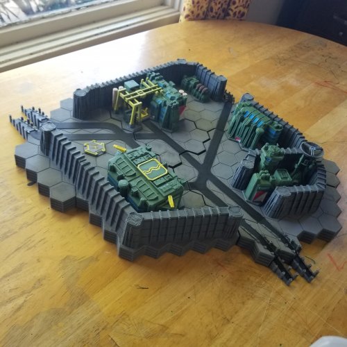

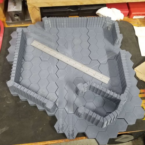

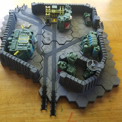

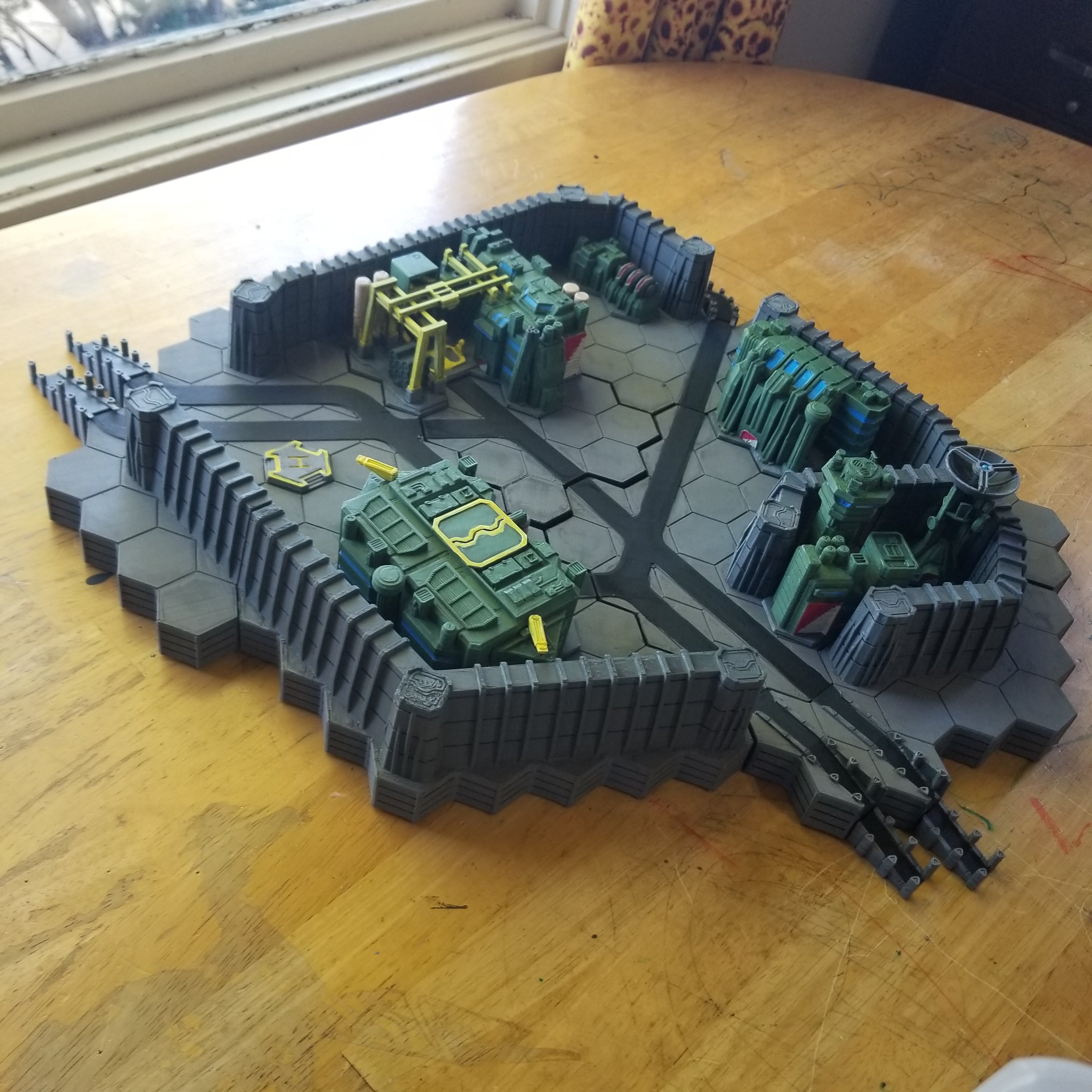

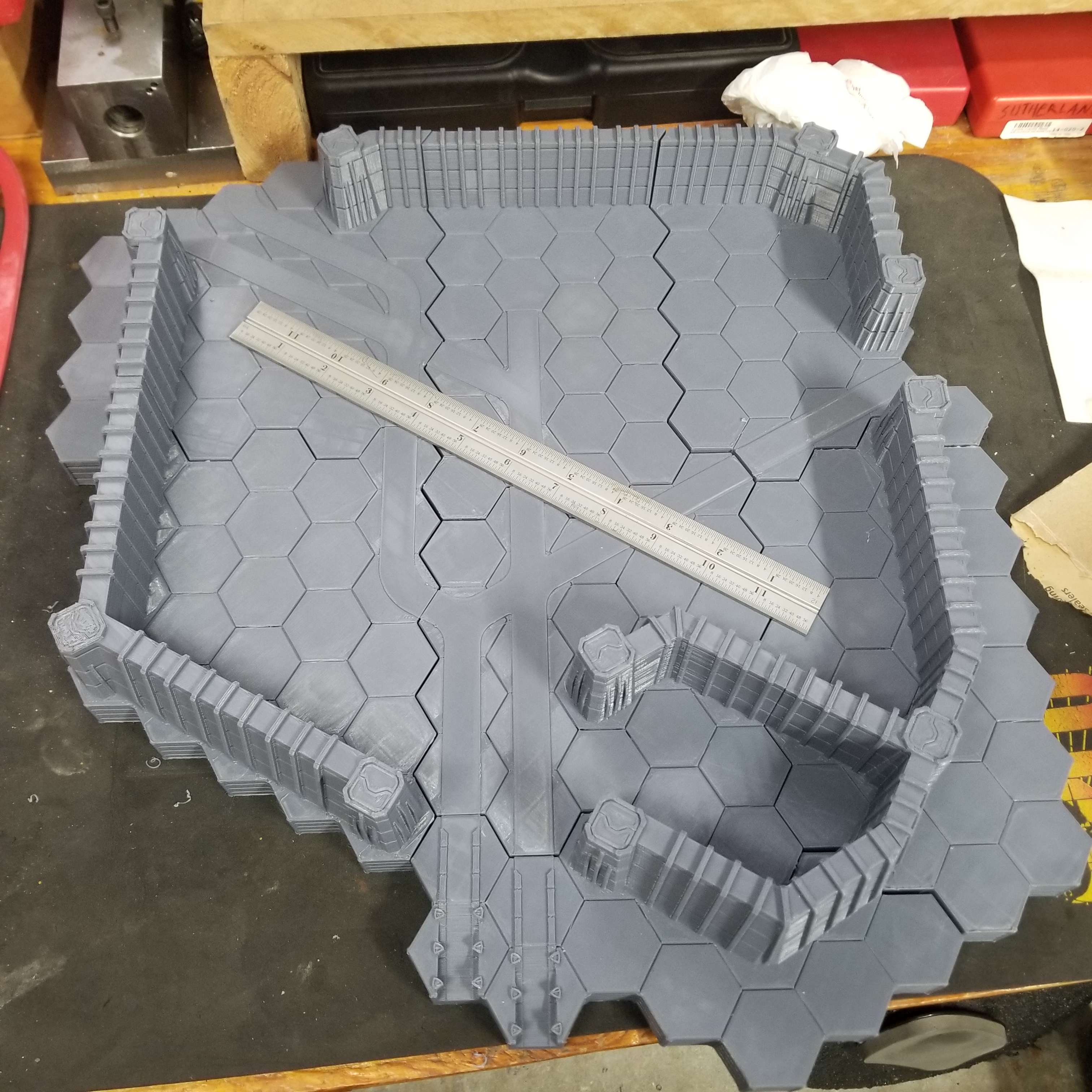

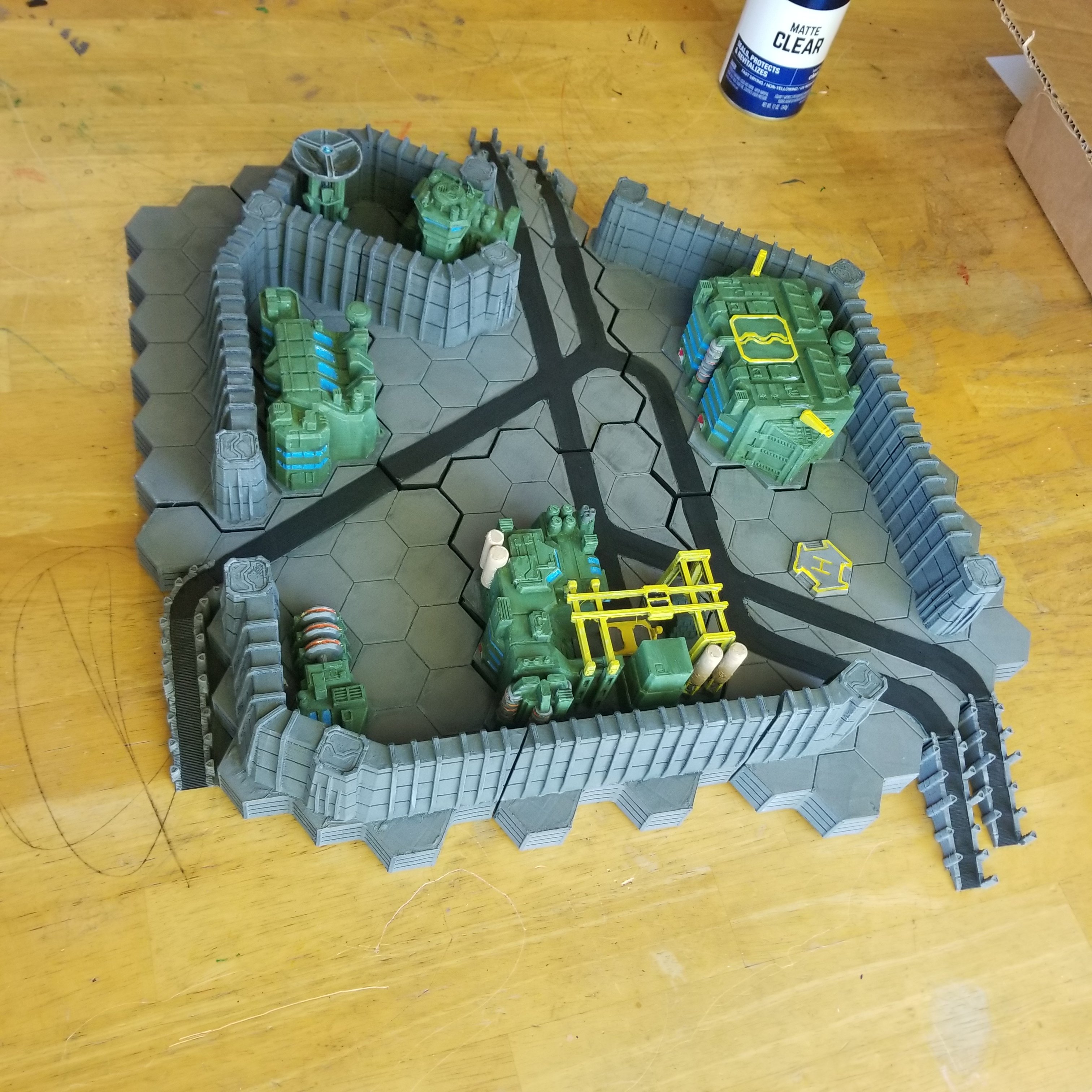

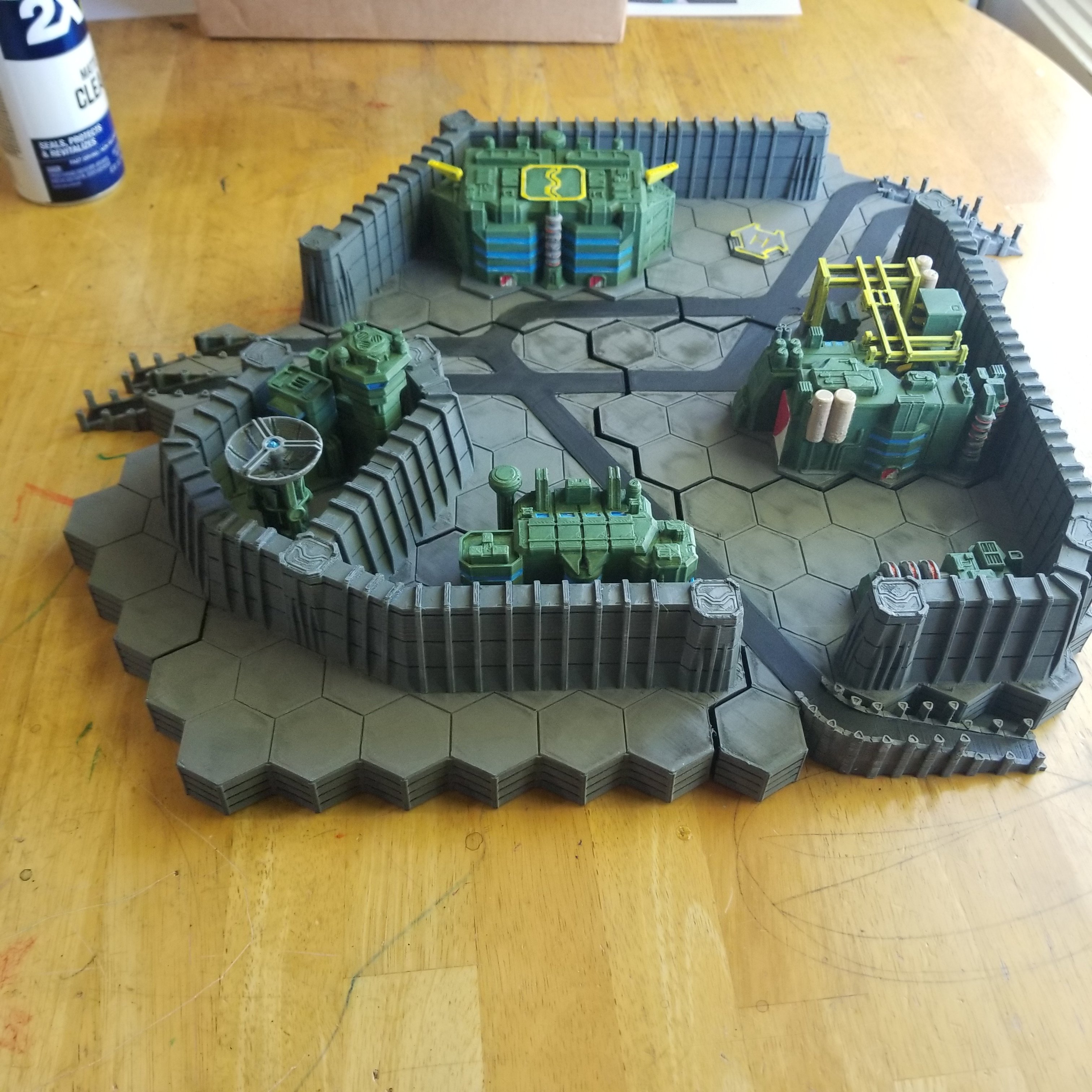

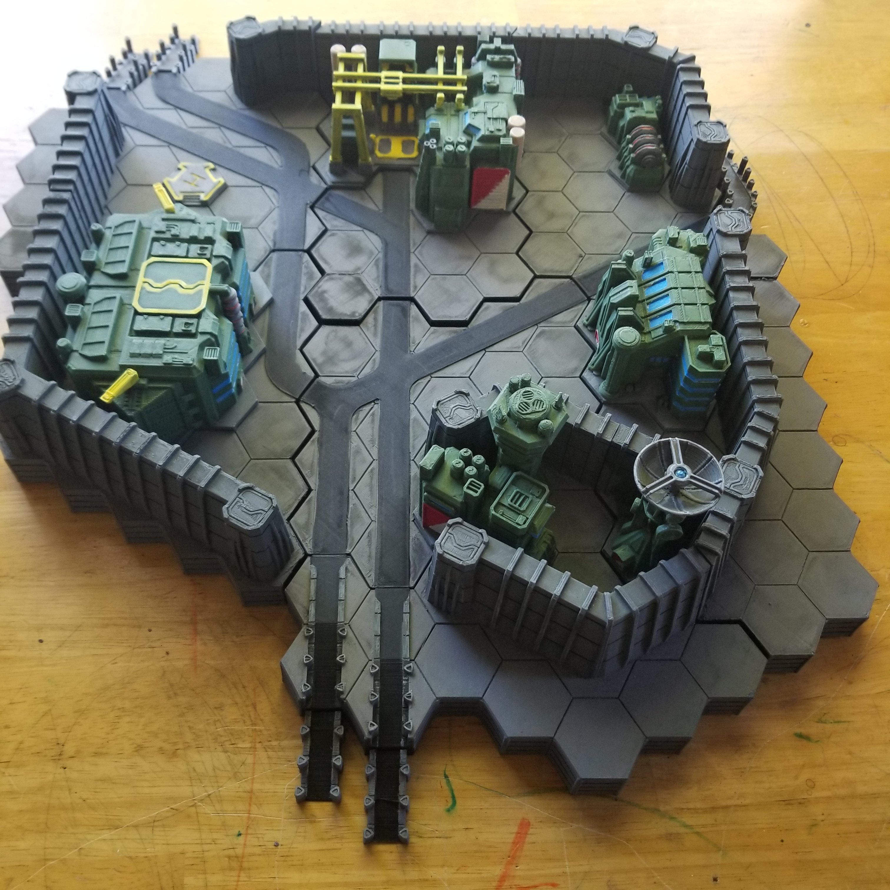

The FOB those green CAV buildings will go into... Well, it was a few kilos of PLA (including the structures)! It's a beast!

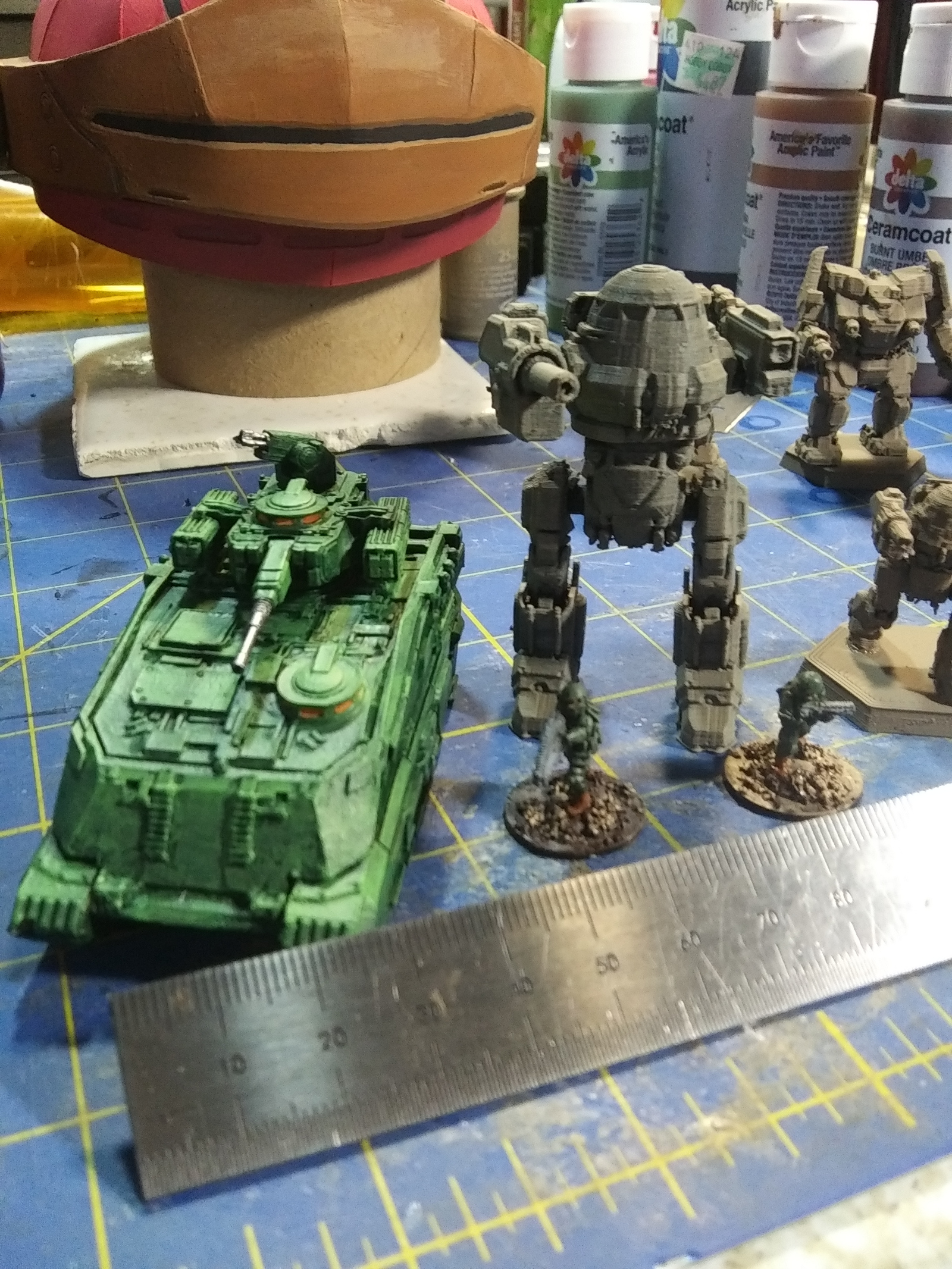

My 12" (300mm) ruler for scale. Had to go to my garage to lay it out, didn't have enough room on the hobby bench for it setup! Needless to say, this will dominate a table top.

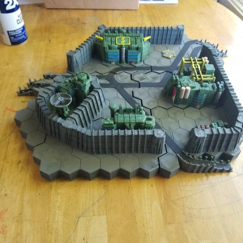

Every battle needs an objective! This is my months long 3D printing and painting project of the Thunderhead Studios Hextech Forward Operating Base. A mighty objective to defend or seize! I estimate about 2-3 kilos of PLA went into the foundation/walls, and buildings. Four rolls likely because I pinted other stuff in between parts for this.
