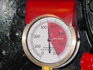

ALSO, DOSE ANYONE KNOW WERE I MIGHT FIND A GOOD CLOSE UP PICTURE OF A STEAM PREASURE GAUGE. ONE I COULD POSSIBLLY DOWN LOAD AND MAKE A DECAL OF.
