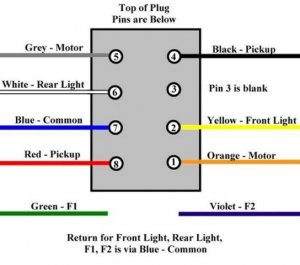

If you hardwire any decoder to the oil-electric, make sure you modify or, better yet, throw away the dummy plug and the lightboard! Pin 3 is connected to Pin 7 on the plug which will short the headlights and blow the decoder - or at least the light function part of the decoder.

Here's the pinouts for the NMRA 8-pin plug. You will note that Pin 3 is blank. On the Bachmann dummy plug, there is a solder-trace that connects Pin 3 to Pin 7. With the present circuitry on the PC board, this will cause a short which travels down Pin 7 back to the decoder.
A word of caution - ALWAYS trace the circuitry BEFORE you install the decoder and satisfy yourself that everything is okay.
