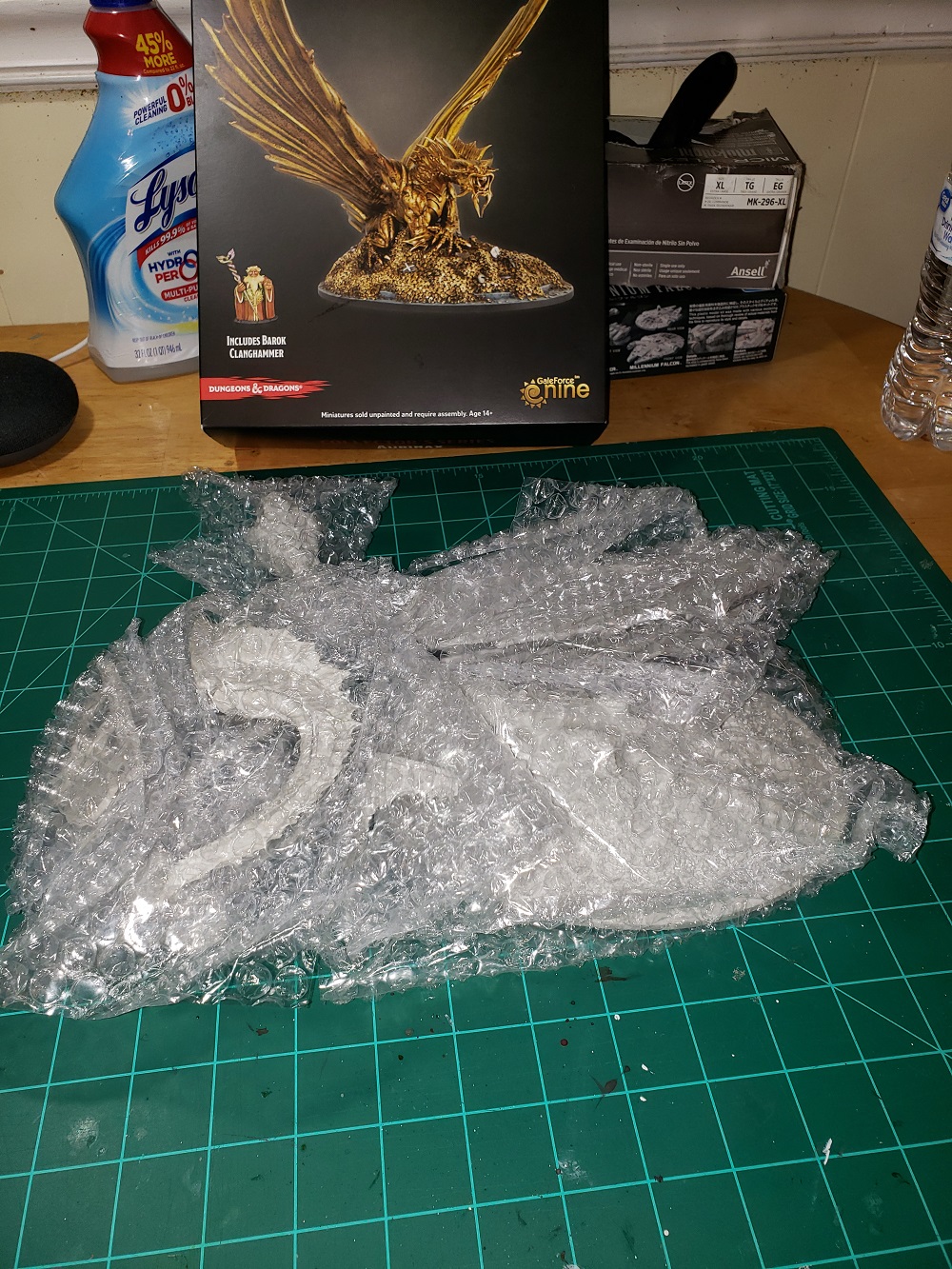

all the parts of the kit in thier "protective" bubble wrap.

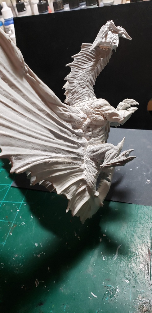

The main body part, this will rest of the base, and all the other pieces will attach to this, it actually looks to be a pretty nice casting.

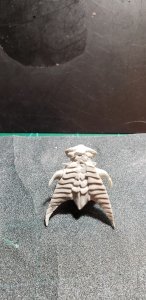

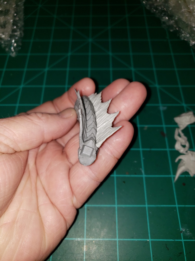

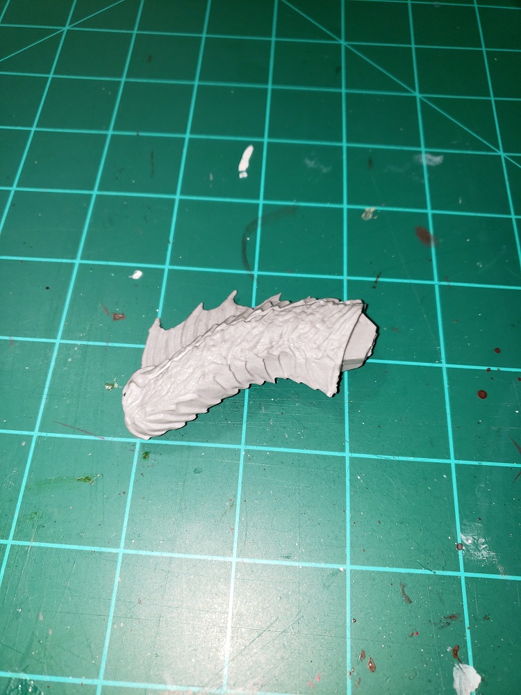

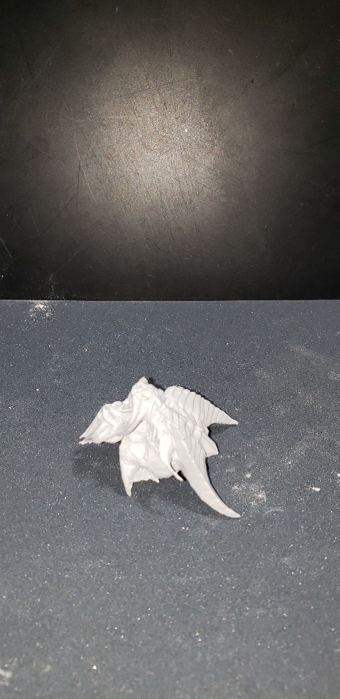

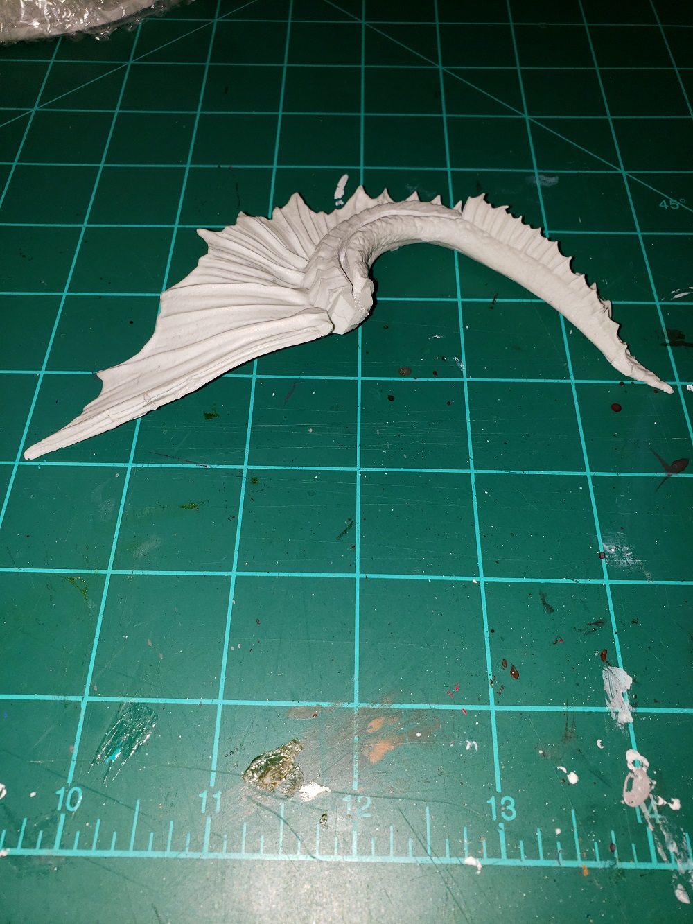

The back tail piece, with the left hand wing/fin attached, it dosent show in this pic, but the wing/fin is warped and will have to be straightened.

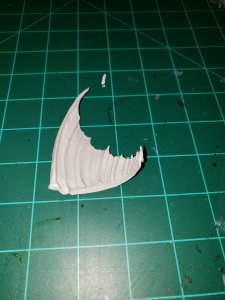

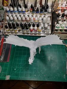

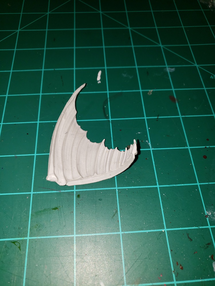

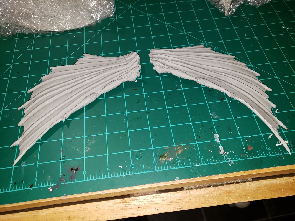

The main wings, these will attach to the upper shoulders of the body piece and to the front edges of the rear wing/fins

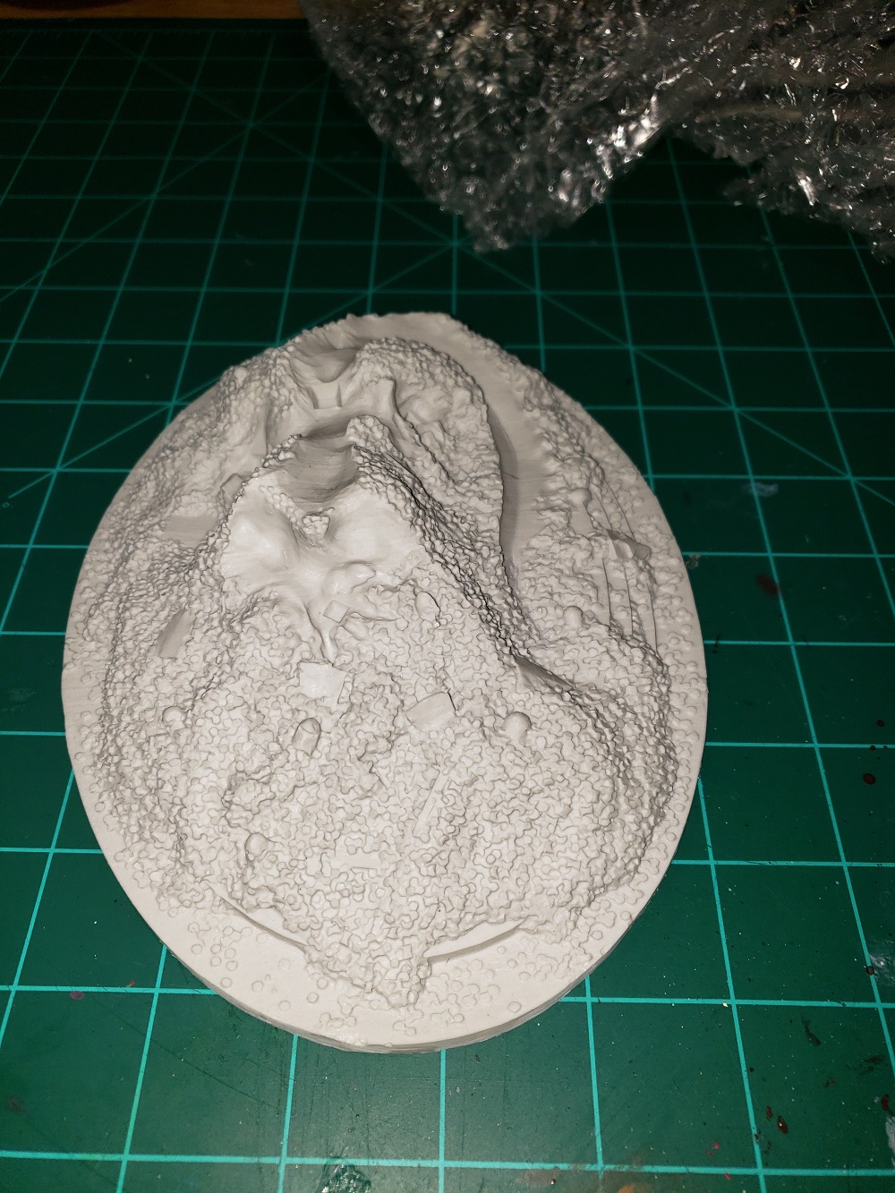

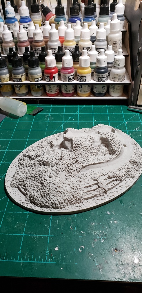

And the base piece it's cast to look lie a pile of treasure on a raised dais.

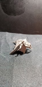

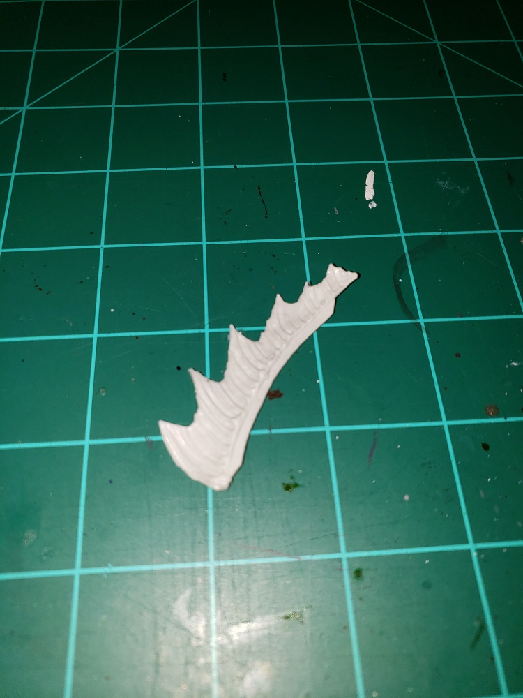

the right side rear tail wing/fin piece

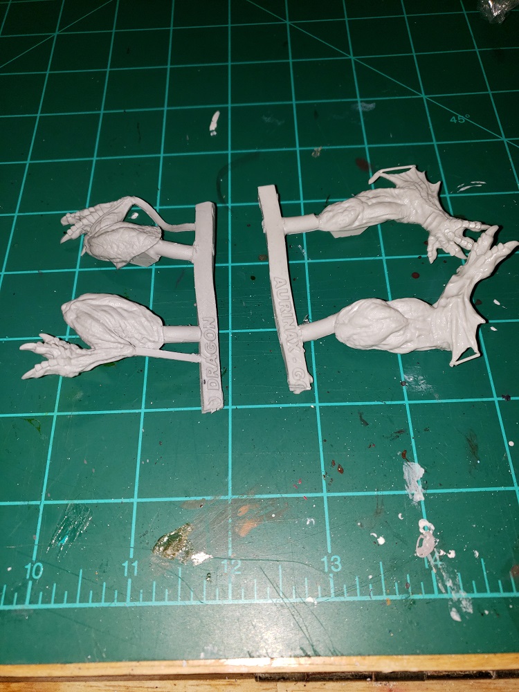

The legs, still attached to thier pour stubs...

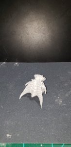

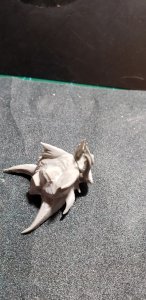

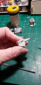

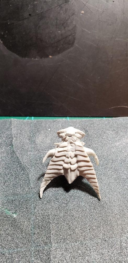

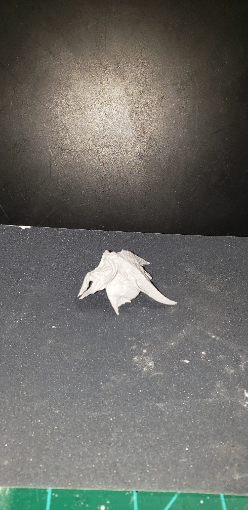

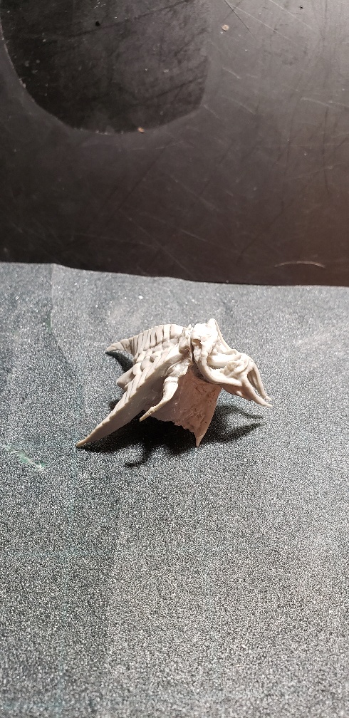

the neck with left side fin molded in

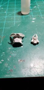

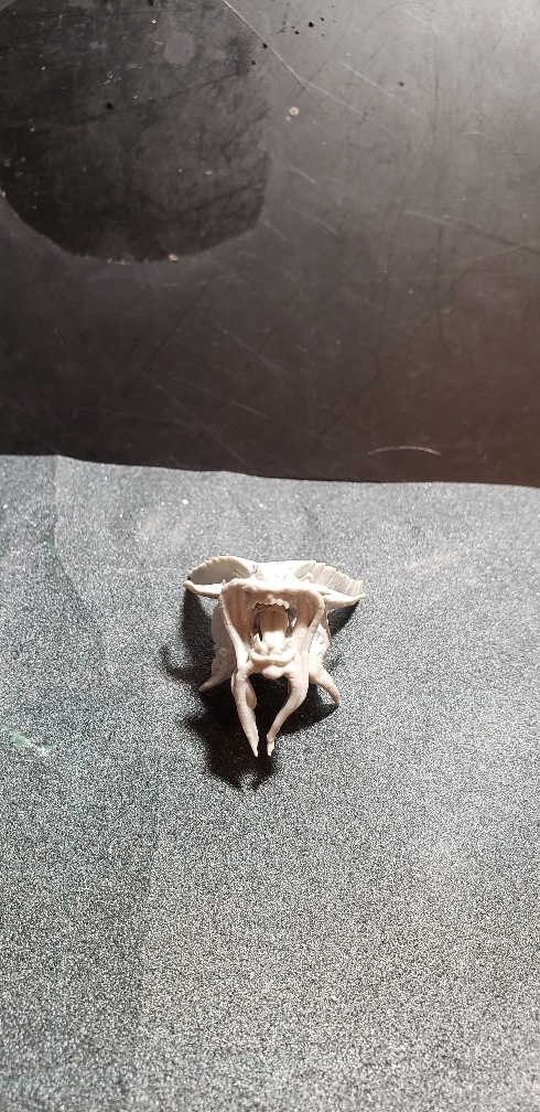

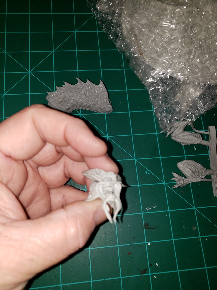

Three pieces that make up the head...

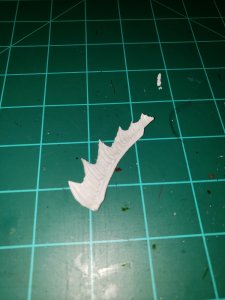

the right side neck fin

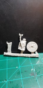

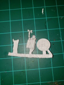

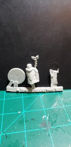

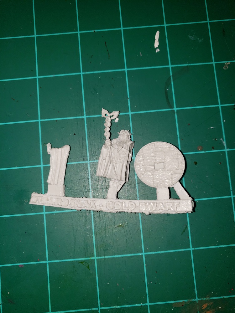

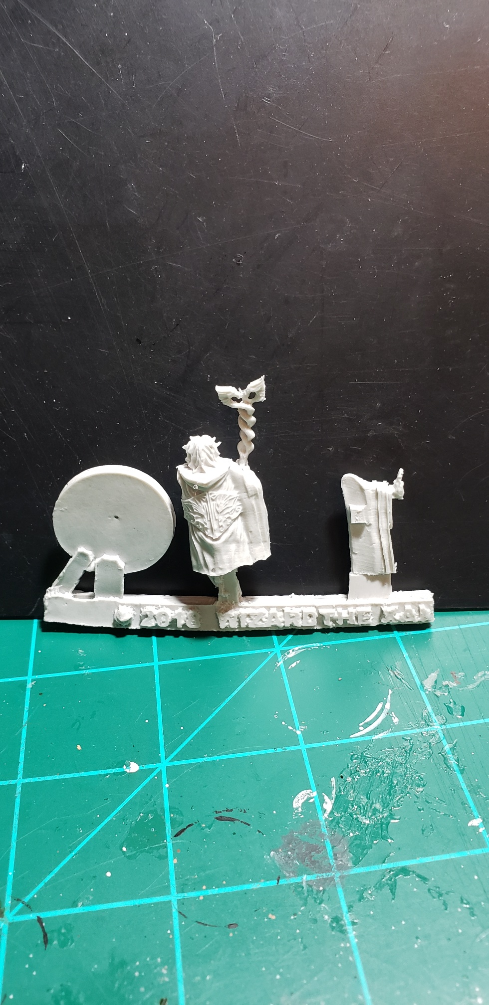

the gold dwarf, Barok Clanghammer, 2 pieces plus the base, still on the pour stub...
the neck with the separate right side fin in place... nor a bad fit...

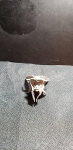

the three pieces that make up the head just held in place,.. this is gonna take some major work to turn into a nice looking head.

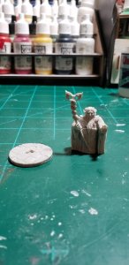

I am starting the build with Barok Clanghammer, Aurinax's polymorphed form of a Gold Dwarf priest.
I have to get used to working with resin again.

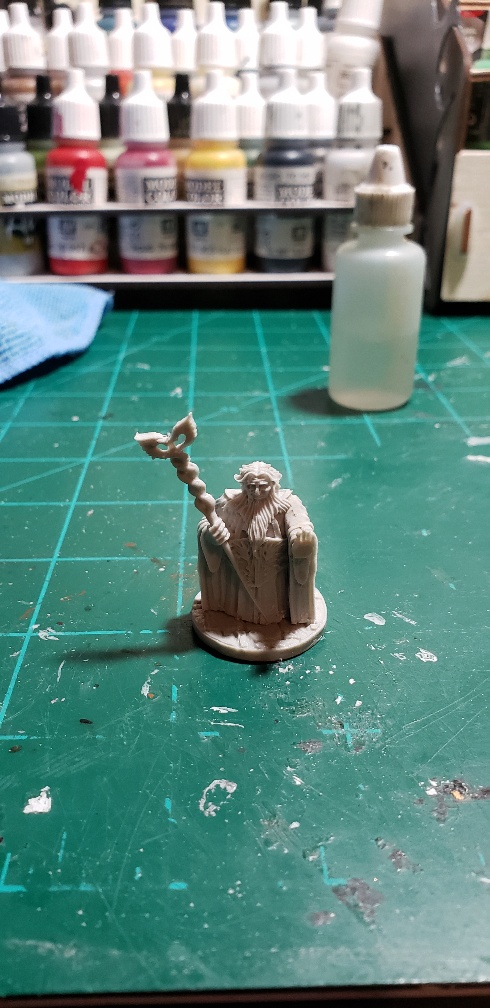

The first step was washing all the pieces with warm soapy water to get any mold release agent's off the resin. Next is to remove the pieces from the runner.

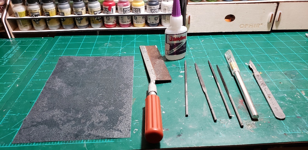

Tools used so far. My Really Old ExactO saw, Files, hobby knife and scalpel, CA glue, and sanding film.
I've got all the pieces for Barok Clanghammer off the pour stubs, and sanded ready to assemble.

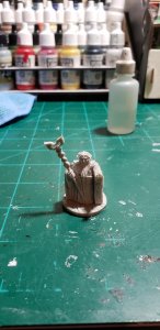

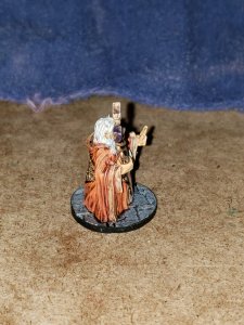

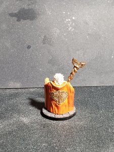

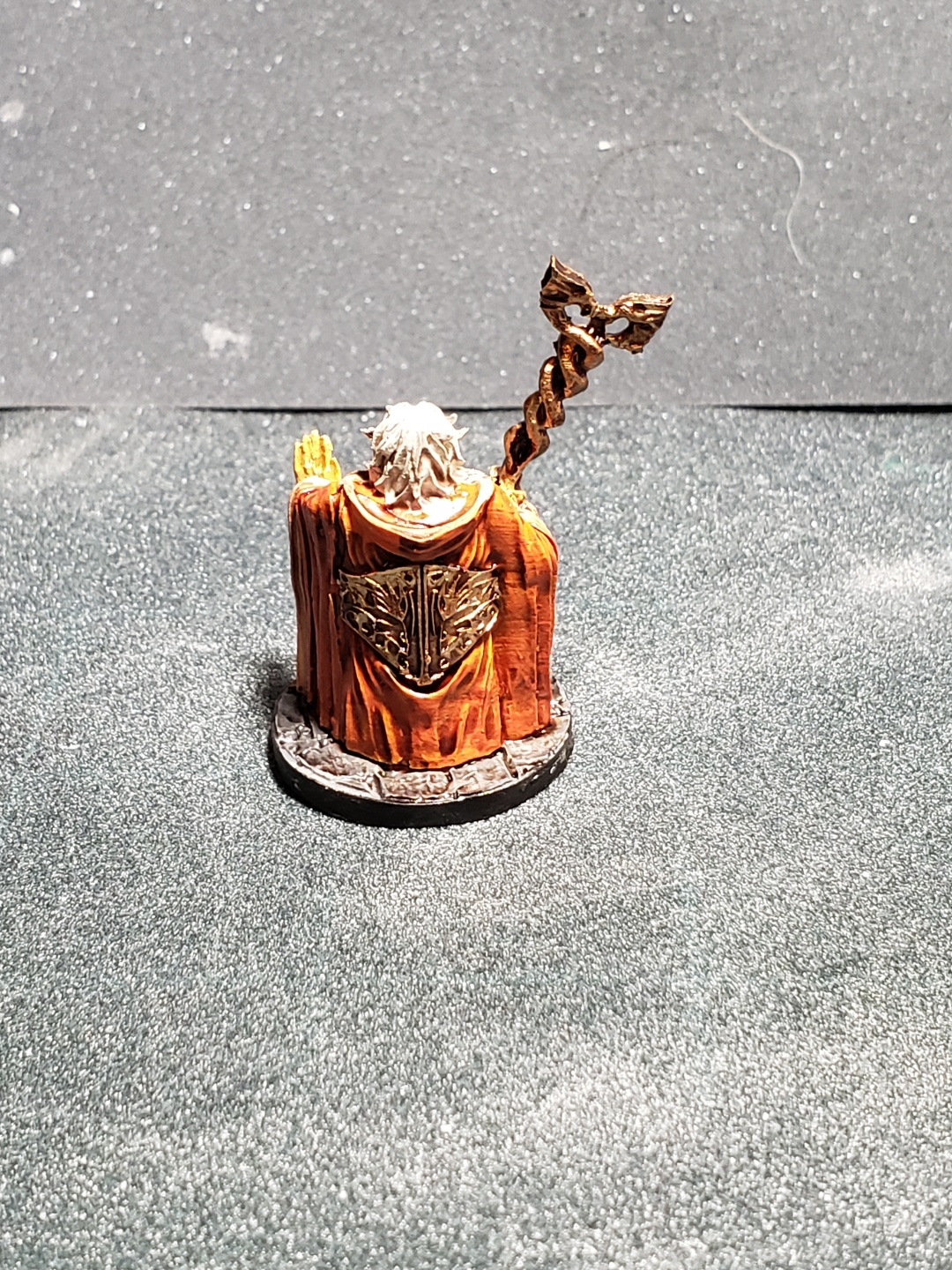

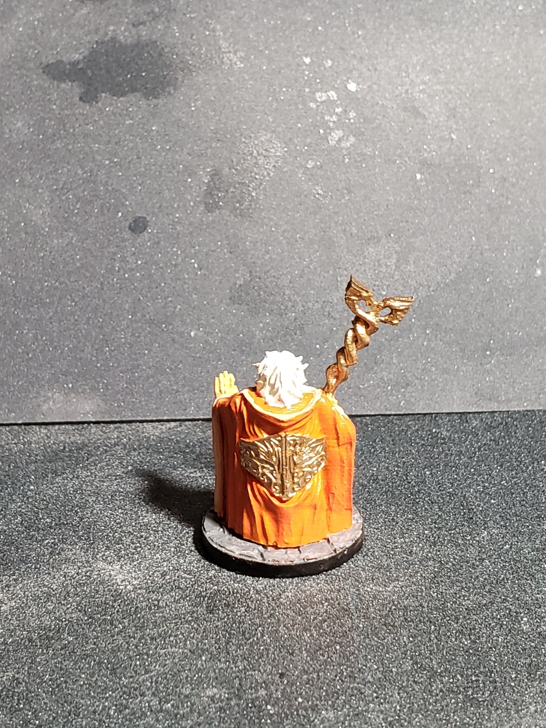

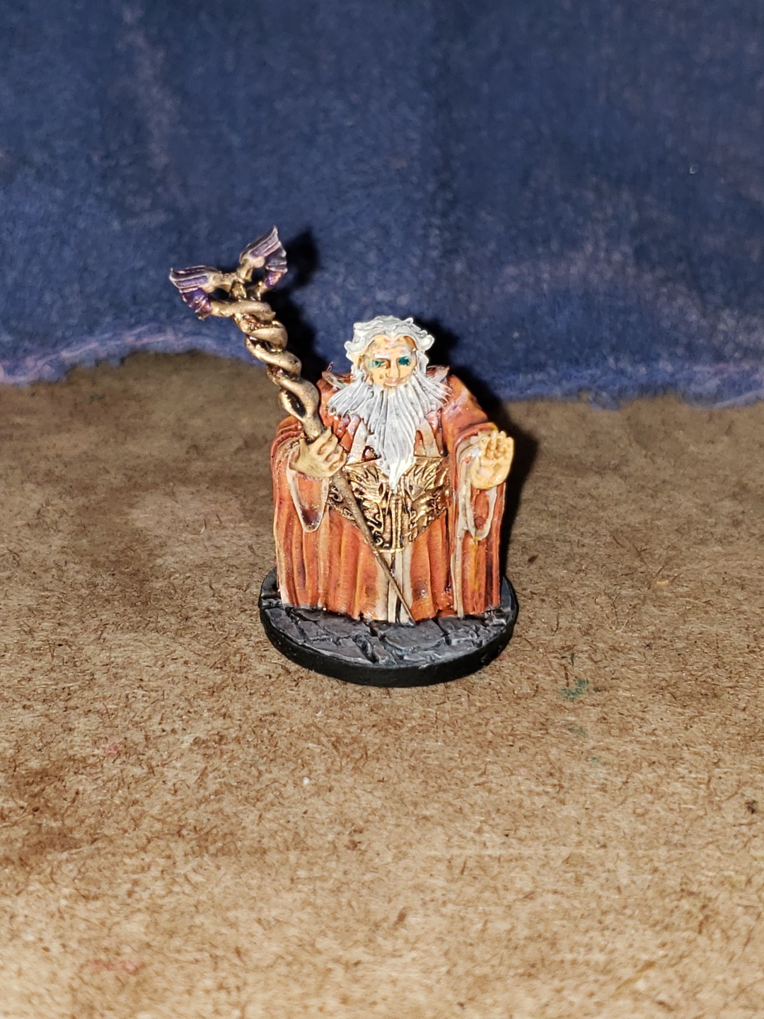

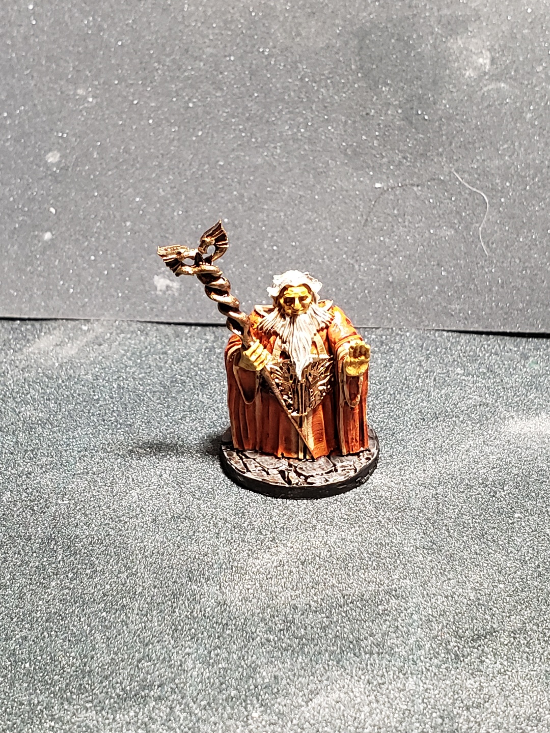

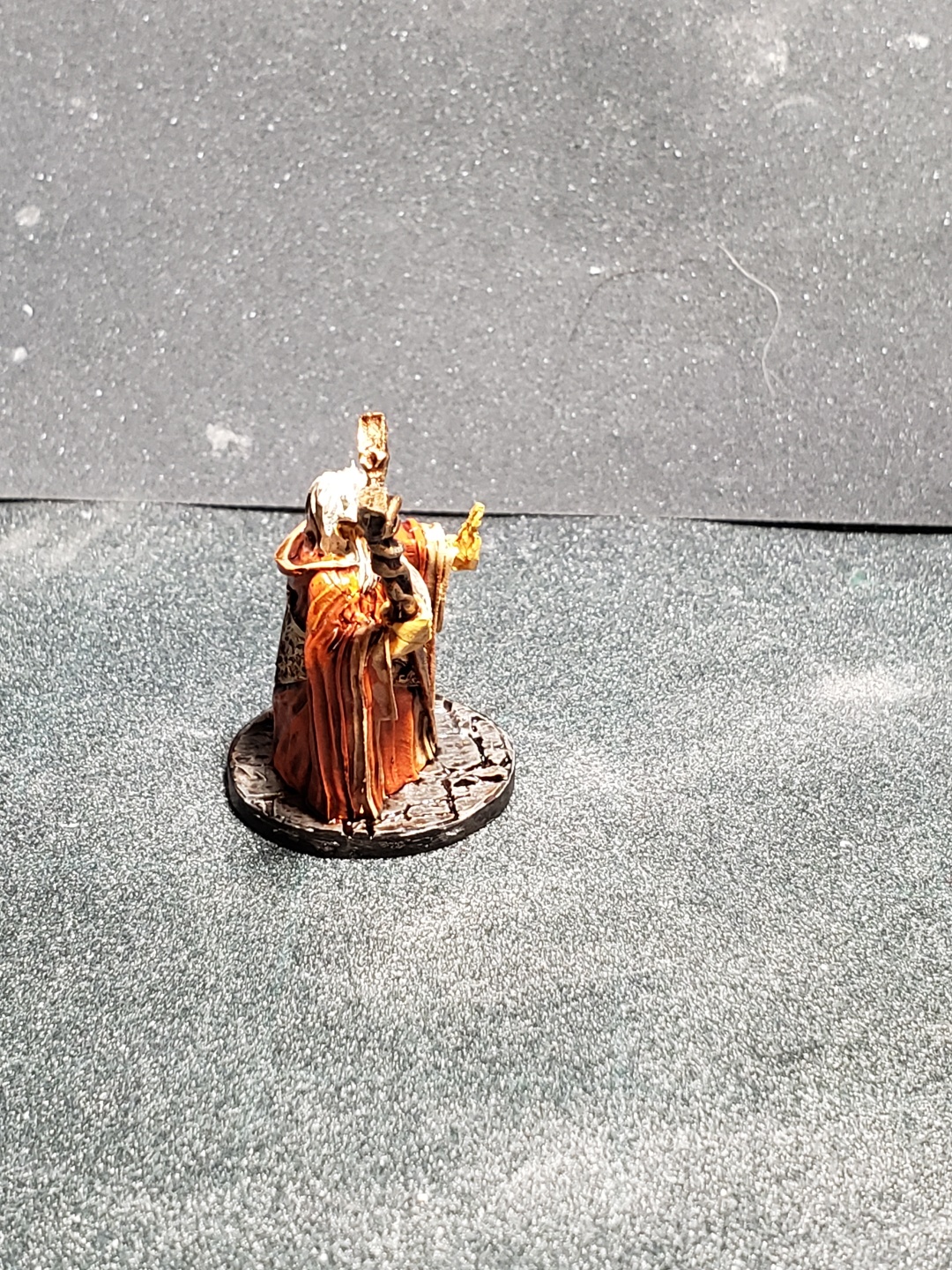

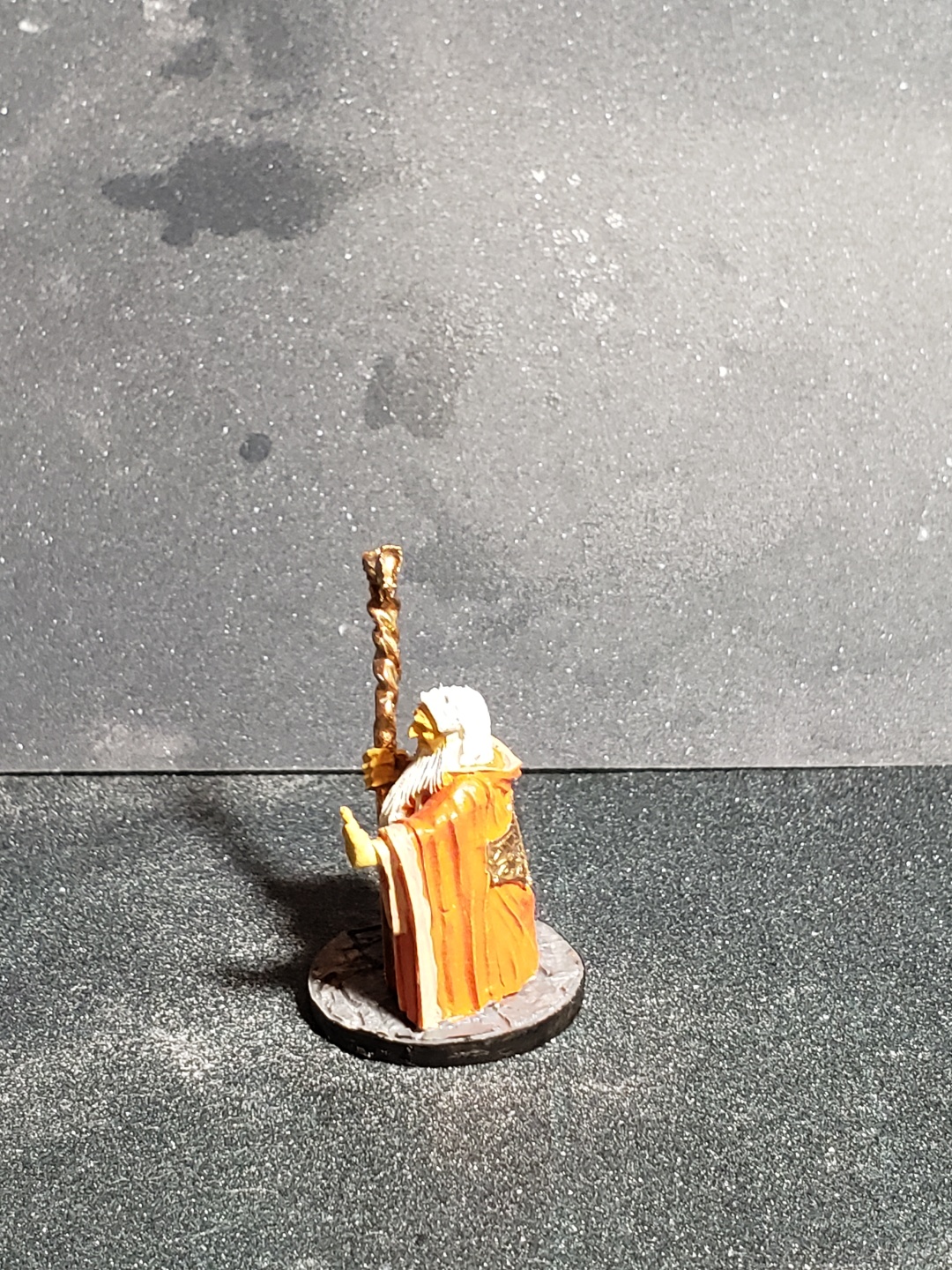

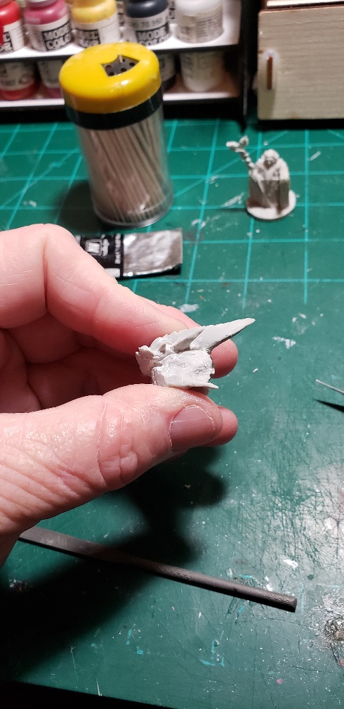

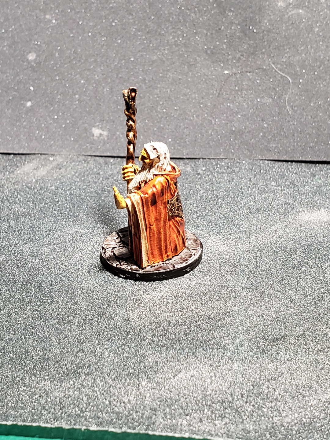

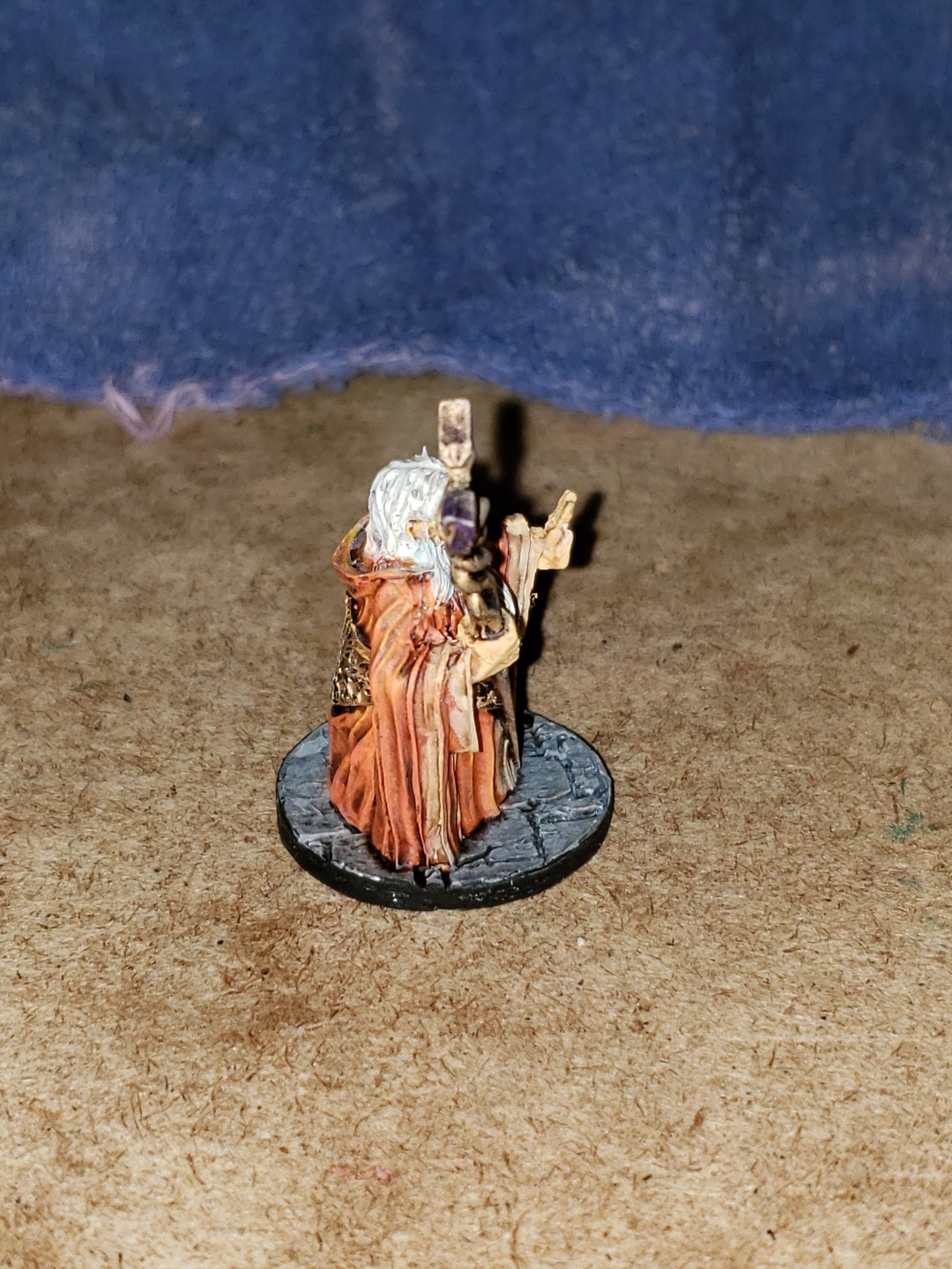

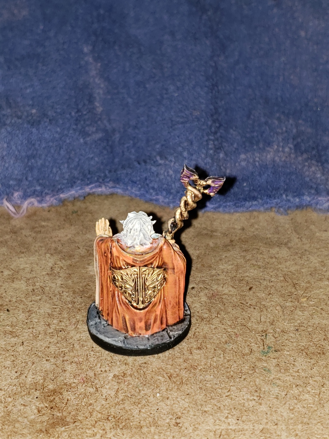

No assembly and painting of the Dwarf...
Barok Clanghammer is assembled, and I straightened the staff.

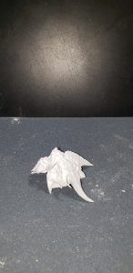

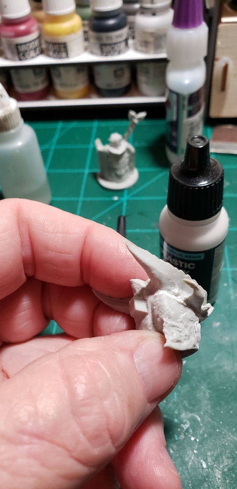

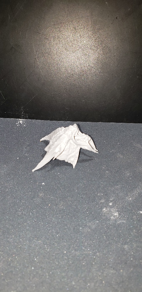

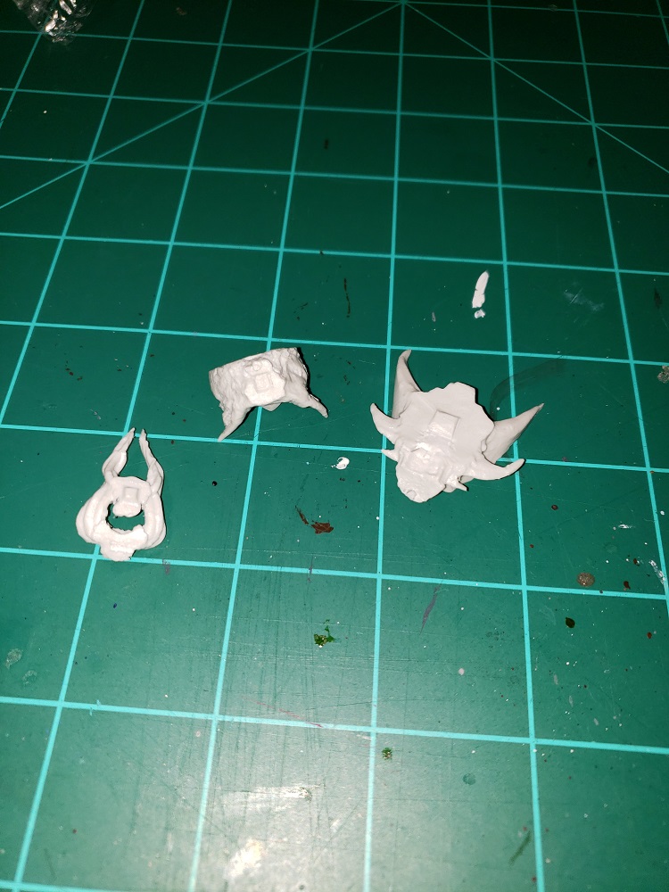

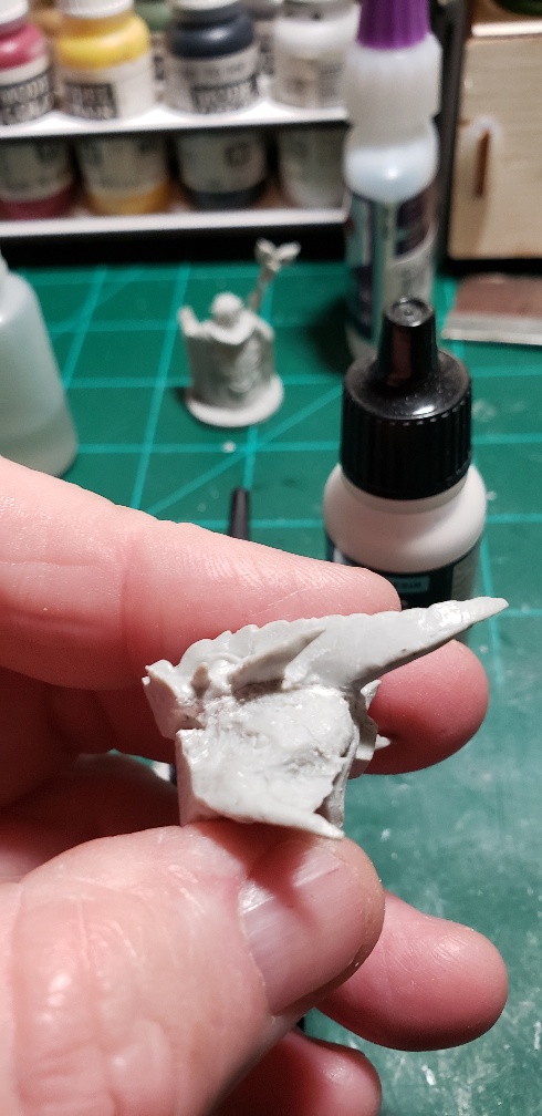

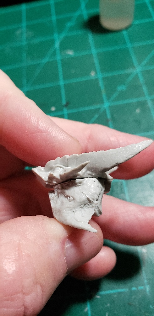

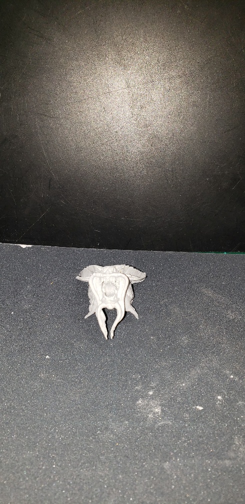

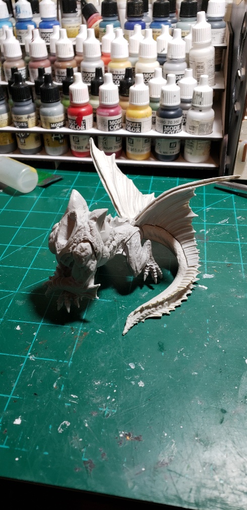

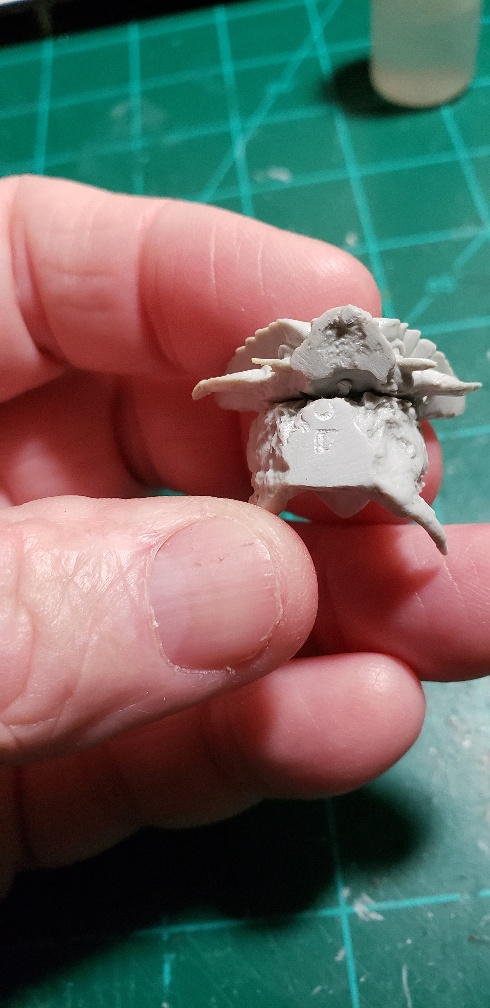

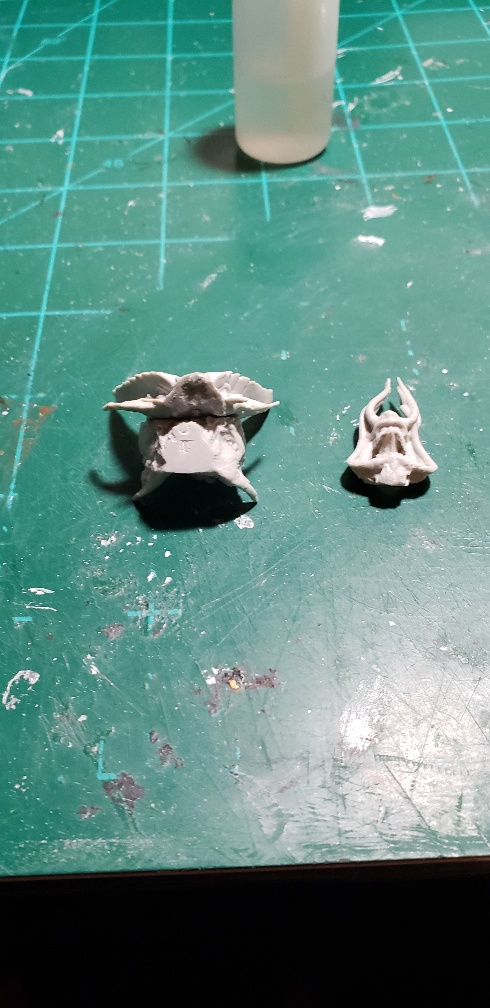

Starting actual Aurinax assembly with the head, 3 pieces, and all of them are warped.
I have sanded all I can, to get the head pieces to line up, but I don't want to sand away too much detail. So I'm gonna assemble the pieces and fill the gaps...
Resin kits, ya gotta love 'em.
The molding quality looks great. Just be careful not to inhale the resin dust during sanding. ;)

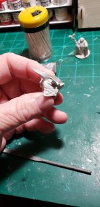

Yea, one of the upsides from being a plumber for 30+ years, I have 3 boxes of nitrle gloves, 1 box of latex gloves, two Tyvec suits, and a half a box of NIOSH N95 dust and particulate masks left from when I cleaned out my truck. The detail on the molds is great, but this is from like the third pour? on the mold, so there is warpage, and misalignment of some pieces, but I'll get it built.

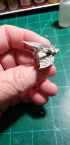

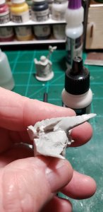

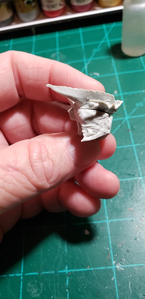

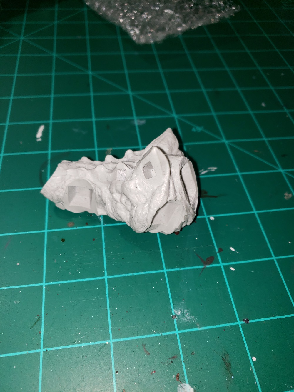

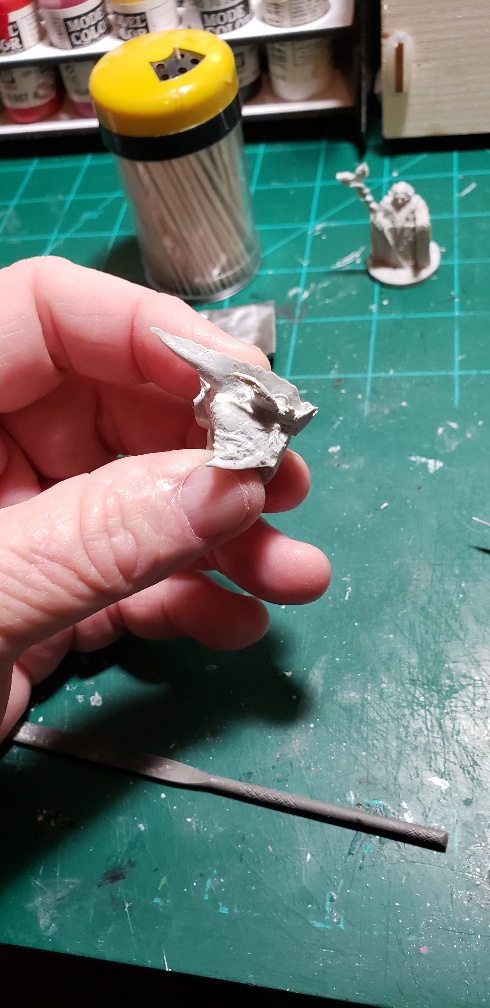

I had to sand the index stubs off of the head pieces to even try to get them straight.
first dry fit,
alignment stubs sanded off, glued together, and first filler added
second filler coat added
Once I smooth the filler putty out, I'll have something I can live with.

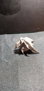

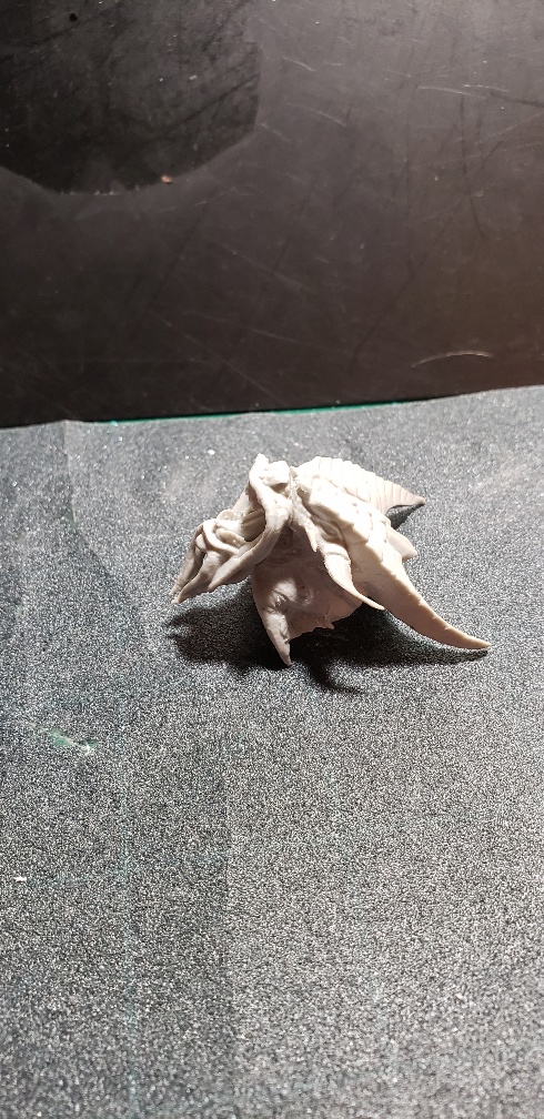

Got a light primer on the seem line, and it looks good enough to go ahead,

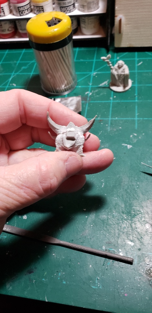

Glued the snout part with "whiskers" in place
20200802_094440_resized.jpg20200802_094446_resized.jpg20200802_094453_resized.jpg20200802_094458_resized.jpg20200802_094503_resized.jpg
Now it's starting to look like a dragon's head.

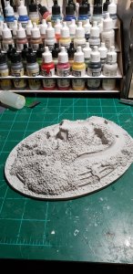

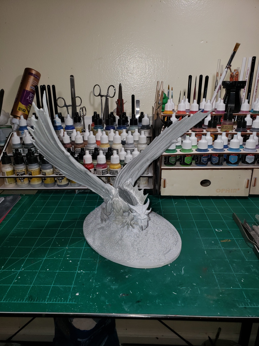

The base

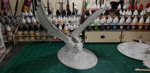

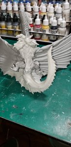

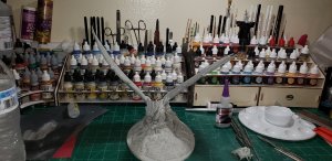

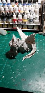

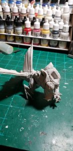

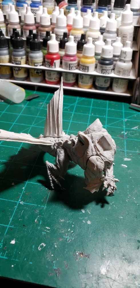

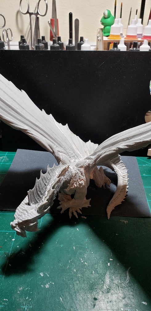

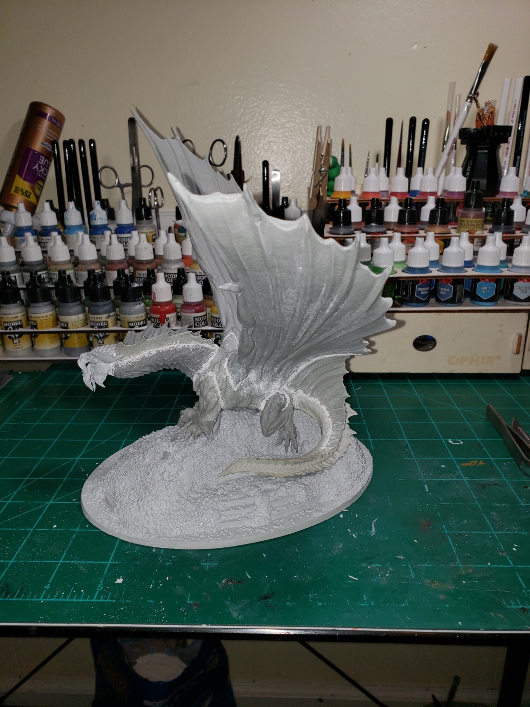

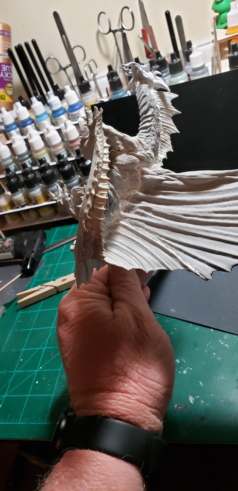

assemble the body...

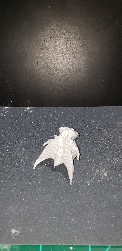

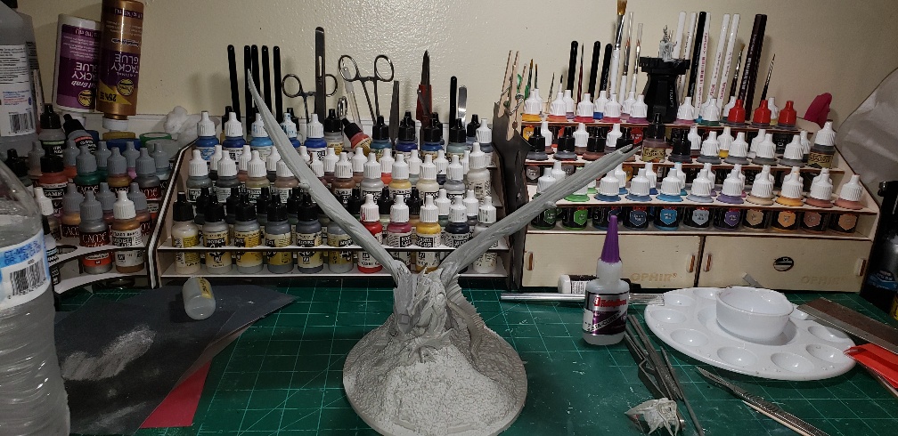

neck and wings added

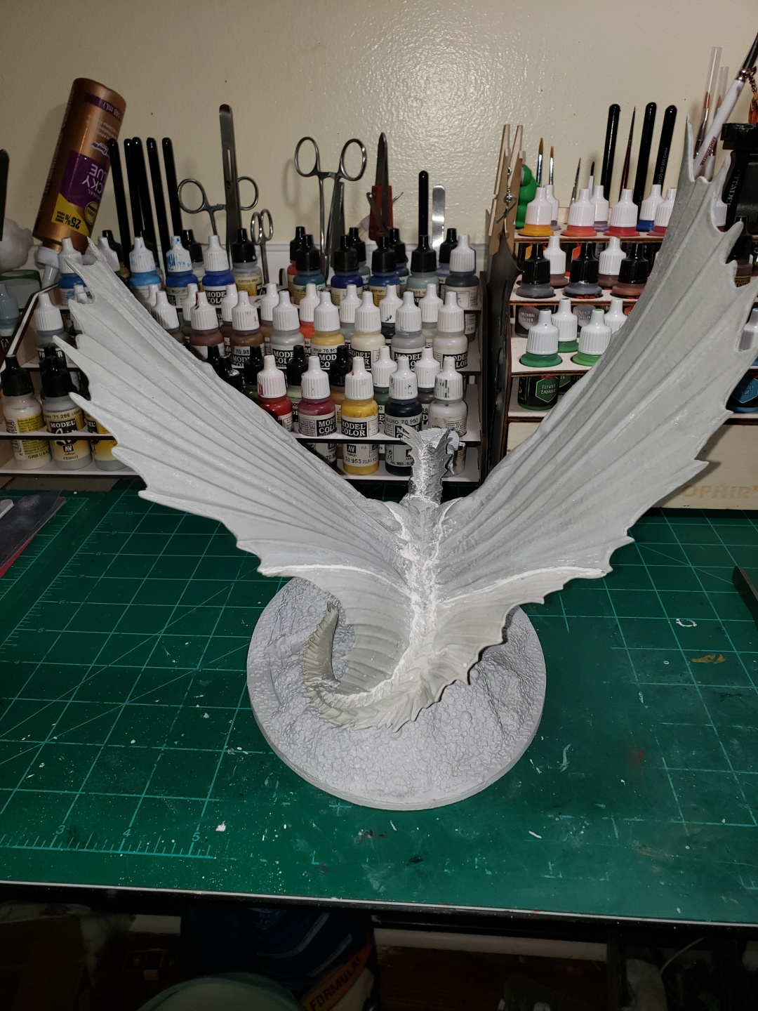

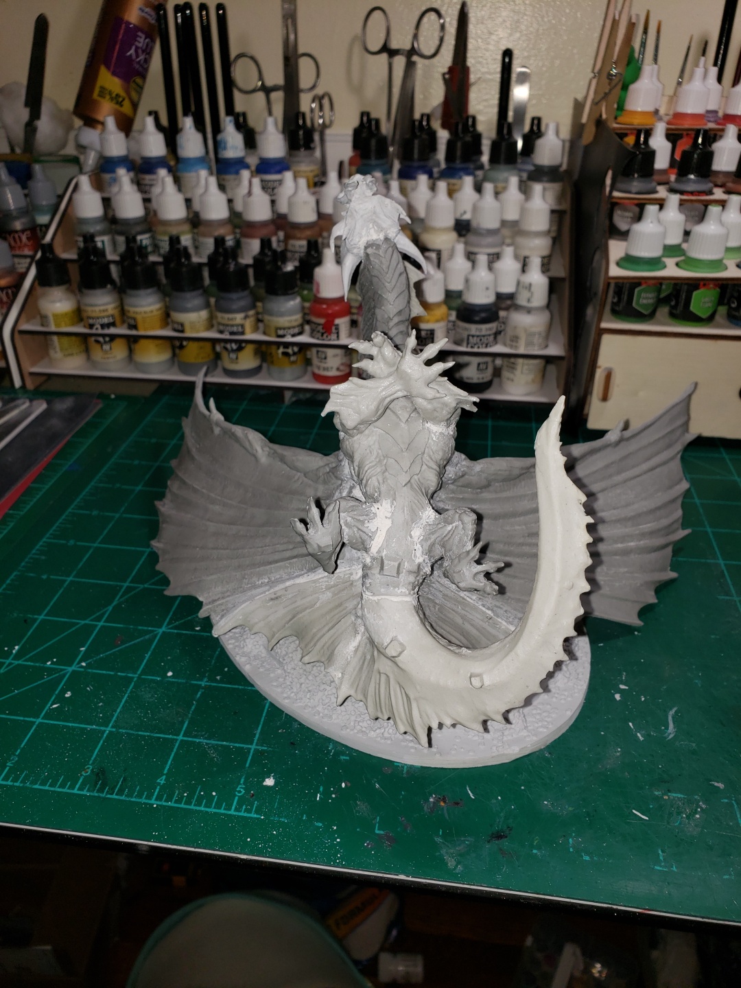

The body was placed on the base to get the orientation of the tail, and legs before gluing. this allowed me to only have to heat and bend a very few pieces, but still get a nice fit. The dragon is not glued to the base, and I may leave him this way, still haven't decided.
He is currently just tacked together with CA. I will be filling the seems first with Thick CA, then my AV Vallejo Plastic Putty. The Thick CA will provide a little more structure, and the plastic putty will provide the finish.
The gaps on the hind legs will be filled, these were caused by the warp in the hind leg parts, in relation to the body, and base.
Needless to say, this is the underside of the figure.
This is my stopping point for today. Let the CA fully cure, and then tomorrow start filling the seams.

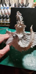

I got the head finished, and in primer. Those seams have disappeared, and it's a nice looking head now.
20200803_092945_resized.jpg20200803_092952_resized.jpg20200803_093002_resized.jpg20200803_093012_resized.jpg20200803_093019_resized.jpg

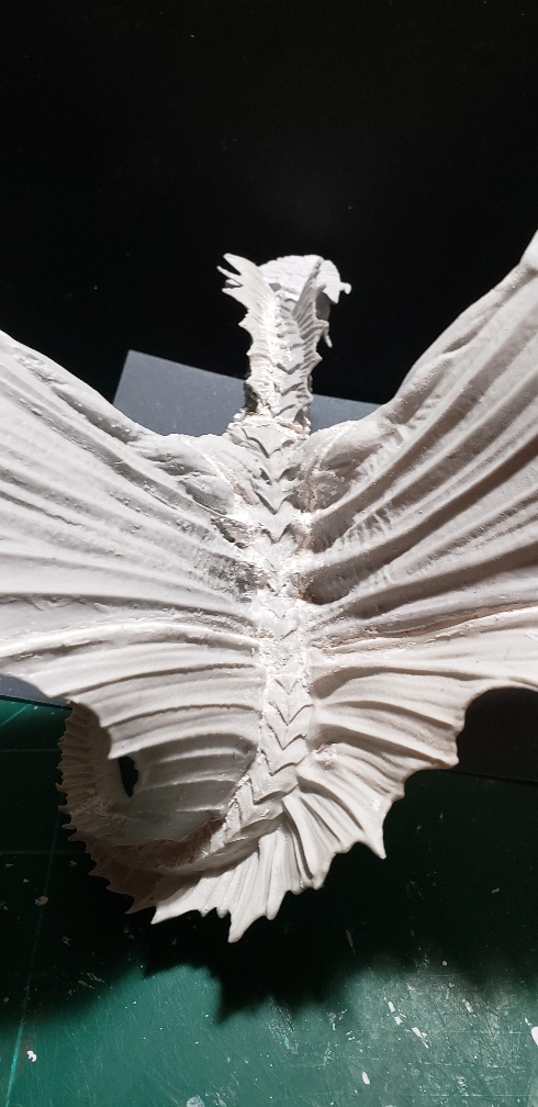

when I get back, I'll start on seam reinforcing and filling on the body. I also have 4 shades of gold to try out, and see which will be the base coat, and what order to apply them in. Aurinax represents and adult Gold Dragon, as such he should look almost as if he was covered in liquid gold, so no yellow base coats for him.
I worked till late last night on the seams, and started on them again this morning. They are all filled now, but the last round of filler needs to dry, then I can finish cleaning up the seams.

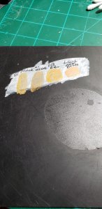

Here is a sample of my 4 gold colors painted on primed plastic.
20200804_131651_resized_1.jpg from left to right, Vallejo Game Color Polished Gold, Model Color Old Gold, TAP D&D Ki-Rin Gold, and Vallejo Liquid Metals Red Gold. I'm thinking the Red Gold as the base color, then lighten it up with layers of the others.
20200804_131948_resized_1.jpg 20200804_132010_resized_1.jpg 20200804_132024_resized_1.jpg 20200804_132034_resized_1.jpg 20200804_132041_resized_1.jpg All the seams filled.

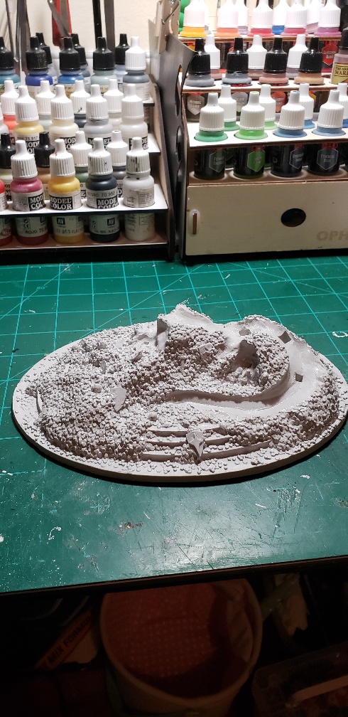

20200804_133449_resized_1.jpg the base is primed.

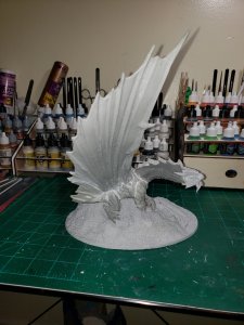

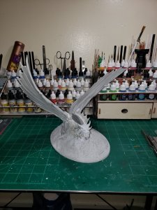

and a beauty shot so far.

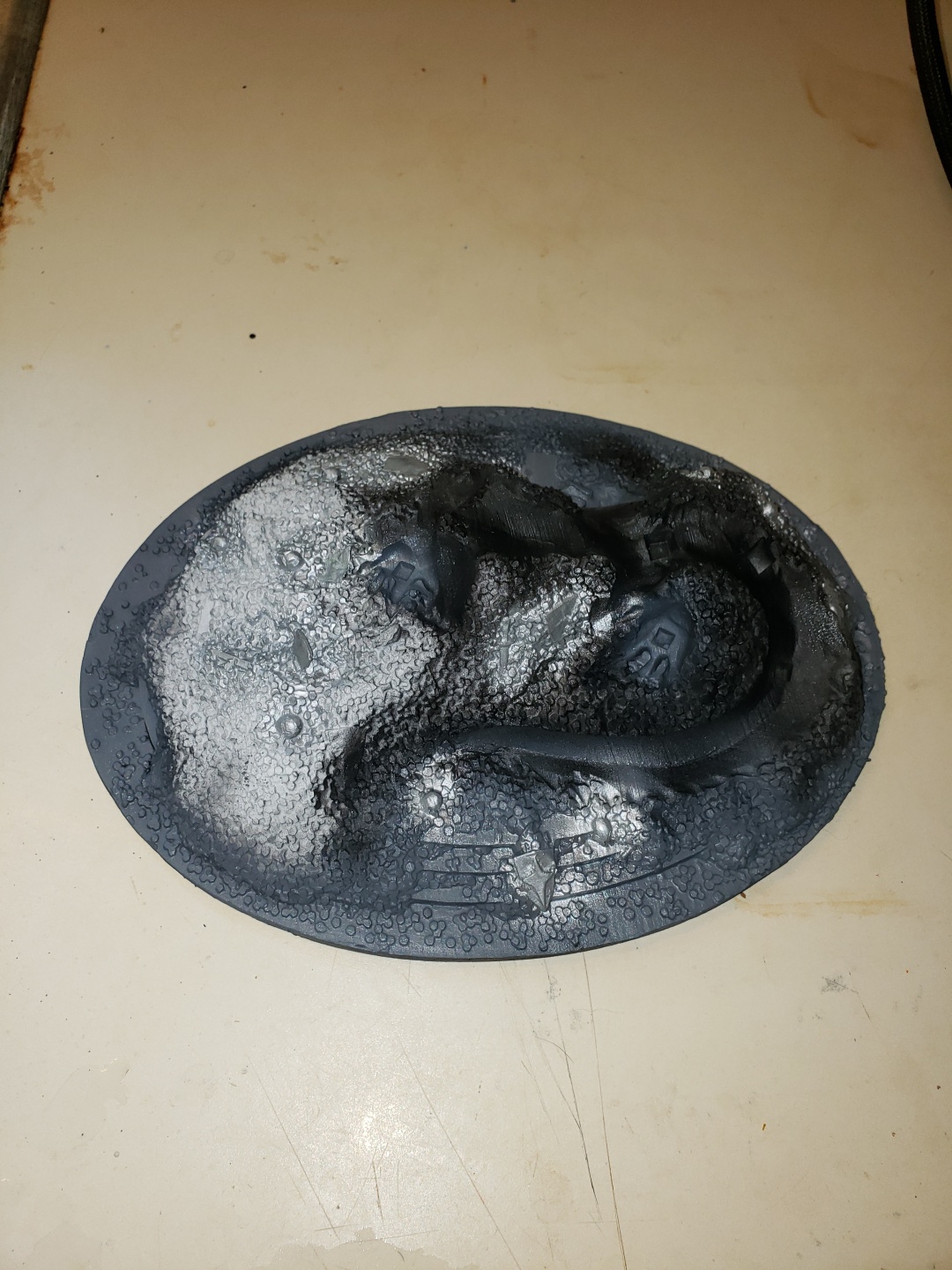

first pre shade and color coats airbrushed to the base.

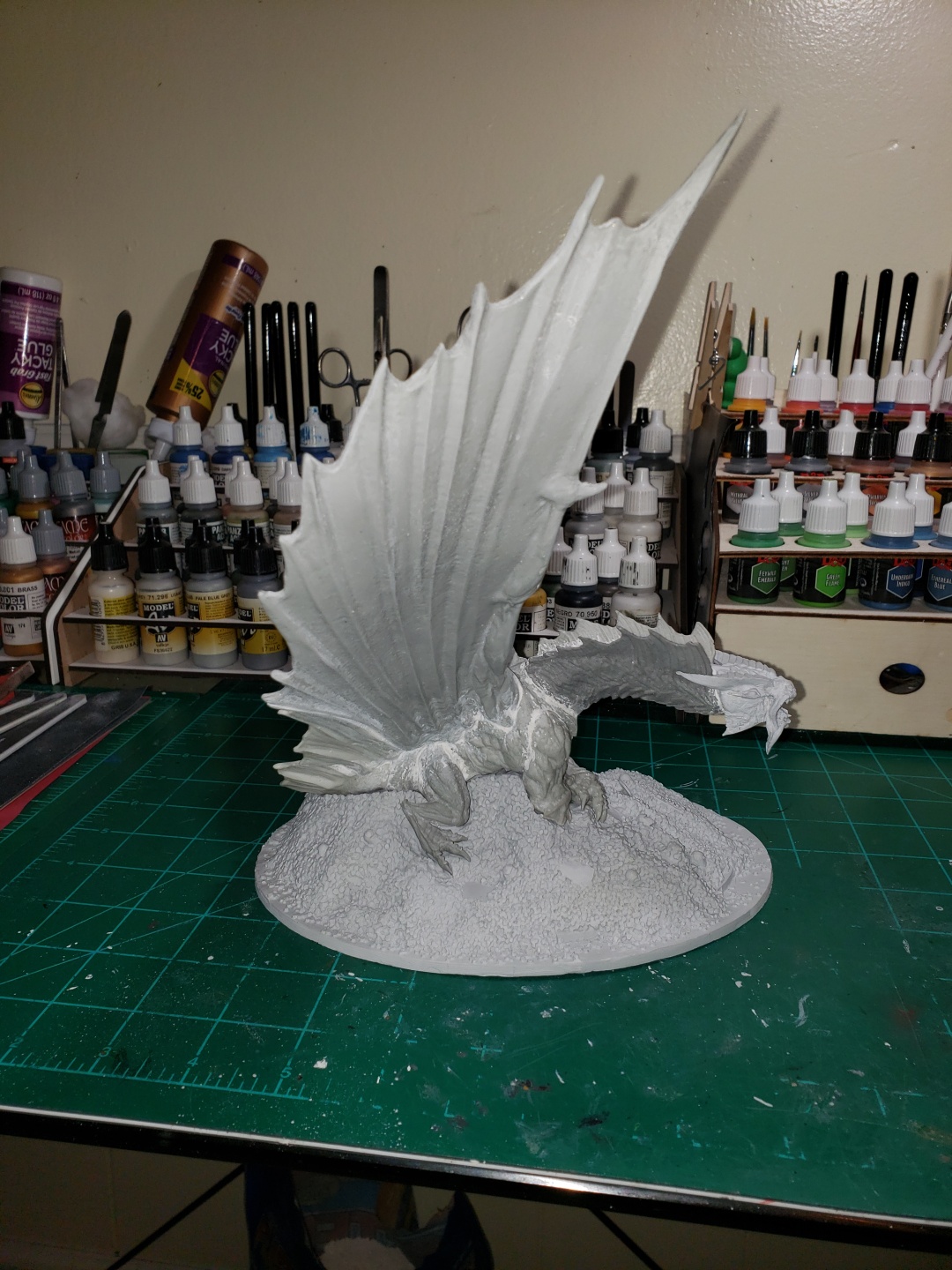

overall primer airbrushed to the dragon itself. No more voids found, and overall, I can live with this.
AV Vallejo Acrylic Polyurethane Primer takes a minimum of 24, and ideally 48 hours to cure, so now I wait.
