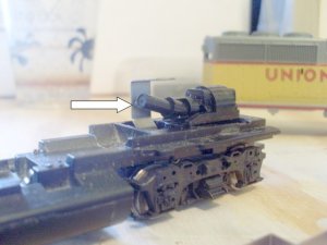

Whats that little piece called that broke off? i need to get a replacement for it. The other one on the other side is still in tacked and i was able to put it back on (it was also loose in the box).

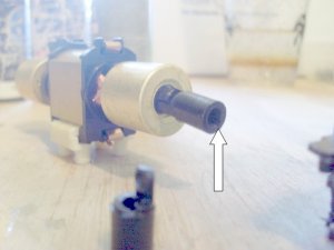

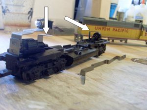

Also what is the easiest way to assemble the motor back in the frame? I cant seem to get the things in the picture above to go inside the rods that are on the trucks?? :confused: The thing thats sticking up in the picture below
I think i know how to put the metal clip back in so that shouldnt be a problem

The long metal clip, snaps on the top of the motor, and the ends tuck in under the metal clips on the trucks. The white plastic "nubs", on the bottom of the motor, go into the four holes loctaed in the bottom of the tank.
I do have a couple of extra drive universals. PM me and I'll mail them to ya.

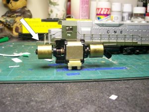

As far as putting the drive back together(I couldn't get a good pic, so I used yours), in universal coupling that mounts to the flywheel you'll see a slot or keyway. On the drive shaft, there is a spline, or a key. You may have to rotate the motor by hand until the keyway and the key line up. The coupling should then slide on the drive shaft.

Thanks for the replies and help guys!! :mrgreen: :mrgreen: I think i got it, i got the motor in and the clip on. I also was able to get the side that did not have the broken drive shaft in as well :thumb: :mrgreen:
That was easyer then i had thought lol
