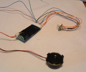

In looking at the decoder again, it has a 10 pin connector on the board where the harness plugs in. Seven wires go to a small board with 8 pins and 3 wires are loose.

I may be just trying to over think all of this. The pic of the DCC board in the loco came out blurry but you can sort of see the 8 holes (2 rows of 4) at the bottom. The small board attached to the end of the harness drops right into the 8 holes. There are only 7 wires attached to the small board.

It almost looks like the brown wire has came a loose from the 8 pin board maybe. I know on most of the decoders I have gotten with a 8 pin board only had the green and violet wires loose if it had them. The rest where hooked to the board. You may have to solder it back on or send it back.
OK, looks like no problem! Plug the decoders 8 pin plug in to the locos socket, the other three wires are just extra functions you can wire to ditch lights, a strobe, etc. Or trim them and tuck them out of the way if not used. I like to put a dab of liquid tape or similar insulator over the wire end to make sure it doesn;t contact something.
