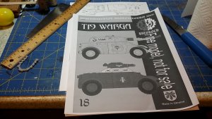

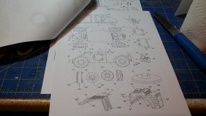

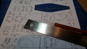

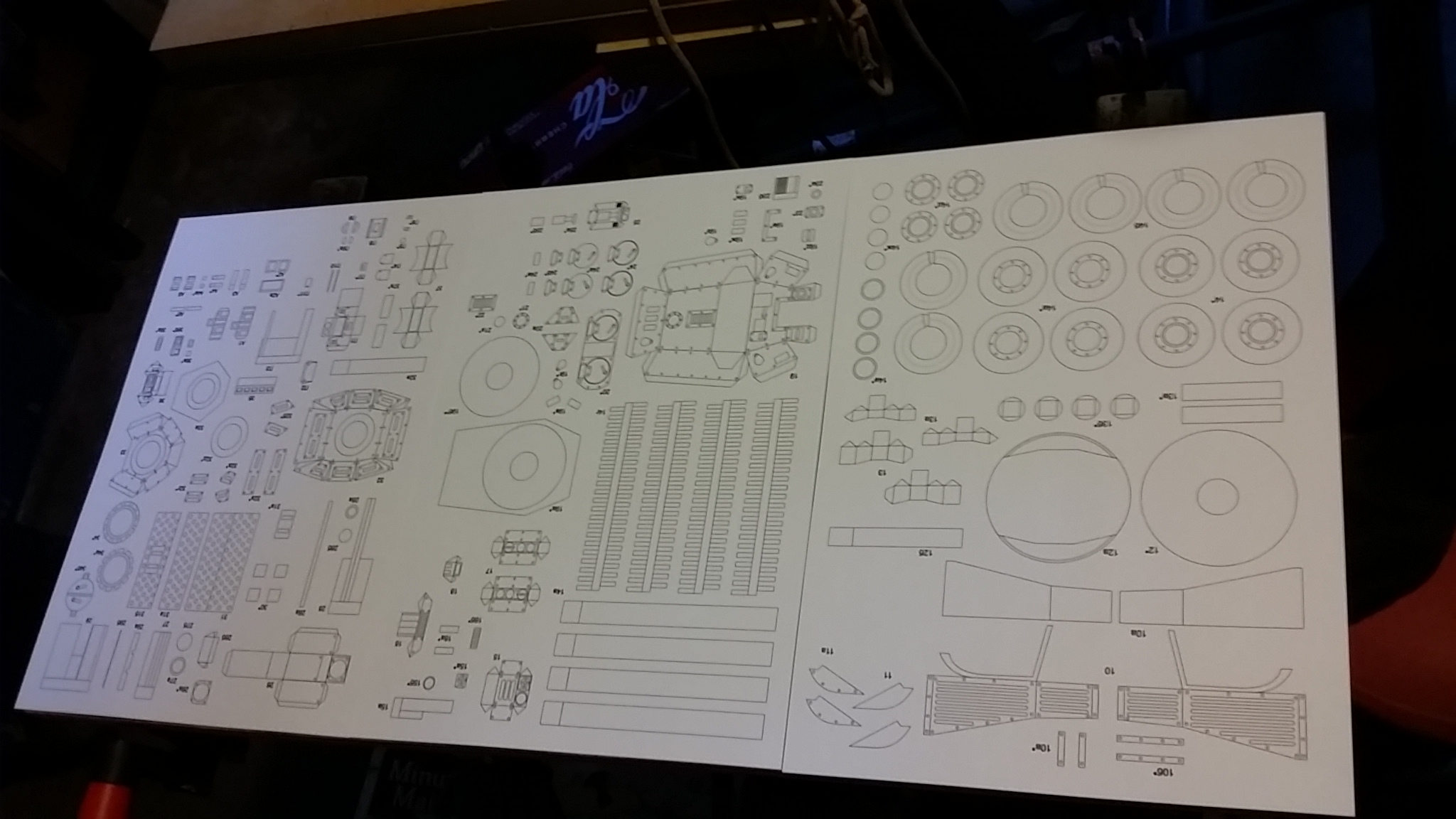

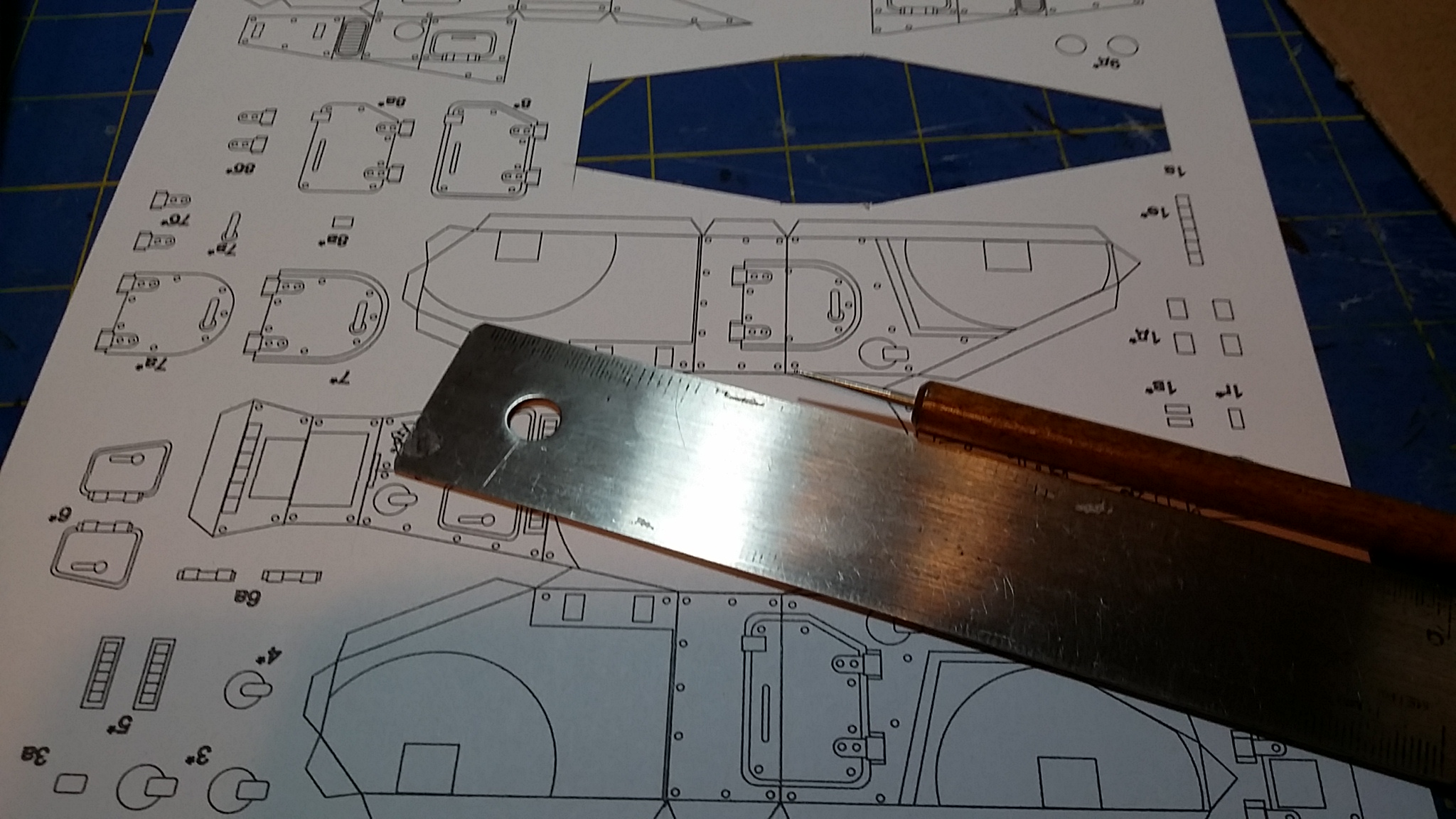

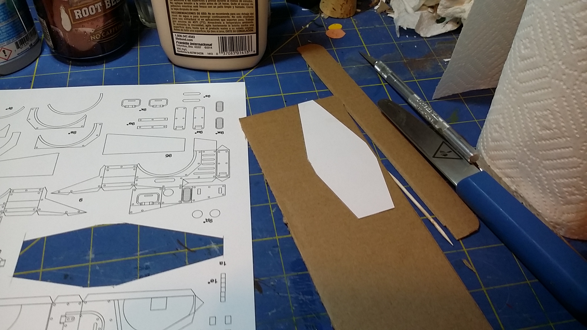

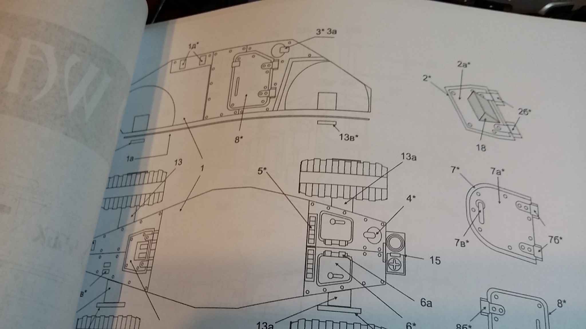

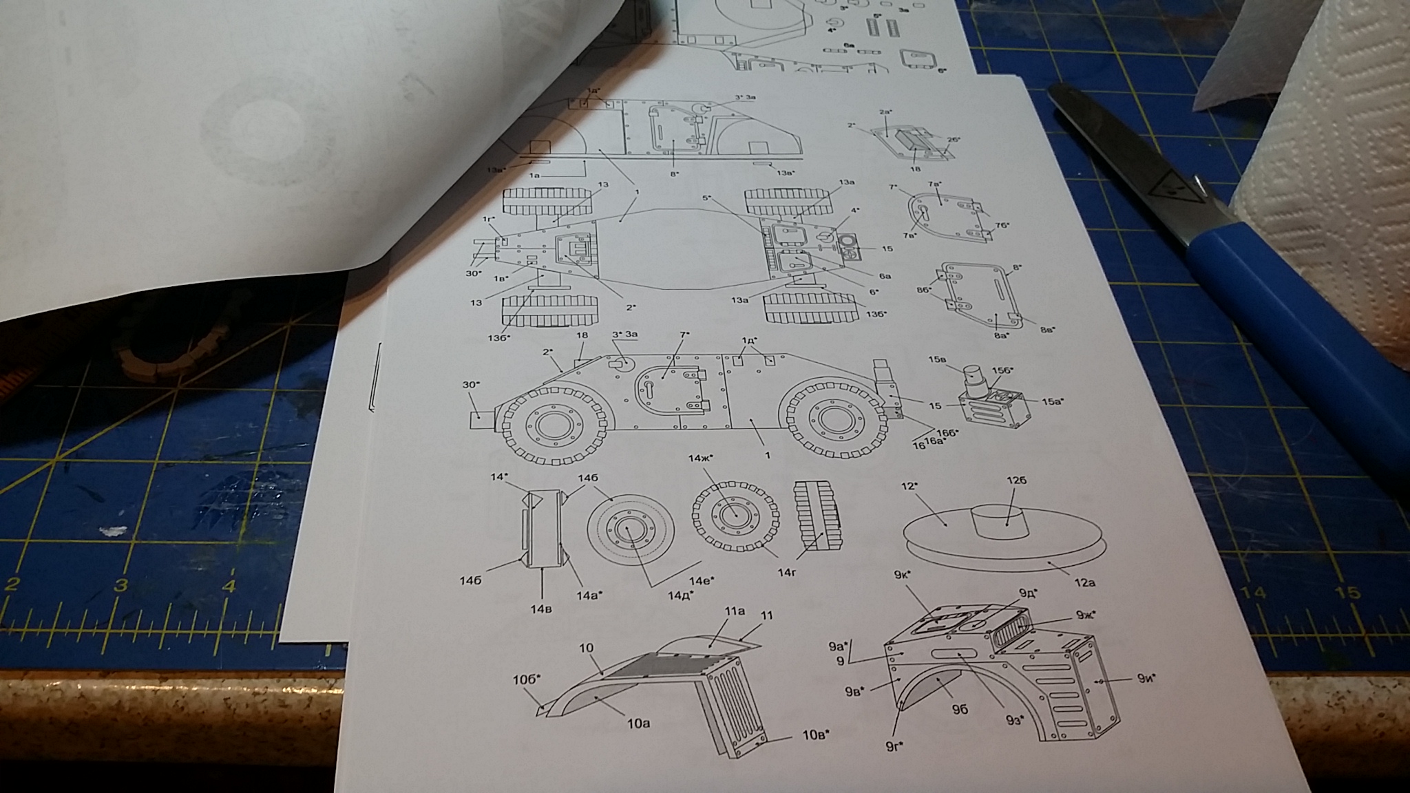

So, we start with the instructions:
I look at these, and compare them to the references, both Wikipedia and the plastic kits, and make a quick determination of what is going to need the cereal box thickness material. Pretty simple really. The hull at least. This is where I will grab it during games and to take it off the shelf!

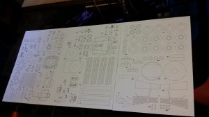

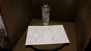

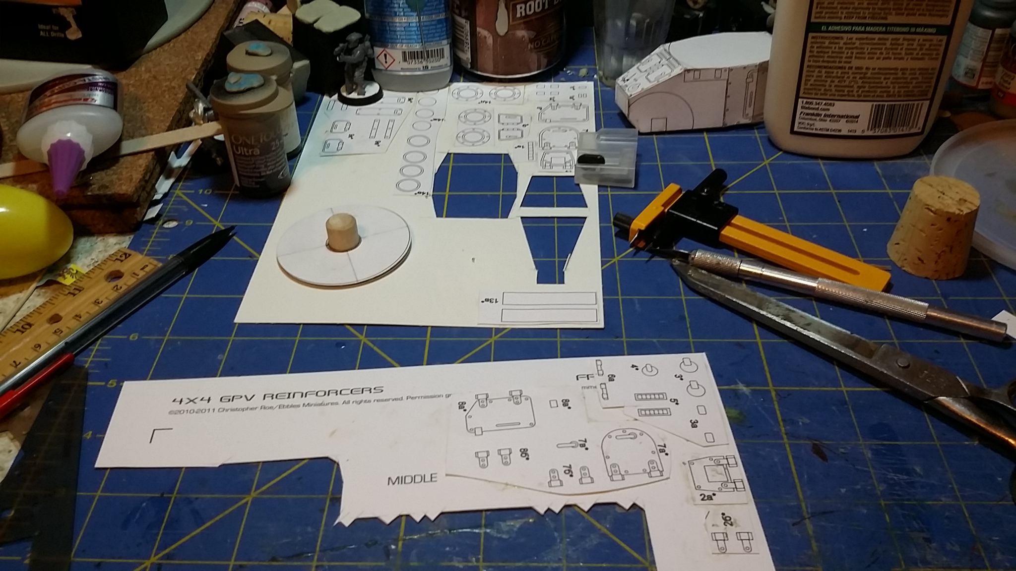

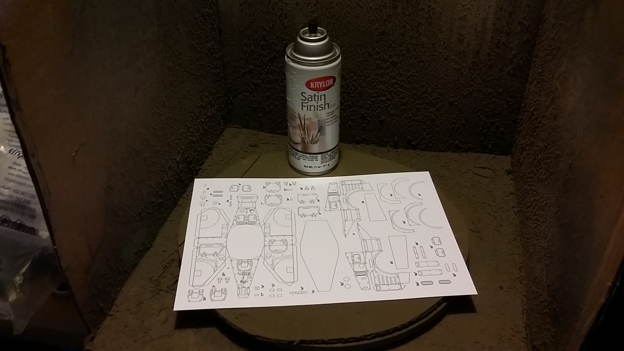

Okay, after I've printed the instructions on normal paper, I use my choice of card stock to print the templates. Now, I cheated. Being the US, I went to Amazon.com and grabbed a pack of A4 index card stock. It was cheaper than I thought! Next, after printing, I hit it with some clear coat, in this case (North American readers), I used Krylon Clear Satin. I spray every page, front and back, with the clear coat. This will seal the paper from the moisture (Omaha NE is in the Missouri river valley, and is 100% humid during the summer months... Yeah, my garage has swamp air 9 months out of the year...).
This will also pay dividends when we get to assembly and painting (sealing in the printed details that tell us where to cut). It means the paper will warp far less as well.

Very interesting procedure. Does the paper crease after it was sprayed when you are making tubes or rounded shapes or does it stay flexile enough for that?
Reactions: Sudsy
This looks like it will be a very interesting build. I have heard about spraying the sheets with some sort of sealant to seal the paper and "lock-in" the printing. I am very curious to see how this works. What kind of glue are you using for this project?
Reactions: Sudsy
I've never had bend issues with the sealant sprayed card stock. Rolling, it just depends upon the diameter. For some of the barrels, I'm likely to go to regular printer paper instead of card stock to achieve the flexibility and desired diameter. For example, small tubes like gun barrels, smoke grenade launchers, etc. If the diameter is larger, like artillery tubes, wheels, or las-cannon barrels, I'll use the card stock. It will roll just fine even with sealant.
Typically, I use wood glue for this kind of project. I have a lot of it laying around. In the United States, I use a type called Tite Bond II or Tite Bond III. It is a pretty good wood glue used in cutting boards, bowls, and other general purpose projects. Tite Bond III is listed as food safe, therefore that is why it used in kitchen item wood working. Since paper is just wood pulp anyway, it makes sense to use that kind of glue to me.
Sealant thus far has not impacted gluing. Nor has the the spray paint used as primer (on the BMPs). Seems to hold together nicely. Now, they haven't gone through a gaming session yet to fully battle test them though!

I believe the sealing of paper is on the top layer of the matrix, thus allowing for sharper and less "hairy" edges. This has been my experience. Unless you were to saturate the paper, there should be no problem with any kind of forming, and painting becomes better as the pain adheres to the sealed layer better. IMHO.

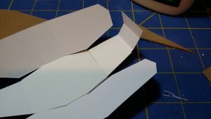

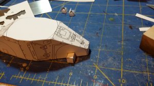

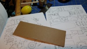

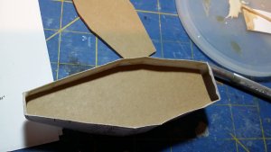

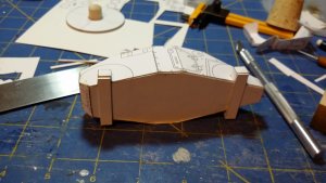

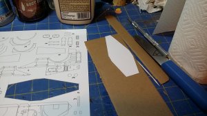

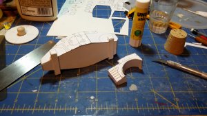

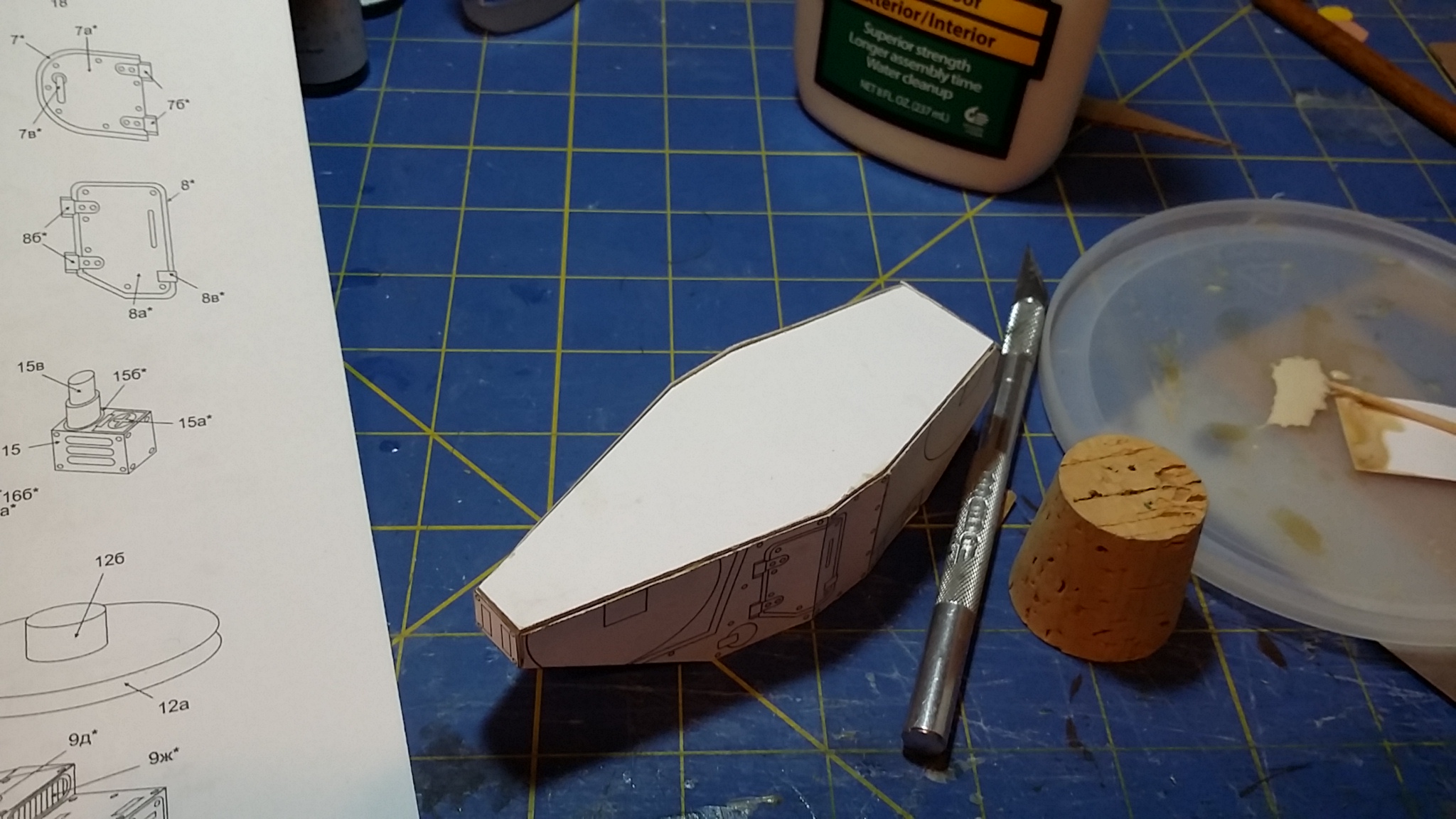

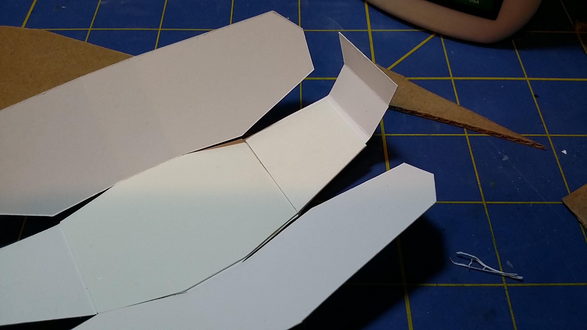

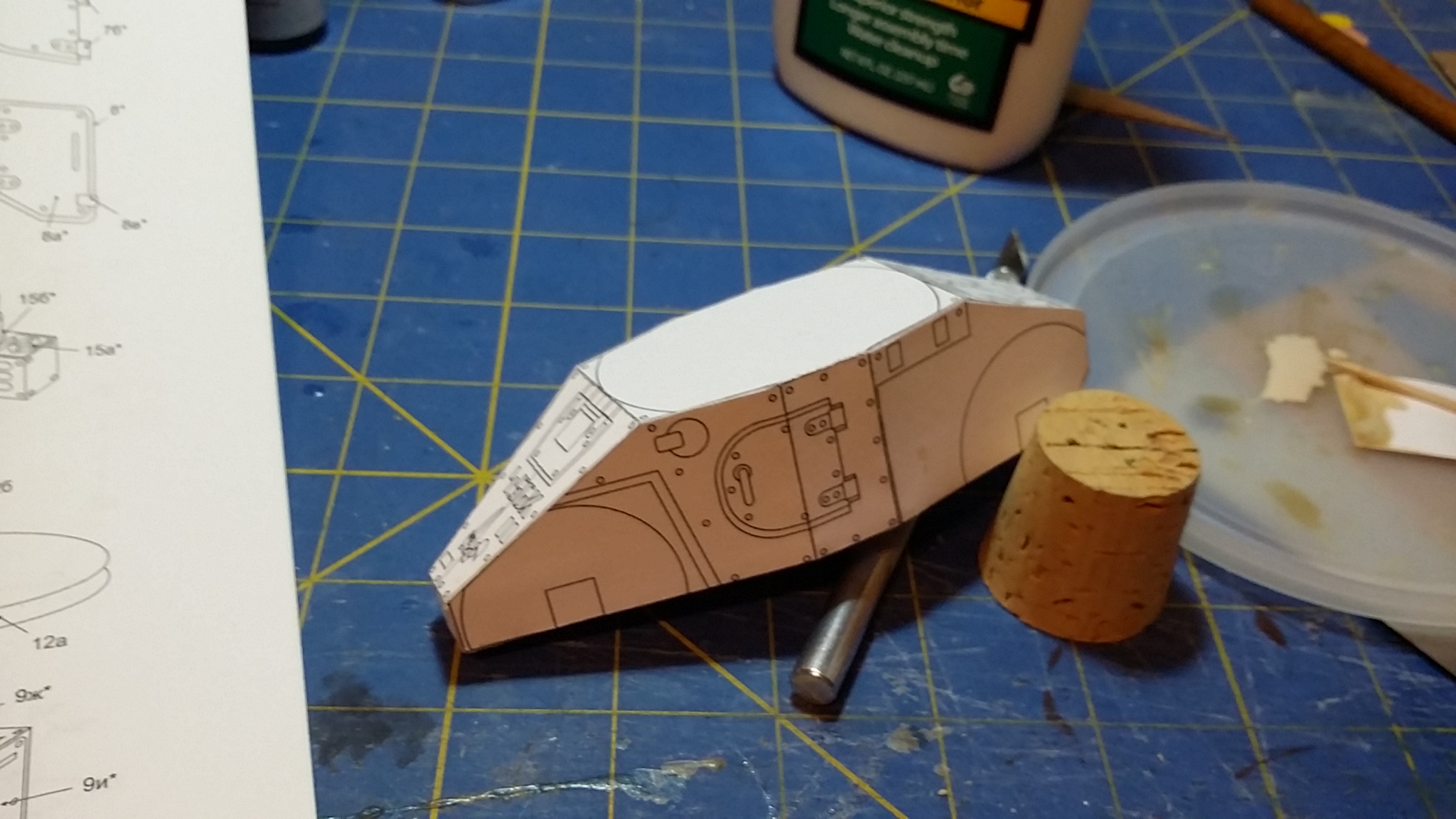

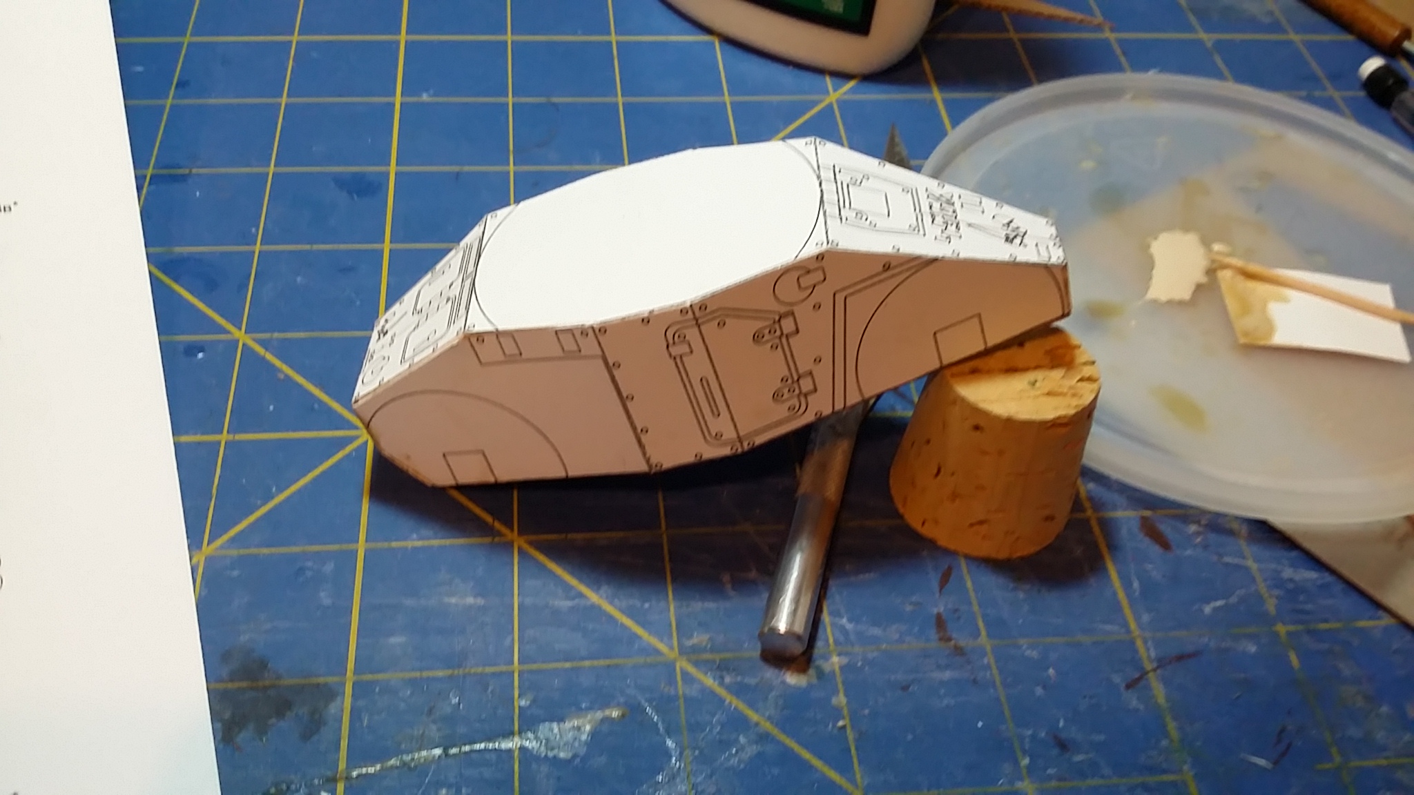

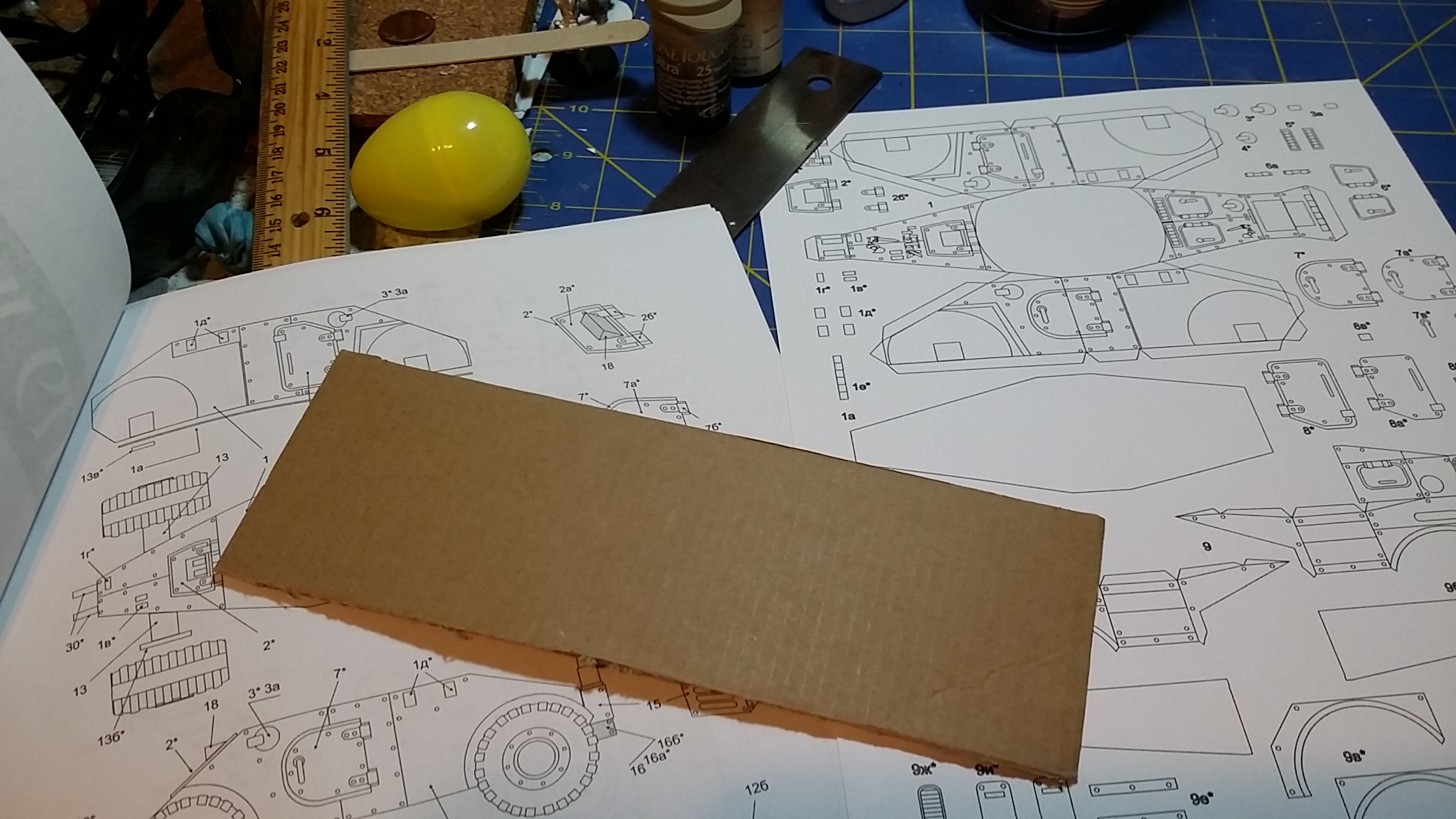

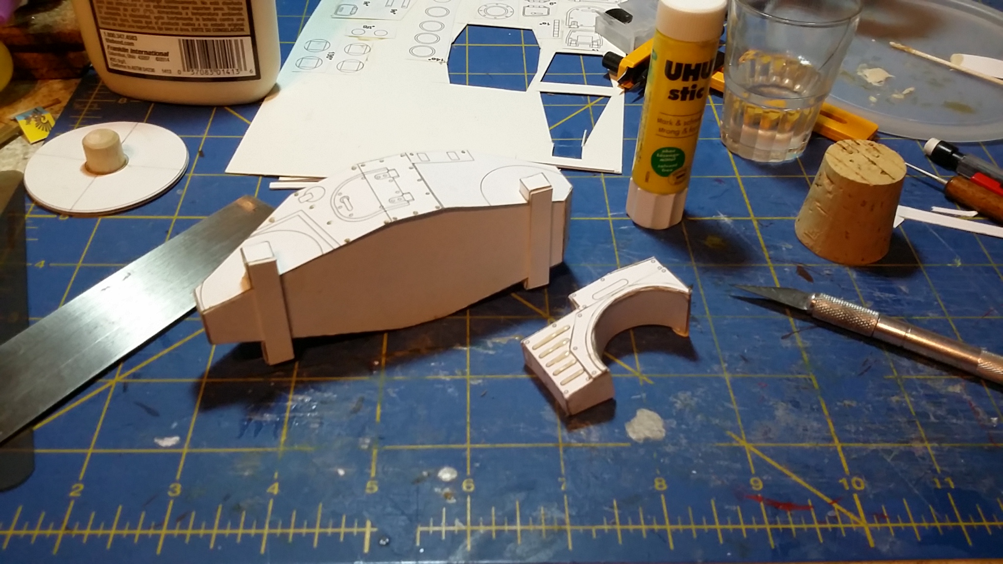

Today's progress. I used some thin corrogated coard board (from a 3d printing filament box) as my bottom stiffener for the main hull of the armored car:

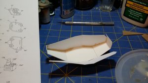

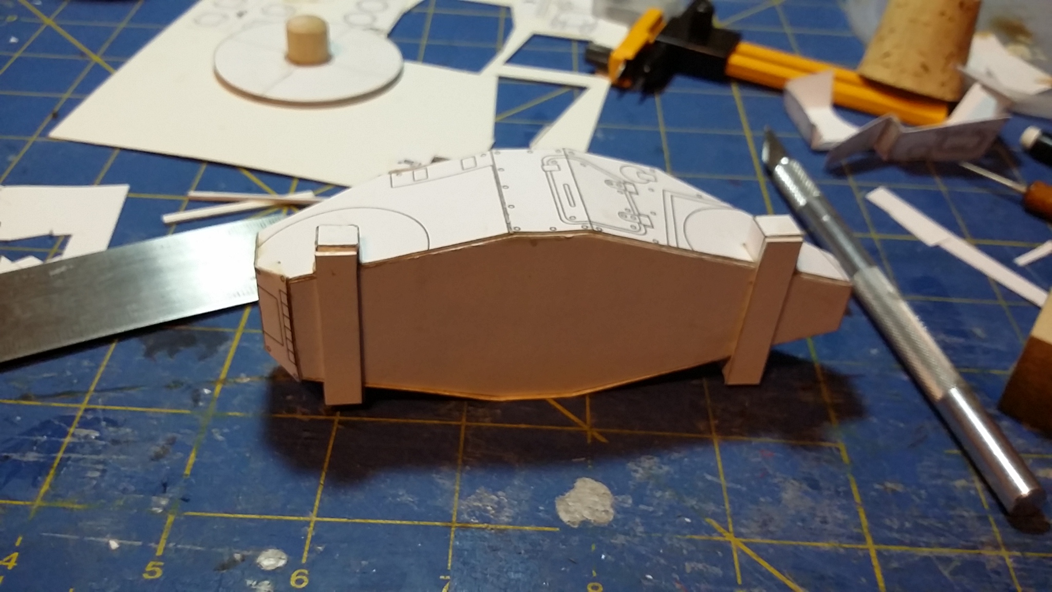

Then I took my ball tool and ran it along all fold points. I decided I did not need any tabs (@Gandolf50 )...
I used some food card stock to bolster some armored panels along the front and rear. Folds on the sides should suffice...

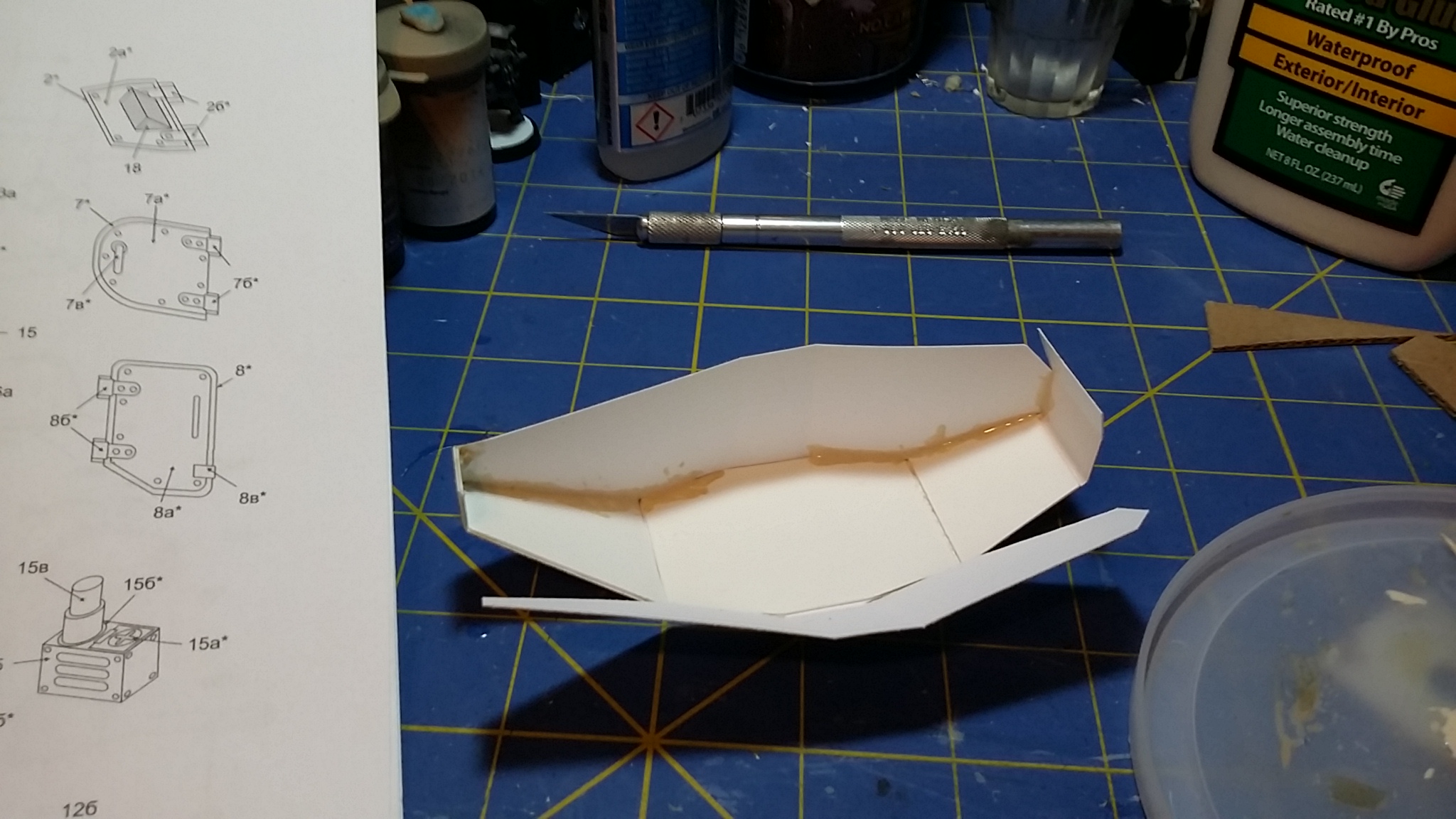

I ran a bead of glue down the corners of the interior. So far so good! See, who needs tabs!

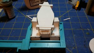

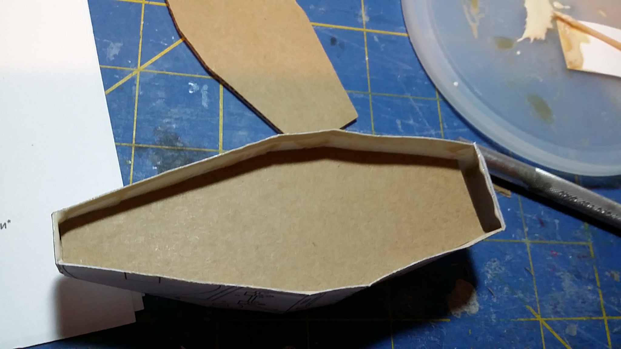

I deced to cut another corrogated cardboard stiffener for those side panels. This was glued in only a bit from the base....
Finally, I got the bottom on. This was a piece of the printed card stock laminated with wood glue to the corrogated cardboard.

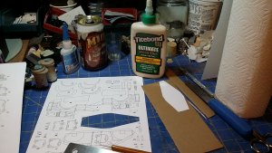

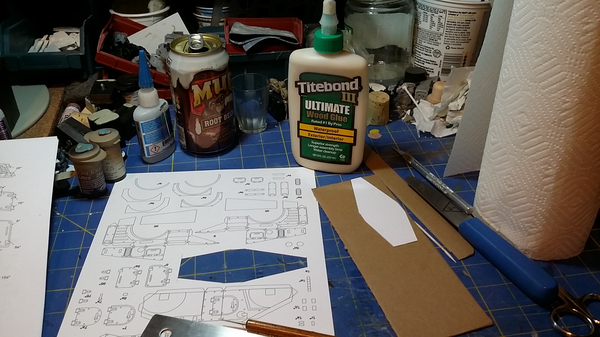

A bit out of order, but I figured I'd show my bench with the glue I use.
Finally, the the main body ready for more work tomorrow:
With all these reinforcements you are making an armored armored car. :)

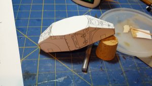

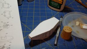

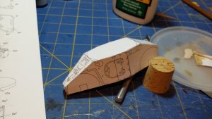

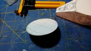

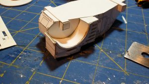

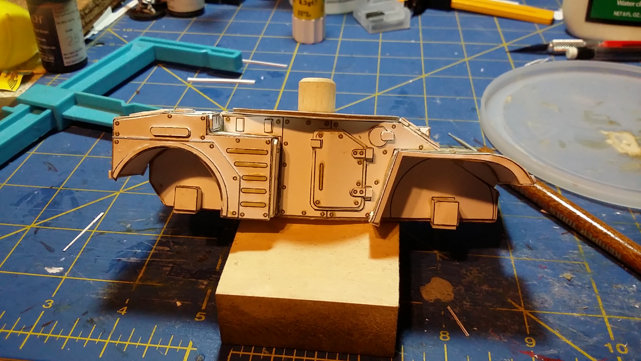

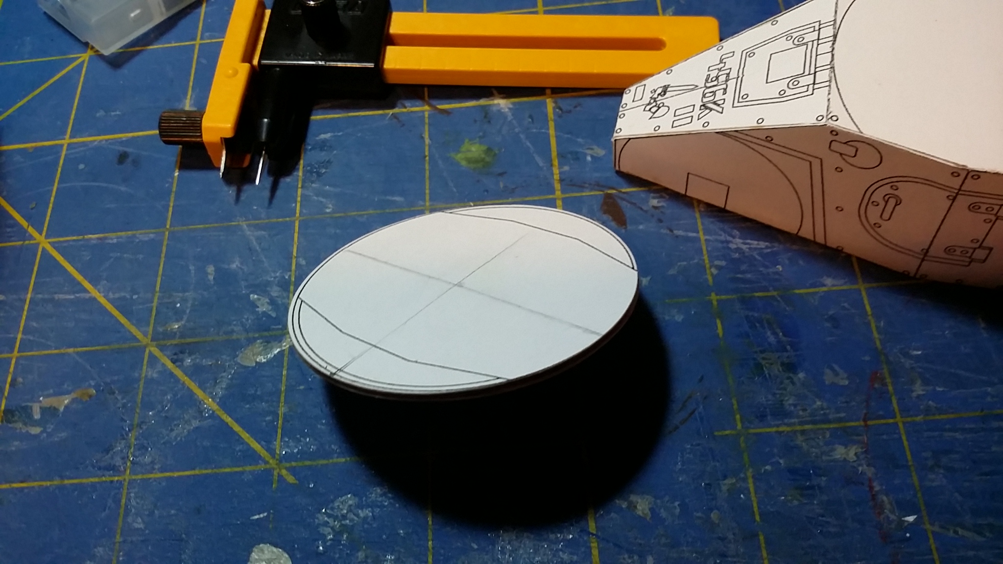

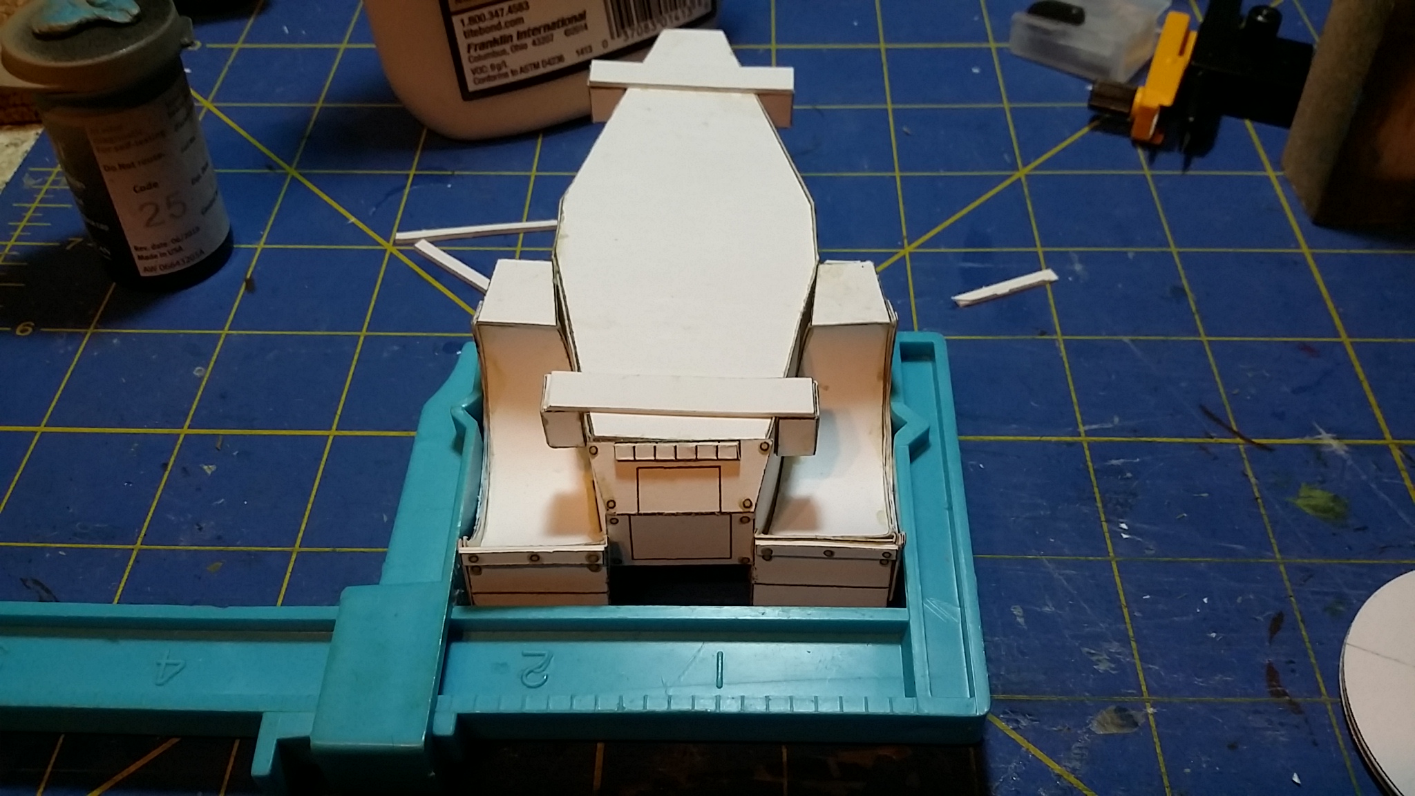

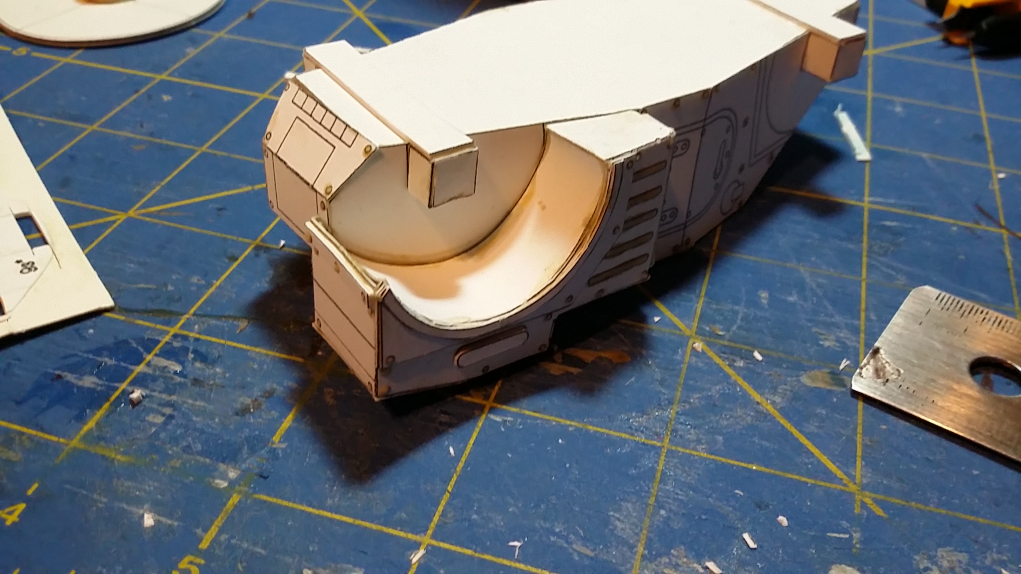

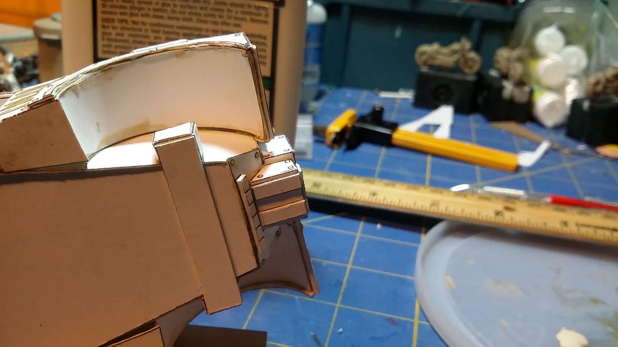

Got some work started on the hull again today, here is progress:

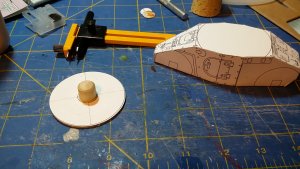

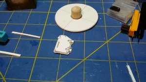

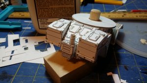

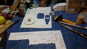

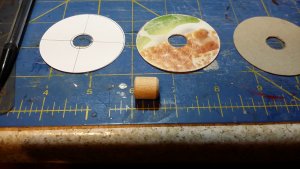

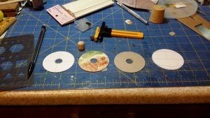

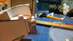

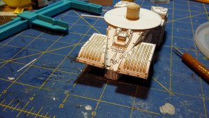

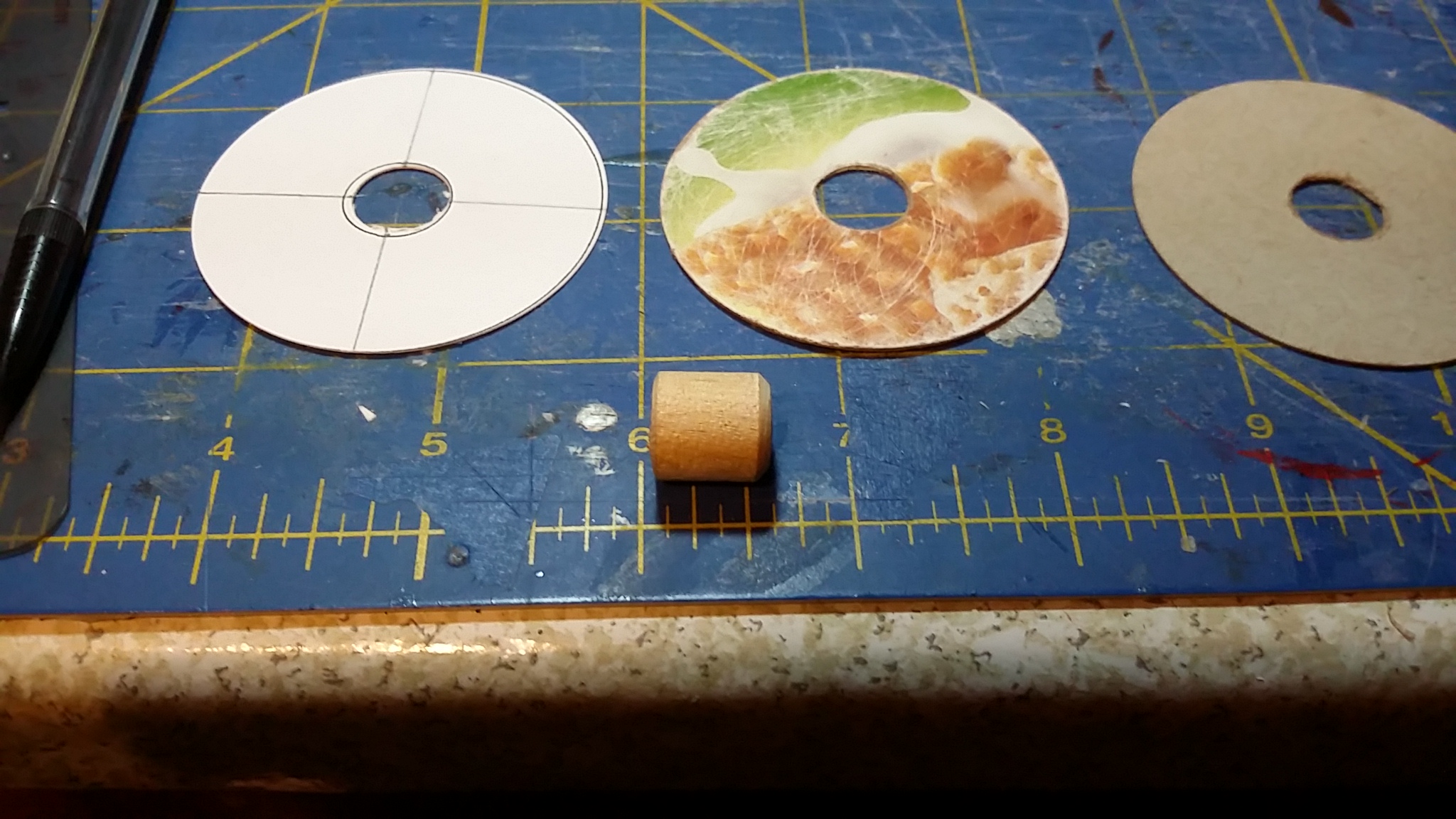

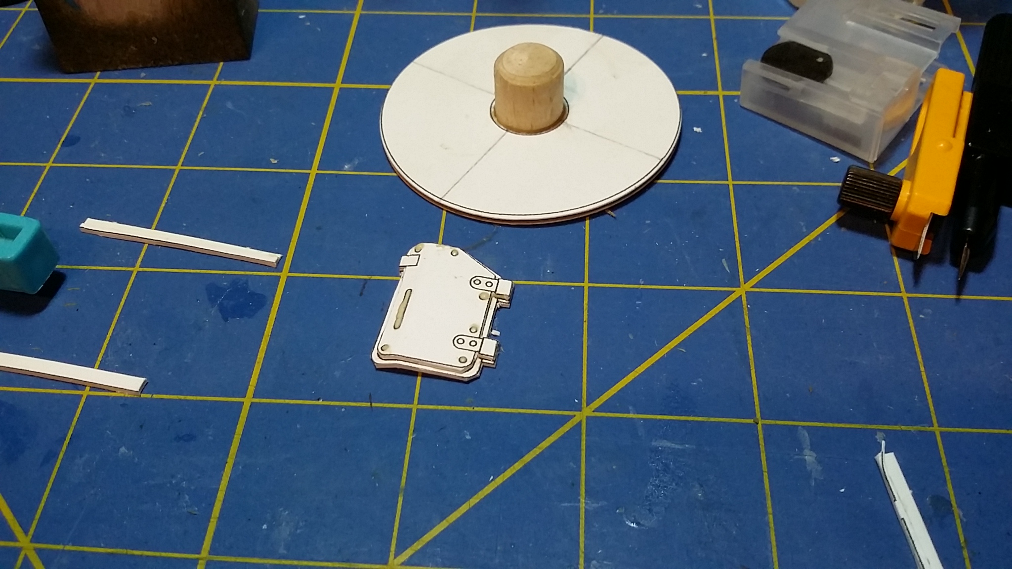

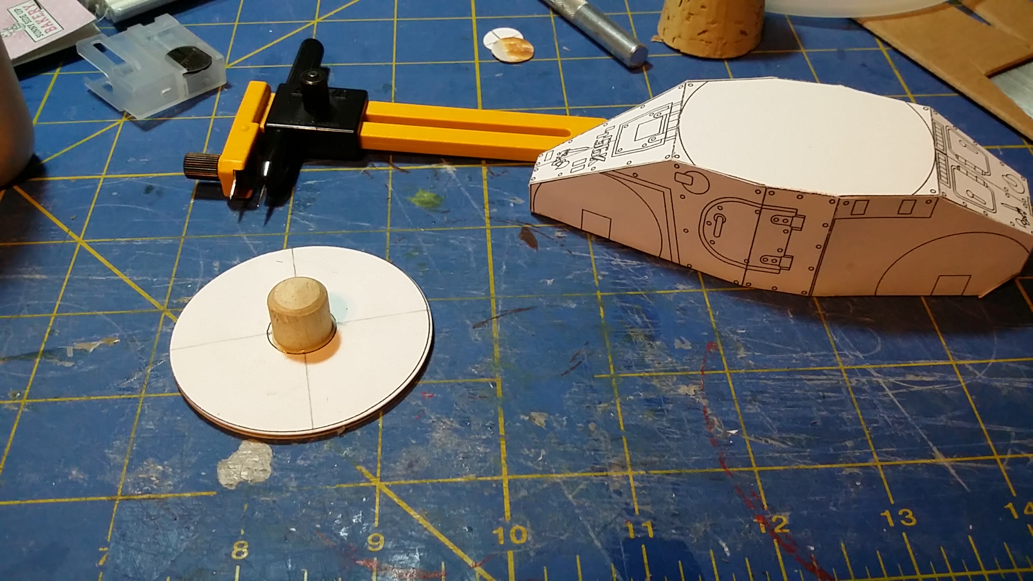

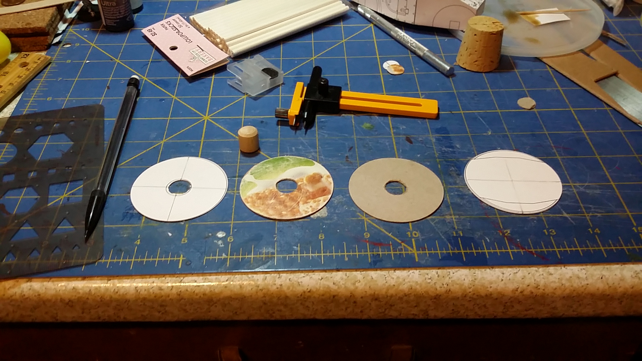

This is the turret base where it will mount to the body. This ring was created by two layers index cart stock with print-out, and two pieces of cereal box. Based on the reference, and nature of the part, I found thickenss of under 3mm to be about right.
That's right folks, I'm skipping the rolled paper tube for the turret pivot shaft on this one! I trued this peg up on my wood lathe from a 1/2" (12.7mm) dowel. This matches the about 9/16" (14.28mm) DIA holes. Switching turrents will be a snap, and standardized across the vehicles of this type now!

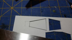

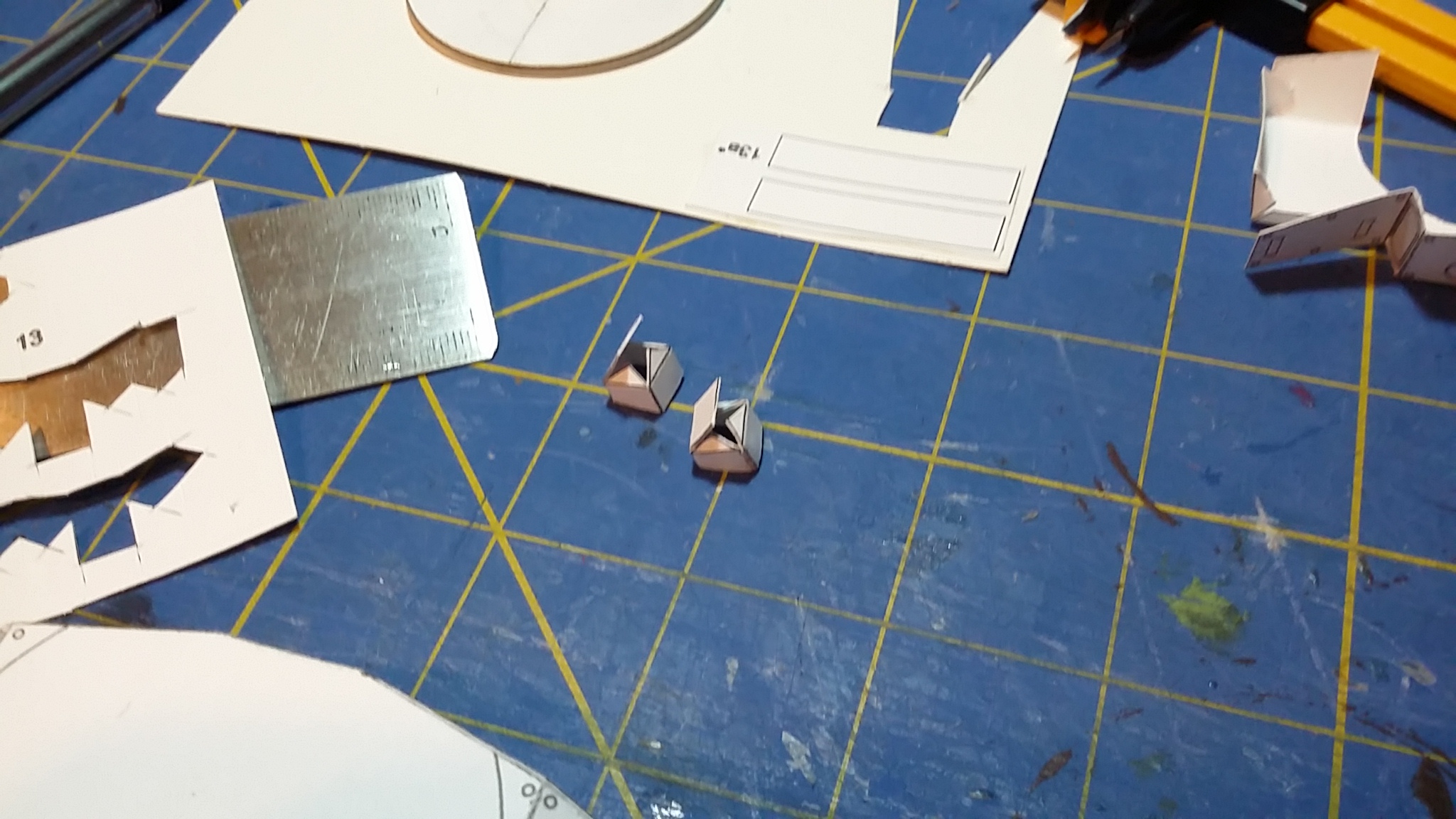

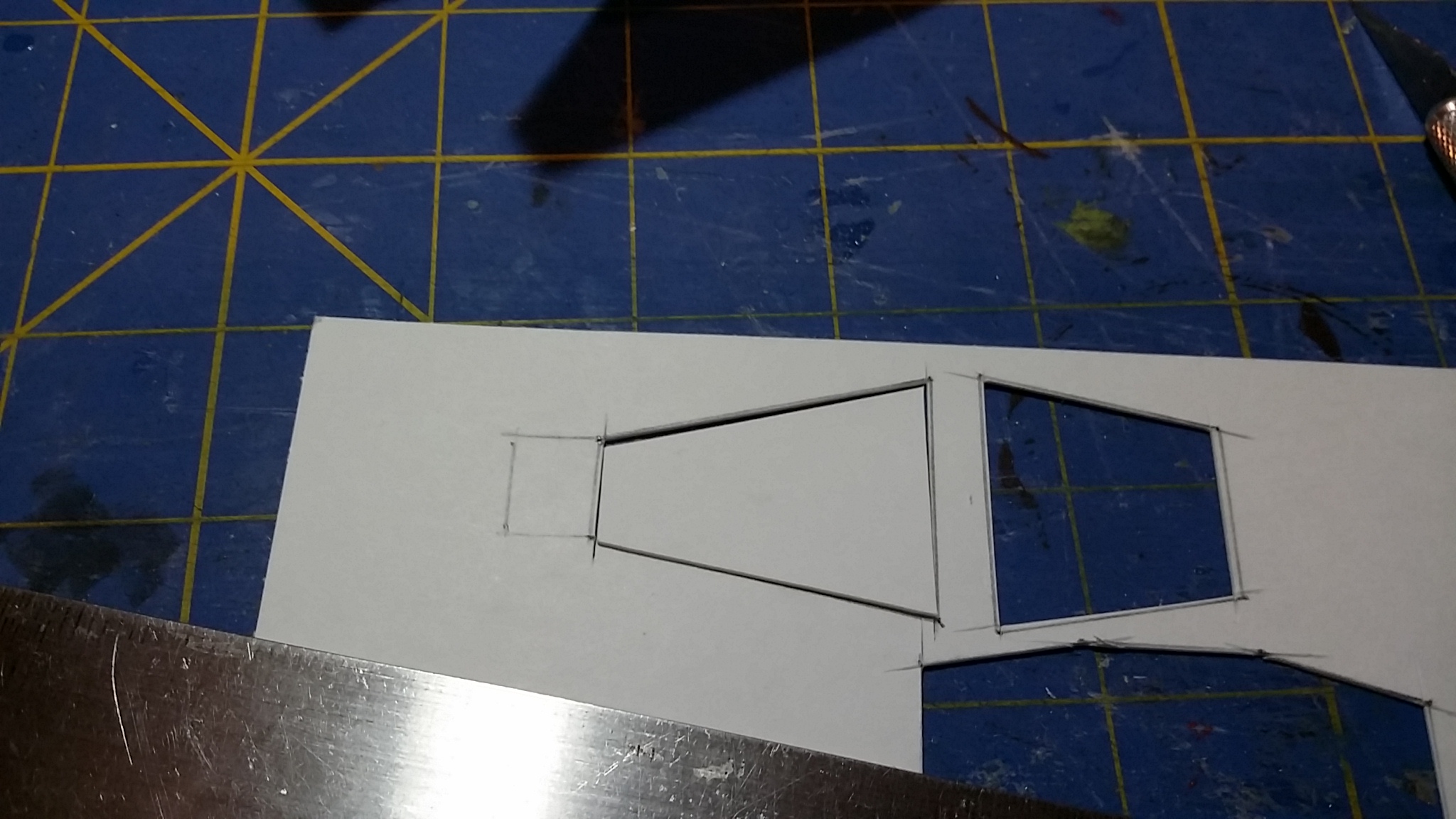

Next comes lamination. Thicker grebles were glued to the food card stock I used earlier, thinner ones to some 110# bristol scrap from my Genet 4x4 build a couple months ago.

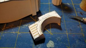

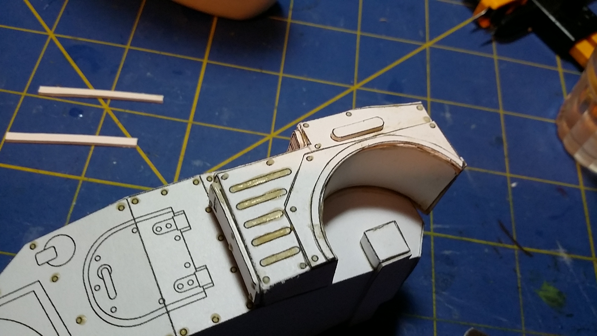

Wheel well

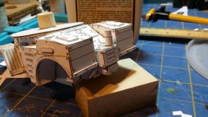

This one comes with quite a few parts worth grebling! Tank your time! Many do not exist at all on the real vehicle (especially those a-spalling rivets). Wood glue makes raised parts on the back of sheet metal look pretty good. We'll see if it translates into paint!
Wheel well with grebles and rivets complete!

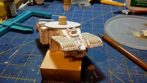

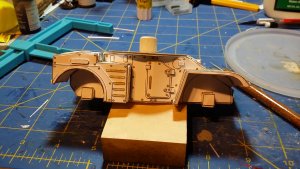

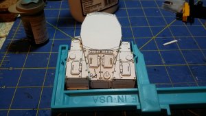

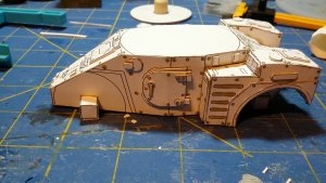

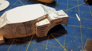

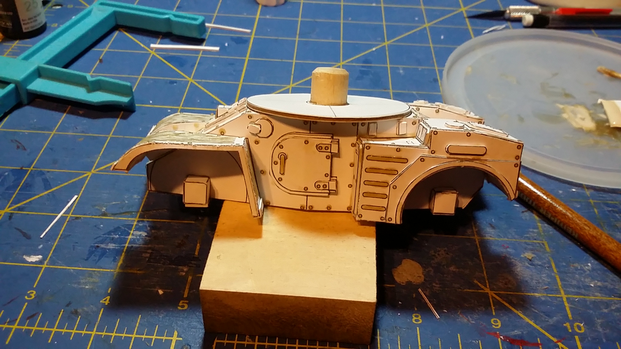

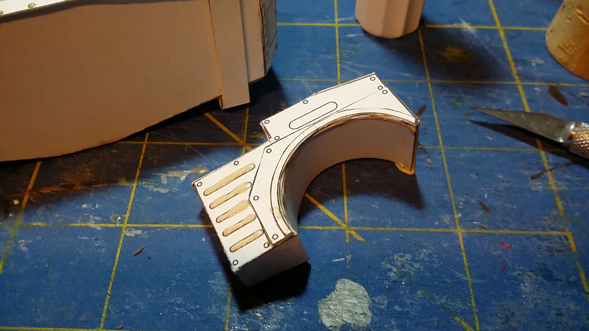

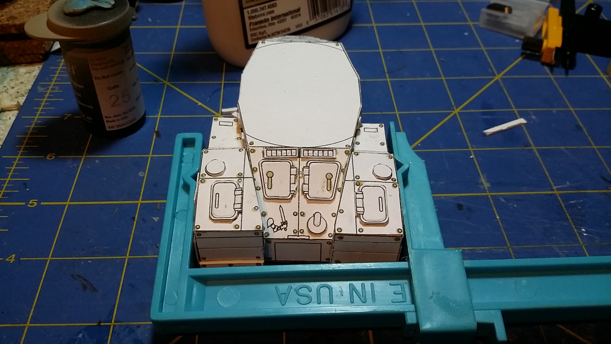

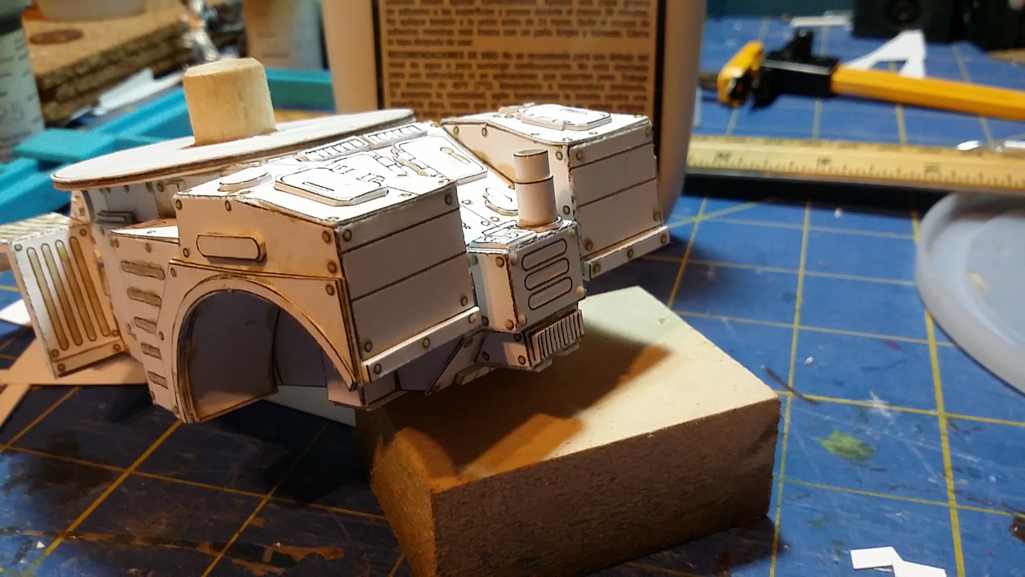

Tonights progress was the other rear wheel well, and engine compartment grebles for the top panels. Still have a few more details to add to the rear, the gothic steampunk style engine exhaust for example (parts 15 & 16 on the sheet). I've also managed to get the left side door completed. Finally, I got the right side door started with a few grebles left before gluing to the body.
I have had the same results as Gandolf, though maybe I don't use as much, but it does allow for a bit for future painting. Some glues don't like it, but the better ones stick right to it. ;)
Reactions: Sudsy and Gandolf50

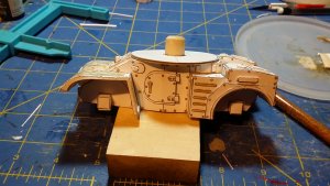

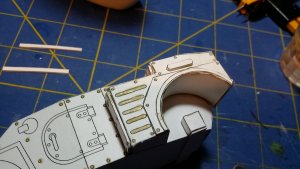

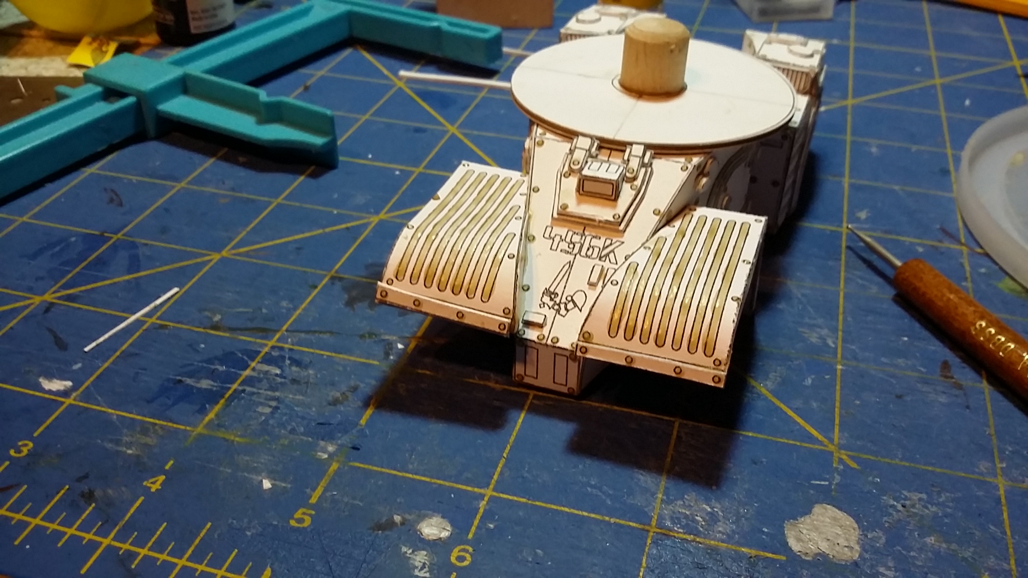

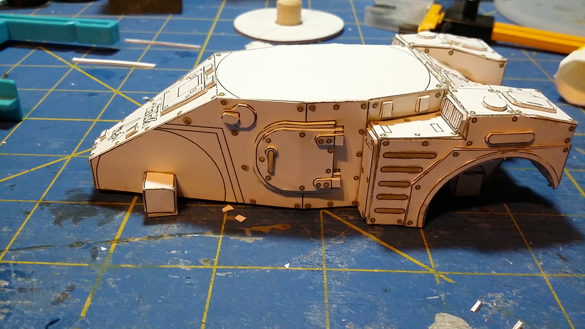

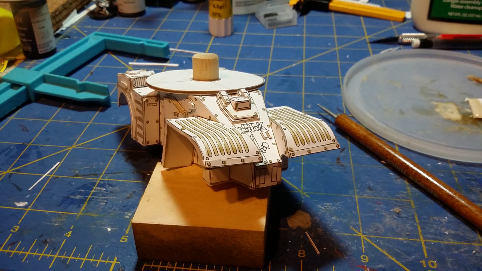

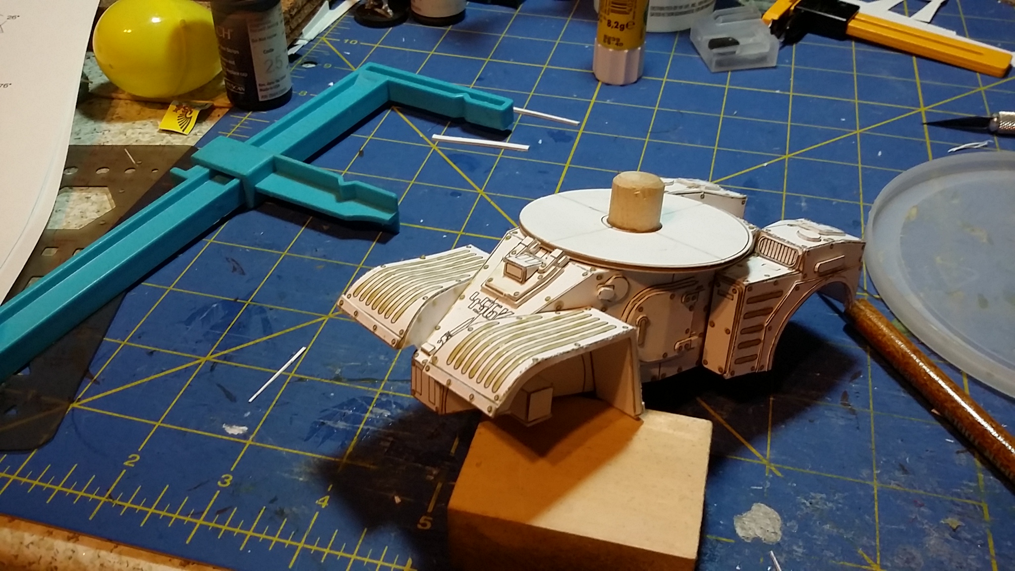

Tonights progress was the front wheel wells. Those alone took up a couple hours. Lots of grebling with the glue on a toothpick to get those channels in the sheet metal (ref. the real world AML).
I also got the drivers hatch glued into place along with the turret ring.
I did find myself having to improvise a bit on some rivets with the wheel well cover along the glacis plate, one of the parts was not mirrored, so the detail guide was on the opposite side (i.e. it is the same part for both left and right, rather than a left hand version and right hand version).
Still, since I'm painting it, all that will be covered with paint! So long as the rivets are in about the right spot, it'll look uniform enough for gothic science fiction!

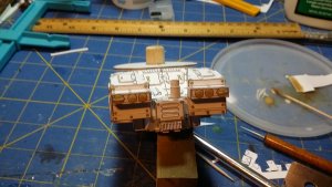

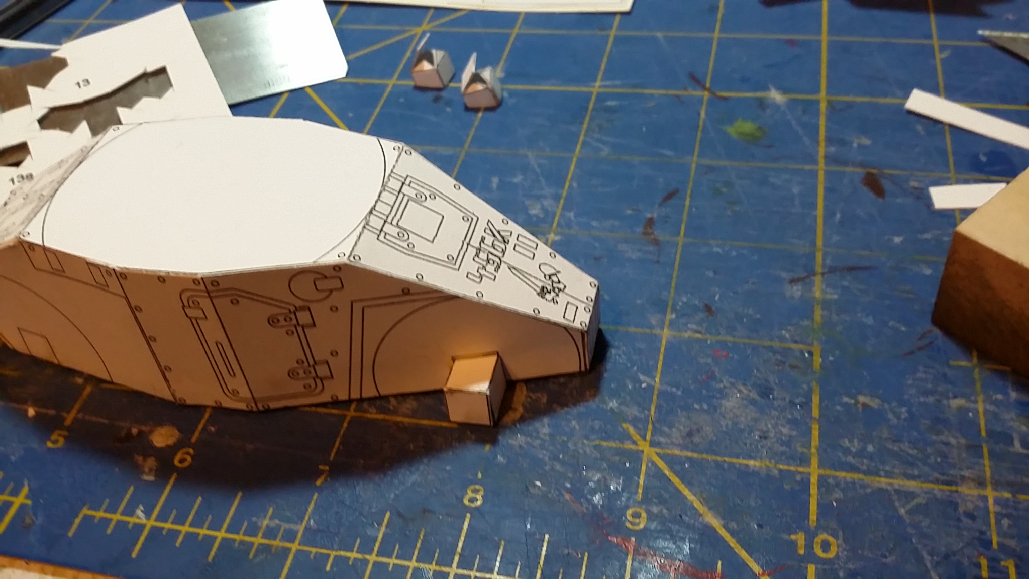

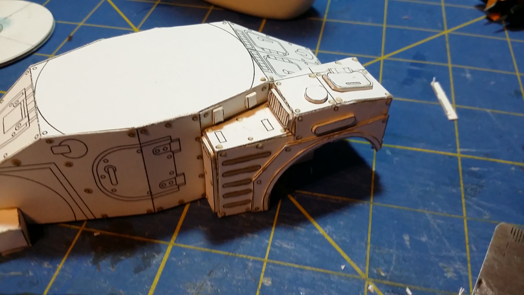

Father's Day progress! Part II, because I was up late last night, early this morning working on the front fenders!

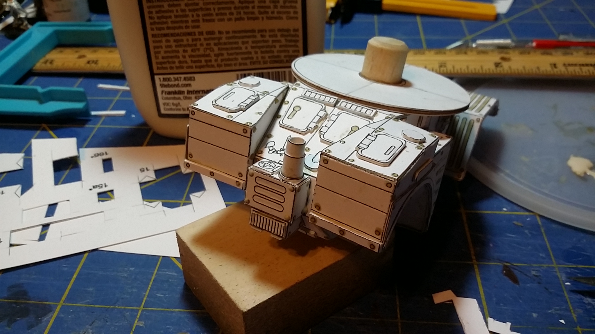

I started off with the gothic engine that brings this armored care into the 40K style.

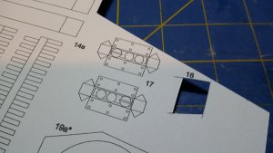

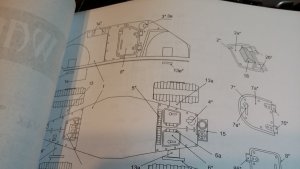

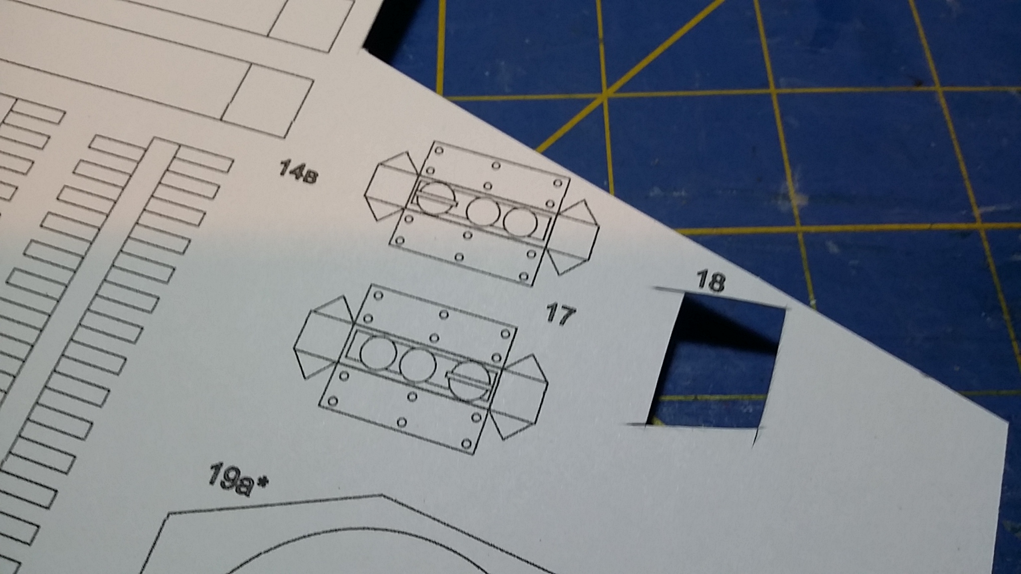

Then I was about to move when I was scratching my head over this mystery part, part 17. All my engine parts were 16's so I know it goes next in sequence (well, most of the time, such is NOT always the case).
In black and white, it is hard to tell what those. There is not leader with these in the assembly drawings either. Nor is there a view which shows this side of this part in the assembly! So, I was perusing the colored model parts when I finally figured it out. These are tail light assemblies! They go on the rear like so:

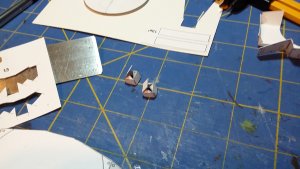

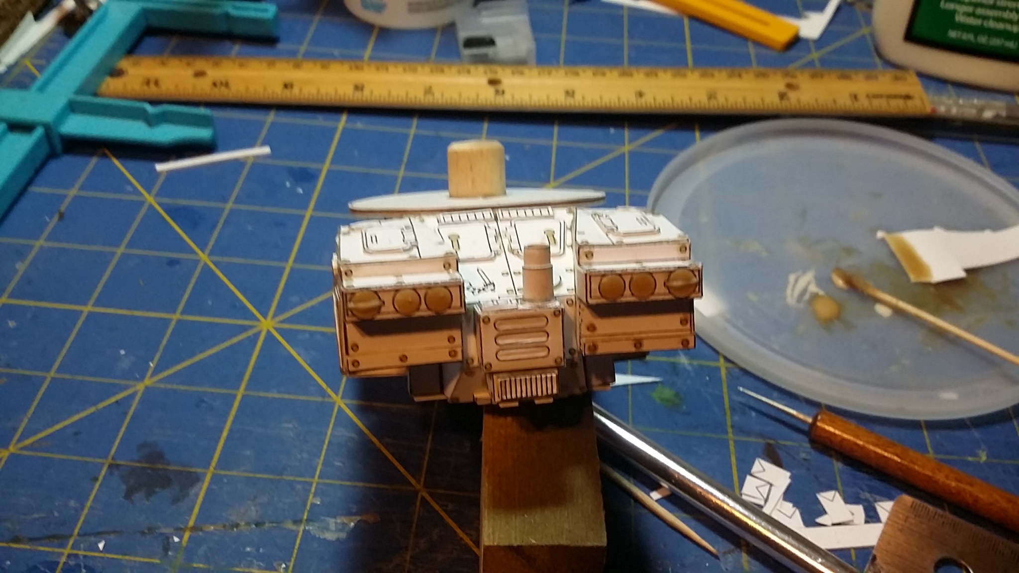

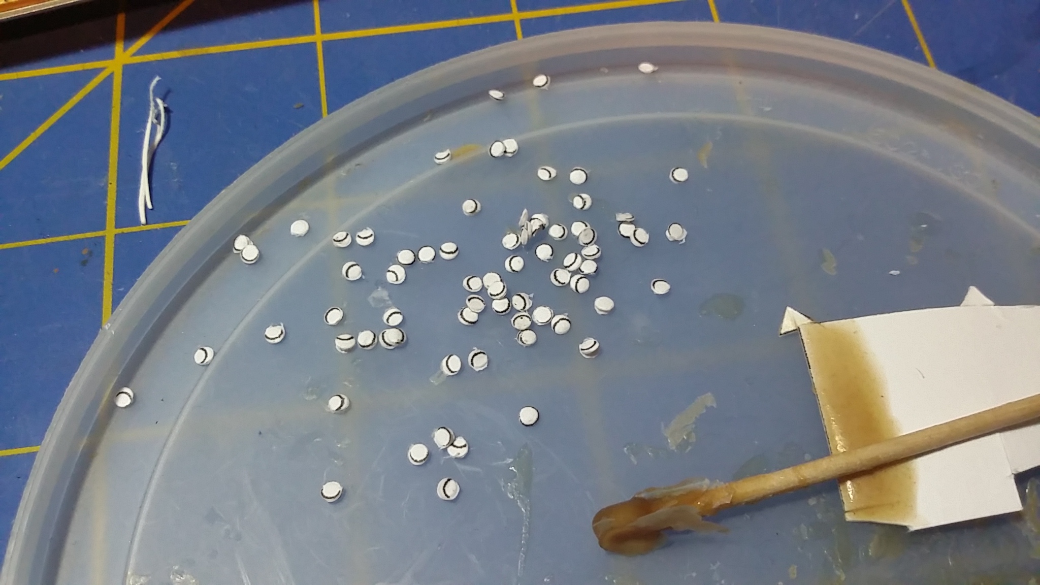

I took my glue and gave them 3D effect with the wood glue. I'm finding this a rather valuable method for me beyond rivets for this project. First it was the channels in the wheel wells, now its that bar across the tail light on the outboard lights.

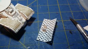

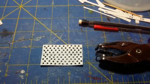

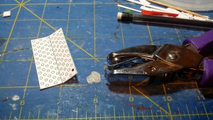

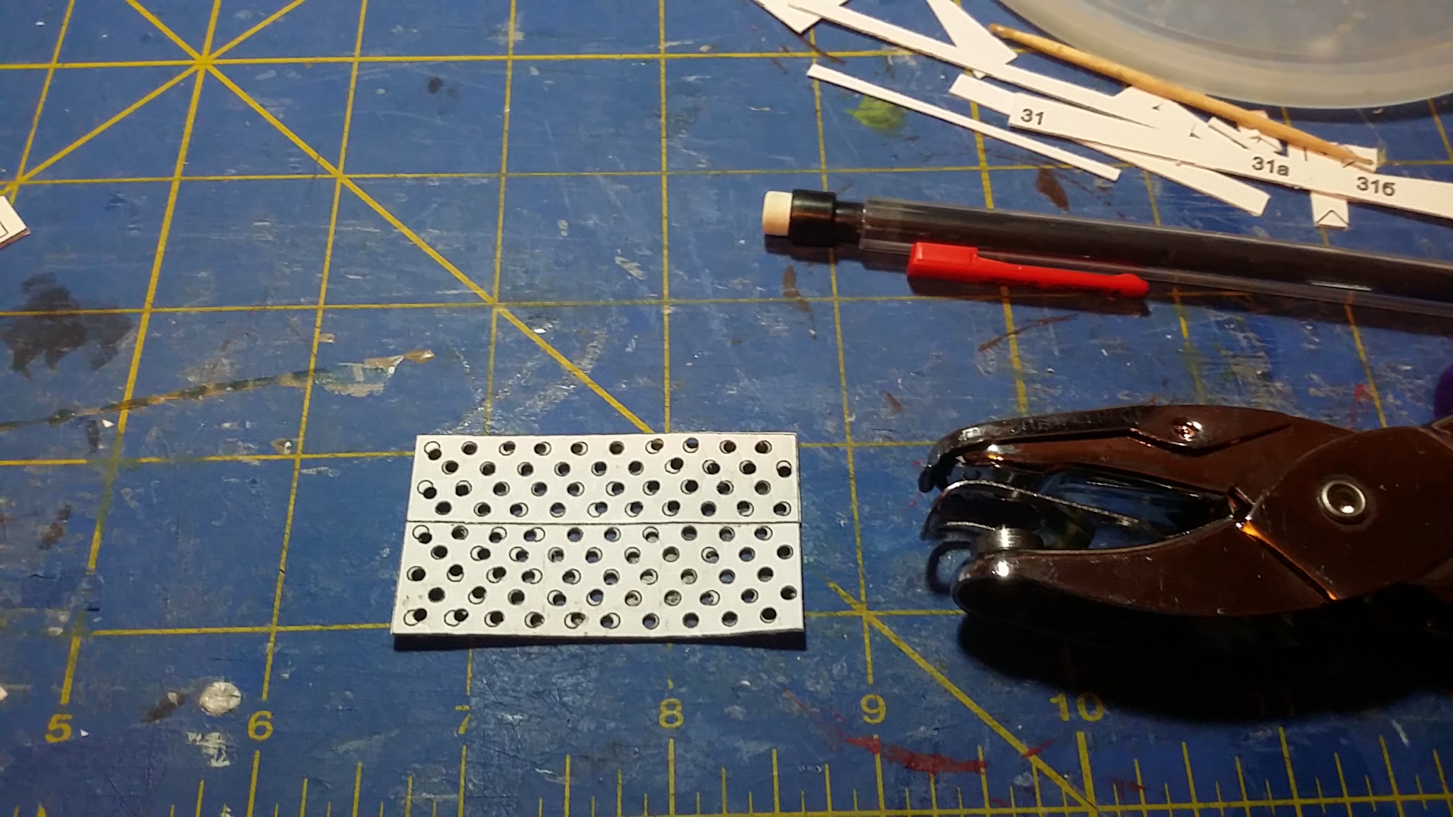

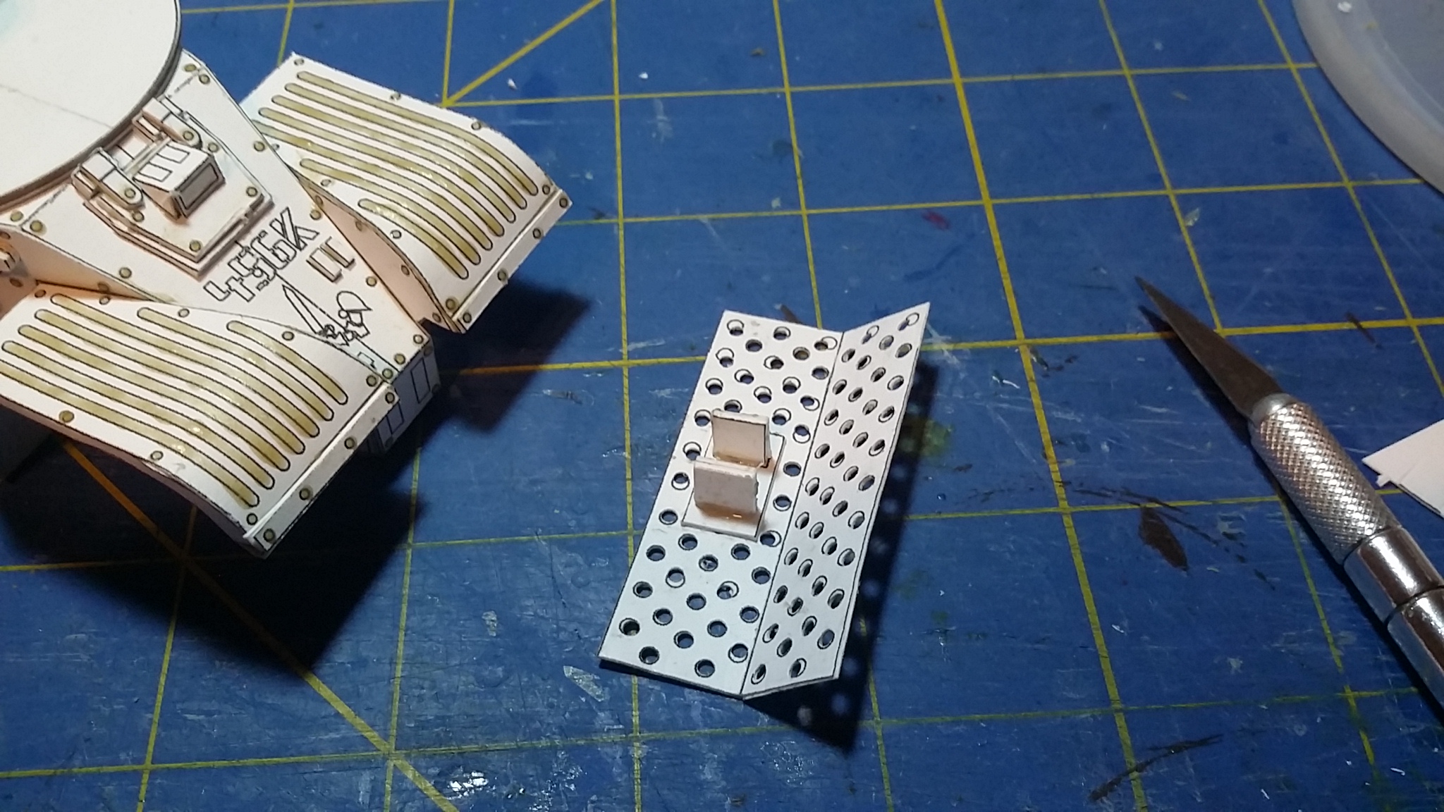

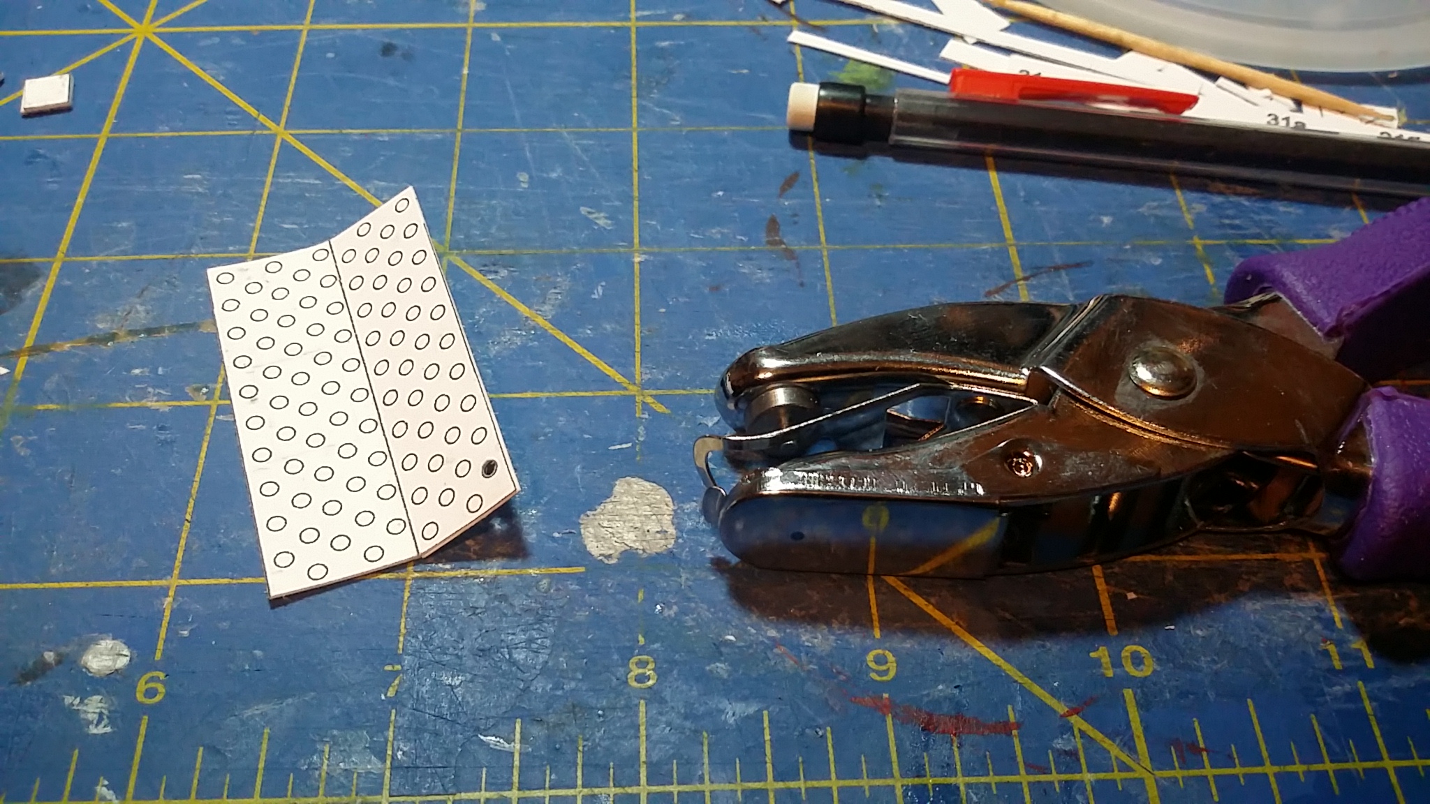

With the tail lights figured out, I have everything I need on the lower hull outside of wheels and the front peforated steel brush guard. I didn't have time to start the wheels, so I started on the brush guard.
My 1/16" DIA punch was the hero tool of thise piece! My brush guard even looks like it has seen extensive use after I finished punching the holes!
I am not too worried about the bends in it right now.

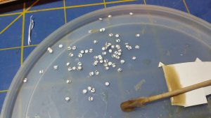

Rivets anyone? For larger rivets of course...
...I still prefer my glue dots thank you!

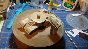

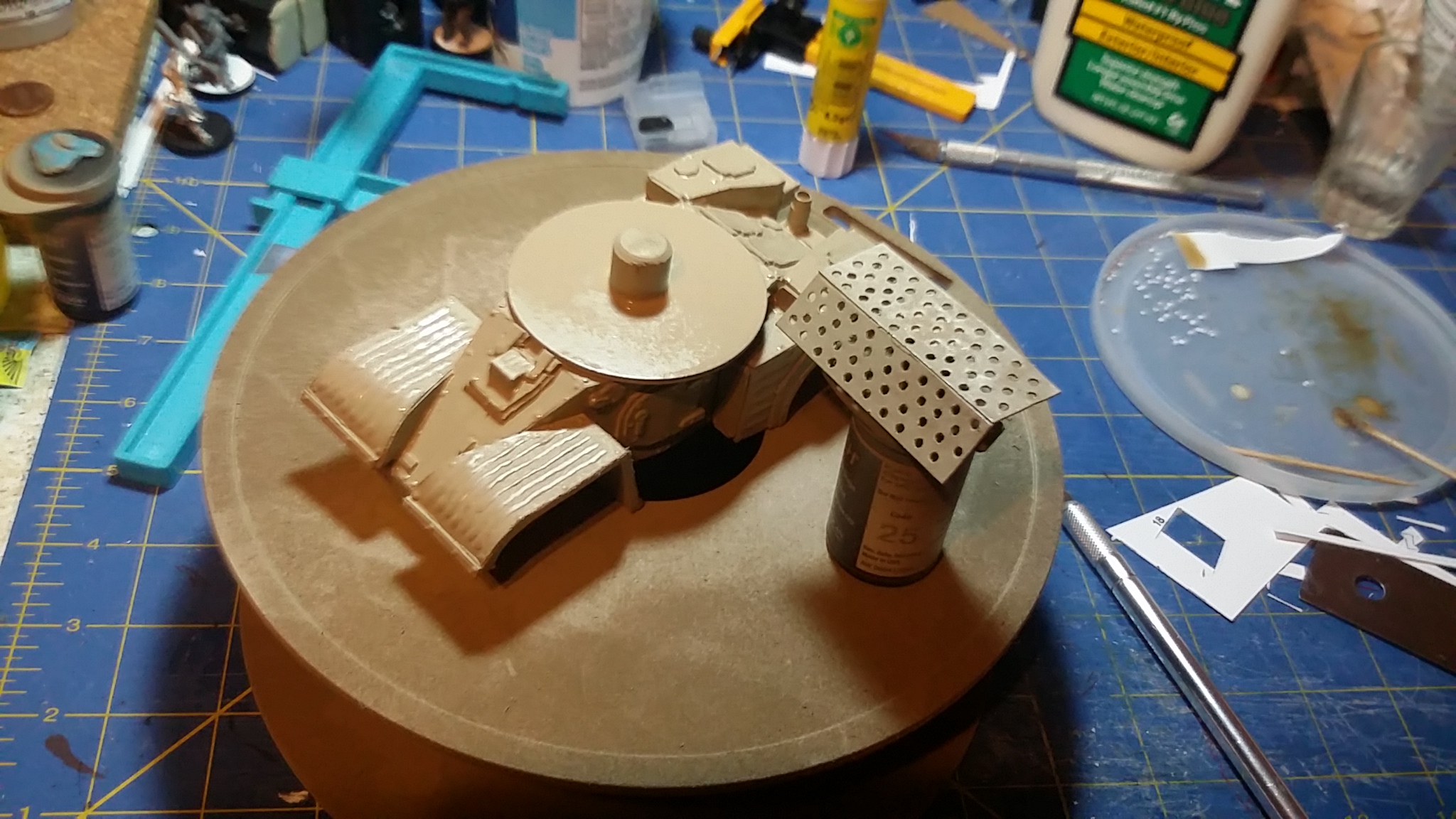

So, like I said, the warping wouldn't last too long. After bending and assembly. The lower body and brush guard are my first two sub-assemblies to put together after painting!
I couldn't wait for the paint to dry to snap this shot of the base coat!
Even wet primer looks great (well, wet camo paint used as primer at any rate...).
