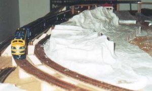

risers
John,
I just used 1/4" balsawood, with risers every 6" or so, and wood glue to glue it together. You can cut/shape it with a hobby knife and sands down smooth very easily. It's strong and I've had no problems. Don't forget your transition to the level to the rise. Do a search in here on "incline" and you'll find some real good info.

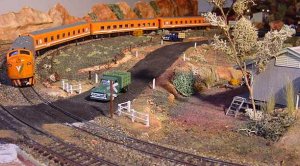

Woodie I like that colour scheme on the train in the last pic, but do all Aussie trains pull 3 G's on the curves? :)
The ones around Perth don't, (at least not while I was there) but things might have changed in 44 yrs.

I don't like it actually, as a coloour scheme, however I wanted the setup. It was a scheme introduced in Victoria in the late 70's, and there is still rollingstock around with that scheme.
Pulling 3G's?? Yep... and it's stationary too! I've mentioned in here before about my curves being too sharp and unrealistic.... that's the consequence. That one is 20" radius.
