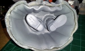

And this is what's in the box,
I guess it's technically a Mixed Media kit, as the figure itself is vinyl, but the walking stick is styrene. The kit also comes with two left hands in different poses.

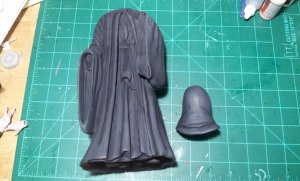

I figured the best way to show what the reshaping did was to outline the part before and after I reshaped it. I started with the cowl / head, before and after reshaping outlines side by side.
you can see the subtle change I made to the shape of the mounting area of the cowl.

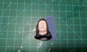

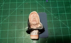

getting the flesh tones of the face and hands done.
Next is to get the eyes and mouth detailed out.

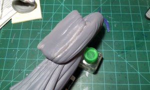

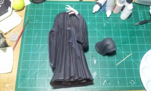

and as the coats of paint dry on the face and hands I got the seems filled on the left arm joint.
The filler material itself is an alternative material, Dental Wax...
The Face and inside of the cowl are done,

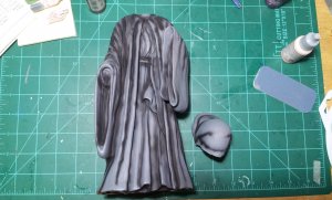

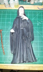

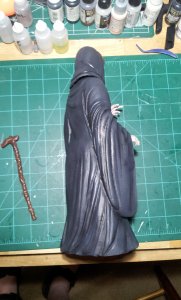

and the first base coat of Heavy Charcoal applied,
you can see how subtle an effect the pre shading is.
Next will start post shading, then highlights.

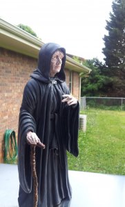

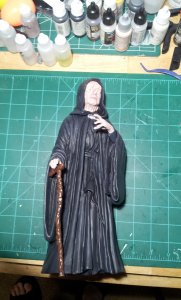

Thanks RB He is a nice addition to my collection.

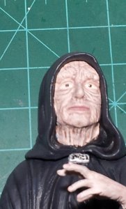

I got a couple natural light pics
20140523_155342.jpg 20140523_155355.jpg 20140523_155409.jpg 20140523_155419.jpg
