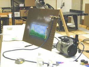

I have a pretty nice setup I think, got it at an art store so I probably paid too much tho they did cut me a discount for buying the whole rig. I've got a Badger double-action internal mix brush model 155-7 which came with a 6' braided hose, that standard cup and some bottles with siphon caps. My compressor is a Badger Cyclone I model 180-1, diaphram type, 40PSI max., never needs oiling. A Wilkerson 50-054 regulator with filter trap and gauge.
I made up an easel out of pegboard with adjustable legs that I saw on another forum, this makes painting MUCH easier. I got some waterbased paints that I've been playing with, now I need to get more paint and more bottles.
Heres my first experiment at scenery, and all the things wrong with it....lol Didn't prime wood..I'm impatient and I just wanted to PLAY..lol Used paper for templates..too flimsy. Didn't use template for hills..too fuzzy. But I learned alot and the clouds actually look pretty good, better in this pic than in person. :)
