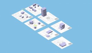

So I searched a long time for a good 3D warhound model to work with, and couldn't find it. So I decided to start a new lunchtime activity and back drive a 3d model from JSV's DIY template. My goal is to eventually use this to make a pepakura file out of.
I originally started JSV's template, and ran into alot of issues first with scaling, and then the lack of tabs. So I went into powerpoint and made my own tabs through trial and error. After one leg I gave up because of the workload. So this will be my attempt to rebuild what he's already done and have a clean, pure paper build, start.
The other added benefit is I can texture wrap the model as I see fit, and wouldn't have to deal with powerpoint to do any textures.

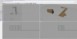

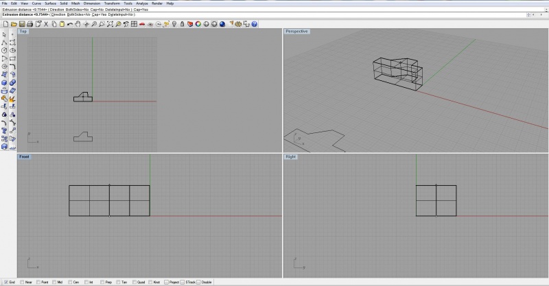

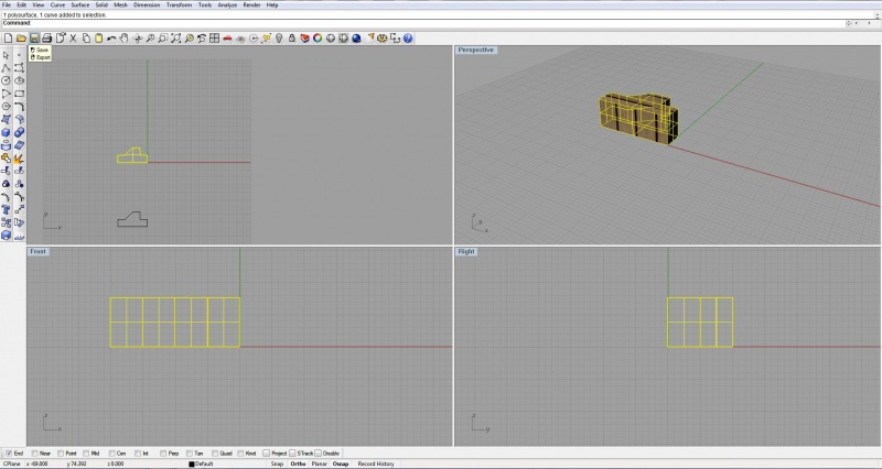

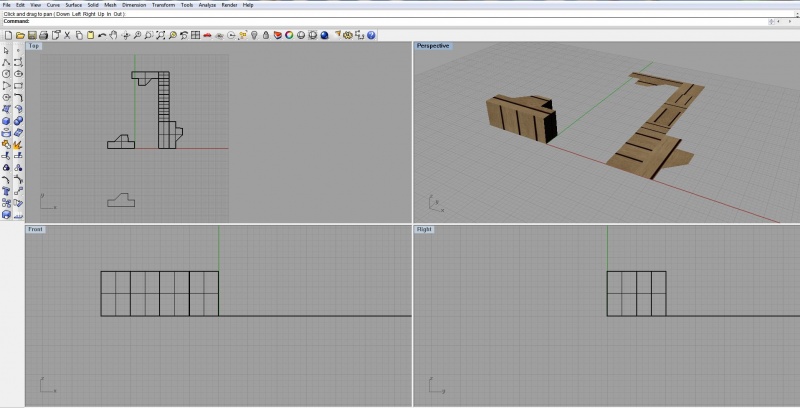

I wanted to show you something that took 3 minutes in Rhino, as an example per our discussion. The unfolded model can be exploded and it's piece put where ever you wish. :)
First pic, draw shape/ Polyline command
2nd pic Extrude Surface (Select YES for CAP, NO for EXPLODE)
3rd pic Apply Texture in Properties Window
4th UnRoll Developable Surface, (No=Explode, No=Label)
The textures do not unroll with the part, so I reapplied them to the part. You can make them do that, but i need to work on my barn now! :)

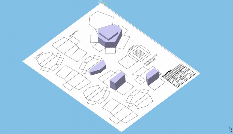

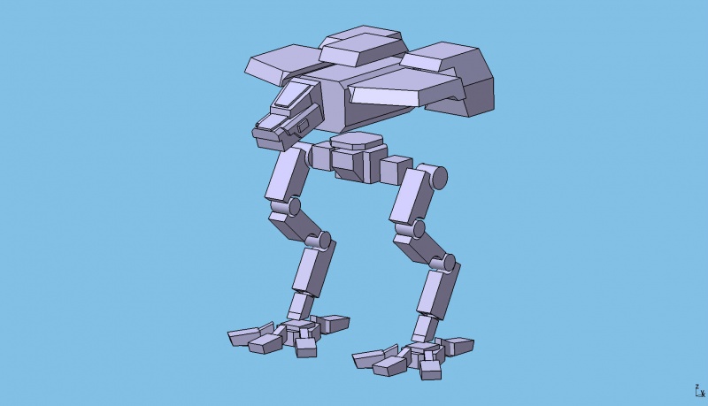

I'll have to try, Catia is my natural fallback obviously. My plan right now is to take these pieces and save off as stl and go right into pepakura. I'm wondering if maybe I can get them into Rhino after making them in Catia? I know I tried that with a complex model with curves, but this is all facets being back driven from the folded model.

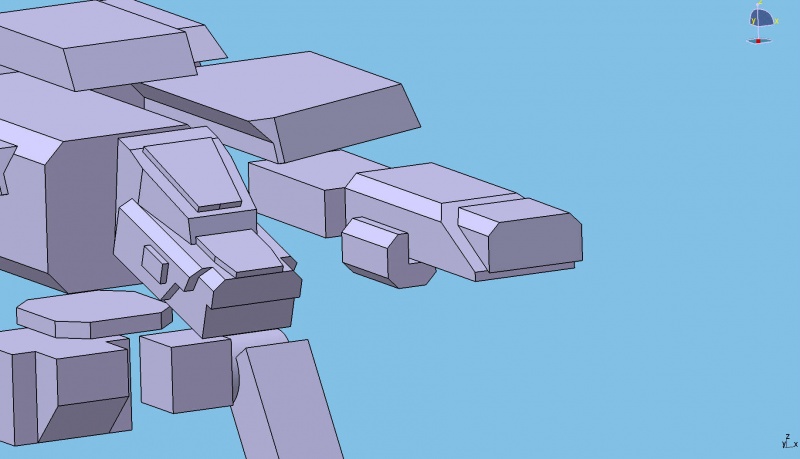

I completely redid the head from what JSV had on his template. Just wouldnt go together as nice as I wanted, and didn't match the forgeworld model that well. To show progress better I created a stiched model of all the pieces relatively in place but slightly exploded.
To do list is the weapons, and tweak the toes so they go together better. Won't have any new updates until next week, will be too busy this weekend to work on it.

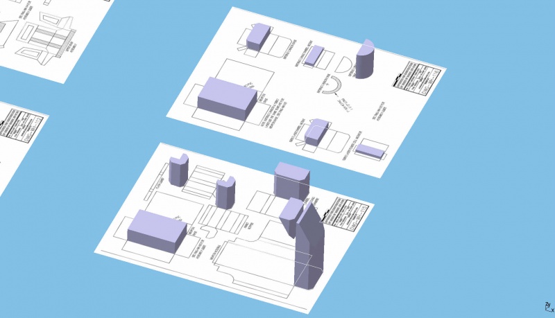

Lunch cut short today. Only time for two weapons and assembling one of them. I changed how cannon goes together for cleaner fit.

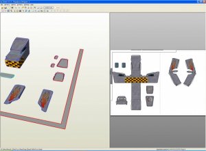

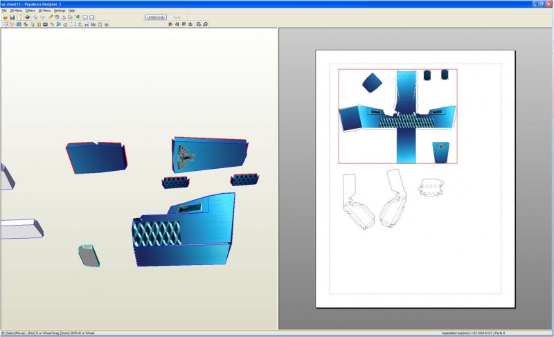

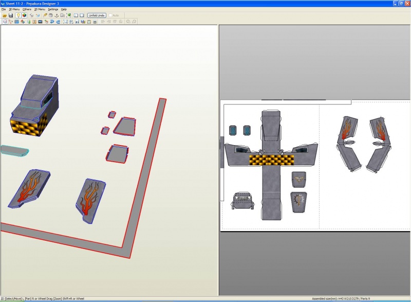

Quick update. All parts are made and can be brought into pepakura. I put together the head in pepakura, and slowly been experimenting with the texture mapping. I've used the pepakura texture map export feature and put that into powerpoint and been editing in there. I didn't get fancy with the teeth area because the jaws will cover it anyway giving the mouth effect.

Quick update. Noticed today that somewhere along the line ended up with a scaling issue. Not sure how. Everyhing brought into Pepakura was scaled down by 1.88. Finding the scale down meant going back to CATIA and comparing to the printed out length. Anybody with pepakura knowledge know what might have gone wrong?
Cheers,
Leibolmai
Edit, found this post here. Doesn't answer all my questions but helps a bit.
http://www.zealotmodels.com/forum/showthread.php?t=160199
Anybody know what it means by Assembled size? --Leibolmai
I think if you P.M. ARMORMAN, tell him I sent you, he will help you out, his knowledge is vast! :)

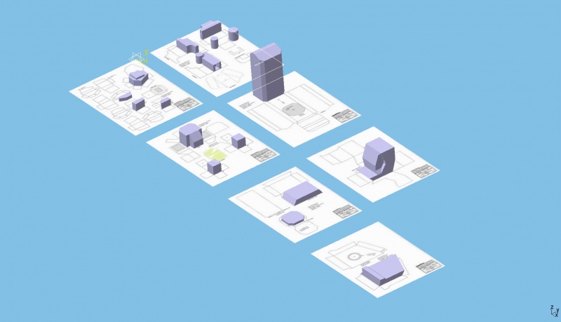

I rebuilt the templates in 3D in CATIA V5, then I'm unfolding them in Pepakura. Right now I'm still experimenting with different texture techinques and to get the scale correct. I figured out the scaling issue in pepakura it was not intuitive at all, and since its only in mm's doesn't convert cleaning (what should be 215.9mm is either 215 or 216). My goal is simply to "Pepakura"ize this set of templates allowing easier texture, and flap additions. Once I get that done, I'll go back into CATIA and start making accessories and add-on packages.

Just minor update, been very busy with real life lately. Switched to Canvas for texture creation, can never seem to get the texture map bmp that pepakura outputs to line up after export, modify with cool stuff, and re-import. So takes alot of tweaking. Canvas seems to have slightly better quality, but not much more then powerpoint. Didn't solve the alignment problems I was blaming on powerpoint.
