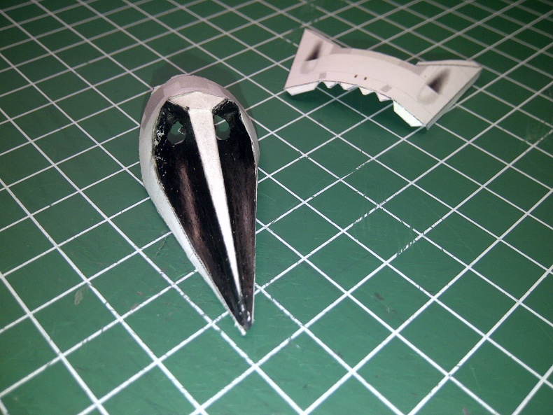

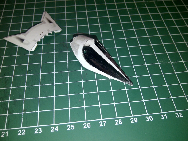

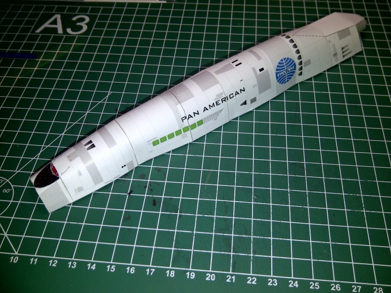

I bashed this together yesterday over a few hours, but the print was ink-jet and not as durable as I would of liked, (I was spoilt in the past.:oops:)

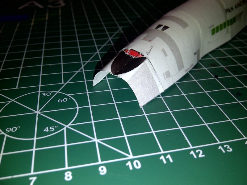

The fuselage... Not happy with it. I can see the joins. A ...kin blind man would see those joins.....
Results of bad print quality, and/or over enthusiastic fingers, are evident in the cockpit windows.
The former still needs to go in to shape the nose section, but the joints are terrible.
I had dreams last night about a bird that I killed, when I was very young....
I kept seeing its mocking skull before me.......
Putting the thing together, was just as much a nightmare!!!

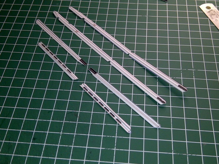

Oh, and some of the edging for the wing assemblies....
This is not looking to be a clean build by any means....
This is my test bed! When the wrinkled, warped, ungainly beast finally emerges from the maws, I'll set it to one side, as an example of how NOT to do it .....sign1

I admire your smooth balls discourse, thankfully, this is a forum, and no contact is possible. :) I am delighted to see this craft. It is an all time favorite and should prove to be an excellent model, neuter or not! :)
It looks like you are off to a good start. You are doing a GREAT job.
You are doing a much better job with this then I could. I still have a LONG way to go before I can think about mastering this technique.

Hiya fernandico, I was using 120 gsm paper for this version. But, the print quality was terrible. It did not matter how careful I was, the print cracked at the folds. Anyway, in my limited experience in this hobby, I have found 160 gsm to be the best general use stock. If you need to do fine details, then use 120 or even 80 gsm stock. 200 gsm is good for laminating other parts and also for parts requiring structural strength
When I restart this project, I am going to use 160gsm paper instead, especially on the fuselage, for rigidity. Laminating the fuselage formers is advisable, and accurate placement of these formers is crucial to keep the lines of the fuselage clean and smooth.
The photos I have posted are a good (and embarrassing :oops:) example of how NOT to do it.
