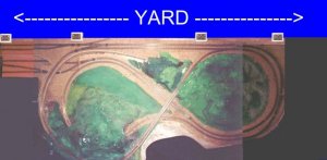

heres a overhead veiw of my layout
- sorry it s bit lame/old, but its hard to take overhead photos becuase the ceiling is in the way!! -and ATM my camara is out of action
- as you can see from the photo (just about), there is a turn out onto the yard area towards the top left, and another on the curve on the far right, (which has been relayed about 100time since this photo - and now looks much more prommising!!)

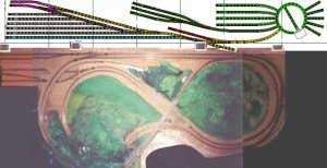

- i have added it onto the other photo, just to see how it would look
- on thing im a bit worred about is that to get across to the "yard" i have to back into on the the sidings on the main board, i could just add and extra crossing on the right (draw on in blue) - or i might move the other crossing right a bit, or somthink

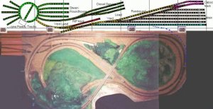

well, i was playing about, and i though, maybe it would be an idea to mirror the whole yard idea, so i came up with this \/ \/ \/ :)
daniel

Ha Danial, I think the first one with the turntable on the left would work better, the first track in the yard can be a A&D track if you add the return you have "penciled" in. the other way you only have one way in and out. I like your layout, great use of limited space. :thumb:
yeah, i was wondering how well a design would work if i just fliped it over, does it matter if all the turnouts are LH not RH, is that "wrong" - will it affect oprational ablity at all?

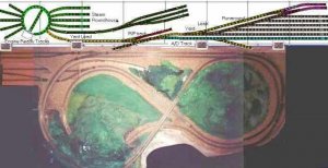

Well, i've tryed reading about designing yards for long enough, i think i need to have a go at operating one now, and seeing as i need to build it before i can operate it, im going to get building. I know it would be better if i could find someone who had one i could try first, but i know that wont happen, so im just going to have a go, and if need be i can always relay it next year, once i know more about it, but in the mean time the best design i have is the one "screwysquirrel" posted, which i've adaped slightly, becuase amongst other things the yard is accutually 8foot long now, so the yard lead has been extended, and the extra turnout had been added to the arival/depature leg.
