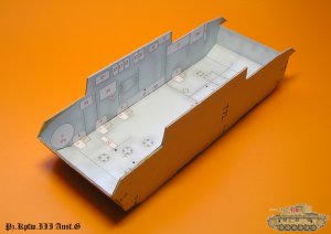

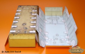

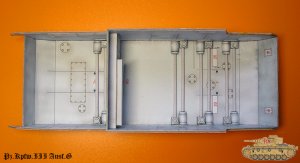

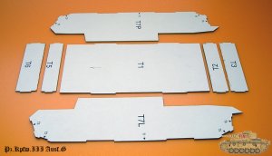

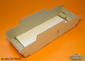

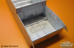

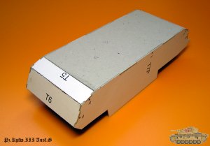

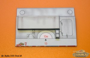

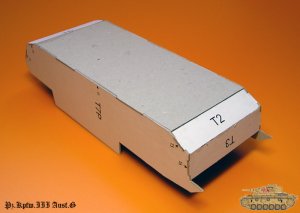

Well, let's start!
The frame. There is no sign on which cardboard you need to glue it, so after some measurements, i decided to glue it on 1 mm cardboard.
The pointing on side parts is wrong and little parts must be glued in reverse. You will see it on pictures.
Also, i cut out inner and outer skin, but glued only inner for now

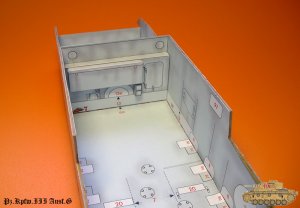

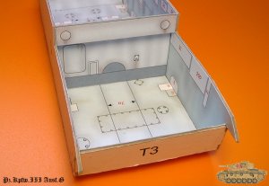

Made a partition between main and engine compartment
Instruction suggests to glue the part on 1 mm cardboard, but gluing place shows that 0.5 mm will be enough.
So I understand, that I will be in need to check every detail that must be glued on some cardboard, to see if thickness is correct

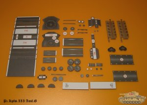

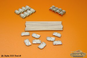

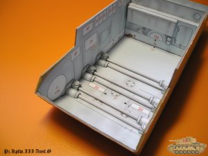

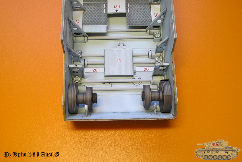

Today I completed torsion bars system
There is no need to cut inside part 8 for part 8a, because it will not enter inside, and only in this way the length of bar will be sufficient, from wall to wall
Also, I advise not to assemble and glue parts in blind matter, following the numeration. Sometimes there is no logic in order. Like with parts 7 and 8. First you must glue part 8 and then 7

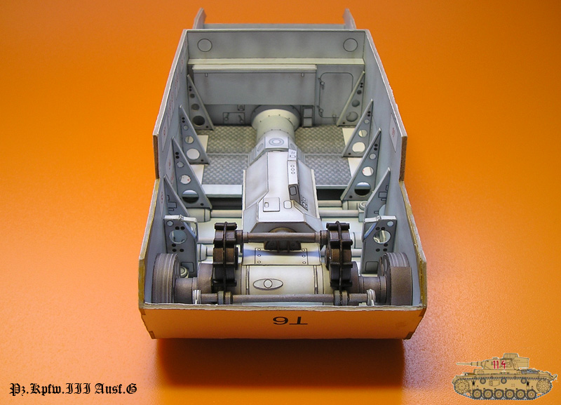

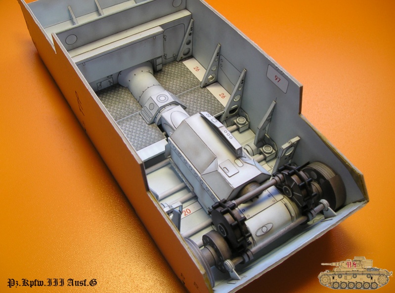

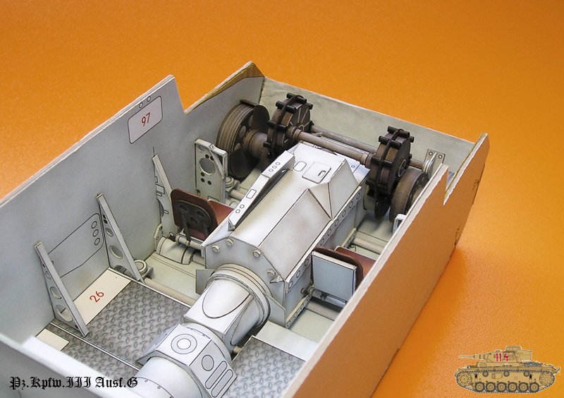

Gearbox
Some parts need to be adjusted, but in general there was no problems.
Also I noticed, that cardboard circle diameter is equal to whole strip with gluing leaf. You can adjust the circle to strip diameter, but all gluing places based on diameter of the circles

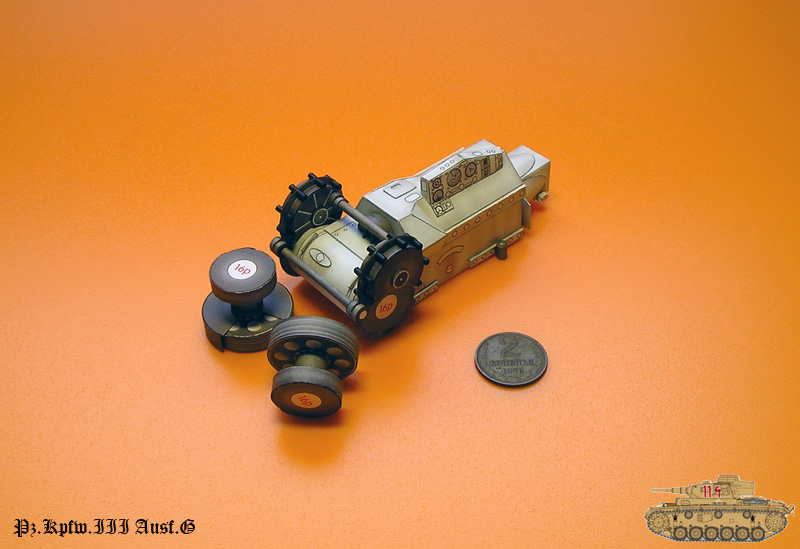

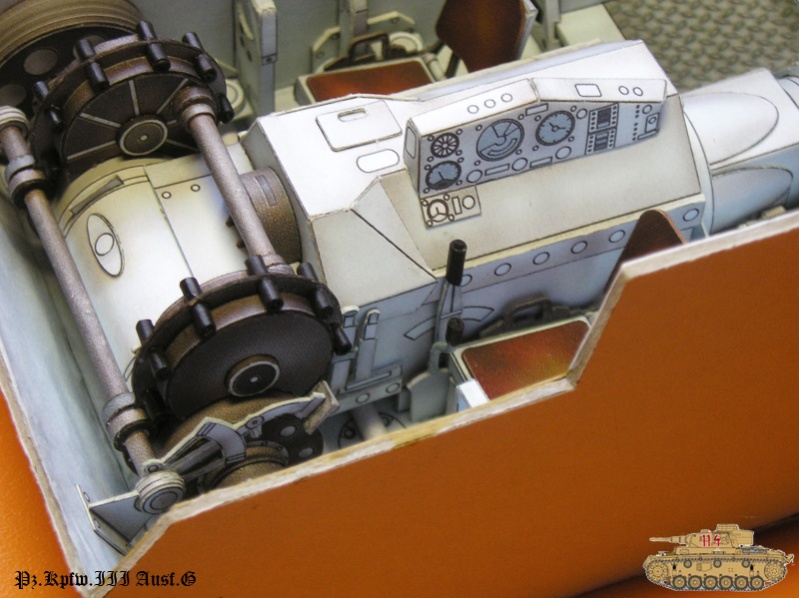

Hello!
After a little vacation, I'm back to business :)
You're right János, transmission block took some effort to accomplish.
I advise to assemble all parts apart, to measure a lot and then to adjust everything to its place, because one part depends
on another and if you glue all parts together and then try to insert it into hall - you will fail!
As you see, side drums are apart from main block. Also, after some adjustments, it became that main block glued as its upper crossbar sticks into gear box.
After that I glued 2 drums to their places and only then the main part with gear box. Final step was shaft cover, that also needed adjustment to fit in place.

The transmission looks functional!!

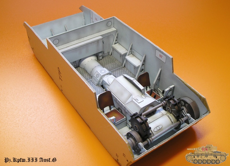

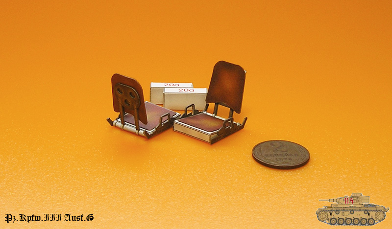

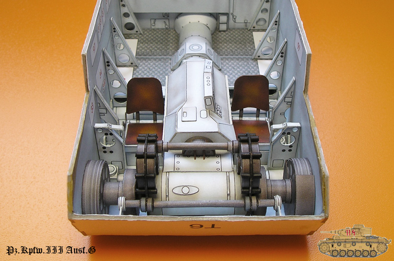

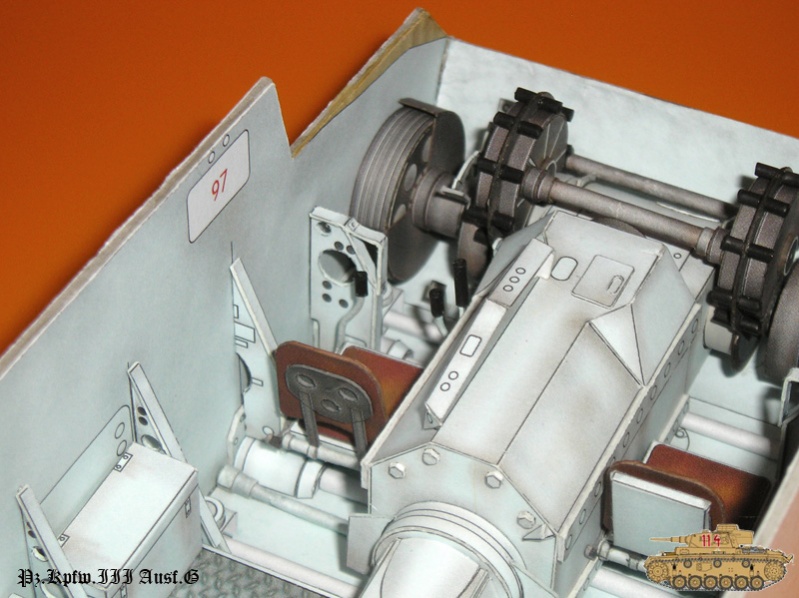

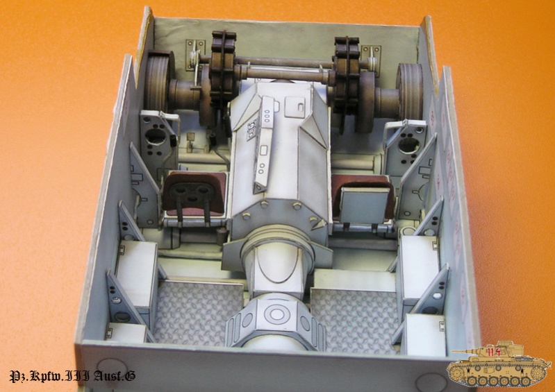

Driver and radio operator seats are ready
The trick to expend the place, when i glued supports, worked.
I've managed to insert seats with no problem.

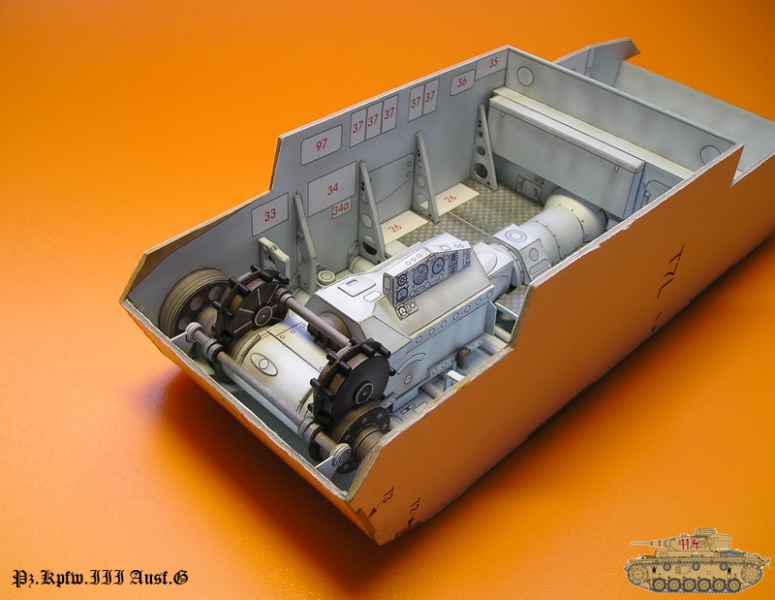

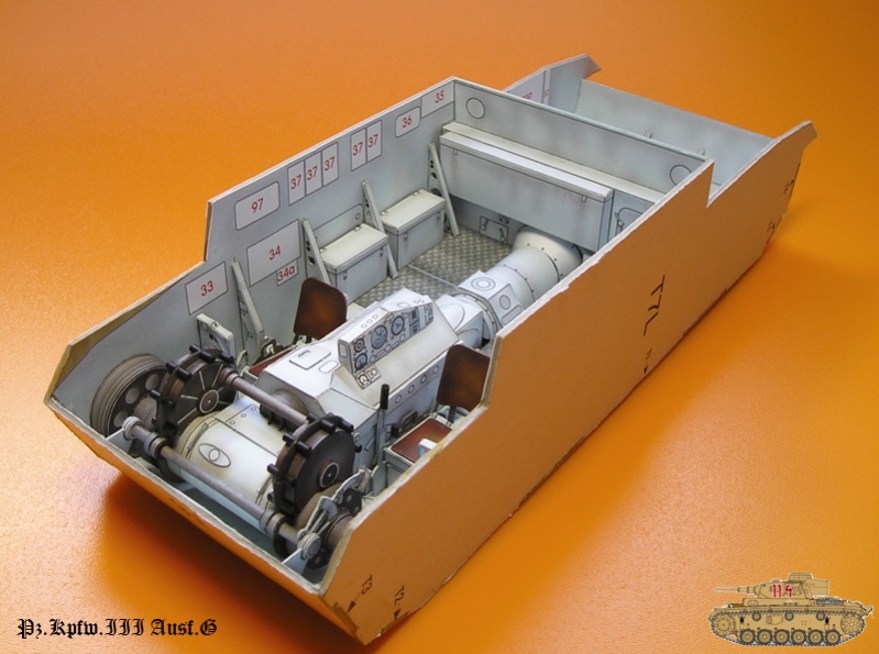

Made all the levers and pedals. Also assembled ammunition boxes

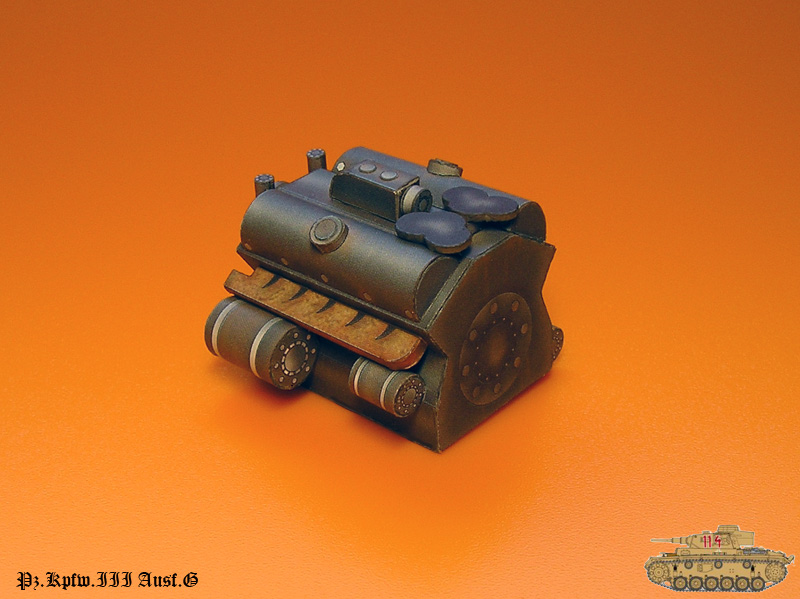

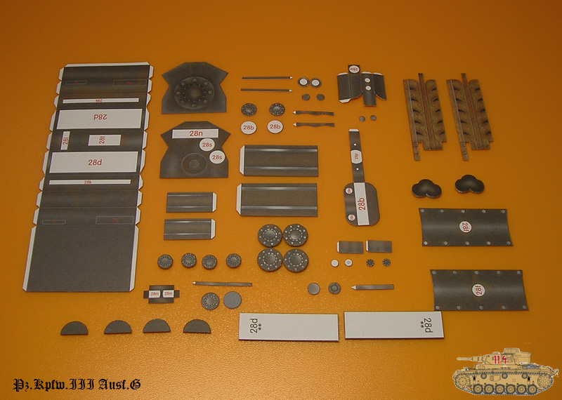

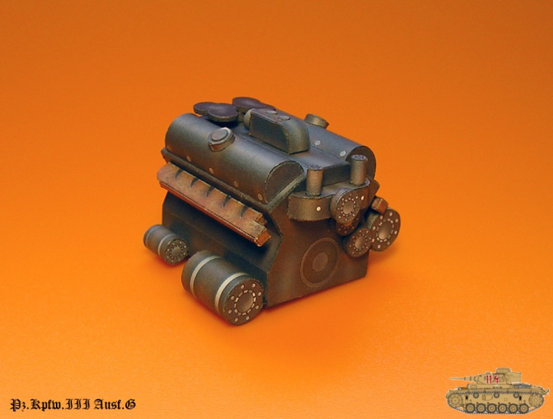

Engine assembled
I think it's too much simplified, but eventually only the top will be seen, so I'm OK with that :)

The engine looks great and if only the topis showing, there will be great depth when looking down into it. Very very nice!! I did not understand what you meant about gluing the seats in. I am amazed that the seem so rigid with such little supporting them? If you had a problem with them, you obviously figured it out! :)
