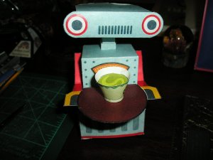

Here's some models I've done with Karakuri (Japanese for Mechanism) a book by Keisuke Saka a high school physics teacher in Japan that is also an aficionado (ok MASTER) of the paper arts.
These models have mechanisms made out of paper. I've donated multiple copies of these books to a local physics program where I live for the students to learn about mechanisms, but also to introduce them to paper modeling.
This is the robot tea carrying model.
Note the cam mechanism underneath in the center. As the robot is pushed along a surface the center cam cam rotates and pushes against a platform labeled "8". As the platform is pushed, the shaft joined to platform and the head causing the head to move up and down.

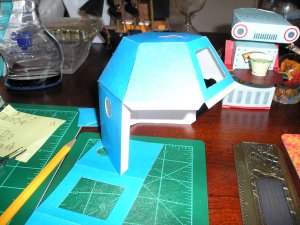

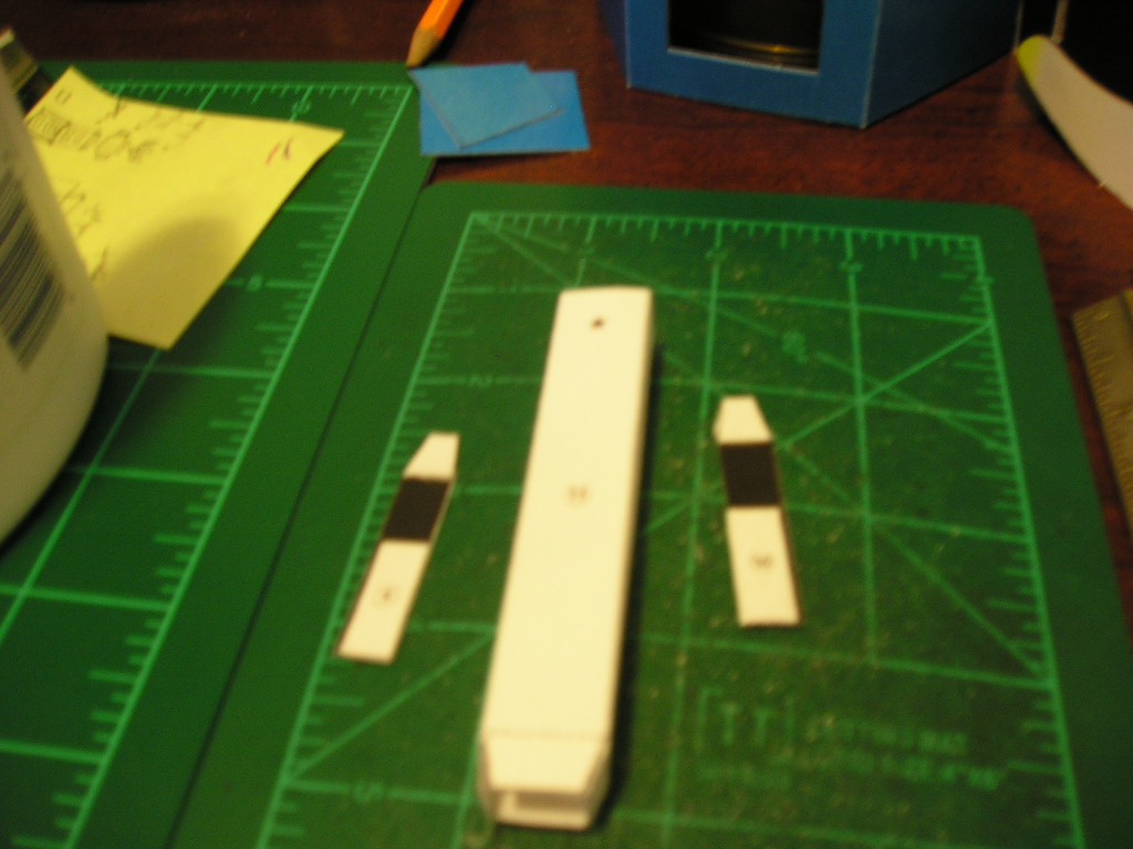

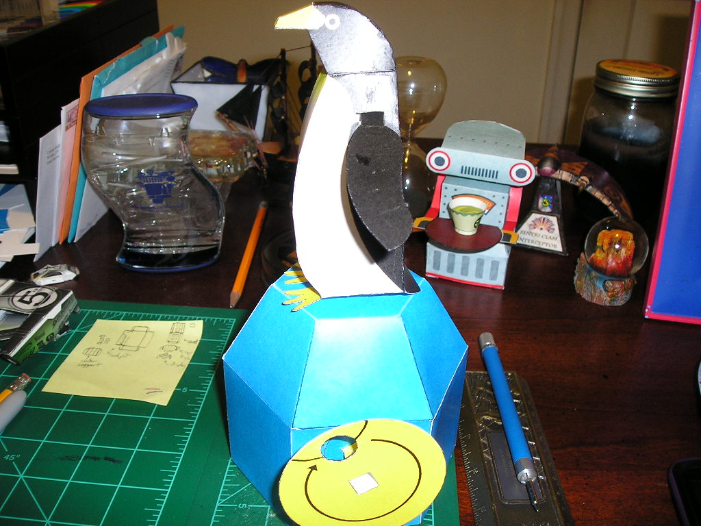

Here's some more pics with the Penguin this time.

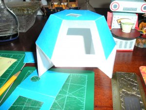

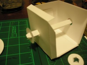

After cutting out each piece make sure you number them so you don't get confused later.

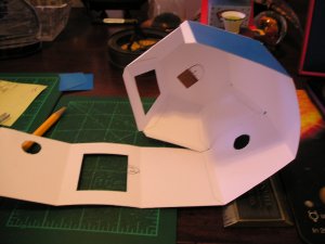

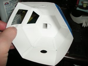

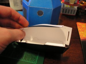

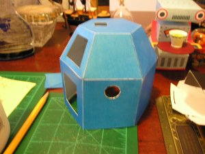

Base construction.
Note attachment of the front of the base to the main base. Starting from the edge working around to the other edge.

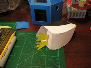

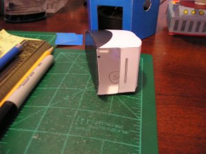

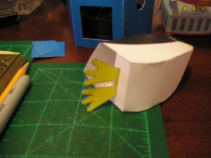

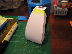

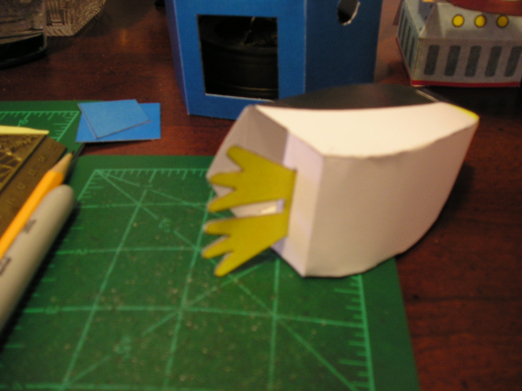

Penguin body.
Note the bottom slot. The feet are just inserted through the slot and are NOT glued. They just flop around.
That's it for now.

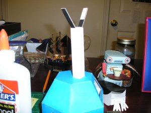

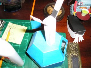

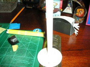

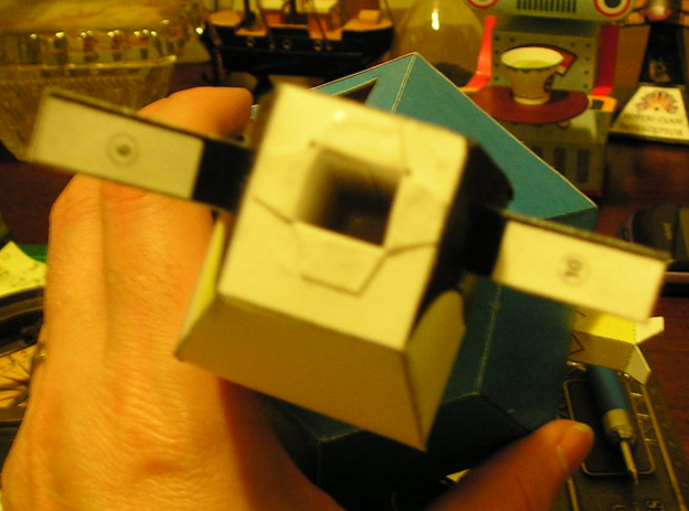

More pics - Penguin.

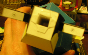

This is the main shaft inserted through the penguin with the two tabs that are glued to the wings.
Inside of the bottom with the bottom of the shaft above glued in place. Note the tabs at the top of the inside base.
Shaft glued in place to base.
Tabs glued to shaft.
That's it for now.

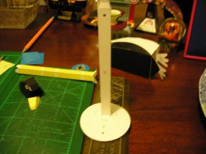

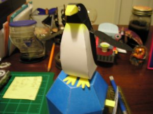

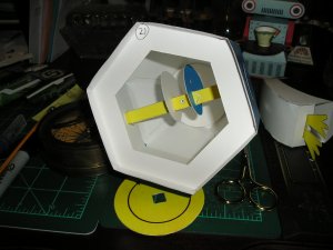

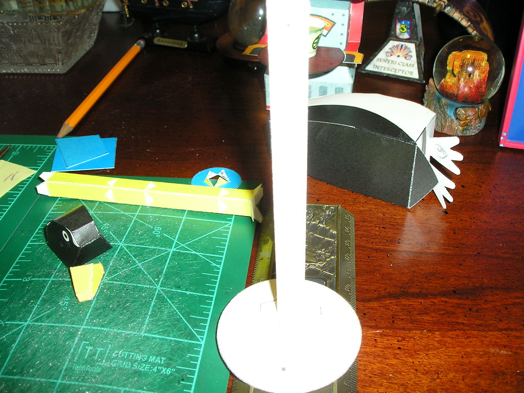

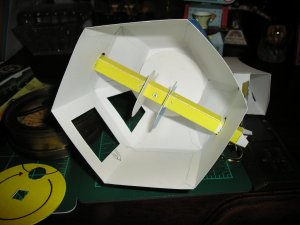

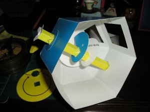

This is the main rotating shaft with the cams pre-positioned (before gluing). Note the penguin head. Note additionally the blue circle on the right with a yellow center with an "x". Cut along the "X", but NOT around the edges of the "X". This forms tabs which allow the circle to be glued to the shaft. The same applies also to cutting along the "X" for the cams.
The moving shaft that extends though the other shaft joined to the base. The star indicates which direction the shaft has to face in relation to the front of the base.
The cams were placed on a scrap piece of card stock traced, cut out, and glued in place on top of the original cams to strengthen the cams.
Cams glued onto the shaft. Note the designer left white arrows to indicate where the cams are to be placed.
Cam shaft mounted to the base. The shaft is just slid inside of the holes cut out earlier in the base. Also, the cams contact the bottom of the platform joined to the moving shaft.
End attachment on the cam shaft.
Bottom view. This also features the cuts made to the base so that the students can see the workings of the cam shaft in relation to the moving platform. The original design is covered all the way around the base.
Base with stabilization covering - 21. The flanges of the stabilization covering just reinforce and strengthen the model.
That's it for now.
Sky Seeker
:tank:

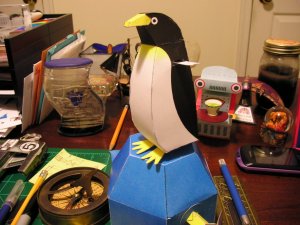

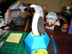

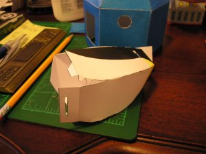

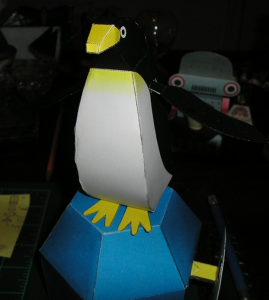

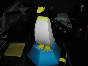

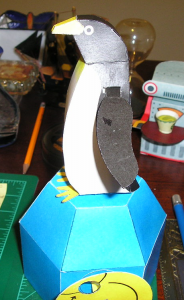

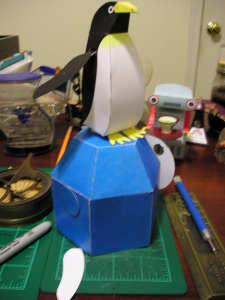

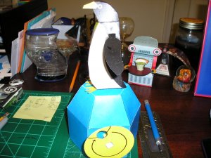

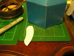

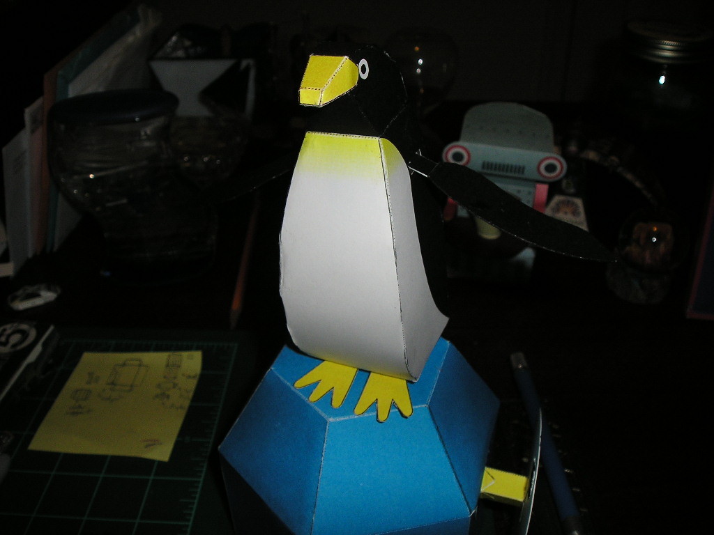

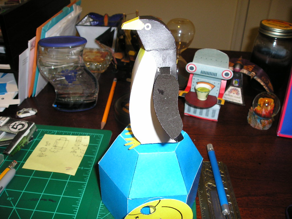

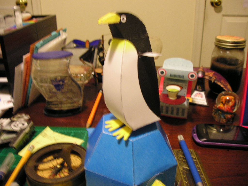

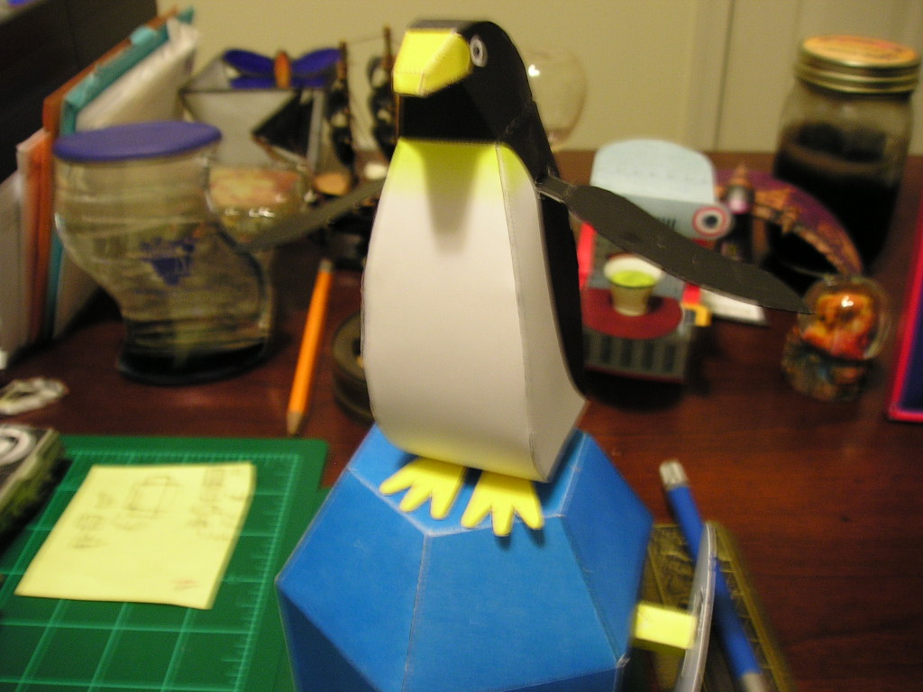

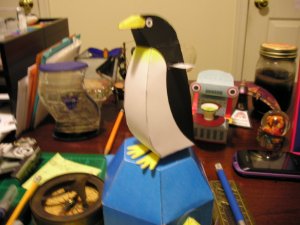

This is the top of the penguin body. Note the tabs of the top of the moving shaft glued to the top of penguin body.
Penguin head mounted on the body. Almost ready to fly!

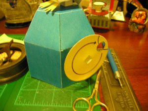

Crank wheel glued to the main actuating shaft. The cam wheel was reinforced with another layer of card-stock to give it additional rigidity.
This features the wing. Unfortunately, you can't see the stripes added to the underside of the wing added with extra cardstock from the model.
Penguin with the first wing added.
That's it for now.

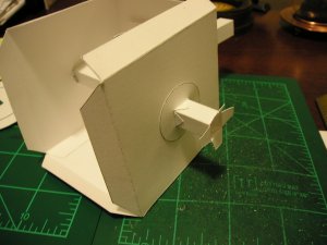

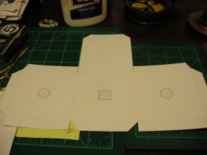

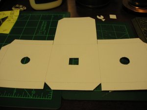

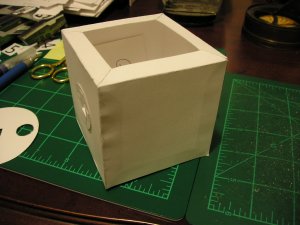

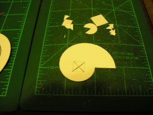

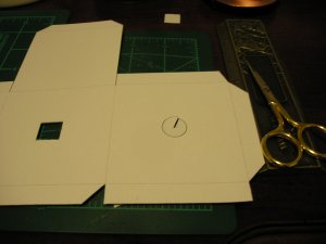

Cam 1 - Assembly and pics
This is a quick build that demonstrates a single cam / post actuation similar to the one used with the robot above.
Before assembly all parts should be numbered so that you know which part goes where.

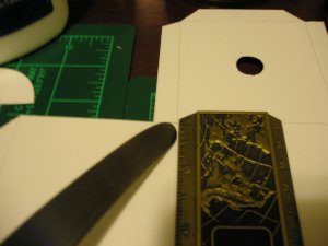

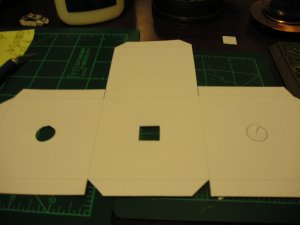

Base _ note the striped areas and dashed areas. The striped areas are to be cut out and striped areas are to be creased.

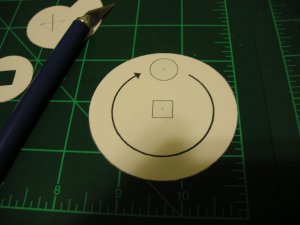

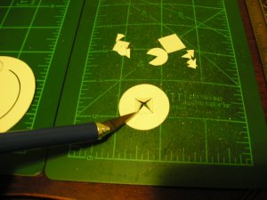

Note the area on the right. A single cut is made with a knife then scissors can be used to cut the periphery. Alternatively, a knife can be used to cut the circle all the way around. Of course if you have the right sized hole punch that would leave the cleanest cut (if anyone out there has any ideas about how to make a better cut please feel free to comment!).
I guess Pac Man is hungry!

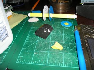

Note the "X" portion within the center of the circle. Cut along the "X", but NOT the sides. Crease and fold along the sides.
On both cams make sure to cut along the "X" as well. Crease and fold.
This is the turning wheel / crank for turning the shaft. Make sure to cut out the striped areas. To make the wheel crank stronger you can choose to place the wheel crank on some extra cardstock. Trace the outer perimeter, cut out the shape, and glue to the existing wheel crank (the one you traced). Make sure to apply glue sparingly along the perimeter. Place something heavy on top of the wheel crank until the glue dries. After the glue is dried, cut out the circle and square. If the cut out areas are separating, apply glue to the separated areas with a paperclip tip. After application place a heavy object on top until dried. You now have a stronger wheel crank.
Fold creasing. Along the dotted lines position a ruler (or other stiff straight edge) on one side of the dotted (crease) line. Take a butter knife on the dull side and apply pressure onto the paper and run the knife along the edge of the ruler. Do this a couple of times. This allows for sharper creases and eases assembly. Alternatively, a pointed paper stylus can be used to form the creases instead of the butter knife.
That's it for now.

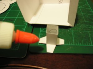

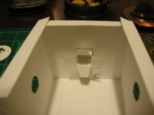

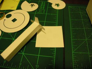

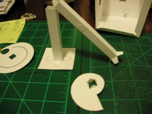

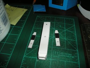

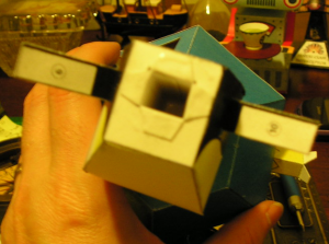

Cam A - more pics

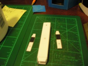

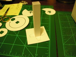

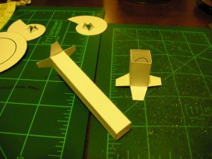

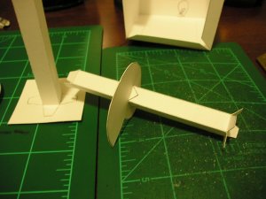

These are the shafts for the moving post.

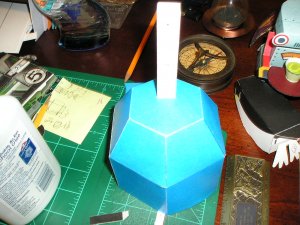

Apply glue on top of the tabs of the short shaft.

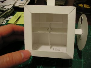

Insert the shaft in the square hole at the top of the base. Press the tabs of the shaft flush with the top of the inside of the base.
Apply glue to the tabs of the long shaft and attach to the base on the dotted areas (hard to see in the pic).
Shaft assembled to the base.

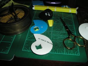

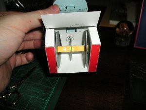

Cam shaft pre-assembly. Glue the cams together. Make sure that the square holes align. Also, place the cams underneath a heavy object until cured. If you don't the cams will have a warped appearance.
Apply glue on to the shaft on the center arrow areas.
Move the assembled cam into position on the shaft. Press the tabs down onto the shaft.

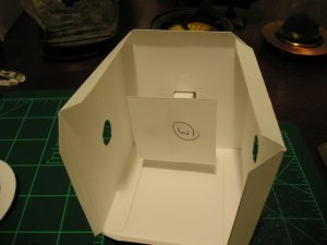

Insert the shaft with the square base into the shaft shaft on the top of the base. Make sure that the shaft can move up and down within the short shaft.
Shaft within the short shaft inside of the base. Note the number on the square base.
That's it for now.

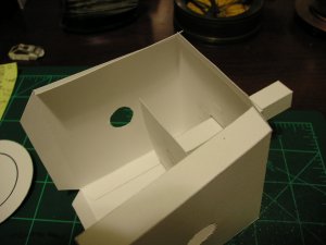

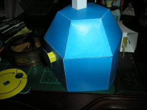

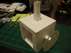

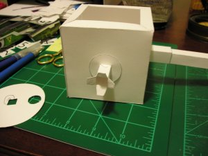

Cam A - more pics & final assembly

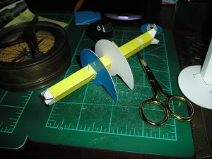

End portion on shaft. Circle positioned on one end of the cam shaft. GLues the tabs on the end of the shaft and fold down on top of the circle.
Glue the other circle on the opposite end of the cam shaft. Apply glue first onto the arrow areas near the end of the cam shaft, then move the circle along the cam shaft until positioned on top of the glue areas. See below.
Glue the big square in place onto the base.

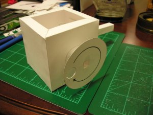

Apply glue onto the tabs of the cam shaft. Then attach the wheel crank onto the end of the cam shaft.
Wheel crank attached. Assembly Complete!
Side view. Note also the attached of the wheel crank with the cam shaft as well as the position of the cam to the base of the moving shaft.
