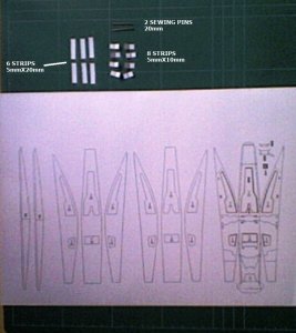

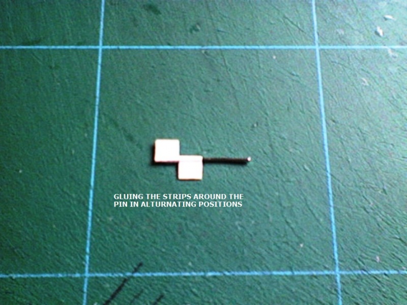

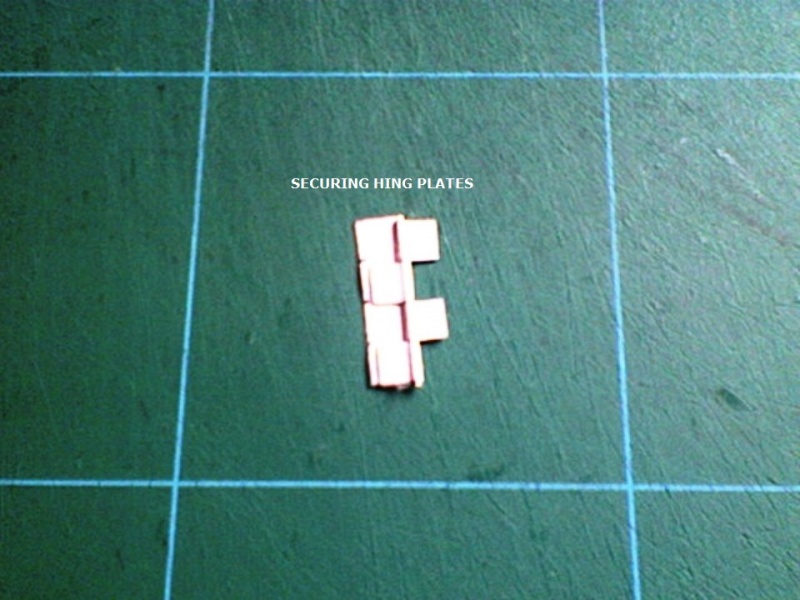

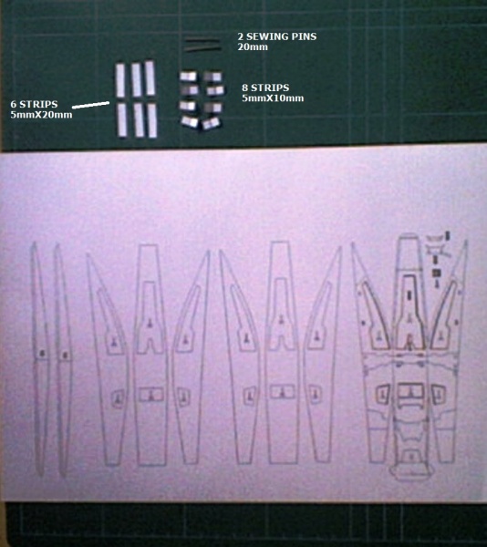

These are the parts that I used; Parts sheet with the canopy parts, 6 strips that are 5mm X 20mm, 8 strips that are 5mm X 10mm, and two sewing pins cut to 20mm.
gluing the strips to the pin to form the hinge.

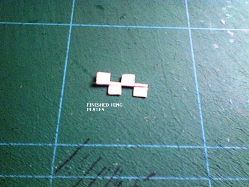

After finishing this one, you need to make one more just like it.
I attached the long strips to the hinge plates.

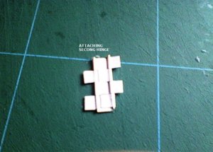

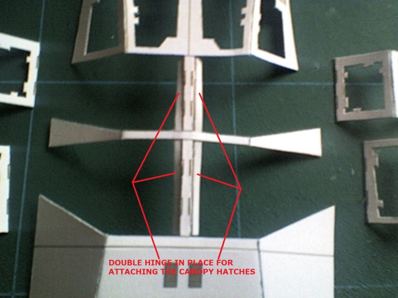

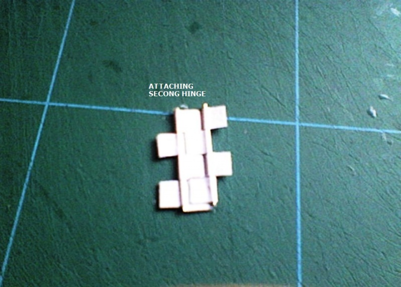

Attaching the second hinge to the long strip

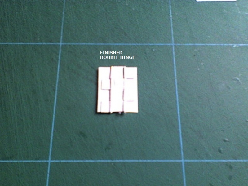

After you have finished attaching the second hinge, attach the longer strips to the hinge plates. You now have a double hinge.

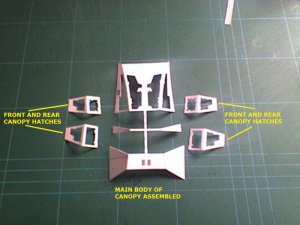

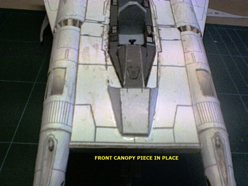

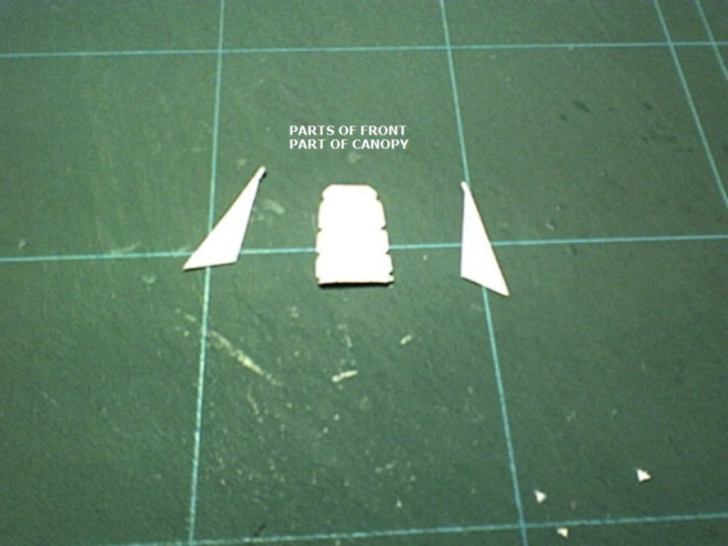

These are the pieces of the front part of the canopy
front piece assembled and put into place.

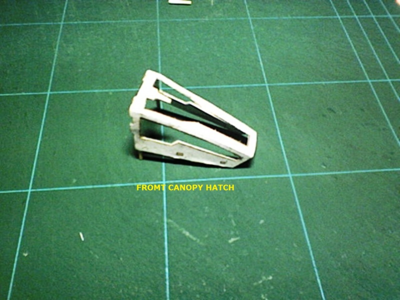

front hatch assembled and double hinge attached.

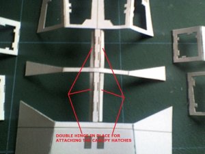

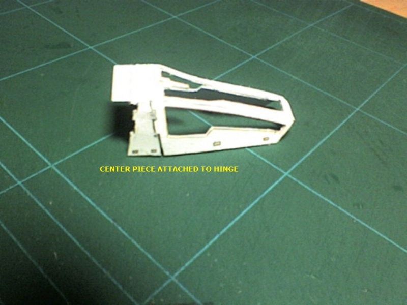

Center piece is attached to the center part of the double hinge. This piece will be secured to the plane after the last back piece is in place.

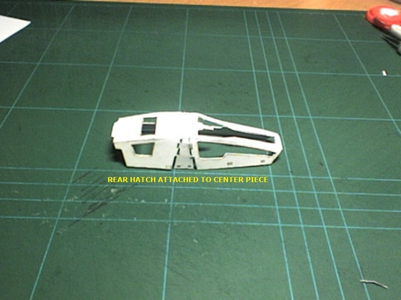

back hatch is attached to the back end of the double hinge.

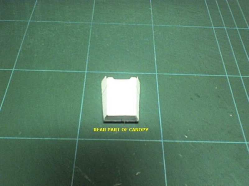

Rear part of the canopy is assembled.

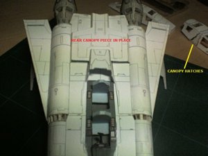

I have attached the rear canopy part in place.
The main part of the canopy is now in place,

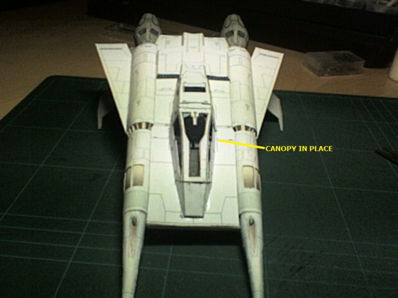

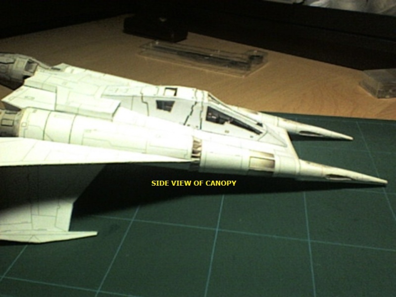

Here is a side view of the canopy in place.

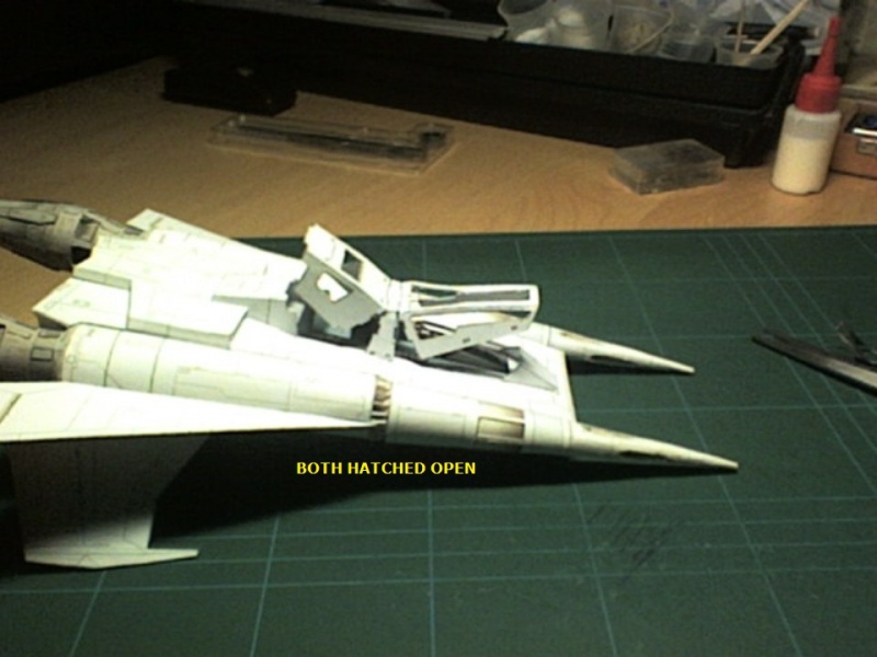

Hatches are open.

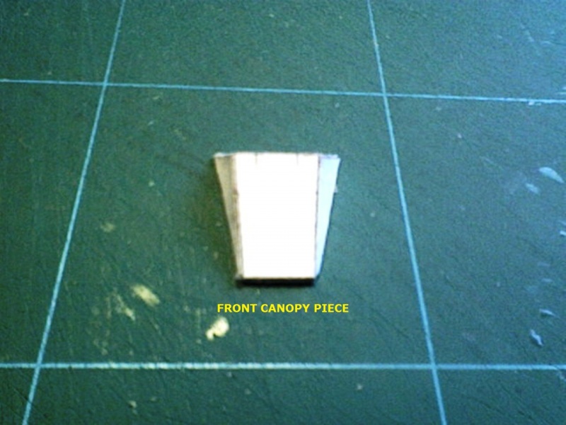

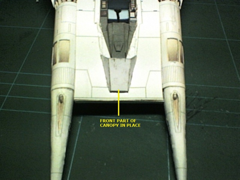

Front canopy piece assembled
Front canopy piece in place.

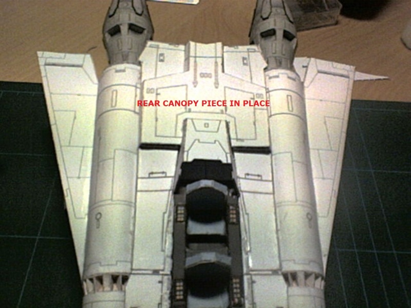

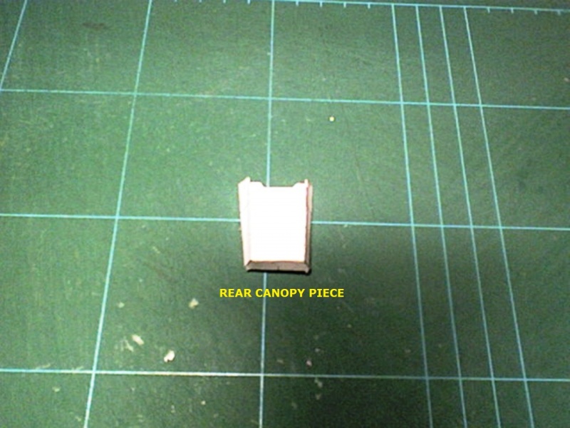

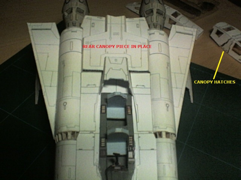

Rear canopy piece.
Rear canopy piece in place

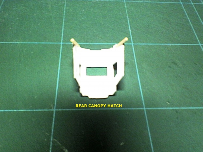

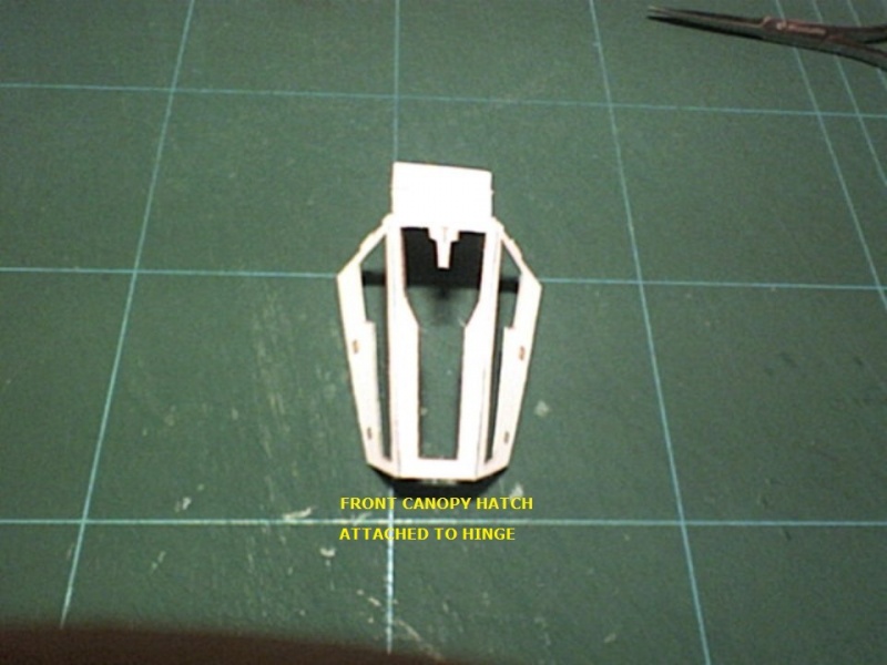

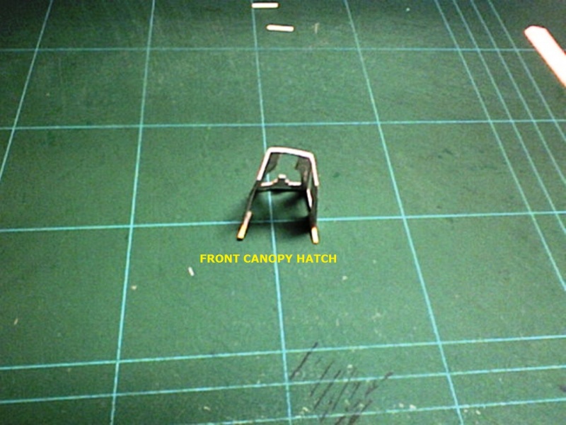

Front canopy hatch. As you can see, I used pieces of tooth picks for the slide posts. (This was done for both front and rear hatch)
Side view of front canopy hatch

Rear canopy hatch

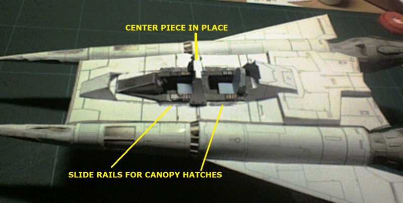

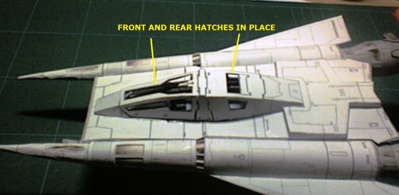

Center piece in place. slide rails cut on either side of cockpit interior.
Front and rear canopy hatches in place

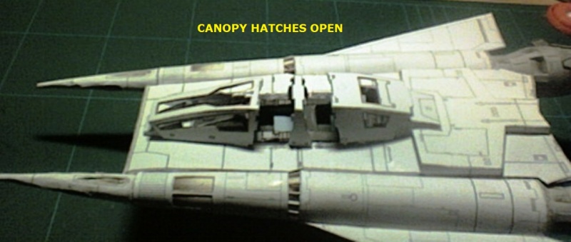

Canopy hatches open.

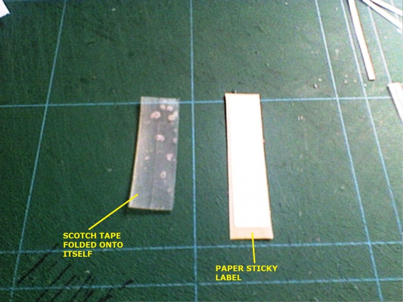

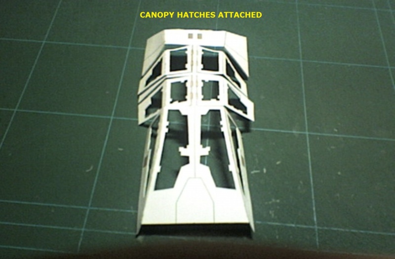

Here is the QUAD canopy. In this segment, I made a different hinge system for the hatches. Instead of using a pin for the hinge, I used scotch (clear) tape and sticky labels (as you will see in the photos).
I got the idea from Silveroxide, when he was talking about out to glue clear plastic on to paper to stick together with out clouding the plastic.
This type of hinge can also be used for the two seat canopy as well.

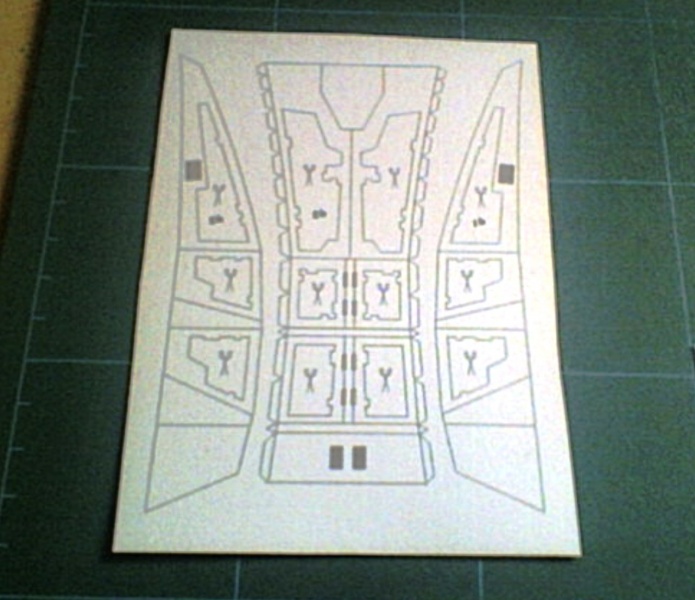

Part sheet (You will want at least three copies for laminating all of the parts)

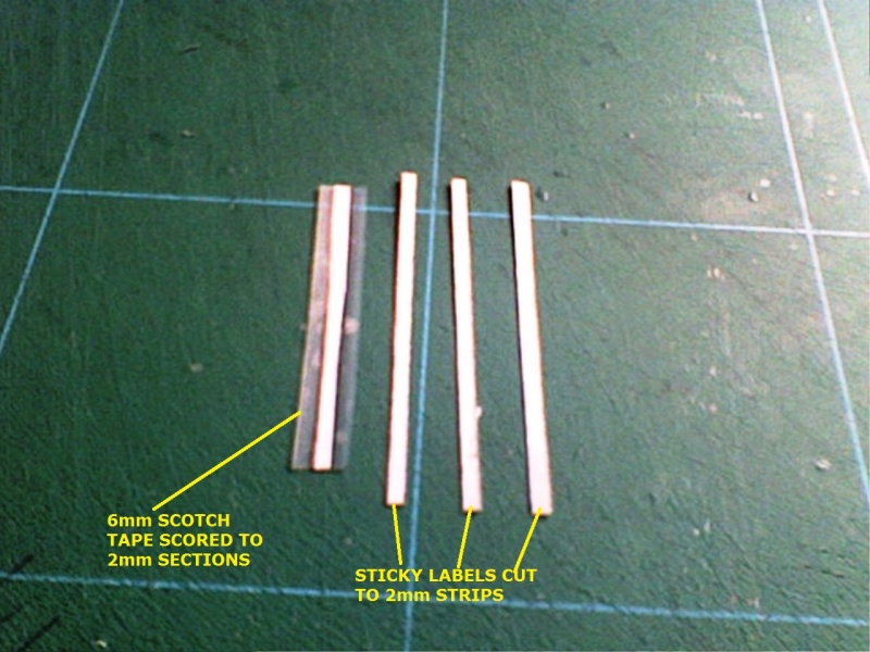

I took Scotch (clear) tape folded it onto itself. Next to it is a sticky label.

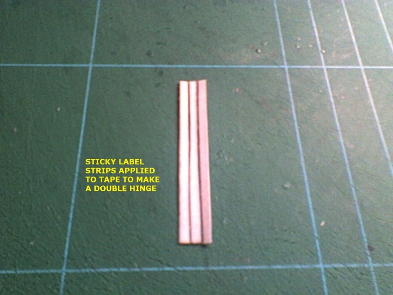

I cut the tape into a strip (40mm X 6mm) and the sticky labels into strips (40mm X 2mm).
I applied the sticky label strips to the tape (on both sides) to make a double hinge.

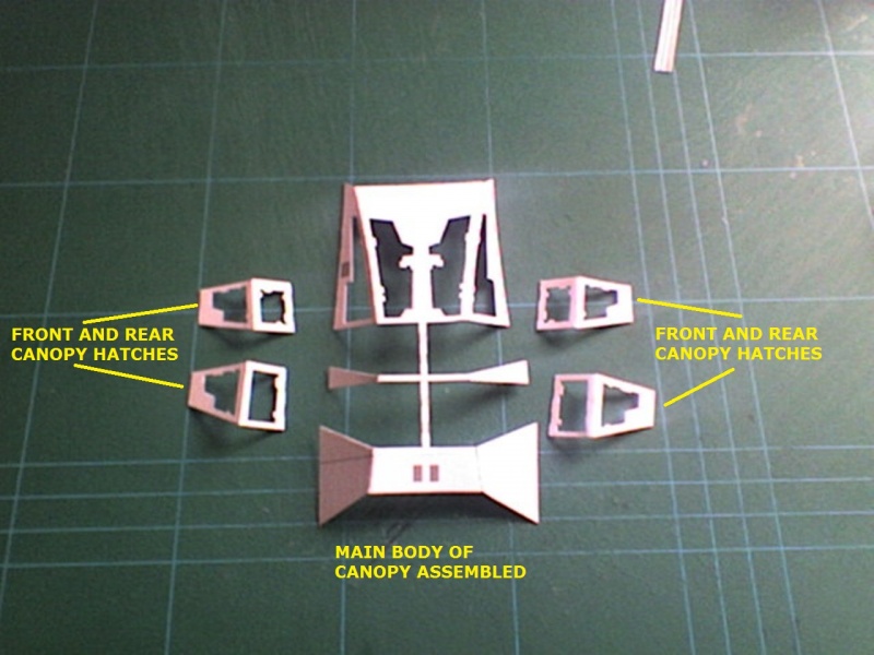

I cut out and assembled all of the canopy parts (keeping the hatches separate).
I attached the hinge to the underside of the center rail,
Here I have attached the hatches to the hinges.

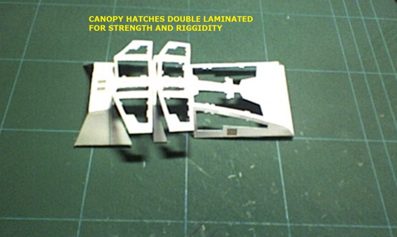

I double laminated the whole canopy for added strength and rigidity.

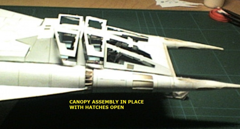

I attached the canopy to the plane, with hatches open.

I assume that the canopy would be something like a gull wing effect folding up. That center channel for the attachements must be a B****, (Rhymes with witch) as thin as it is, it probably would be hard to control warpage. Did you place a strenghtning strip on it? It looks great, thinking and building out of the box.
Thank you for the compliment.
Too right you are, it was B****:headbange::headbange::headbange: to work with. It does not help matters when I have HUGE hands like bear claws.
The tape that I used to make the hinges as well as laminating the whole canopy twice added to the strength of the center channel, so no warping.
If you wanted to, you could run a 2mm wide strip of thin plastic down the entire center of the canopy to help strengthen it.
