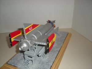

I completed this scratchbuilt wood Fireball XL5 several years ago. Now that we have a wood forum and I have plenty of build pics, I thought I would make a build thread to show one of the ways I scratchbuild. I have refined my methods over the past few years, mainly under the influence of pics on the site for the Osaka Solid Model Club in Japan.
On to the build. Here are pics of the completed project. The model is sitting on the launch cradle, which is glued to the rails. I like to build very sturdy wood models and encourage youngsters to handle them, which always comes as a surprise to them (they always hear Don't Touch!).
The fuselage comes from a wood curtain rod bought at the local hardware store. The fins are poplar, which can be hard to carve but is also tough wherever there is thin detail. I used the card model, studio drawings, and lots of stills from the TV show. I also used Martin Bower's web site for guidance, though his does not exactly match the TV stills. Don't know if it is still there, but I got a lot of stills from a Fireball XL5 yahoo group.

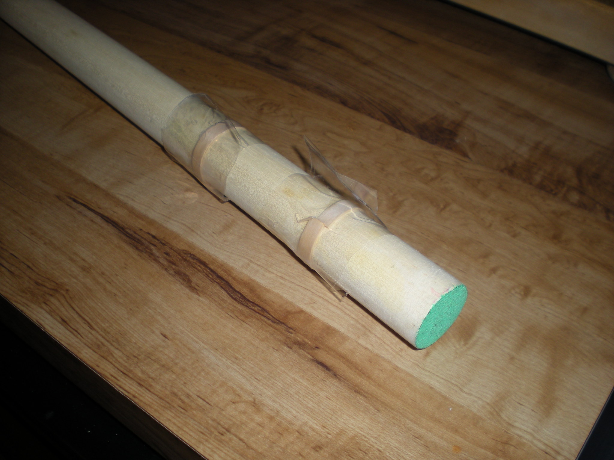

You have to be careful when doing cylinders to keep your circles. You can accidently carve and sand such that a cross-section that is supposed to be cylindrical is sloppy. For this reason I taped around the back of the cockpit before reducing it to a conical section for the nose.

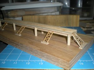

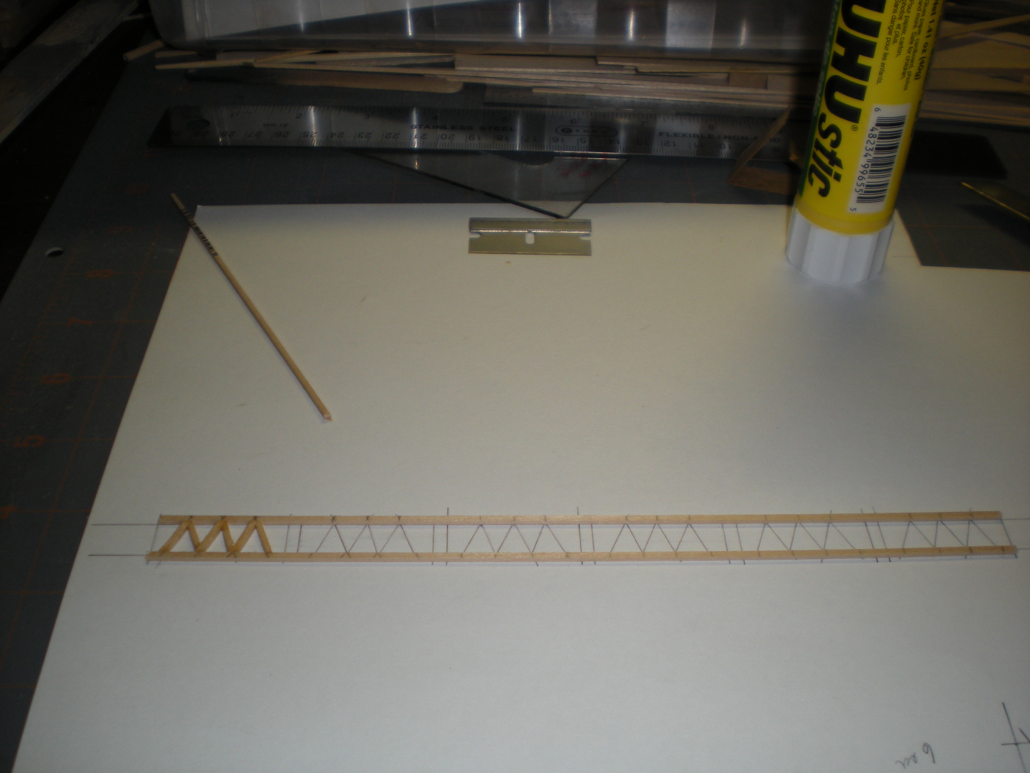

Sorry I haven't finished this build report but my crummy health does like to get in the way. On with the build. The rocket is done but we need the launch rail system. I found a lot of pics on the web to help with this. I just estimated it's basic size against the rocket and built a section.

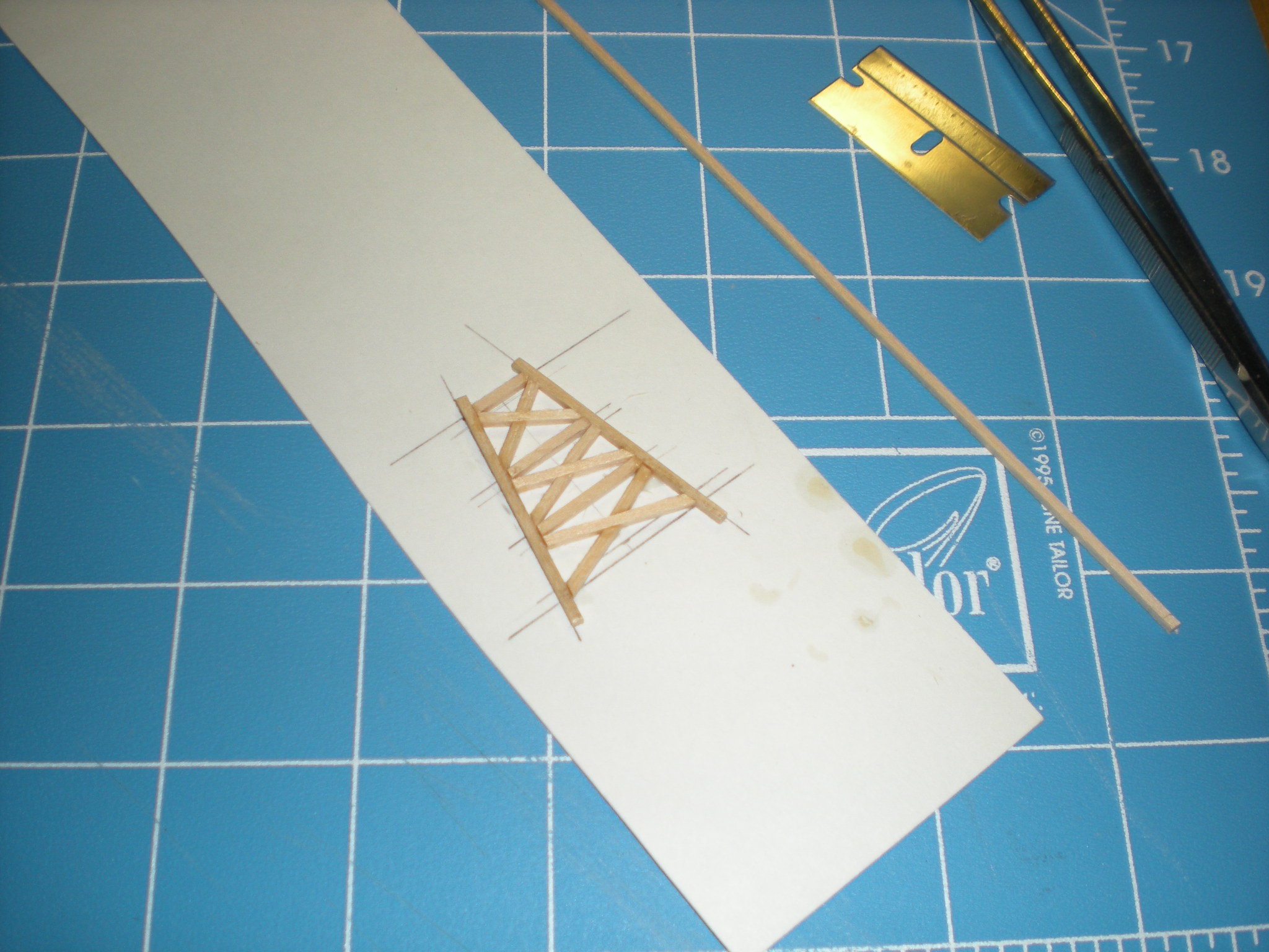

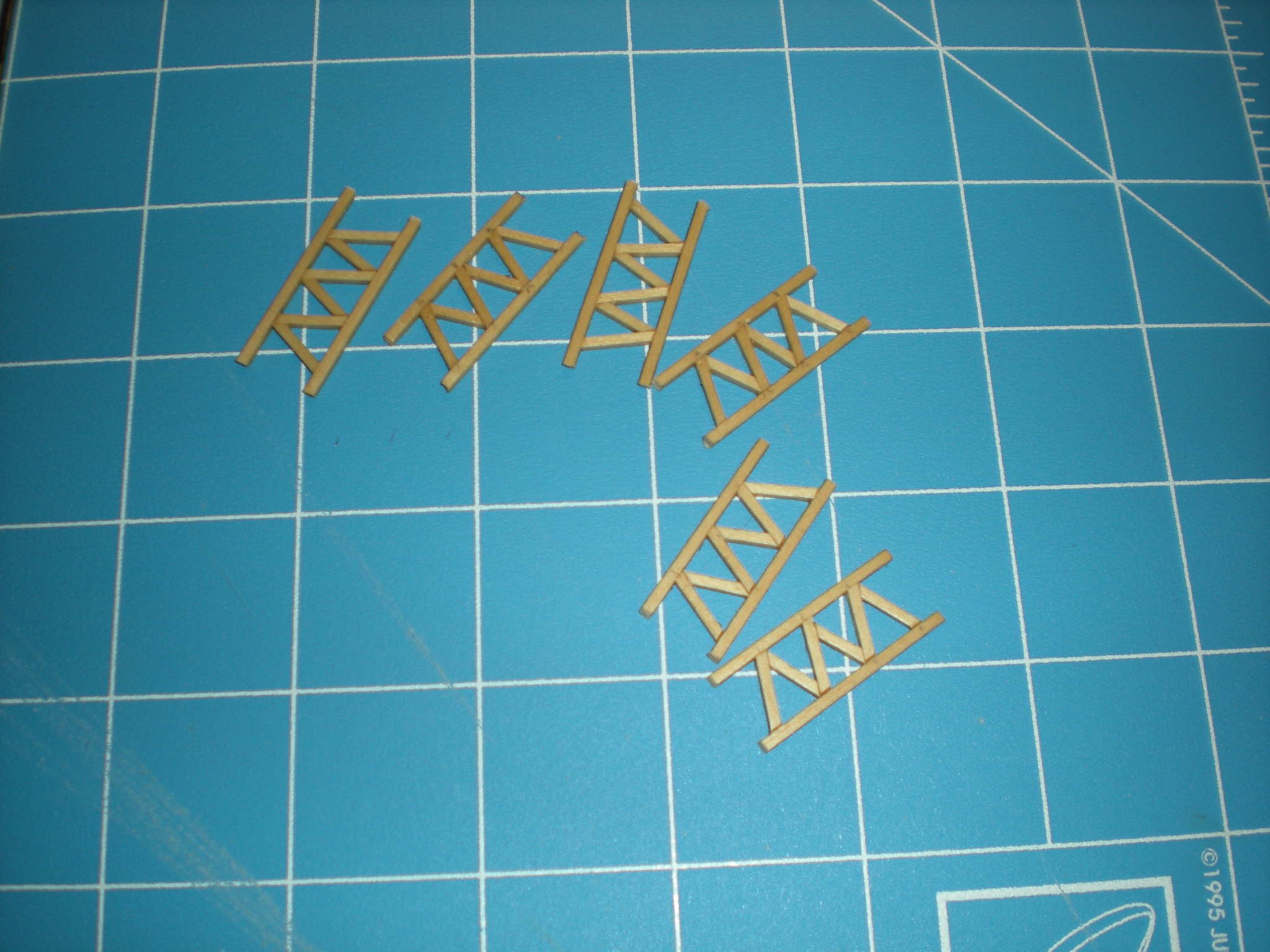

On the base you essentially have straight ladder supports and narrowing ladder supports. I drew out a template on card and built up my sections just like making a rubber powered airplane fuselage.
After that I just cut them out, sanded, finished, and they were ready.
The angled ladders were built the same way with a different template.
Reactions: micahrogers
I used a piece of red oak I got from Lowe's for the base. A nice, heavy base can support this model well. The layout was marked out on the board and holes were drilled for the posts. The posts were slotted to accept the strips of wood for the rails. The rails were then built on the posts and the ladders against the rails. The is actually a very easy base to build and when all these structures are glued together it is extremely strong.
As you can see in the background, I use clear plastic shoe boxes to keep the models dust free during construction delays.

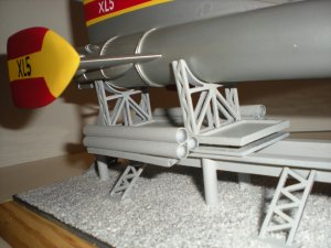

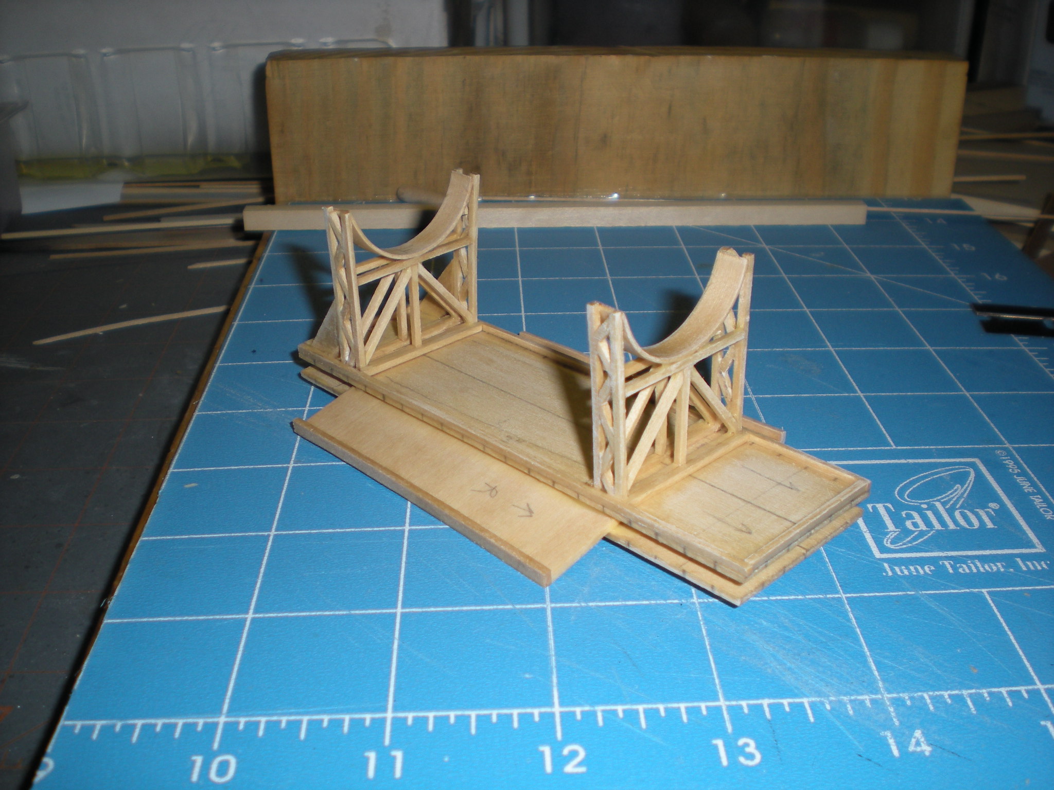

The launch cradle looks complex but is also simple to break down. Again, when all these structures are glued together it is extremely strong and does not flex. The cradle is glued to the rails but the model just sits in the cradle. This allows the rocket to be removed from the base for handling, fondling, and waving around the room making noises associated with childhood. You want to blow somebody's mind, especially a kid, tell them to feel free to pick the model up and look it over. I like to build them strong with durable finishes.
The bands for the launch cradle were easy to make. I took some of the wood rod used for the fuselage to use as a mold. Strips were soaked in water and bent around the rod. They were taped down tightly and left to dry. After drying overnight I took them off, bent them in further to get the proper shape, and they were ready for the cradle.
Look at the launch cradle as sections and subassemblies and you can see it is also easy to build. I did not get detailed plans, just templates for the structures. The booster rockets are rolled paper and lay on the wing-like pieces.

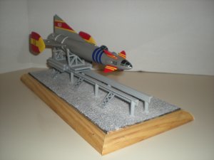

The base pieces were glued together and painted gray. I put some gravel from the craft store on the ground and it was ready to hold the rocket for display.

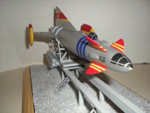

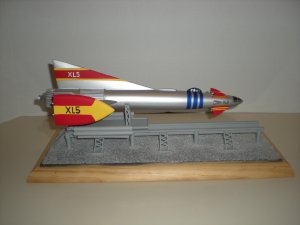

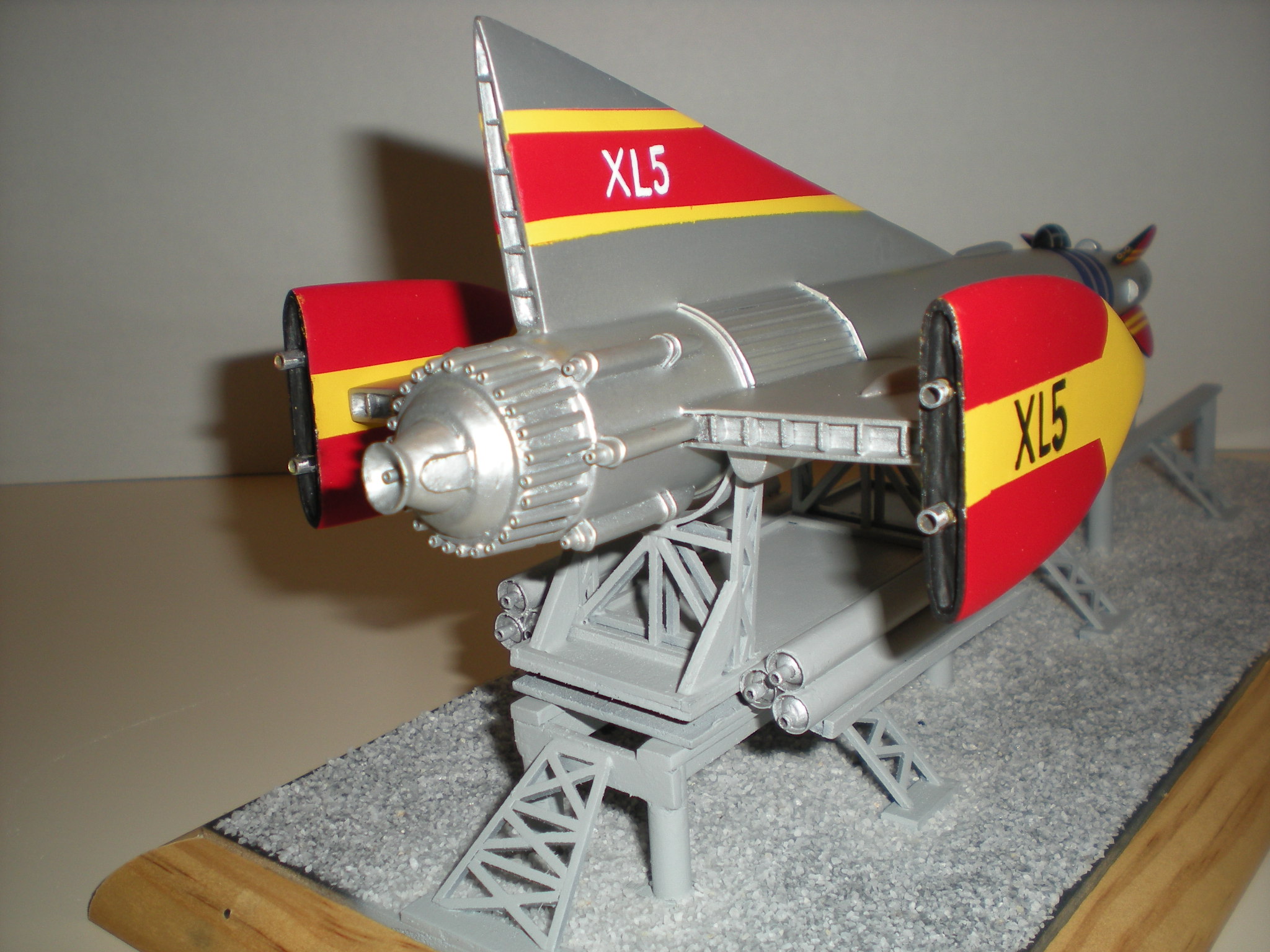

Well, here she is. I could have gotten more detailed in painting by simulating the panels but I liked the way it looked so this is as far as I got with it. Everything is painted, no decals. The numbers were painted by hand. They are not perfectly formed, but I like the hand-painted look. The aluminum finish is Krylon aluminum paint. I covered it with Krylon clear, thinking that using the same paint brands would be a good idea. The stupid thing took on a shade of pink!. I sprayed it again with aluminum and it was fine. The markings are regular craft paints. I got the surface of the wood way to smooth and some of the aluminum chipped off when I removed the tape. I touched up the paint and it still looks good. You have to examine it closely to see it. I know better now and rough up the surface after I get it perfectly smooth.
