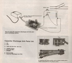

The two books describe each kit in detail, circuit diagrams, and hints for usage.

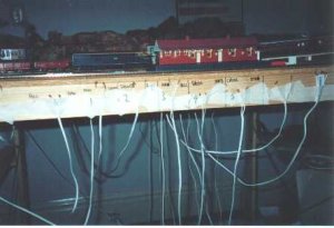

BTW..... my control panel! (as it was). my "switch" was just the other wire!! A few sparks fly when you "connect" the "momentary" wire, but it worked fine!

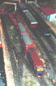

Oh... BTW.... the gap (line) you see between the tracks is the gap in the elevated roadbeds (I used balsawood roadbed). I've filled it in now.
