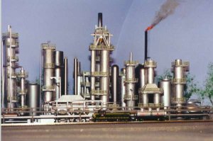

Refinery
Charlie, I scratchbuilt the refinery a couple of years ago for my previous layout. It now has a new home on my current layout.

Robin, your models are awe inspining!
I'm going to become an armchair modeller!:eek:
I already have the pencils/paper/rubber (and time to visit this forum :D )
What I lack is patience, I always want to see what I start on finished! ... an attitude not conducive to quality modelling.
Maybe I should go back to riding the range with Tonto :) .... well it's something I do well. :D
You're a first rate modeller Robin, congratulations.

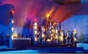

Flames and smoke
Tyson, the stack, flames and smoke are all just painted onto the background using those cheepie acrylic paints I find in the local $ store.
