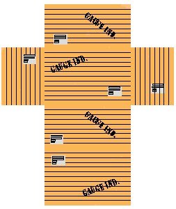

Shouldn't be too hard to make a pattern to print out, cut out, and fold-up that would get you the whole box, lettering and all. Seems I saw a web site a while back where you could download one.
While I like Charlie's idea of something communications related and working for a newspaper co. that is the way I'm going. However for those whose layouts are already to far along to add another industry I still the the box or crate is the way to go. May even use it also.

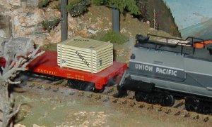

Would this be any good?
Grab the image from this post... scale it to any size (within reason), cover a block of wood and stick reinforcing batons around the edges.
(perhaps I should have used quality print on my printer instead of draft print)
Just my $0.02 worth! :)
Errol
Oooops, forgot the attachment!:confused:

I love it. Just think of the fun we will have with The Box. We can move them from place to place on out respective layouts, we can actually make them differen colors if that makes you happen, there are just all sorts of things to make it fun.
It also gives each of us lots and lots of opportunities to take pictures to share with all. I like that part even better:D
Errol, will your fisrt box soon have little boxes to share space with on the flat car?
Bob
Bob I put that box together in a hurry, next 2 (or 3 or more :) ) will be from solid wood, I'm sure they will look a lot better. I'll probably try using "Lettraset" for the stenciling (I'll try anything once).
Yes it's the tail end of a Bachman 0-6-0 switcher you see there, it runs smoother and quieter than a sewing machine (and it can run slowww):) just changed the McHenry tender coupler for Kadee and replaced the pilot dummy coupler with a Kadee.
Errol
Bob, if I remember correctly the pilot coupler is part of the frame moulding. I think I used a dental burr (courtesy of my dentist) in a Dremmel to grind it out. I've forgotten the coupler I used but it is a short one with a radiused back end. I drilled through the pilot beam and used a screw to secure the coupler. Then painted over the visible (but flush) screw end.
