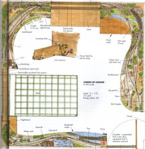

I don't know what the legal ramifications might be, but here it is.
The layout is actually a series of dioramas connected by removable link sections. The dioramas bascially fit in the corners, with the links running in areas where it wouldn't be desirable to have shelves (like in front of windows).
The layout is printed across the binding between the two pages, so the left-side doesn't quite line up correctly.
-Rory

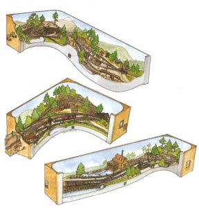

And here are Mr. Rice's drawings of the dioramas. Each one is self-contained, and each could function as a small layout by itself.
The layouts in the book make heavy use of external and/or hidden elements for staging trains--like removable cassettes, sector tables, and sector plates. The idea is to isolate the staging elements from the layout as much as possible, so that as much space as possible can be dedicated to scenery and running trains.
I definitely recommend this book. It has some great ideas!
-Rory

Wet blanket time.....
I hate to rain on anyone's parade, but I have a cautionary note to sound here.
I admire Iain Rice's ideas and his sketches, but I would suggest caution in expecting to be able to build his track plans --- particularly if you don't want to build custom turnouts.
I've noticed that he seems to draw his track plans in a very freehand manner, and many of his turnouts have curves in them. To see if this was just my eyes playing tricks, I've tried to redraw one of his trackplans (from the book) using stock standard turnout sizes, it just would not work in anywhere near the same space.
I expect that most of us would find his passing sidings way too short. And I feel he is far too free with reverse curves also. There was a thread here a while back in which several of you said that reverse curves are okay, and the prototype does it too. Okay. But just because you may be able to get away with it, doesn't make it good practice if it can be avoided. Reverse curves DO present the potential for trouble.
Bill Stone
Yes, there are a number of...difficulties...with the plans he presents. But his purpose was to show how to integrate various techniques that can make smaller layouts more worthwhile, not provide out-of-the-box track plans. I don't have a space in my new place where I can build one of these layouts exactly as shown in the book, but I have gotten some good ideas on how to design one on my own.
