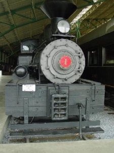

First from this Picture you will notice that the Boiler is off center to the Engine’s Left.

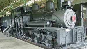

But, look at it from the Right side, and you will see what makes it go,
These gears and pistons allow the shay to pull greater loads, up steeper grades, more efficiently than most other classes of locomotives. The overall length of the Shay, is 52 Feet. Also a credit to it’s design is that compared to other locomotives it is light. Only 137,000 Lbs. It’s Gauge is the standard 4’ 8-1/2”. The piston system transfers the pulling force, to the wheels, via, the connecting rods and gears (shown here):

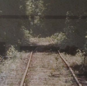

The Heisler was the latest to be designed, and had several design advantages. Like the Climax, but unlike the Shay, the drive line was centered, which improved the flexibility of the trucks, and improved tracking. also with the say the pistons were directly over one rail. on operations where the locomotive was never turned , that ran shays exclusively, you could see one rail was perfectly straight and smooth, and the other was crooked and wavy, due to the pounding the Shays cylinders gave it.
I have posted digital a photo I have taken of a photo Mack Montgomery took back in the 1970's that shows a section of the Grahm County Railroad near Robinsville NC. This outfit used shays, and did not turn them. look at the diference between the left and right rail.
