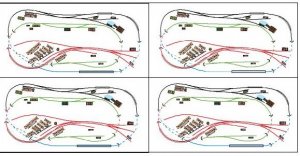

Hi and welcome to the gauge, you can make(4) - N-scale 4'by2's out of (1) - 8' by 4' for H0.
Any plan you find that is in H0 scale, just divide it by 4 as a general rule for N-scale and it should fit.
Shamus
