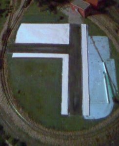

As requested in another thread, here are pictures of the progress on the new town configuration for my layout. The first two pics are the "before" images, and they've been posted before.

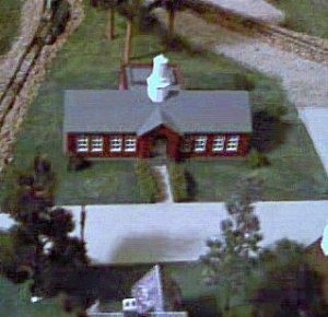

Here is a view of the school:

I painted the streets with India ink diluted with alcohol (they were originally gray). I'll figure out a way to do stripes later. The white areas are going to be sidewalks, foundations and alley-ways around the buildings. I glued down Craft-It mini-sticks (from Hobby Lobby) to make the forms, then poured plaster of Paris into them. After the plaster dries, I'll add another coat to level it; then I'll paint it with a gray color to simulate concrete.
When I originally poured the streets, I didn't fill the forms all the way to the top. That way, the wood forms become curbs. The sidewalks and foundations, though, are even with the tops. To make a driveway, all I'll need to do is whittle down the wooden curb a little...

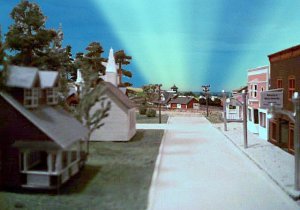

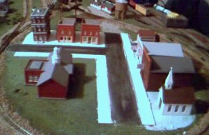

And here are the buildings in their approximate positions. (I noticed just now that the two brick buildings along the back are too far apart.) Yes, the hotel on the left is leaning to the left. I still need to apply that second coat of plaster and level out that section.
I'll post more pictures when I've got it finished. It'll probably take me a couple of days! :)
-Rory

I still have to pour more plaster to fill in some gaps and uneven spaces. The stuff set too fast for me to get it all even last night, so I figured I'd have to do it in two phases. That'll hopefully fix the "Leaning Hotel of Bryan" problem! :)
I don't know what came over me with the roads... I prefer the look of concrete roads in towns. I was kinda thinking of "modernizing" the layout, though, since I'm moving it forward in time to the present. Most of the towns in these parts end up putting layers of asphalt on top of the concrete at some point...but not all.
The buildings are open at the bottom. I plan on eventually putting in some cardstock to block the light from shining through. When they get moved to the Next Big Layout, I intend to install interior lights.
This layout has mostly been a training exercise for me. One day I hope to build something much bigger (The Next Big Layout, aka The Next Big Thing). The current one, though, is based on the Atlas N-11, Unhinged and Horizontal. It's built on a hollow core door. I used blue foam insulation as the base. The whole thing sits on top of two wooden TV dinner trays! Not the most stable platform, but it's convenient.

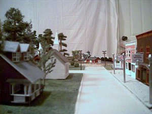

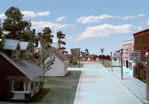

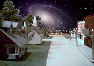

Tyson, here is a digital backdrop applied to that second picture:
-Rory
Wow, Rory!
That really makes it, my friend! I can almost hear dogs barking, & a breeze blowing!
I've always liked your trees, but they look even better with that sky behind them!
Isn't it amazing what you can put together with some wood, plaster, glue, styrene, & lots of imagination?
