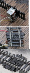

The PL10 motor is fitted onto the point itself and a hole is made in the baseboard the size of the motor and the point/motor inserted. After this apply masking tape to either side to cover up the rest of the hole. Don't forget to paint the tape what ever colour you first painted the baseboards before you laid any track.
Here is how it's fitted, top photo showing point & motor -- 2nd photo shows how to bend over the lugs, final photo shows it on a piece of insulation board (Easy to cut)
Shamus
