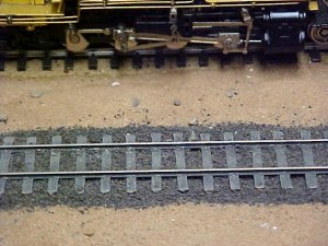

unpainted, unballasted (and note the track, how close to the edge, for previous thread).

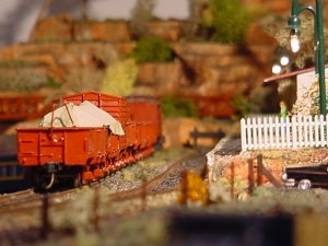

Painting the track makes all the difference in the world:) This is a spur leading to the farm supply warehouse and is ballasted with cinders.
My method: Do it in place. I airbrush the rails and ties with grimy black. Then dry brush the ties....you don't have to be careful this goes fast...with a light grey. Add rust to the web of the rail if you want to. Ballast the track and using some #1200 emory paper ( very, very fine) clean off the rail tops.

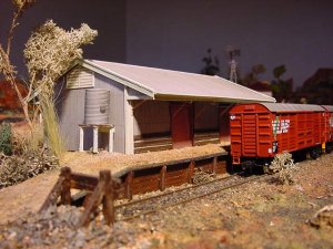

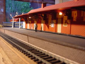

Love the station and goods shed.
Question : Both buildings scratch or kit built? and if kits, where did they come from? The shed is almost identical to a prototype I have seen and I would be keen on locating one.

The good shed is a cardstock kit from LJ Models (no website) for around $10 a kit. I just "bashed" it up a bit with styrene and model lumber for the barge boards and external frame boards. They make about 20 different kits based on Aussie prototypes. ($10 - $15 each) I can email you a scanned kit if you like (to get the resolution and detail for printing + instructions, its about 5 meg (split over 4 emails).

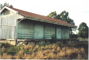

The goods shed is a model of this prototype (Seymour, Victoria, but these sheds are all over Victoria.) The house and pub on Garahbara are these kits as well. I've just completed the community hall and church as well. The kits do everything from public houses to public dunnies. :cool:
They have a fabulous card model of Ripponlea, a historic house in Melbourne. Costs $70 though.
Now....... Where would you rather live? That house, or this shed!!!
