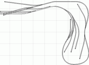

Well, it was just an experiment. I like RTS, though, because I can quickly sketch something out. To me, it's the easiest of the layout programs available. Attached is a layout I put together based on the Mount Galena Mines Railroad from Small, Smart & Practical Track Plans. This version is in N scale, but it occupies about the same amount of space. I was able to put this together (including inclines) in about 20 to 30 minutes...while talking to my wife! :)

That's a good drawing. Trying to get precision into a drawing for track is, to me, pointless. Such a drawing as yours is sufficient to let you know "it will work". (Chuckling again here) "Close enough is good enough" :)
Not sure that track plan can rightly be called "Small" though.
Is it the basis of your next major project?
Errol
The original is in HO-scale and is 8' x 10'. My version doesn't reduce it directly. Instead, I tried to fit the N-scale track into about the same space. It could probably be done in about 4' x 5', or maybe just a little bit larger.
I'm giving this design (or something along those lines) some consideration. Like I said in another post, this one has actually gotten me to thinking about going to HO-scale--mainly for the greater availability of steam locomotives and old-time structure kits.
