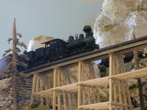

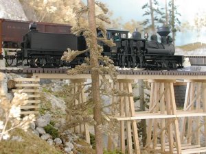

I thought I'd try taking photos with natural light during the day (as opposed to how I usually do it with artificial light) and voila! I think the results speak for themselves.

Vic- I took these with my digital cam, a Nikon Coolpix 775, set on autofocus with the flash off. As stated in my first post, I simply used natural light coming in from the window of the room.
