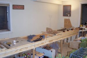

It was a great spring day in Chicago, so I moved the car out of the garage, and set up the slice and dice equipment, and commenced hacking up some wood. The second three module set is under construction.

Looking great sumpter250, whats that big grey bridge on the bottom right, part of a further module?

Woodie, I don't think "the top five" are applicable to my question. The bridge could be a static display, if not, I had a question of how Sumpter makes provisions for his track alignment. :D :p

Bill,
The bridge on the center module is a rolling lift, and I do intend to make it operational. Changes to the plans require that I move the rolling lift to the back of the module and put a non operating vertical lift in its place. The purpose of the placement of the bridge was to actually "bridge" the center and lefthand module, the vertical lift will do the same thing, but with a manually removable bridge deck. The rolling lift will still be an operating bridge. The beauty of the rolling lift is that it is basicly self aligning, and its bridge deck can also be removed, to make transport of the modules safer.
In order to include the "waterline"route, at a lower level than the standard mainline spec's, I will have to use the "take down" bench work instead of the standard legs. The modules are 48" X 30" vice 48" X 24", but will fit in the same trailer I use for the older mod's.
Pete
Thanks Pete, that answers my question and gives me several ideas. Plan on making several more "N" scale modules for our shows and water will definitely be in the planning. I'm impressed with your 30" wide modules. It doesn't seem like much over the 24", that is until you try and manuever them through some door in a high school gymnasium. Thanks again,
Bill P.
Bill,
The "skyboard", or backboard is the same for 30" as for 24", and the mod's are usually carried "front high" through doors, so there's really no more problem,,,,except for the extra weight.
